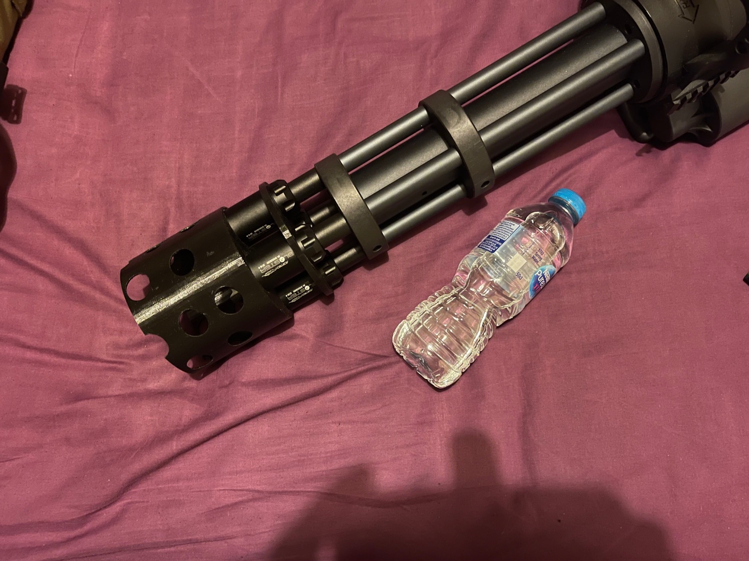

Supporters sp00n Posted January 2, 2023 Supporters Posted January 2, 2023 Still a work in progress …. I need to remodel the flash hider and coat the inside to make it reflective Nick G and Rogerborg 2

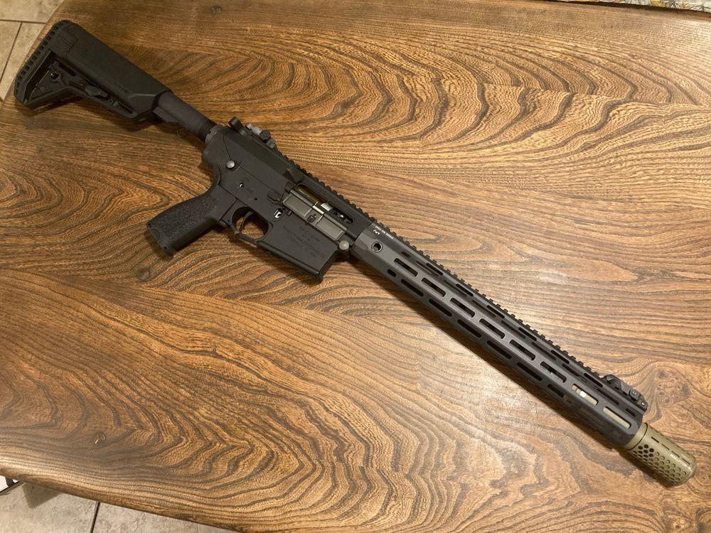

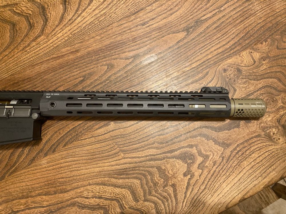

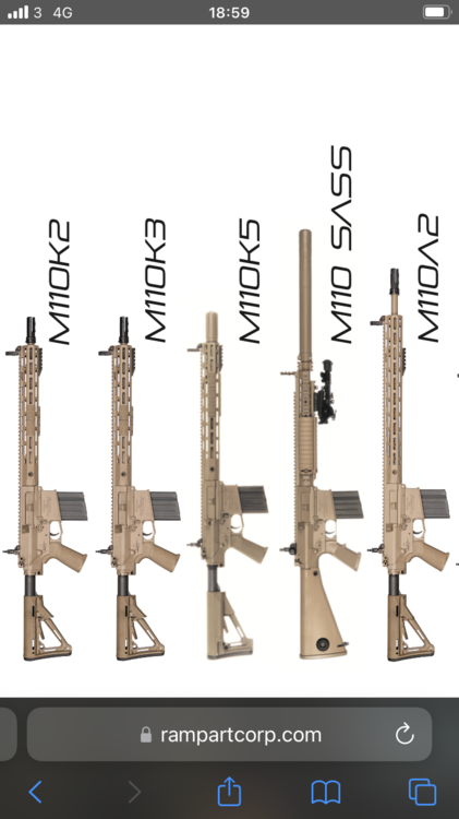

Davegolf Posted January 10, 2023 Posted January 10, 2023 (edited) WIP M110K5, suppressor modded/machined, we’ll pleased! Edited January 10, 2023 by Davegolf TheFull9 1

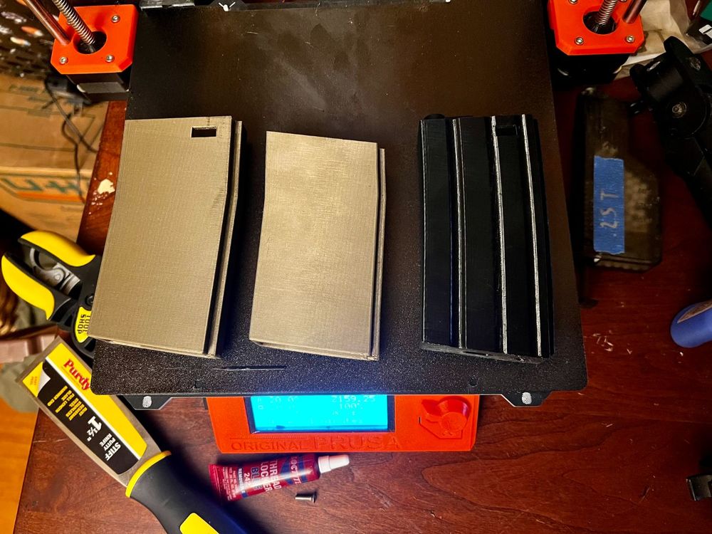

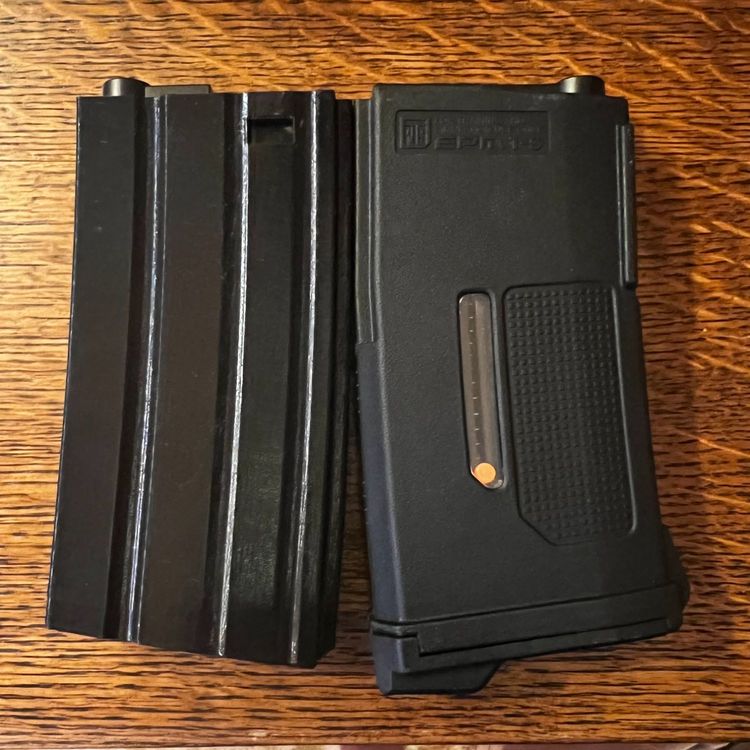

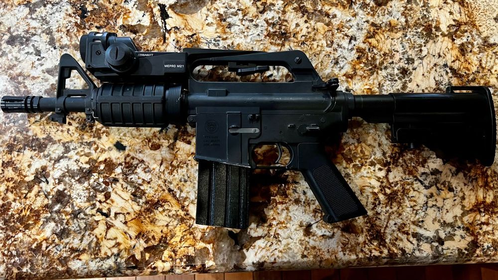

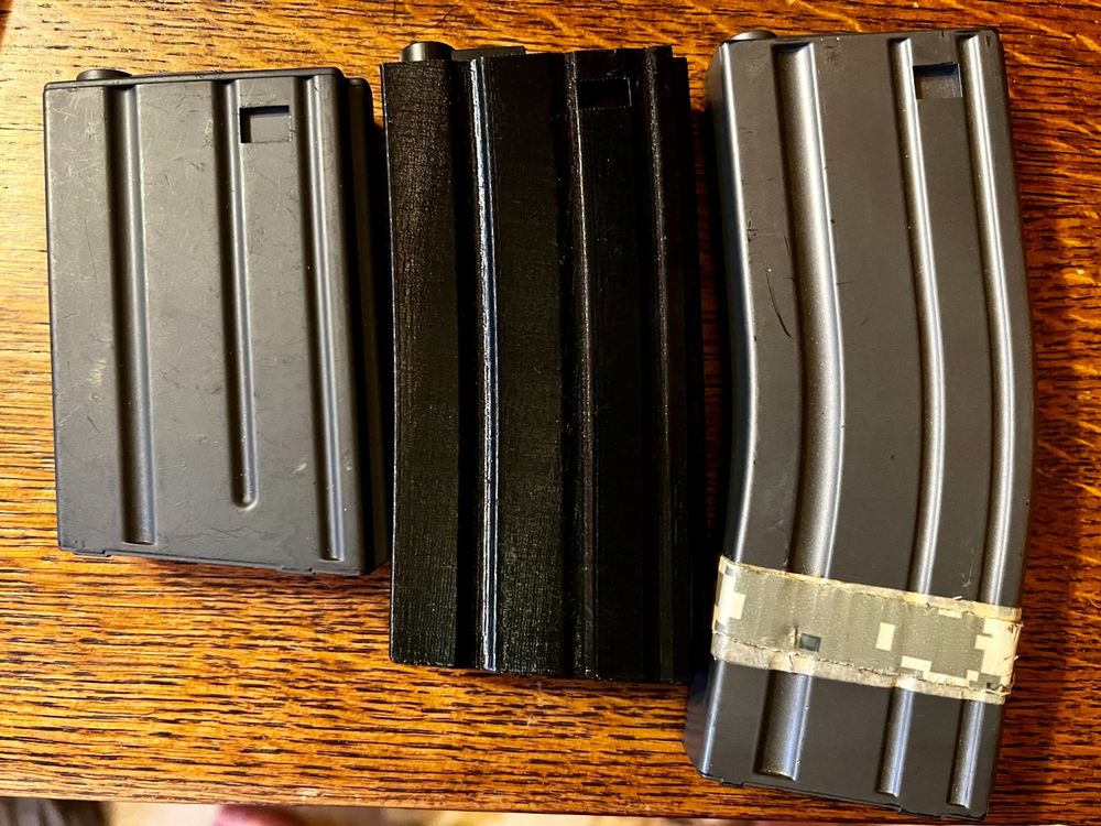

Supporters SeniorSpaz87 Posted January 13, 2023 Supporters Posted January 13, 2023 Been working on more EPM-1S shells, this time to make them look like M16 VN 20 round mags. Can be printed in one piece, with no additional hardware needed. As close to plug and play as I have come with a design as of yet. V1 was an attempt at adapting my 417 EPM-1S to fit, and was dropped early. V2 was a shell to test general fit. V3 fixed the internal dimensions to allow the EPM-1S to slide in fully - the print failed at about the 85% mark but it still allowed me to test dimensions so I still count it as a success. V4 was the initial "production" model, with the appropriate slots in the mag to make it look like a VN mag. A bottom floorplate was added for the EPM-1S bolt and plunger. The mag catch recession was shrunken to fit within the slots. After printing I confirmed V4 is a working model and I could stop there, but there were a few small details to be added. These included moving the bolt hole 1.9mm forward to align better with the hole in the mag itself, and the plunger recession was modified to fit the more ovular nature of the plunger. V4 in my N23: V4 next to a standard EPM-1S: Left to right, V2, V3, V4: V4 between a VN 20 round mag and a standard 30 round mag: EDcase and Nick G 2

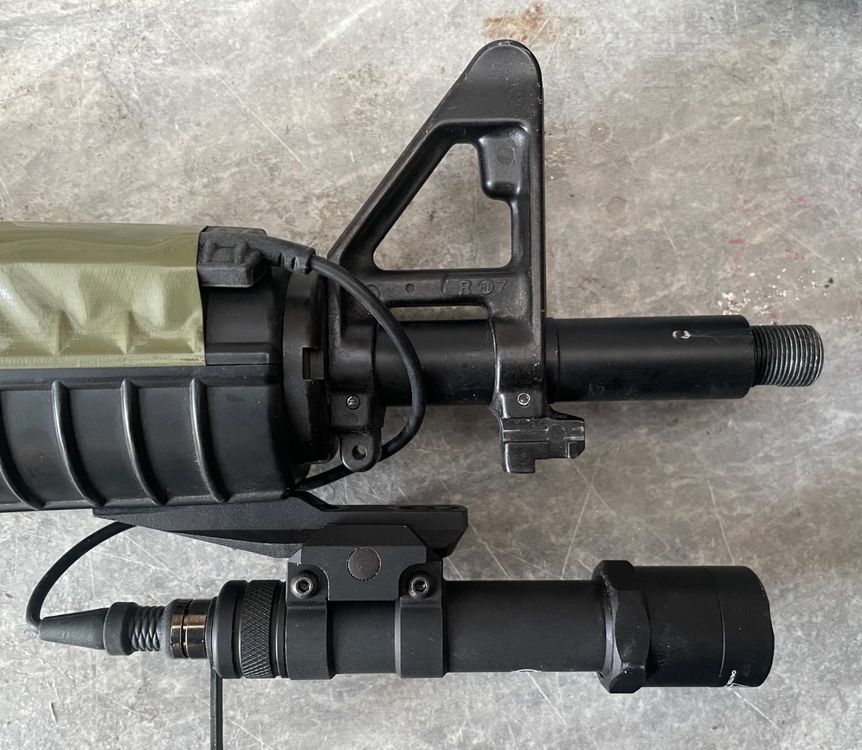

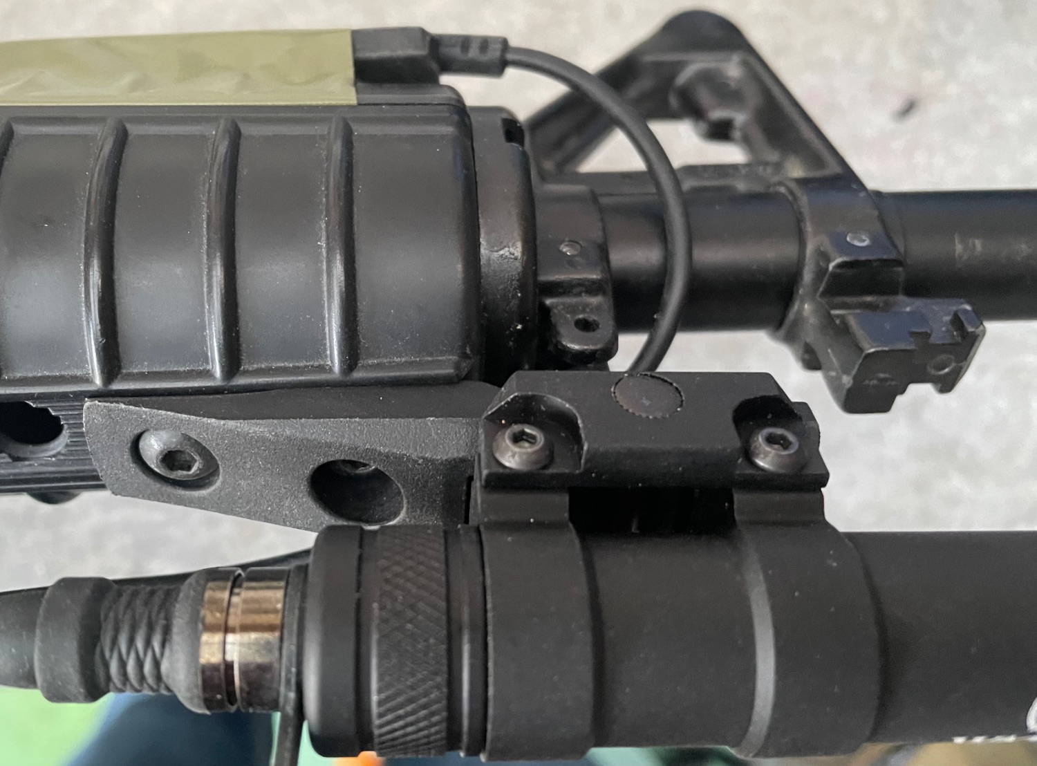

SSPKali Posted February 23, 2023 Posted February 23, 2023 Can’t be bothered to try and make a barrel clamp on RIS fit under the front sight so I trimmed a Polymer Magpul Mlok extended rail to suit ? Clamps through the holes in the fore end and keep the light out the way. If my repro light had threaded holes I could lose the clamp and bolt it directly - might invest in some taps and try threading it. concretesnail and Nick G 2

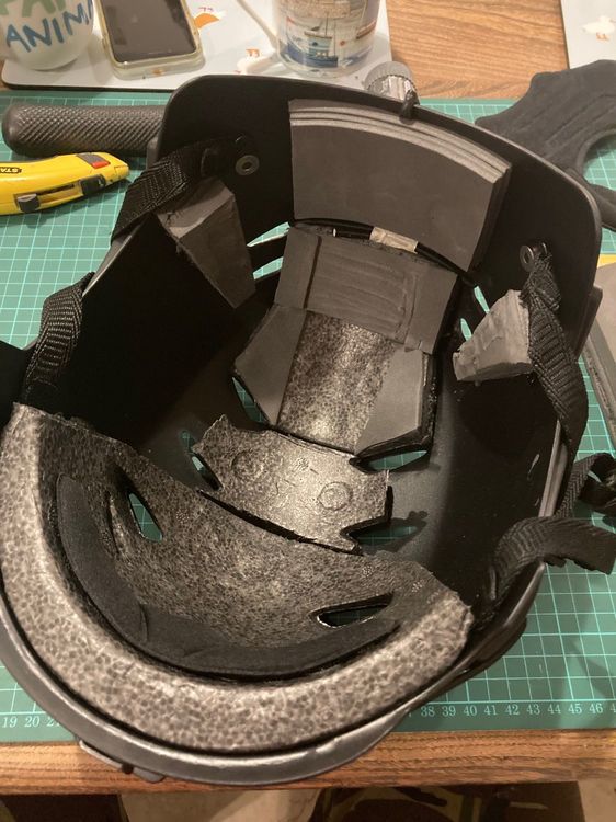

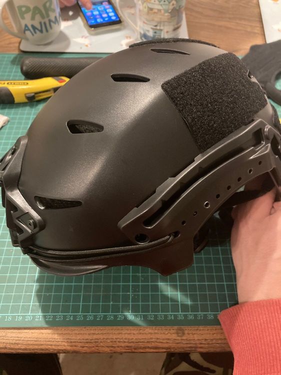

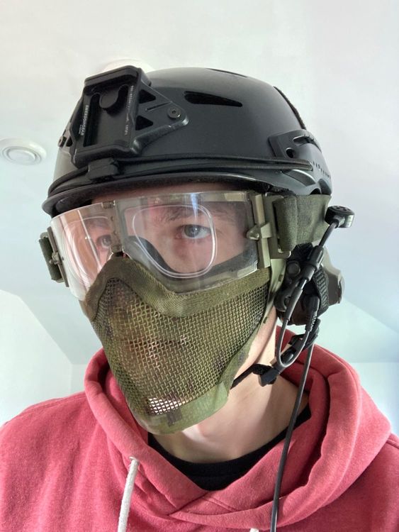

Davegolf Posted March 17, 2023 Posted March 17, 2023 (edited) Bastardised the shit out my £27 Emerson ‘Wendy’ lid so that it actually fits a man head and I can wear my comtac’s inside it, it’s so comfy now! Should be loads of ventilation too. Edited March 19, 2023 by Davegolf
