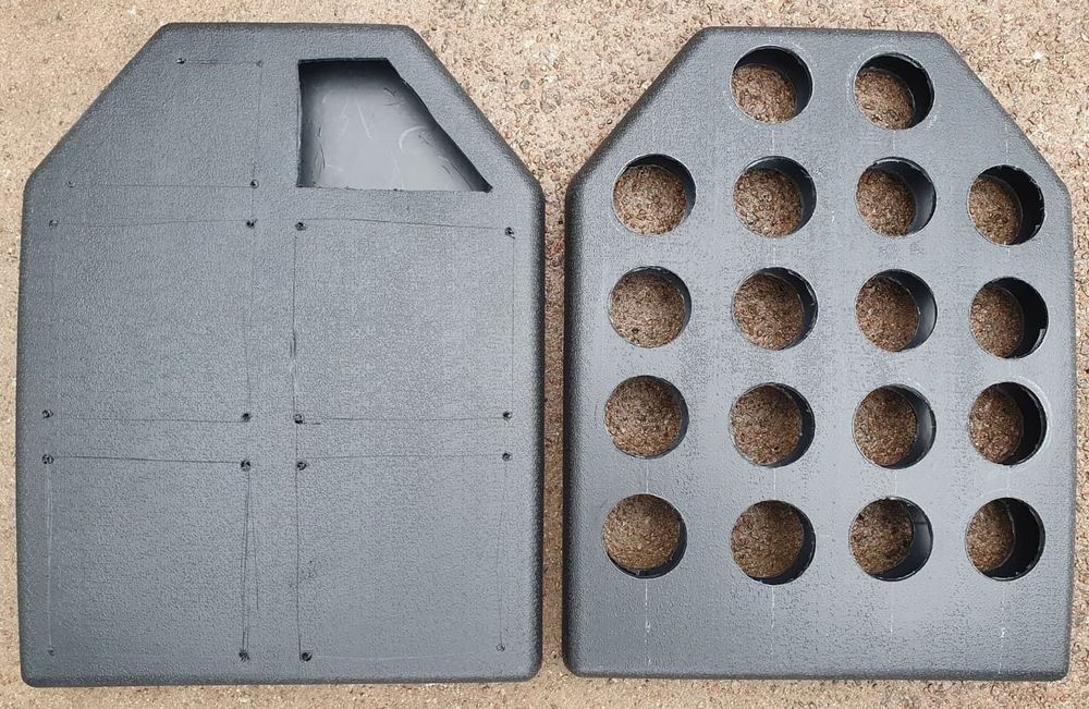

Moderators Tackle Posted December 24, 2021 Moderators Posted December 24, 2021 19 minutes ago, TheFull9 said: I had this plan to put perforated fake plates in a Crye mairitime JPC to make the holy grail of PC that actually wouldn't be very hot/sweaty in summer, so I bought some hollow plastic medium SAPI dummies aaaaages ago and through sheer fuckin laziness I never got around to doing what I wanted with them until this week. Tried just using a knife and mk1 hand first but being about 4mm thick and 'sticky' when cutting I could tell I was going to lose a finger if I proceeded, so I swapped to a holesaw + electric drill. End result has the solid edges/outline needed to fill out any PC and looks exactly like a proper plate when inserted, but it weighs almost nothing and has just enough rigidity in the middle to support everything. I'm already work on a connect-4 meme. Great work, only a matter of time before someone does it with the real steel counterparts to reduce the weight ? TheFull9 and Paul72 2

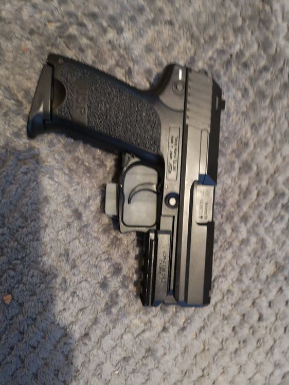

PopRocket123 Posted December 27, 2021 Posted December 27, 2021 The first step to having a working holster for my USP compact so I can use it with the suppressor mount I'm making for it Paul72 and Tackle 2

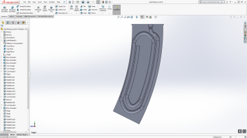

Supporters SeniorSpaz87 Posted December 29, 2021 Supporters Posted December 29, 2021 Working on some ICS Galil midcap inserts. While I use drums in my Galil ARM, I do like to have a trio or so of midcaps alongside my drums in case they go down. Nothing exists for the ICS Galil besides some expensive high caps, and you all know how much I hate tactical maracas. So I figure these $7 (worth of material) inserts combined with a $6 EPM spring will work. Still waiting on an EPM insert to work on the internals, so its just a solid block for now. Paul72, Speedbird_666, TheFull9 and 1 other 4

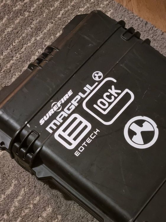

Enid_Puceflange Posted January 8, 2022 Posted January 8, 2022 Bribed my mrs to knock me up a few SAI logo stickers on her Cricut machine What would take me days to figure out, she can knock up in a few minutes! Cant believe I’m so chuffed with a couple of decals for my pistol case ? Tactical Pith Helmet, Druid799 and MAX DICKER 1 2

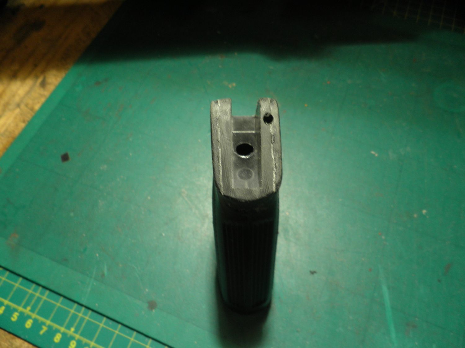

Nick G Posted January 10, 2022 Posted January 10, 2022 (edited) Converted a Storm grip that was for a PTS (I think) to work with a GBBR . Grafted a section of WE M4 grip in . It's for a mate's L119 A1 build and GBBR Storm grips seem to be rather thin on the ground at the mo. Edited January 10, 2022 by Nick G Paul72 1
Supporters SeniorSpaz87 Posted January 12, 2022 Supporters Posted January 12, 2022 So ICS Galil Insert v2 was a partial success. It took BBs, but stopped at about 50 rounds which is far short of what it should take. I think the follower got caught at the base of the first turn. The initial turn to put the BB exit at the center of the mag was too twisting, leading to the follower getting stuck there. The decrease from double stack to single there also was too extreme, meaning BBs would get stuck there. The mags also squished onto my printbed slightly, leading to a slight edge on all edges which may interfere with feeding. So v3 now has a very slight rounding to all edges to counteract that, the insert that the hop unit goes into has been made slightly ovular to allow it to fit the hop easier, the BB pathing has been reworked with gentler curves to help feeding, the double to single area has been massively extended (may cause the mag to not feed the last 5 rounds or so, but thats an issue for future Spaz), and because I could I added about another 3 BB length to the feed tube. v3 is not going to be printed - instead I will begin on v4 which will integrate the 5 clasping bolts, the sole bottom retainer bolt, and the BB retainer and spring slot. v2: v3: Paul72, PopRocket123 and BigStew 3

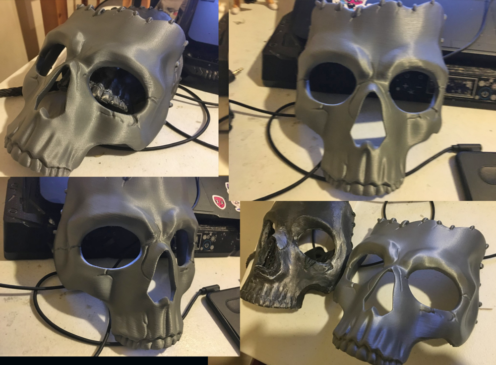

Guest Mr. No_Face Posted January 12, 2022 Posted January 12, 2022 Received the first prototype of my new 3d printed faceplate last week and managed to just about prep it in time for my first game of 2022 last Saturday. Postal delays were insane. I ordered Items 2 weeks in advance that still haven't shown up. Anyway, this mask is PLA material with 100% infil and fibreglass lining on the back. It actually held up pretty well in my game and got positive reactions. Gonna be selling these pretty soon.
Supporters Popular Post SeniorSpaz87 Posted January 17, 2022 Supporters Popular Post Posted January 17, 2022 Well, it took until v7 for all the various issues to be ironed out, but my ICS Galil Midcaps are done for now. They are designed to use PTS EPM springs and followers, as well as 5 M3x14 bolts, 5 M3x0.5 square nuts, the bottom screw and square nut from the high cap, and the spring/retainer arm from the high cap. This particular one holds 104 BBs. I will do a feeding test once I get my Galil back from the shop - should be at least two weeks. To be honest the surplus of bolts is a bit overkill and technically none are needed - the metal high cap shell provides plenty of compression strength and the sole bottom bolt/nut would technically hold the insert in place, but I have like 300 random M3 bolts and nuts from other projects, and this way mag insterts can be kept in one piece outside of the shell, for shipping or should a user ever want to switch back to a highcap. Pappa Large, PopRocket123, Druid799 and 4 others 3 1 3

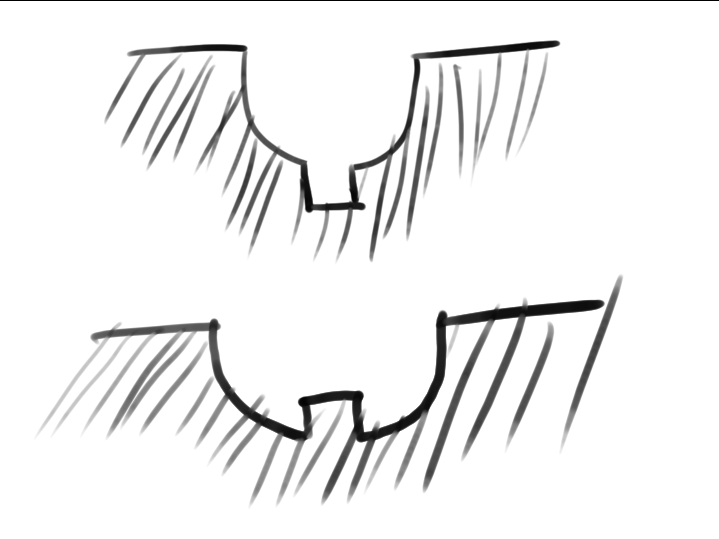

Supporters Samurai Posted January 18, 2022 Supporters Posted January 18, 2022 13 hours ago, SeniorSpaz87 said: ICS Galil Midcaps This is great. I see you printed it on the inside seam facing the bed. I think you should do it the other way. Remove the protruding parts from the side so it can lay flat. The front and back protrusions will still hold it in the shell. This way the ramp will be much cleaner. The spring will probably get stuck in the bends. And/or you could make the path not just a pill shaped in cross section, but add a cutout where there's overhang. The edges will be printing cleaner. What I did, was printing the other side on bed and added a raised part instead to create a small, smooth surface. And also because wu-tang. The compressed spring forces the two sides apart with quite great force and even a small opening can make the BBs stuck. You might even need an other screw in the middle.

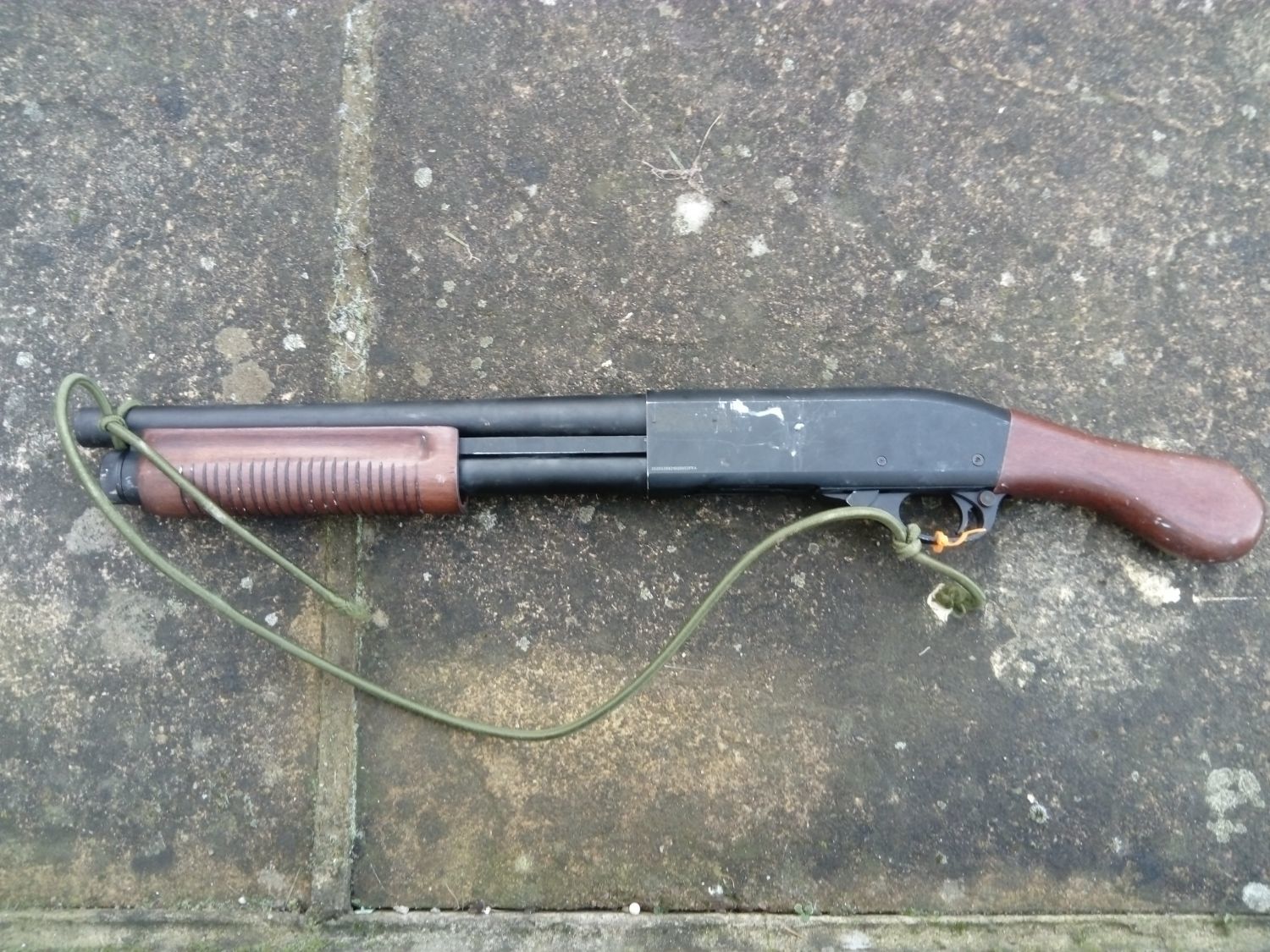

Cannonfodder Posted January 18, 2022 Posted January 18, 2022 Not so much made, as used a simple solution to make a sling for my sawn off which doesn't have sling mounts Druid799 and Paul72 1 1
Supporters SeniorSpaz87 Posted January 18, 2022 Supporters Posted January 18, 2022 7 hours ago, Samurai said: This is great. I see you printed it on the inside seam facing the bed. I think you should do it the other way. Remove the protruding parts from the side so it can lay flat. The front and back protrusions will still hold it in the shell. This way the ramp will be much cleaner. The spring will probably get stuck in the bends. And/or you could make the path not just a pill shaped in cross section, but add a cutout where there's overhang. The edges will be printing cleaner. What I did, was printing the other side on bed and added a raised part instead to create a small, smooth surface. And also because wu-tang. The compressed spring forces the two sides apart with quite great force and even a small opening can make the BBs stuck. You might even need an other screw in the middle. Maybe. It does actually have a small flat section in the path. So far there is no catching of the spring. There already are 5 bolts in there, and it so far holds up from the spring with just 2, so with all 5 in it should be good. If I start seeing failures where you mention then I may change that. I have also had serious issues with prints with that much contact with my printbed. V1 was basically a solid block to get the fit right, and I ended having to print it with the top of the mag down after a half-dozen failed prints trying to print it side-down. If someone wants to test the print on that side I can easily send you a modified file, but on my Prusa mk3S I am yet to have that style of print succeed. Samurai 1

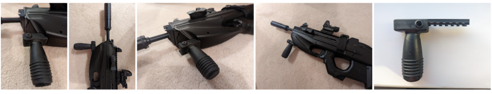

Popular Post RostokMcSpoons Posted January 20, 2022 Popular Post Posted January 20, 2022 (edited) They said it couldn't be done.... ('They' being the voices in my head) After a lot of prep work looking at the inside and outside of the handguard, and looking at various bits of RIS rail on sale (before settling on one of the simplest ones), I've finally managed to bodge engineer my stubby grip onto my F2000, as per my Battlefield 4 in-game loadout. (I couldn't find a tri-rail that I thought would look the same and that I could actually fit, so had to go for a single rail... but I still wanted the 'hanging off the front of the gun' look) I'm sort of blowing my own trumpet, perhaps a small one, such as the type often found in Christmas crackers... but it really isn't bodged, it feels absolutely damn solid. In fact it was so solid that after all the work I did carving out plastic and getting everything 'just so', it actually felt good-to-go without any of the screws and bolts and washers and plates I expected to put in. I put most of them in anyway and now I can pick up the gun by the front grip without any undue concern. I wouldn't want to fall on it, or do anything too drastic, but... very pleased with it. Inside the handguard are a couple of chunks of wood which help locate the RIS against some of the internal ribs which I cut / Dremel appropriately. They're screwed into the handguard. There's a bolt through the rail and the one of the chunks through to the top of the handguard. I actually just used a craft knife to remove most of the plastic, my cheapo Dremel looky-likey just didn't cut it. Ha ha. Ho ho... I'm here all week. Edited January 20, 2022 by RostokMcSpoons Bf4 pic added Rogerborg, PopRocket123, Paul72 and 2 others 5
