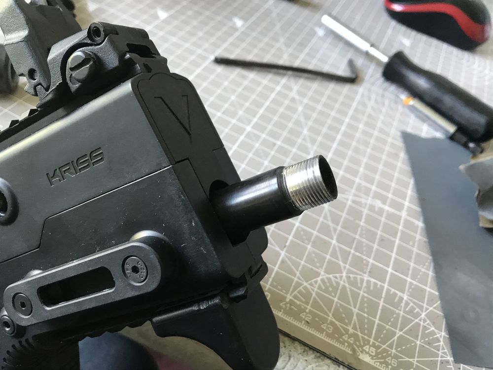

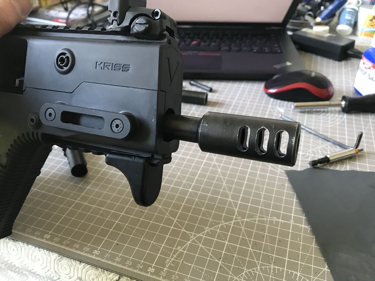

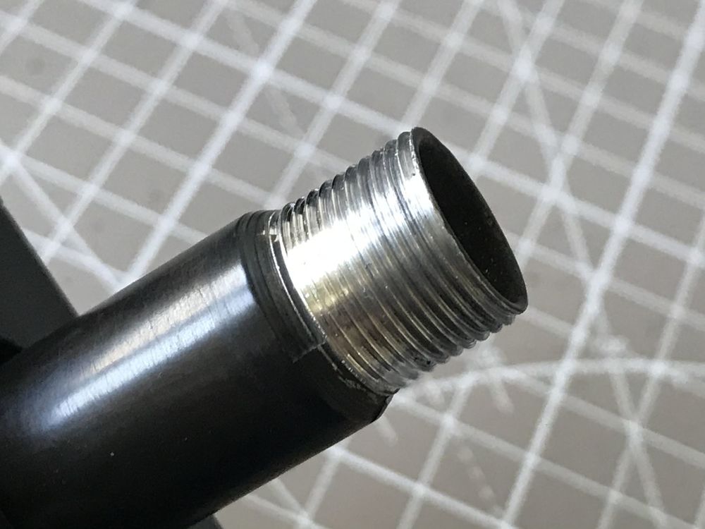

Guest Posted April 20, 2020 Posted April 20, 2020 A tiny thing for lockdown boredom. I got fed up with using an adapter, so I cut a 14mm ccw thread on my KWA Vector. It’s normally 16mm c/w

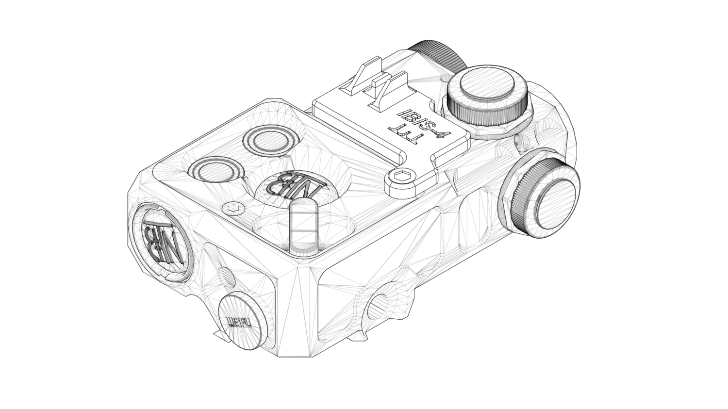

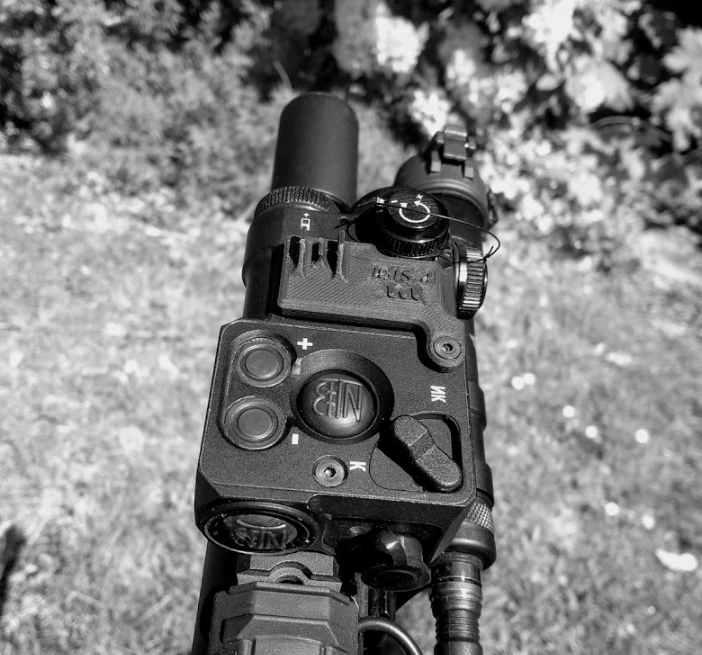

Popular Post Lasbrisas17 Posted May 3, 2020 Popular Post Posted May 3, 2020 Developing an integrated backup iron sight (IBIS) for the zenitco Perst-4 device: First print (still WIP): BigBell1987, clumpyedge, L3wisD and 4 others 6 1

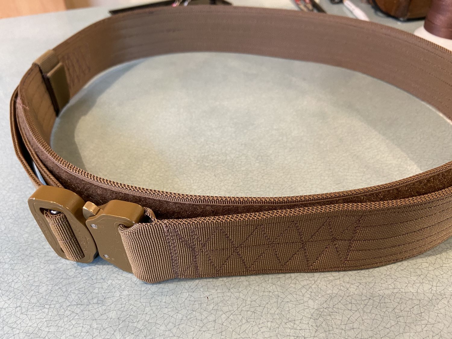

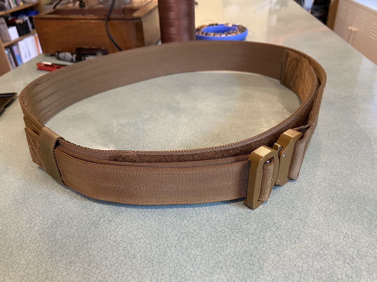

Ropeyshep Posted May 8, 2020 Posted May 8, 2020 Just knocked up a new belt, thicker and stiffer than I’d normally make, used three layers of webbing for the main belt, meant there were five layers to attach the adjuster webbing, that’s a workout for the machine. Also added Velcro which is a new one for me, hoping it helps with the rotational stiffness. Barny, Skara, Enid_Puceflange and 1 other 4
Skara Posted May 8, 2020 Posted May 8, 2020 Nice, although you could have gone for a 2 belt system, one inner lined with male velcro and one outer (2 layers) with female. Just like the FRV one. This way you can still use the outer belt as a standalone (female velcro is the loop one, so it doesn't shred your clothing) and there will be zero rotation as the whole system grips on your trousers belt loops
Ropeyshep Posted May 8, 2020 Posted May 8, 2020 Yeah, I know the type. I prefer single belts, the tendency for single layer inner belts to roll and the finicky lining up of the two layers has always kept me from making them. Also, although I’d never recommend it (I even actively discourage it), the slim possibility of a belt having to be body weight bearing always makes me use the strongest construction possible. I learn to live with having to thread/rethread fairly regularly. Makes me much more focussed on what goes where and why. That’s also why I use the 38mm buckle, it’s the same height as the 2” webbing so the whole belt works in the same belt loops.

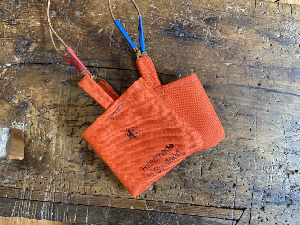

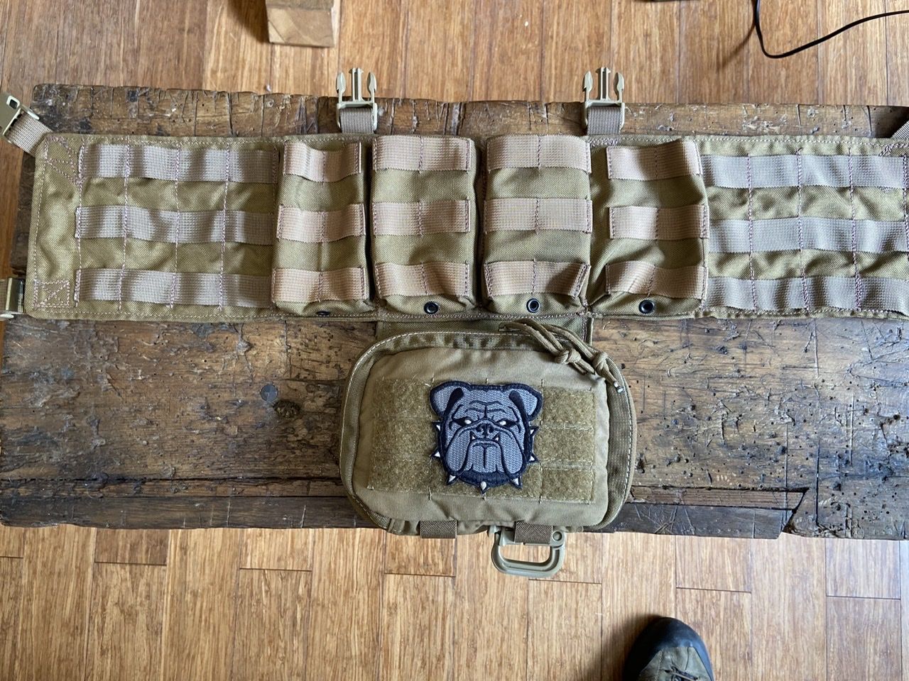

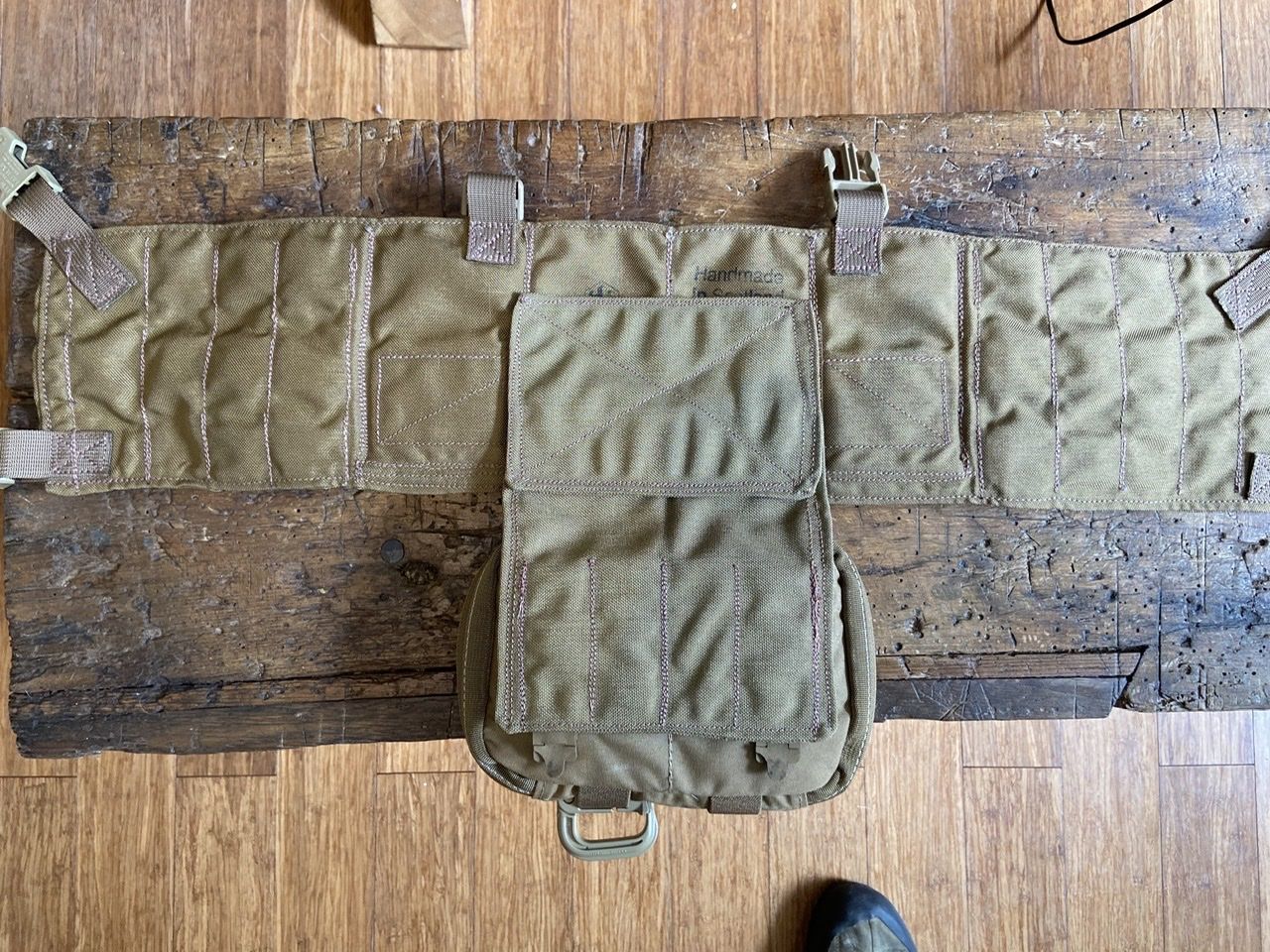

Ropeyshep Posted July 7, 2020 Posted July 7, 2020 Made a little dropper panel so I can move my admin pouch down, makes the front of my chest rig a little cleaner. 2” Velcro at the top, three rows of PALs at the bottom. Also a couple of very hi-viz muzzle covers. Tackle and BigBell1987 1 1

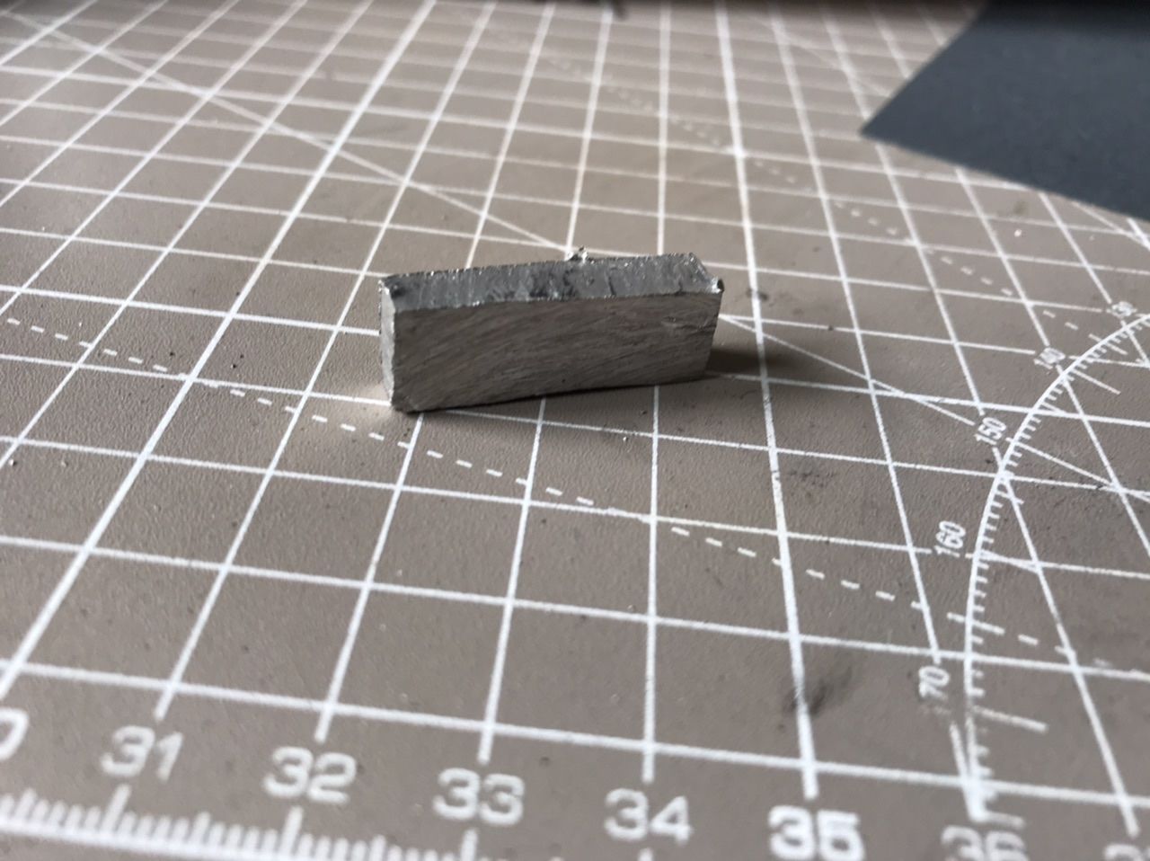

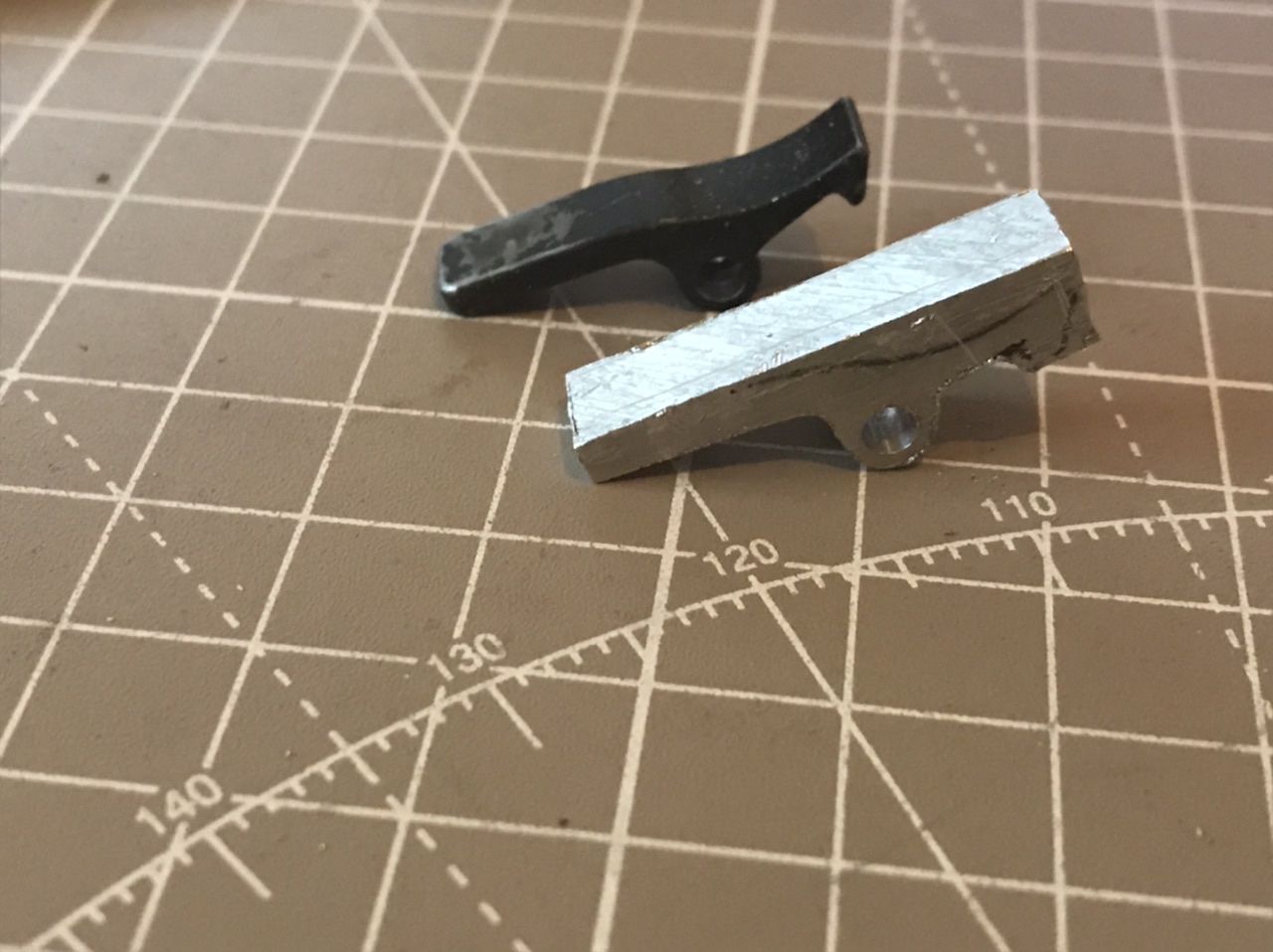

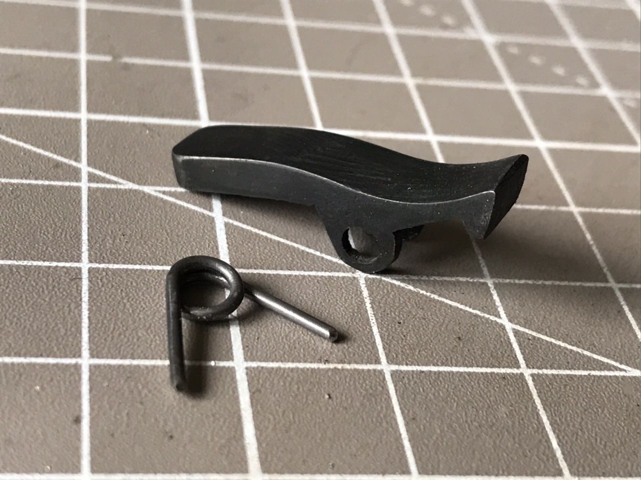

Guest Posted July 8, 2020 Posted July 8, 2020 I made another rear catch for an FPG, being billet it’s loads stronger than the nasty cast pot metal one

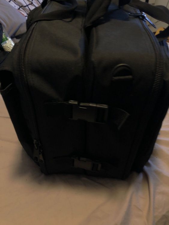

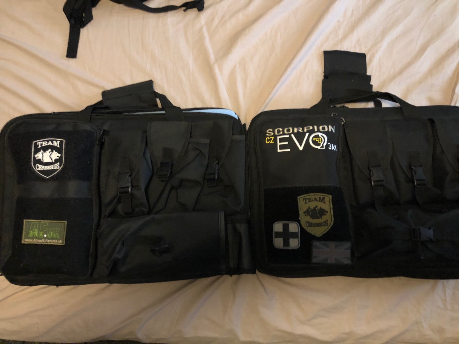

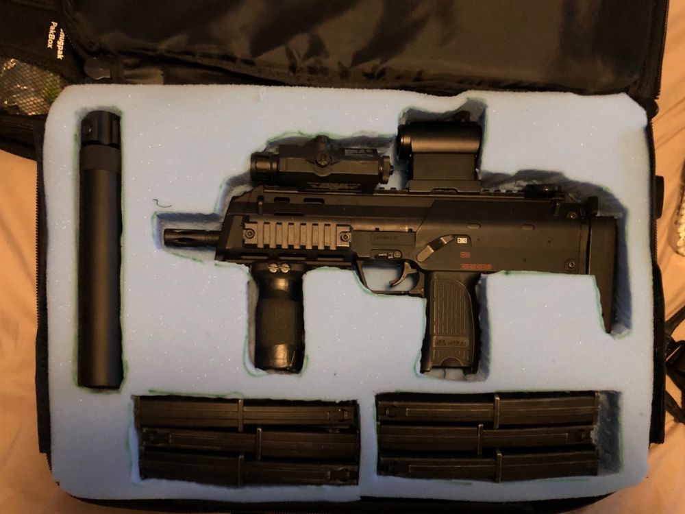

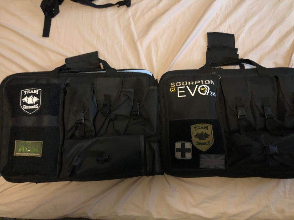

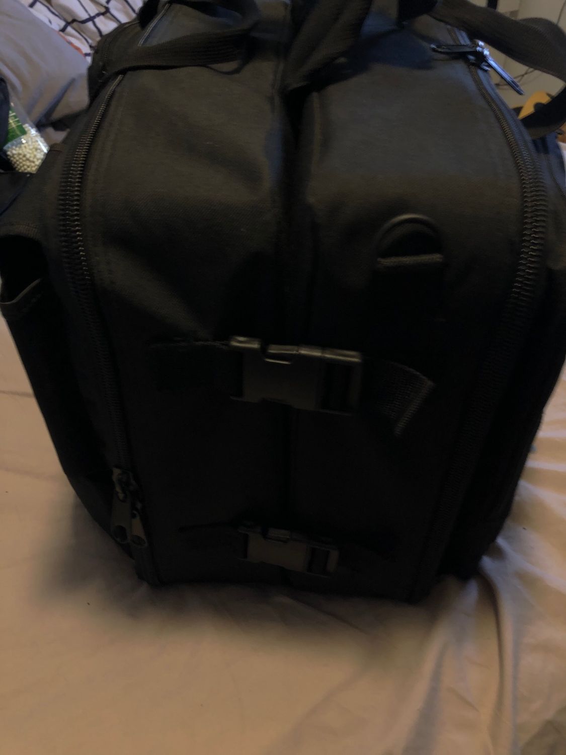

Albiscuit Posted September 18, 2020 Posted September 18, 2020 A friend of mine done a thing, not a bad thing but a good thing. This thing was done for me too so it’s a bloody good thing!! We both have Scorpion Evos and the carry case and love the bags for their versatility and pouches on the front so I bought one for my TM MP7. I was talking about how cool it would be to be able to attach them together so he took both my bags and added straps on the side so I can clip them together to make it easier to carry. he also added a shoulder strap, a stronger carry handle to be able to carry both as once and even a velcro panel over the scorpion branding. I can’t wait to use them, I have managed to get all of my skirmish gear in both bags to make things so much easier on a game day. excuse the crappy pics PopRocket123 and strykerles 2

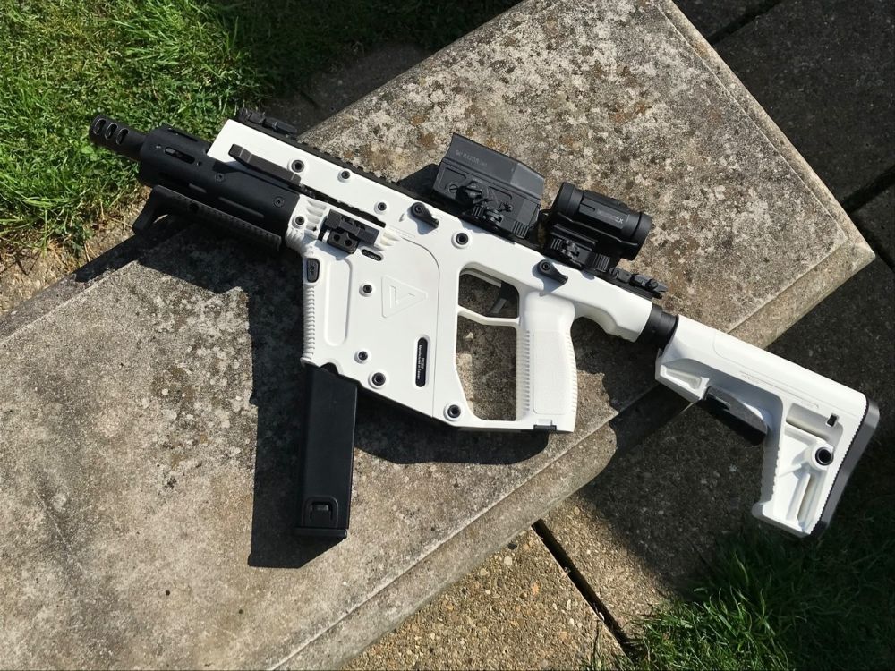

Guest Posted September 18, 2020 Posted September 18, 2020 I built another KWA Vector into Krytac Alpine receivers

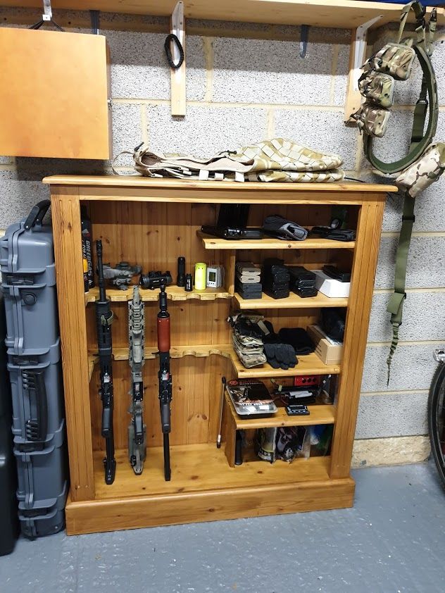

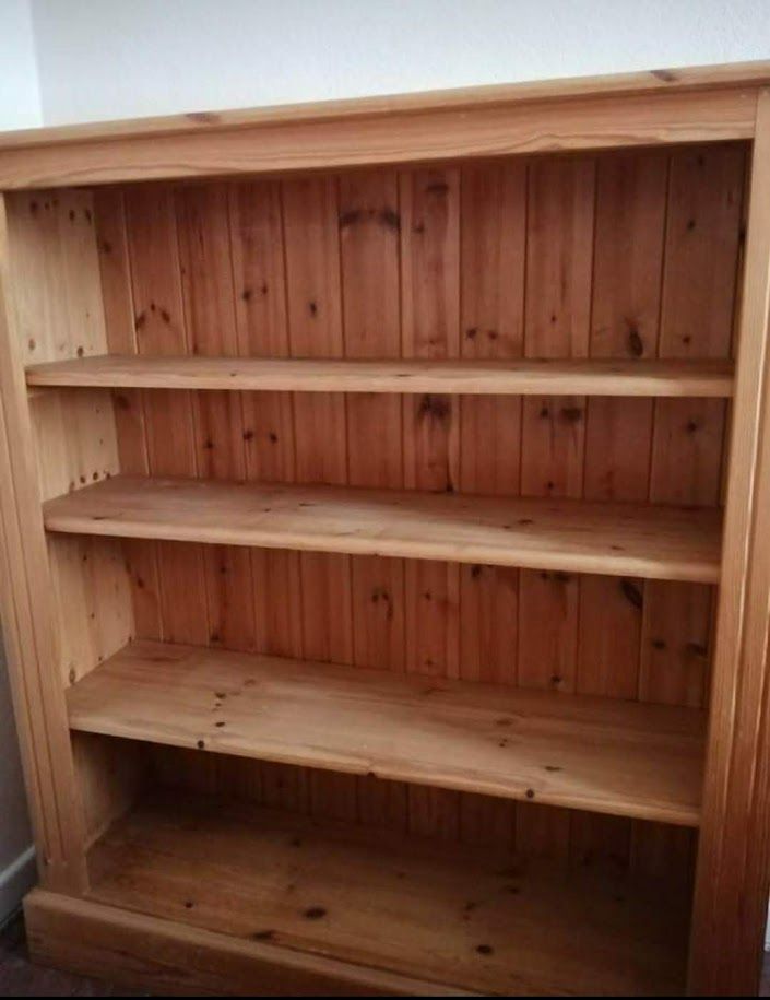

Popular Post SilentSparky Posted September 21, 2020 Popular Post Posted September 21, 2020 My "stuff" was getting everywhere, so I picked up a cheap secondhand bookcase and turned it into a Airsoft storage unit ? Adolf Hamster, Rogerborg, GothicGhost and 14 others 7 10

Shamal Posted November 15, 2020 Posted November 15, 2020 On 21/09/2020 at 08:31, SilentSparky said: My "stuff" was getting everywhere, so I picked up a cheap secondhand bookcase and turned it into a Airsoft storage unit ? Niiice job! See you have future proofed it with extra two rifle spaces. ?? Regards

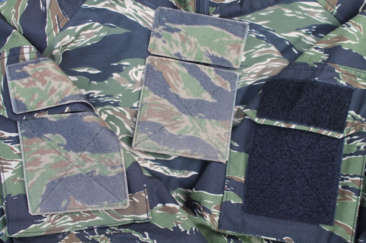

Supporters TheFull9 Posted November 19, 2020 Supporters Posted November 19, 2020 Not my work but I've had a few of these made in different camos over the past couple of years. Have been talking with a couple of different companies, hopefully within a few months they'll actually be available and in just about every camo that you can get gear made in. magaz 1

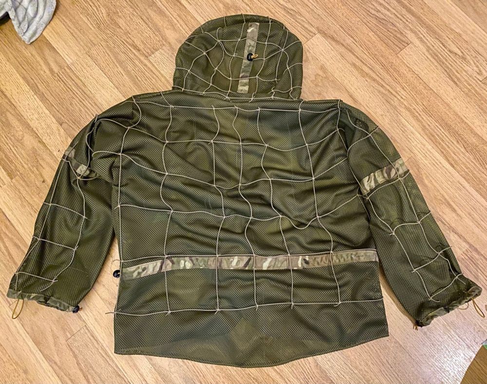

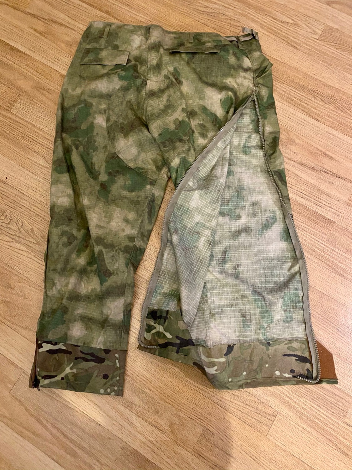

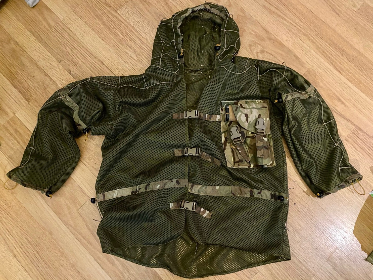

Danger_MouseUK Posted November 25, 2020 Posted November 25, 2020 Here is a ghille suit base I'm currently working on. I need to add some mag pouches for my M40a3, and possibly a small GP pouch to the top, and I need to put some knee padding the shock cord grid and some braces on the trousers. I can't decided wether or not to put pockets on the back of the thighs on the trousers or not. Then I can start ghillieing it up. *** WARNING *** Anyone who has an affliction against mixing cameo should not scroll down. I'm not buying A-TACS 500d nylon for the small bits I need, and I already had the Multicam.

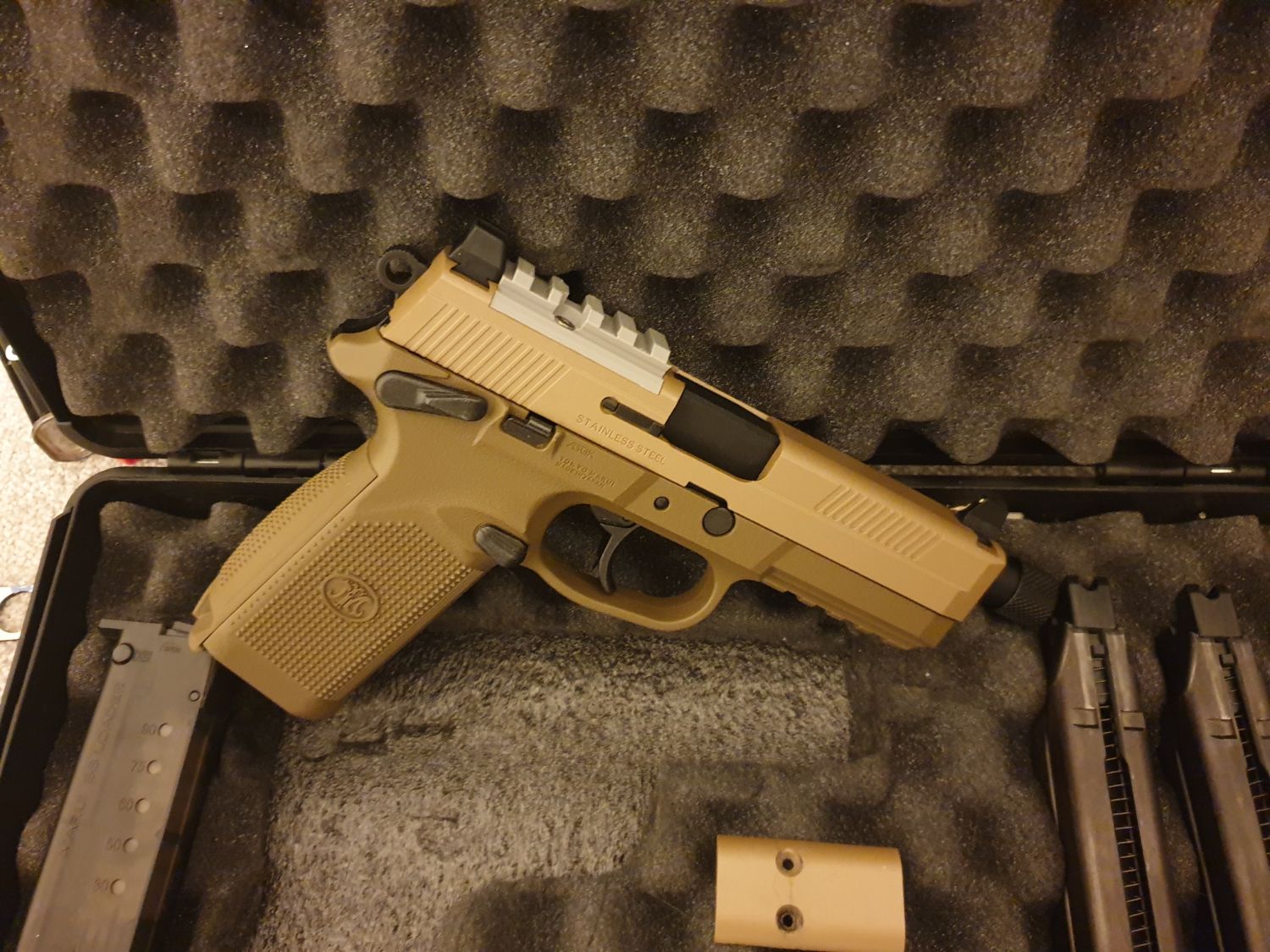

Heath Posted January 2, 2021 Posted January 2, 2021 I've designed and 3D printed a rail for my FNX-45, with the plan to do a low-profile plate adapter if I ever get round to ordering a cheap red dot that includes one. More tweaking to follow to make it more low-profile. TheFull9, Albiscuit and PopRocket123 3

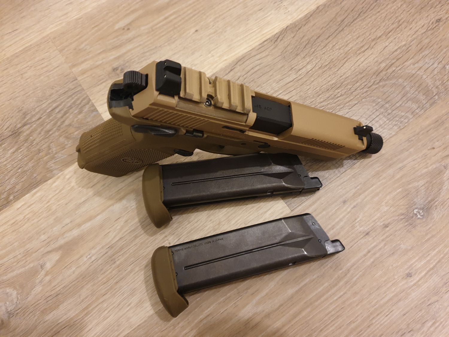

Heath Posted January 12, 2021 Posted January 12, 2021 Latest rail version printed in bronze gold. Not a perfect match, but close enough to the lower frame. PopRocket123, Spartan873 and B4by_Dr1v3r 1 2
