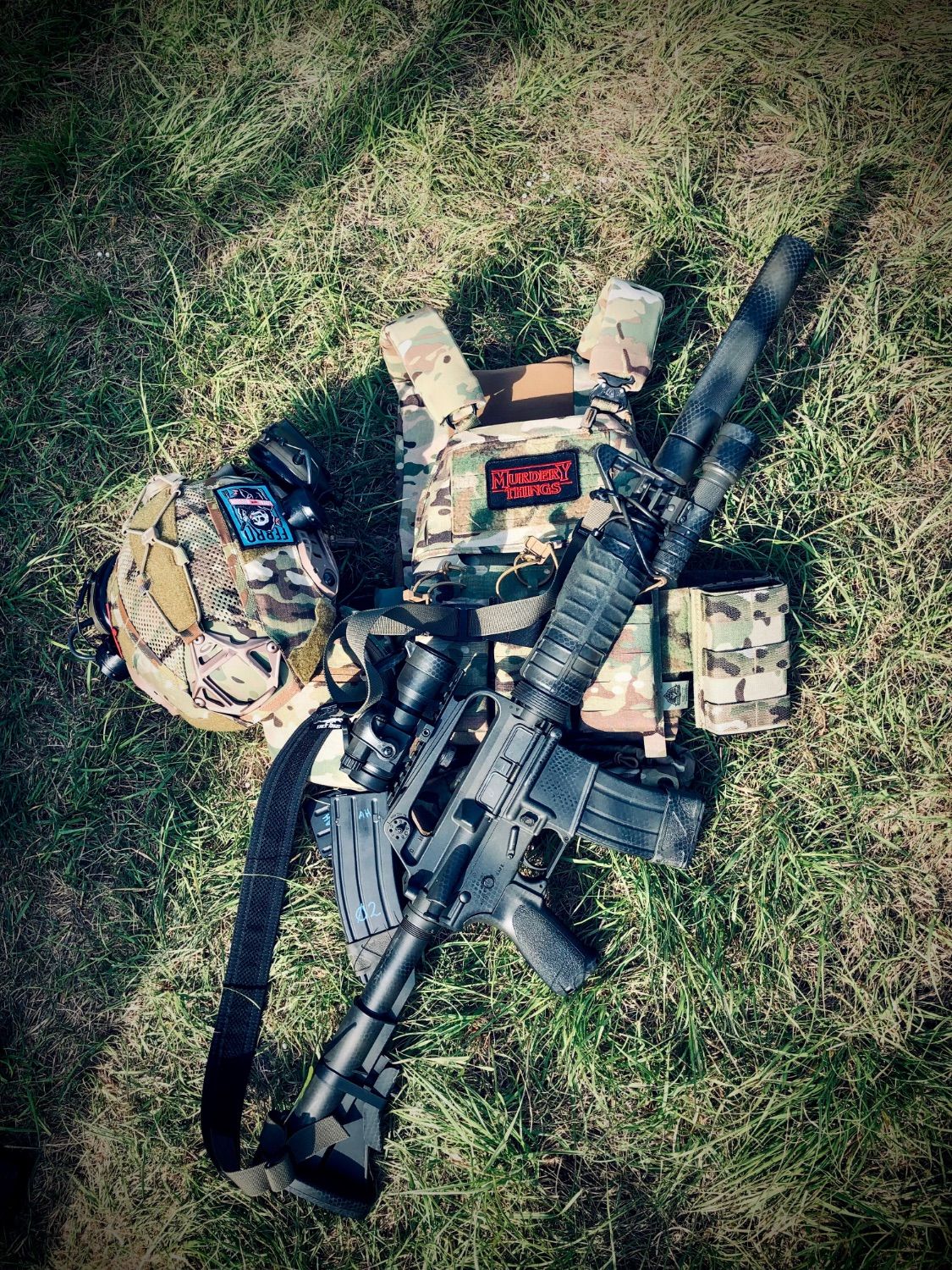

Popular Post alxndrhll Posted May 2, 2022 Popular Post Posted May 2, 2022 (edited) Chopped and changed a lot over the last year or so, but I strongly suspect this’ll be my MWS from here on out. Only thing I’ll be changing is the Aimpoint mount to something a bit more fit for purpose. Internally just had the standard Supernub and HSB, have an npas to sling in at some point. Edited May 2, 2022 by alxndrhll Captain Darling, MAX DICKER, C-Diddy and 6 others 4 5

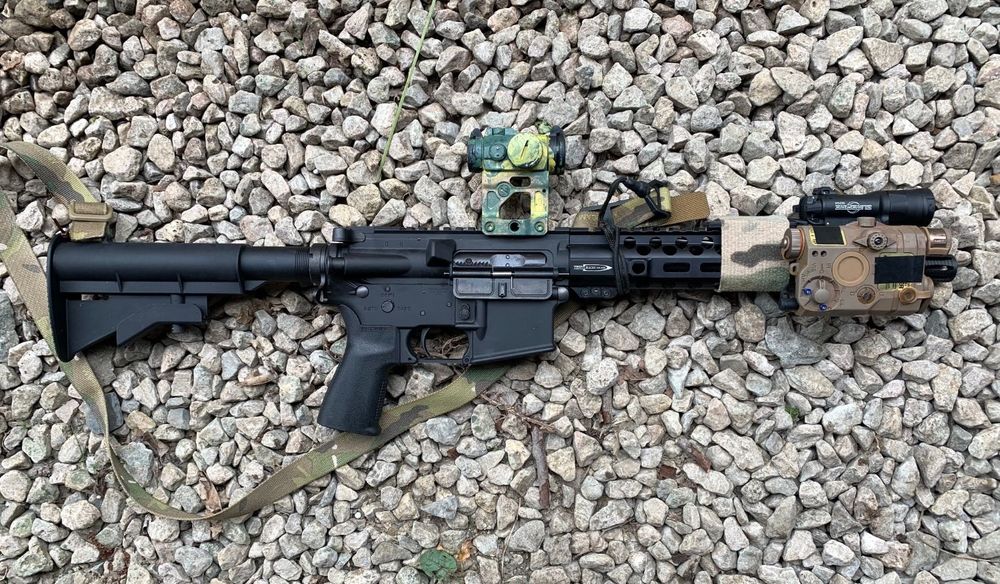

Wavey_Gravey Posted May 2, 2022 Posted May 2, 2022 Mine, although I’m not sure how much longer it will be mine…baby number 2 due this year! T2 and mount are being swapped for a scalarworks when it arrives. JimFromHorsham and Jacob Wright 1 1
