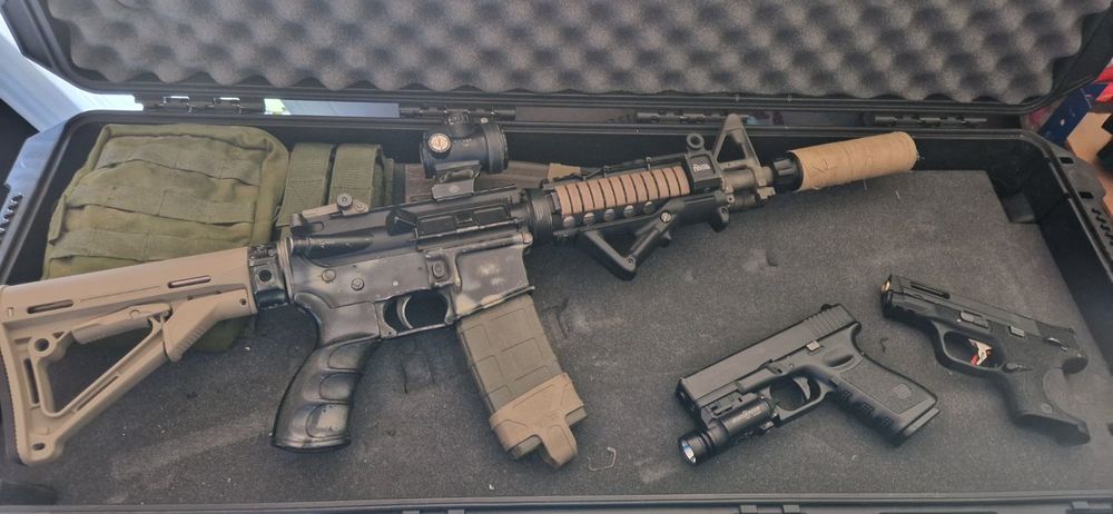

BigStew Posted April 8, 2023 Posted April 8, 2023 John Wick-ish set up Nick G, Stillers80 and Pinovic 3

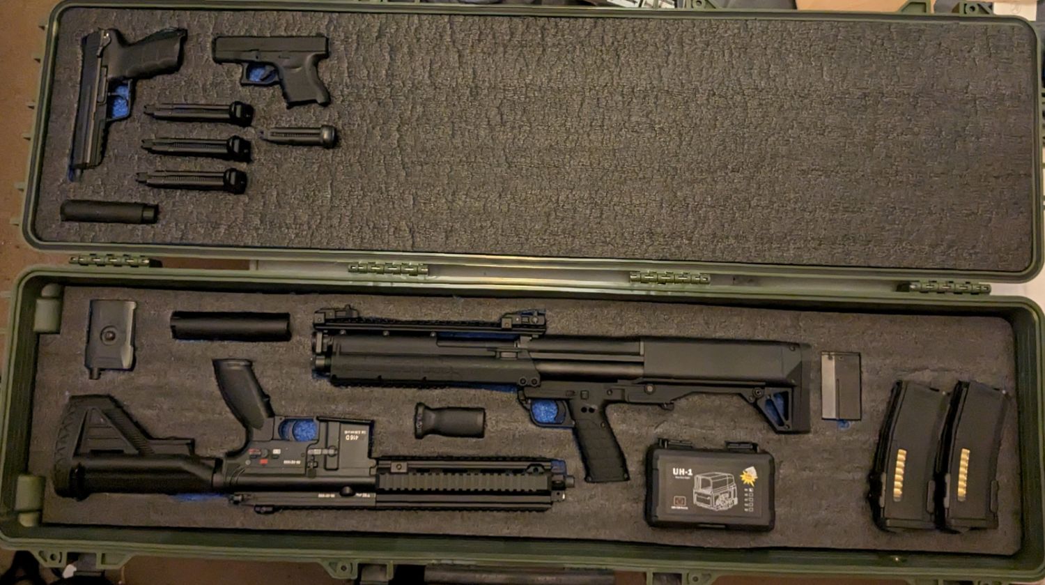

Popular Post Enid_Puceflange Posted April 11, 2023 Popular Post Posted April 11, 2023 Recent (last month) arrival Still trying to figure out my favourite set up for it Skullchewer, JimFromHorsham, Jacob Wright and 4 others 6 1

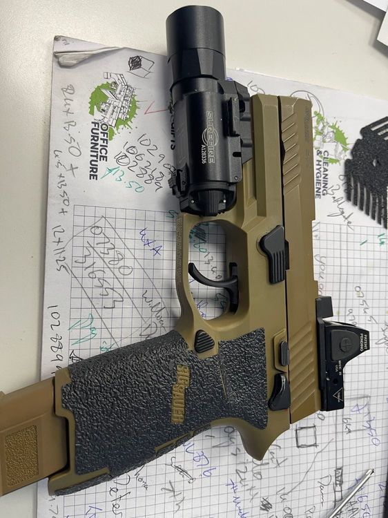

Superkoochy Posted April 14, 2023 Posted April 14, 2023 My very recently purchased M18 with clone X300U, M17 extended mag, RMR and Talon Grips (I’ve also ordered some Talon Material to make the cut outs in the mag match the grip) Jacob Wright, Mantle, lokkers and 1 other 2 2
Supporters Lozart Posted April 14, 2023 Supporters Posted April 14, 2023 4 minutes ago, Superkoochy said: My very recently purchased M18 with clone X300U, M17 extended mag, RMR and Talon Grips (I’ve also ordered some Talon Material to make the cut outs in the mag match the grip) I'd be very interested to hear how it performs.

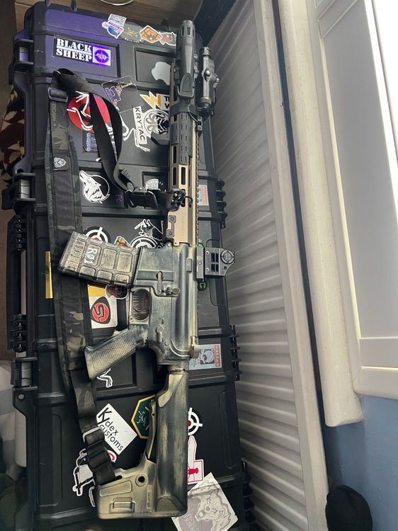

Regx Posted April 14, 2023 Posted April 14, 2023 Not fully complete yet. But almost there. My 14.5 JustMark, Wavey_Gravey, Lozart and 1 other 3 1

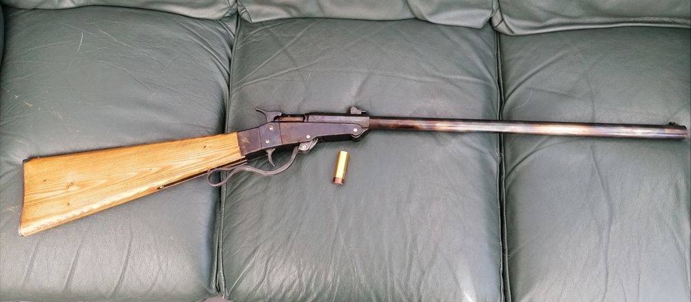

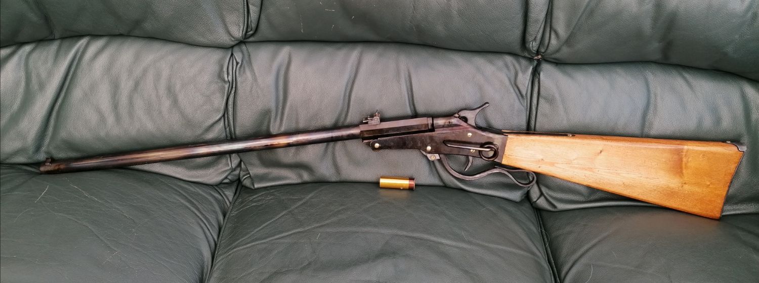

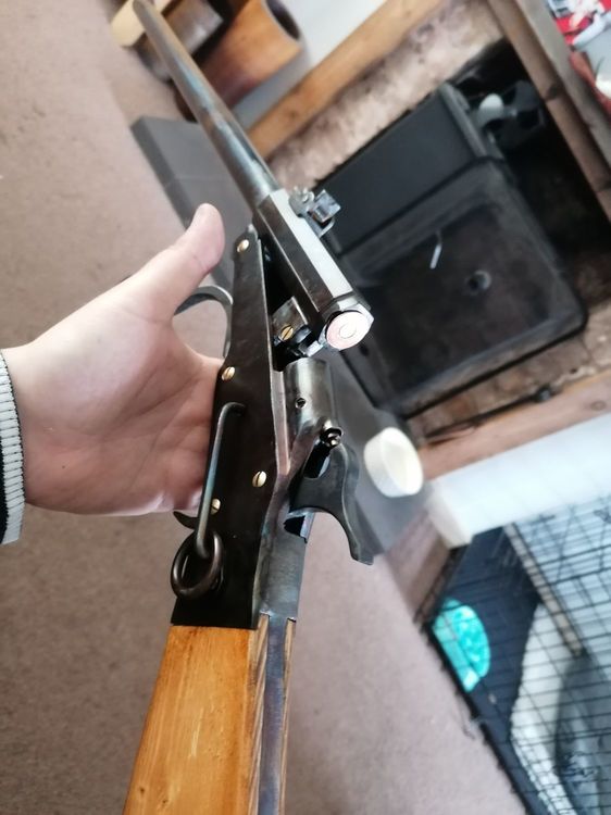

Popular Post Pupa2794 Posted April 16, 2023 Popular Post Posted April 16, 2023 Scratch build Maynard rifle built from steel. Fires madbull shells. Real thing was a civil war breech loaded rifle used by the confederacy. Heat and oil blued. Nick G, Pinovic, TheFull9 and 4 others 2 5

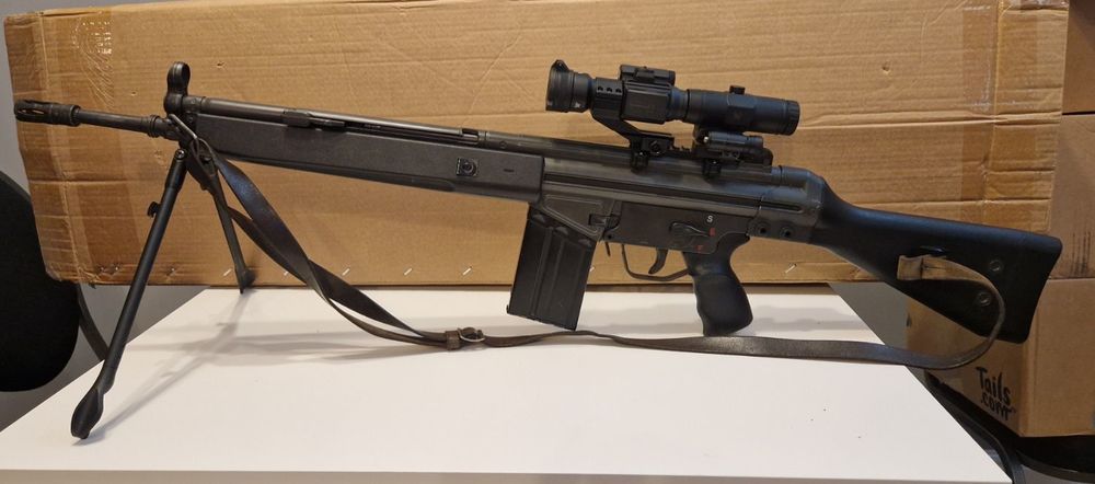

TipsyDiver Posted April 16, 2023 Posted April 16, 2023 Finally got my first proper gun ( other than glock converted with roni kit ^^ ) HK33 by LCT EBB Steel throughout, heavy, chunky, you literally do not need any ammo to kill with it xD, however right out of the box was rather disappointing so I got some parts and sat down on it this weekend. Changed parts: Hopup chamber maxx models Piston head double oring maxx models Cylinder head double oring maxx models Nozzle double oring maxx models 6.02 590mm barrel maple leaf Rubber Super macaroon 60* maple leaf M120 non-linear spring prometheus I am running it with gate aster v2 SE and 11.1 LiPo 3 cell. It works way better than before, all fits well but I am still not happy with fps, as I am using it as DMR I want as close to 450 with .02 as possible. Currently 350 with .28 :(((( I am waiting for stainless steel cylinder from maxx and warhead brushless motor and will experiment with PDI spring 260%. Any ideas how to increase range and accuracy are very, very welcomed Mantle, BigStew, Baptimus_Prime and 1 other 4

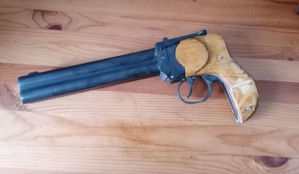

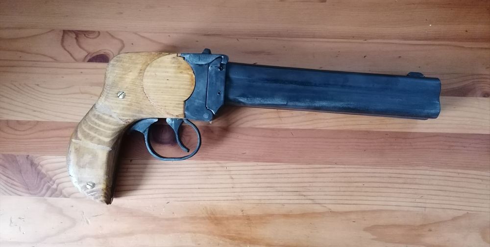

Pupa2794 Posted April 16, 2023 Posted April 16, 2023 Below is a WIP Lancaster 577 howdah for cassieopia shells. Though it may end up as a blank firer.

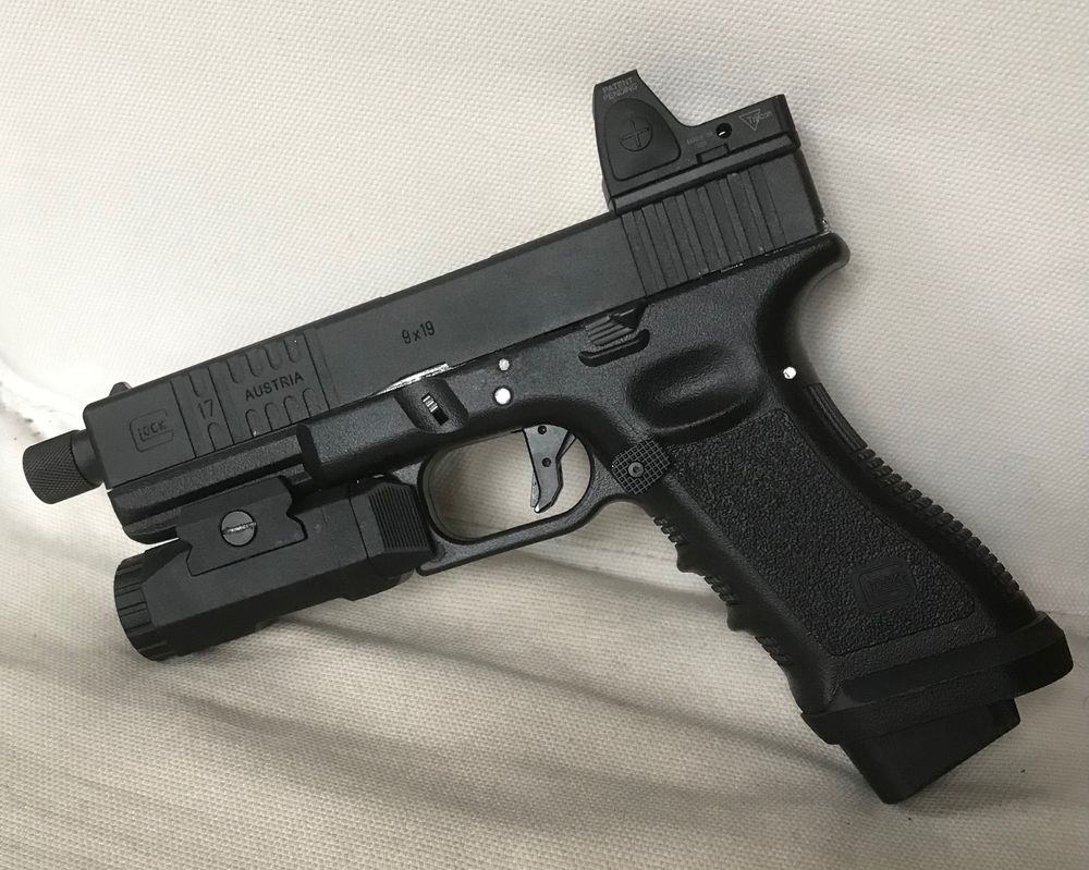

Supporters sp00n Posted April 16, 2023 Supporters Posted April 16, 2023 On 08/04/2023 at 12:22, MILITATED said: Strike Industries TM MWS completed(?) Might experiment with a small red dot or something, but I can't see it changing much more than that. Started in March last year! Time flies. Love how it turned out. To match, also built a Strike Industries TM G17 (decided to not go with the EMG/G&P prebuilt one in the end). Waiting on a nicer red dot to arrive, but God knows when that will be. Make quite a nice pair! dam that pistol rocks, would love to know the full build parts etc ? MILITATED 1
MILITATED Posted April 17, 2023 Posted April 17, 2023 (edited) On 16/04/2023 at 20:29, sp00n said: dam that pistol rocks, would love to know the full build parts etc ? Thanks! It is a TM G17 Gen 3 base, currently stock internals. - GKTactical ARK 17 slide for TM G17 - EMG Strike Industries P80 lower frame for TM G17 Gen 3 - JDG Floyds magazine extension pad (increases gas/bb capacity) - Aliexpress special SI Mass Driver compensator and recoil rod/stronger spring (attaches to the recoil rod like the real one, whereas the EMG/G&P prebuilt is attached to the barrel threads) - Crappy red dot that has now been replaced - Forgot the trigger but pretty generic - SOTAC(?) clone Inforce APL On 09/04/2023 at 08:00, Davegolf said: The MWS came out nice! Is the G17 a Gen 3 or 4 base? Thank you! G17 Gen 3 as a base. Just got a Dytac SLR MWS kit too, but I am also feeling for a normal MWS, so not sure if I'll keep it On 11/04/2023 at 12:18, Skullchewer said: Dear Zod, man, those are absolutely BEAUTIFUL! Good work! Cheers, appreciate it ? Edited April 17, 2023 by MILITATED sp00n 1
