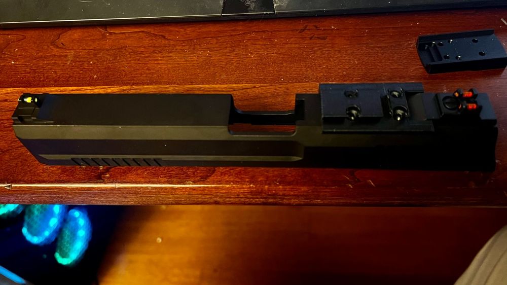

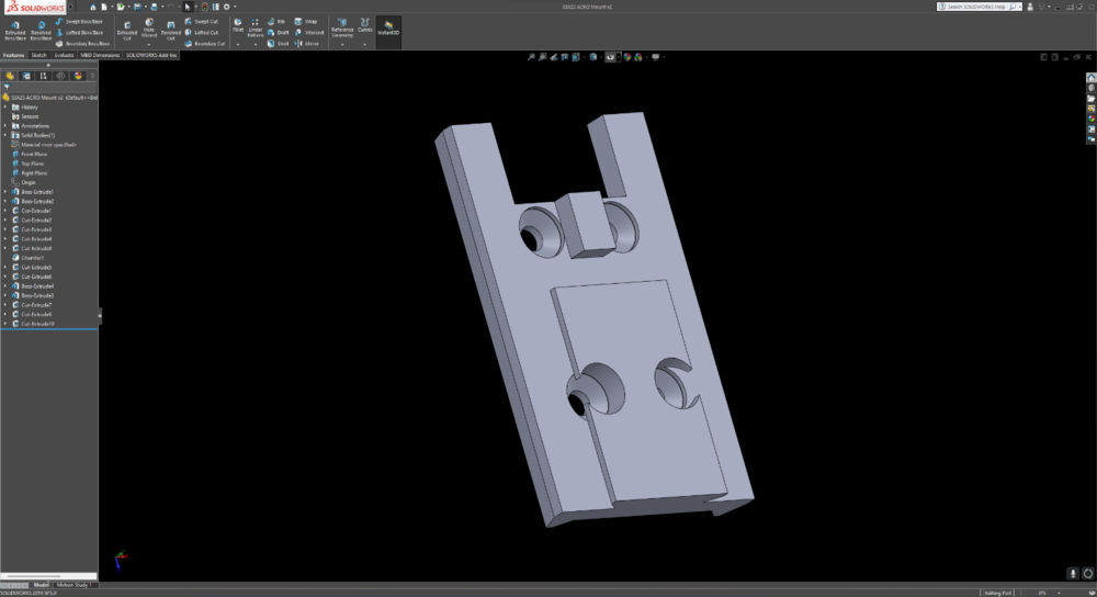

Supporters SeniorSpaz87 Posted March 19, 2023 Supporters Posted March 19, 2023 So Im finally remaking my hybrid mk23 after mine was stolen last year. Building pretty much the same gun but doing some modernization to it. One of those things is the replacement of the Novritsch optics rail and replica Trijicon SRO with a custom mount and a replica Aimpoint ACRO P-2. Only took two versions to get the finished project. I printed it vertically so the layer lines wouldn't cause any sheering breaks due to pressure put on the optic. Pics are of v1, while the screenshot is v2 - its currently printing. Nick G 1

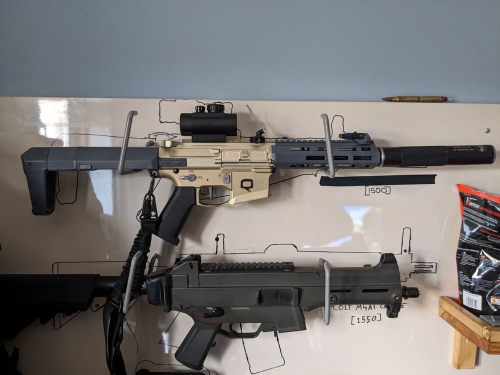

Krisz Posted March 19, 2023 Posted March 19, 2023 Spent a few days to find a solution and closest one was 200 pound wall unit which you can see it in shops so I said fuck it I will build my own. Ordered some pegboards from ikea and liberated some timber from my workplace. I don't know how stable is I may die in my sleep when it falls apart. ? Barny, Jaylordofwaargh and Pappa Large 3

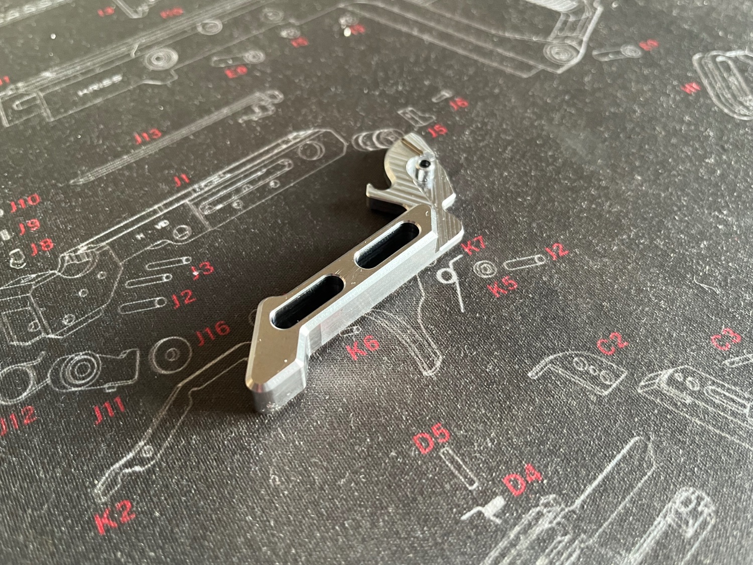

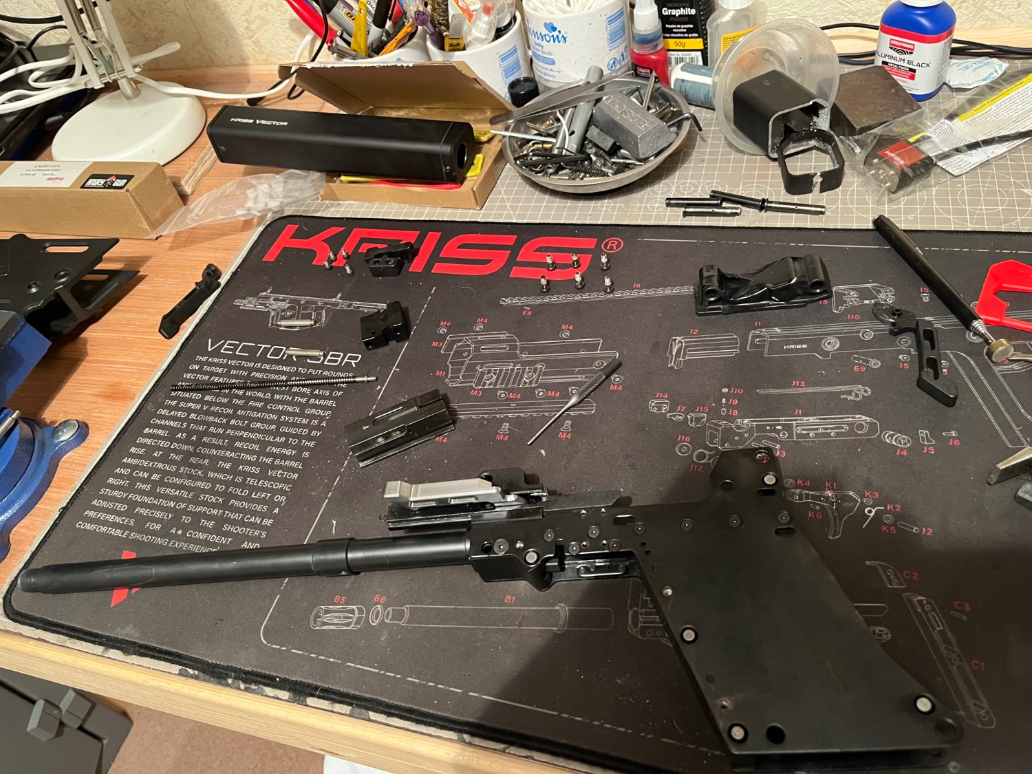

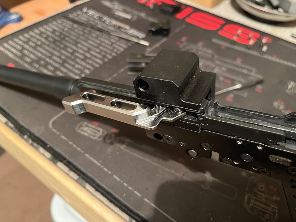

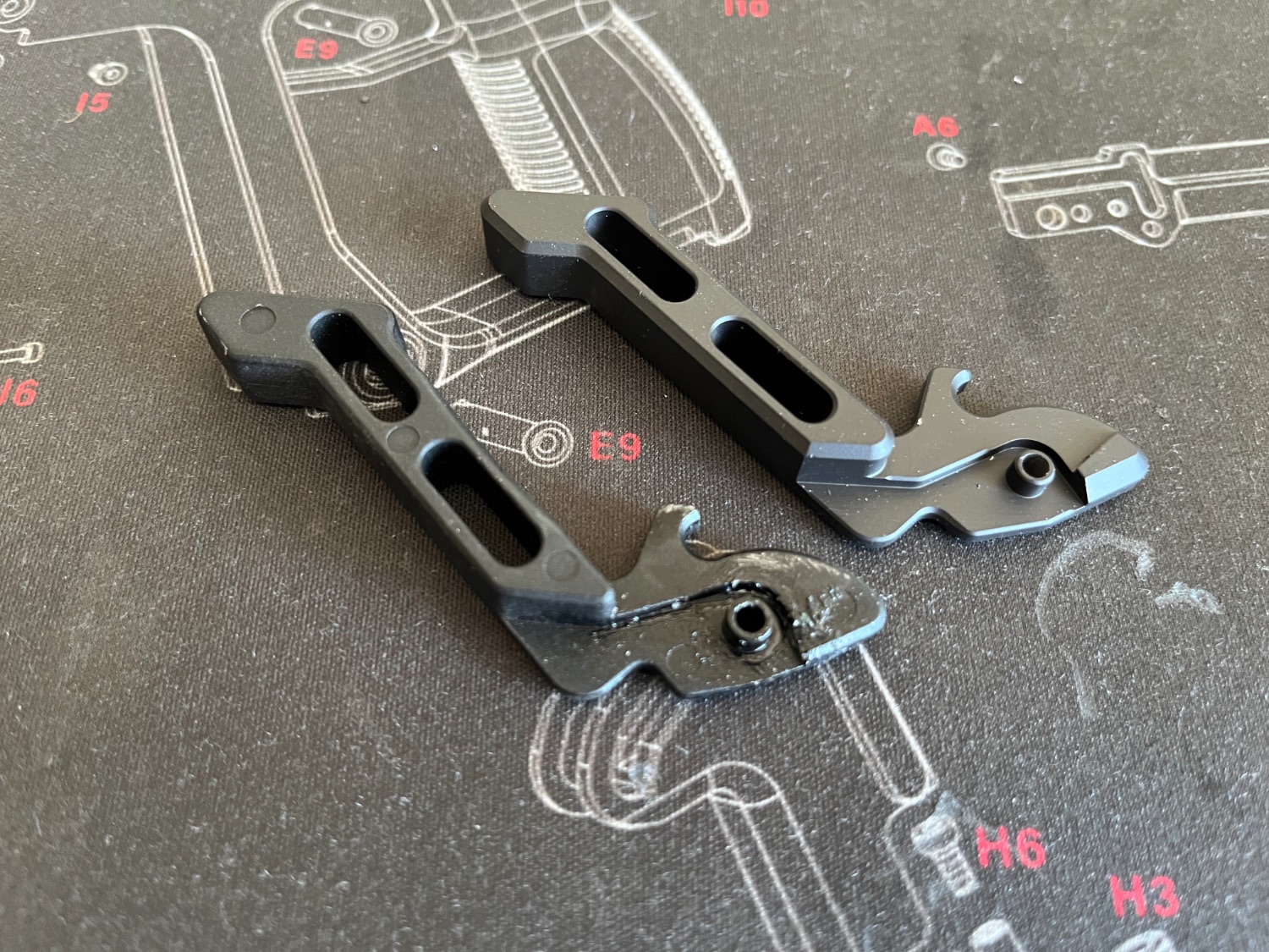

Guest Posted March 26, 2023 Posted March 26, 2023 Not made by me, made, once again, by @RidiculousReed. It’s a CNC steel charging handle that’s fits vectors. KWA, Krytac and Real Steel. Here it’s fitted to my .22lr, but it works equally as well on the KWA and Krytac (though a bit pointless on the Krytac). It will be cerakoted next week
Enid_Puceflange Posted April 4, 2023 Posted April 4, 2023 17 hours ago, rocketdogbert said: Perfect fit Nicer made than the oem one! lovely craftsmanship ?
Guest Posted April 4, 2023 Posted April 4, 2023 3 hours ago, Enid_Puceflange said: Nicer made than the oem one! lovely craftsmanship ? way better, CNC steel rather than cast pot metal, thanks to @RidiculousReed

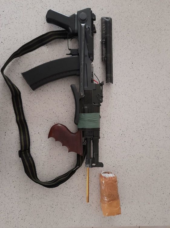

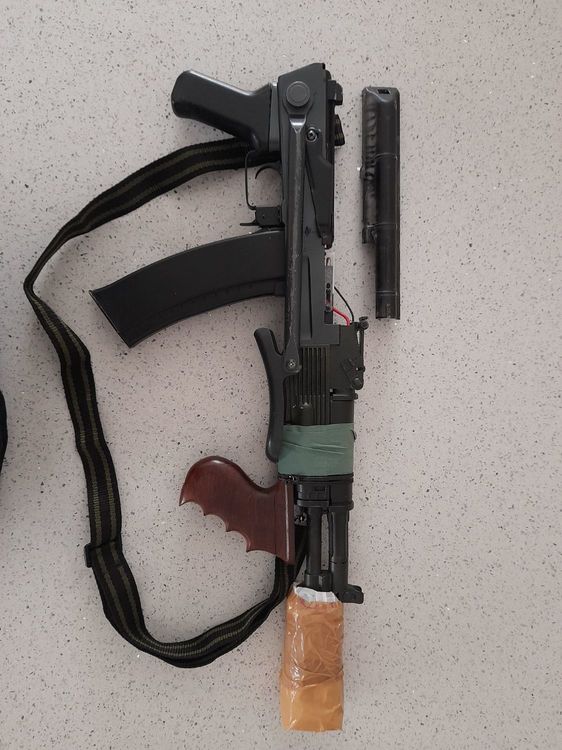

OTH21 Posted April 6, 2023 Posted April 6, 2023 (edited) My current project bitsa AK boneyard 'build' The Moscow Metro Sweeper. Built from parts bought from the classifieds. Cyma cm28 receiver and stock internals TM AK105 front end and handguards Thompson 1928 wooden fore grip TM topcover. JG pistol grip. Missing a cocking lever/spring guide, the plate that sits on top of the gear box and a screw to hold the pistol grip in place. Water bottle DAYZ style SuPpReSsoR to hide the extra barrel length that protrudes from the 105 front end. (To be duct taped) Shoots well in the garden. Going to be a skirmish back up/loaner RIF or apocalypse LARP. Just needs a drum mag. Edited April 6, 2023 by OTH21

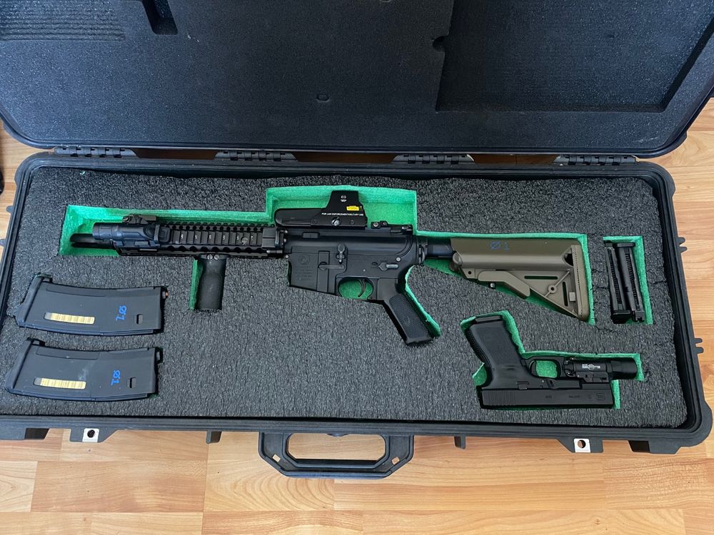

Jacob Wright Posted April 9, 2023 Posted April 9, 2023 It’s not pretty .. but finally got round to ordering and cutting my Shadow Foam. Much more reasonably priced than the Peli stuff, and it’ll do the job of stopping my rifle etc rolling about in the case. BigStew, Nick G and SSPKali 3

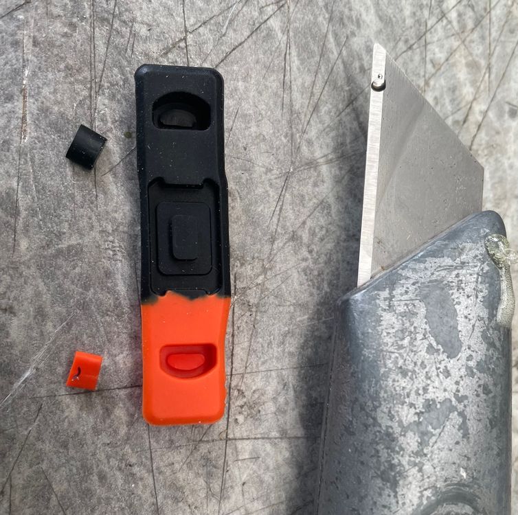

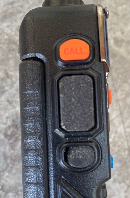

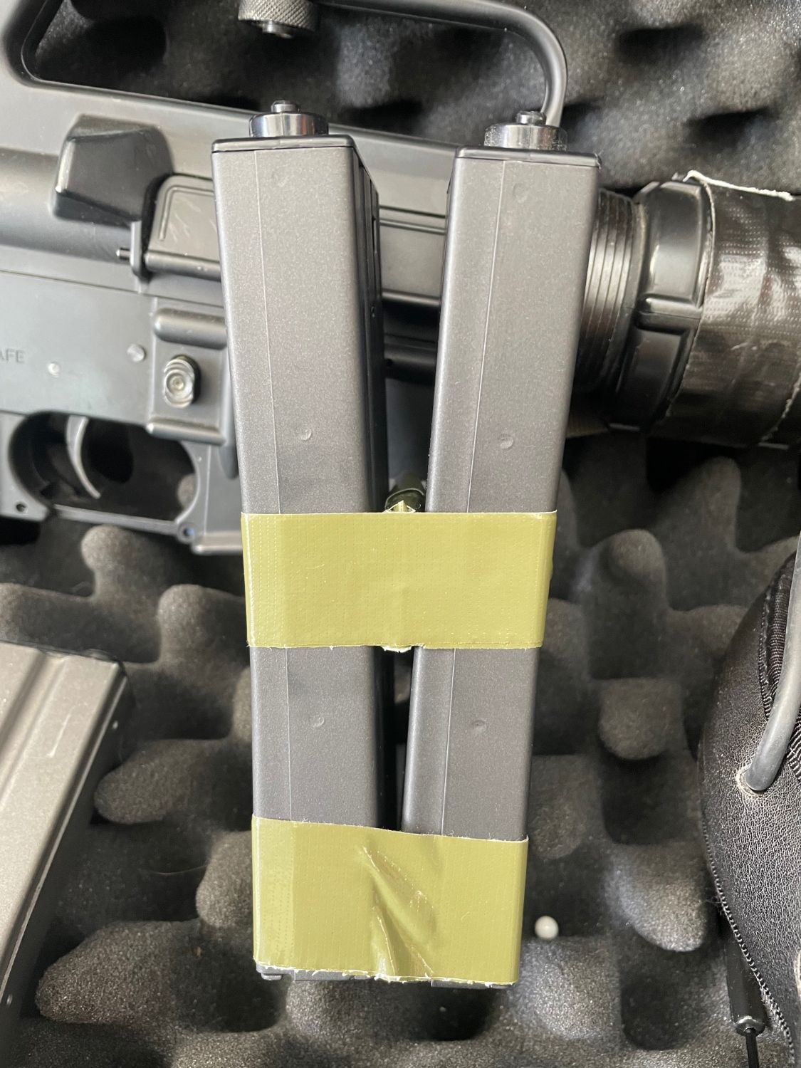

SSPKali Posted April 10, 2023 Posted April 10, 2023 Tweaked my two Baofeng UV5R* by removing the inner nubs from the torch/alarm and FM radio button as I am fed up of hitting them and not the PTT. I can still activate them with a pen or small screwdriver if I ever need to. PTT also got some 120grit paper added to make it easy to locate even with gloves on. Final tweak was a Larry Vickers double mag set up. Watch the Colt 723 video on Forgotten Weapons youtube channel. *yes I have a licence for them, sit down. Also stay off my frequencies ? Jacob Wright 1
