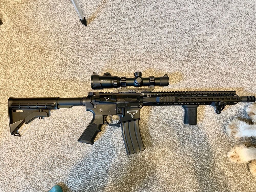

RobHedley Posted October 21, 2022 Posted October 21, 2022 Hey all, I wanted to tap into the hive mind that is all MWS owners. As some of you may know I have an MWS built with the Angry Gun Tarran Tactical TTR1 Conversion kit (got it for a steal from a great guy in Holland). I had intended on using it as a DMR so fitted a Scope. COVID got I the way so I never used it in anger. I have now purchased the phenomenal Umarex H&K PSG1 GBB and for the mean time I have fitted the scope on there so need to replace the optic on the TTR1. I am hoping to go Red Dot with a magnifier or something like that so that I can use it as a hybrid with a bit more reach but under the 350fps so no minimum engagement distance. I have a Vortex in my other MWS so looking for similar sort of thing. Am I completely off the mark or do we all think this is a decent idea. Looking forwards to the suggestions
alxndrhll Posted October 21, 2022 Posted October 21, 2022 4 minutes ago, RobHedley said: Hey all, I wanted to tap into the hive mind that is all MWS owners. As some of you may know I have an MWS built with the Angry Gun Tarran Tactical TTR1 Conversion kit (got it for a steal from a great guy in Holland). I had intended on using it as a DMR so fitted a Scope. COVID got I the way so I never used it in anger. I have now purchased the phenomenal Umarex H&K PSG1 GBB and for the mean time I have fitted the scope on there so need to replace the optic on the TTR1. I am hoping to go Red Dot with a magnifier or something like that so that I can use it as a hybrid with a bit more reach but under the 350fps so no minimum engagement distance. I have a Vortex in my other MWS so looking for similar sort of thing. Am I completely off the mark or do we all think this is a decent idea. Looking forwards to the suggestions I ended up not being a huge fan of the red dot/magnifier combo, but I used one of these as the mag and had zero issues with the product itself. I had my red dot on a Unity Riser, so the mag was mounted in a Unity mag mount (the flip to centre was a big deal for me, albeit at a very high cost). Obviously mounts will end up being specific to what you like, but hopefully this is useful information nevertheless.

RobHedley Posted October 26, 2022 Posted October 26, 2022 (edited) Hey Chai, Unfortunately I am still using it or should I say will be using it. I have scavenged the Scope of it to put on the new PSG-1 GBB and plan on purchasing a Vortex Crossfire and 3x Magnifier so I can use it as a middle distance rifle. i.e. I have my MWS Block One for CQB and Skirmishes, my PSG-1 DMR for sneaky sniper stuff which leave a big hole in the middle which I hope will be filled by the TTR1. Soz. Are Angry Gun still making them? I know they were extortionate when they came out. It does look pretty cool though! Excuse the Dogs paws in the photo, bugger get’s everywhere! Edited October 26, 2022 by RobHedley
