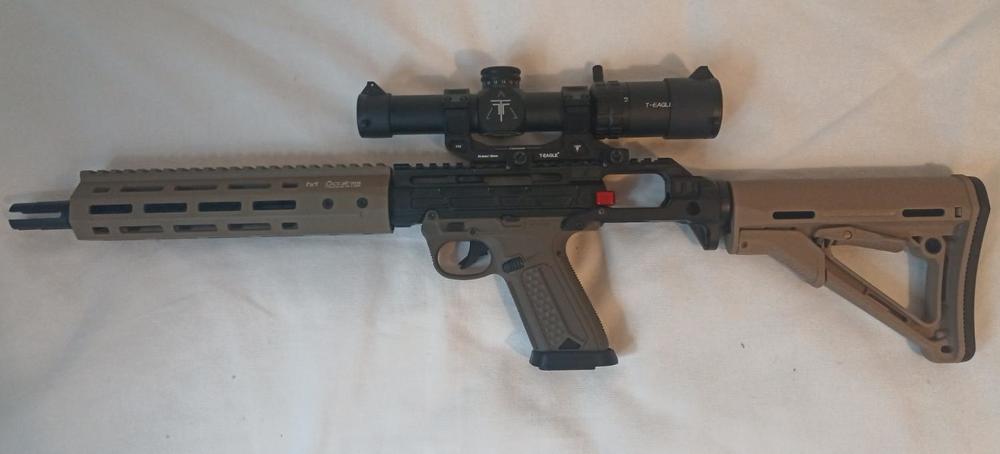

The_Lord_Poncho Posted September 18, 2023 Posted September 18, 2023 Kind of counts for this thread I suppose - A TTI PCC carbine build around an AAP-01. 210mm Unicorn Airsoft inner barrel+ unicorn hop rubber that came with the barrel. 3d printed short stroke buffer, semi lock selector plate, and angled fore grip. Performance seems pretty decent - good accuracy and hop at 1.2 joules (305fps) on a .28g bb - I'll try some heavier ones later. Whole thing is very solid, and rather light/'pointable'. Only bit that is annoying me is the octarms M-Lok handguard - even with no shims there is a gap at the back of it of at least 4mm between it and the receiver. I might need to try a different design that doesn't simply rely on set screw holes in the barrel nut and shims to align. GothicGhost and DanBow 1 1

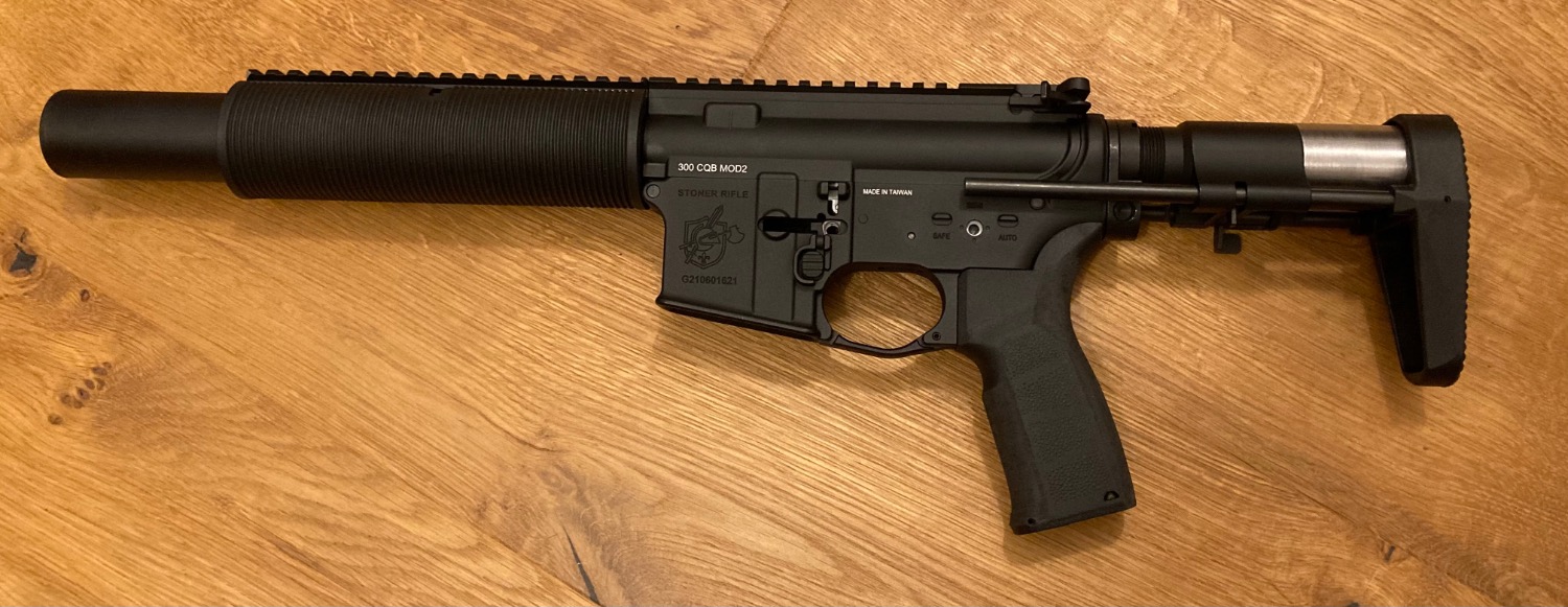

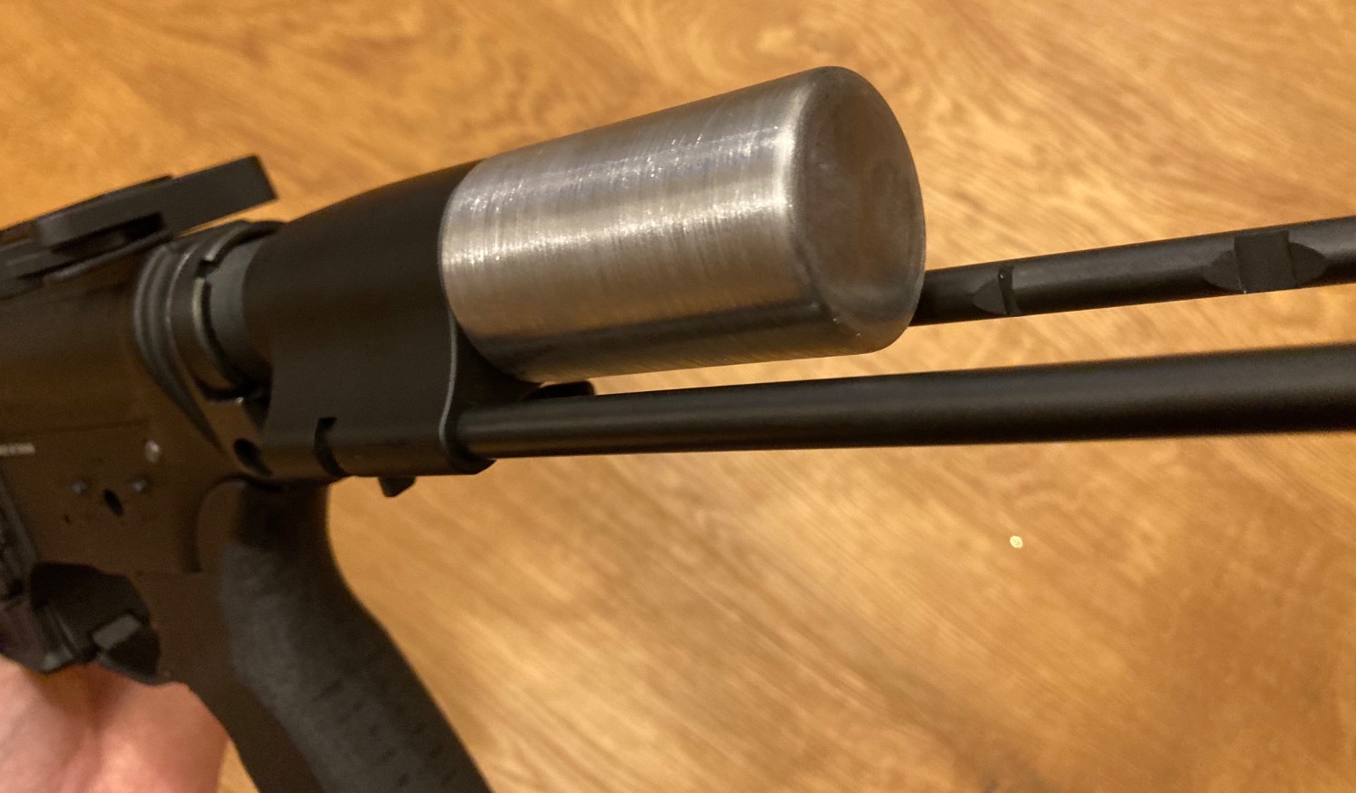

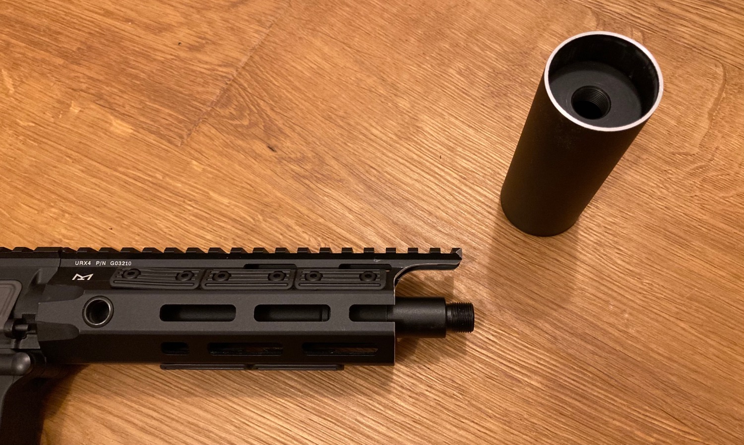

Popular Post Davegolf Posted October 13, 2023 Popular Post Posted October 13, 2023 Machined/TiG welded a buffer extension, for battery and some cheek weld. Shortened outer barrel, modified silencer & machined out the rail. Nick G, GearTech, Lozart and 4 others 4 3

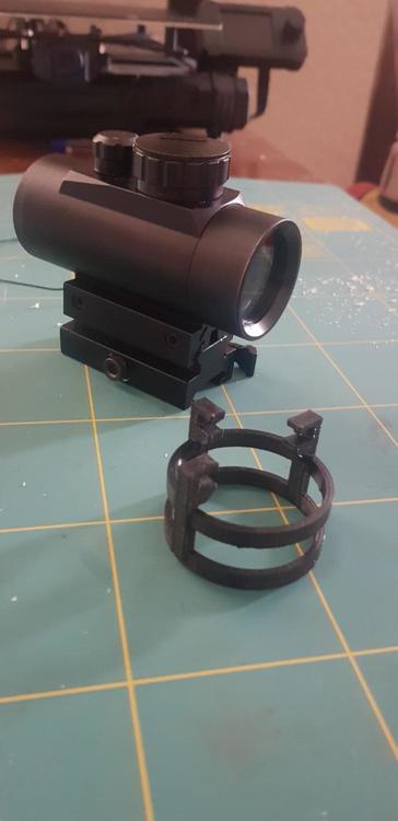

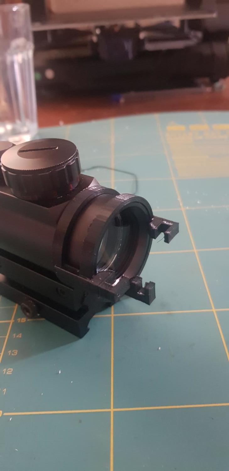

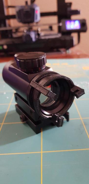

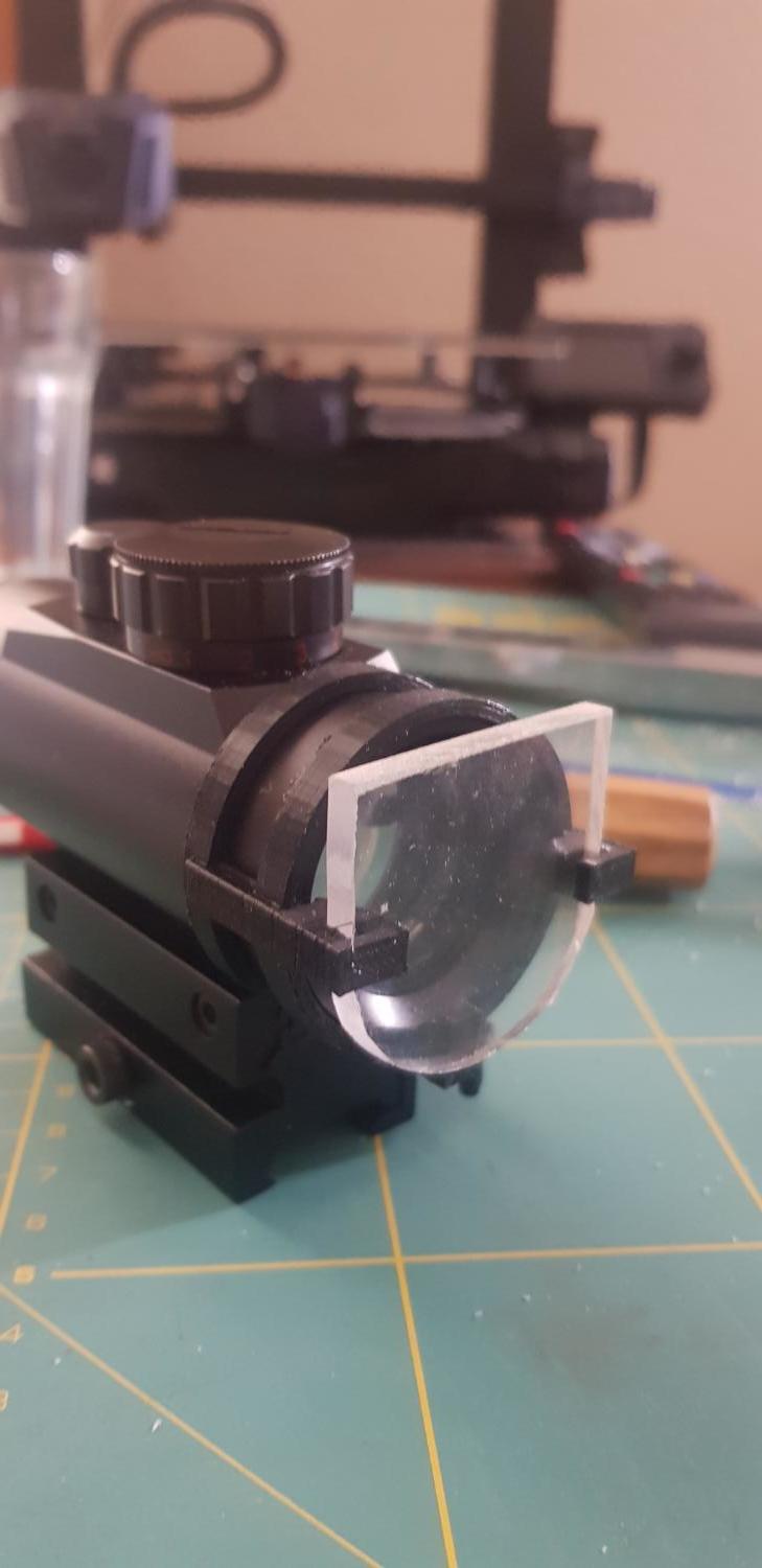

DanBow Posted October 13, 2023 Posted October 13, 2023 I picked up a red dot sight, off here, and decided to design and 3d print a protector. 1st prototype looks cool enough but cutting the acrylic sheet round and then fitting it into the holder was too much. So . . Prototype mk2 Happy with that one. Printed quickly in PLA so I'll get some better fillament, maybe ABS, and print it properly. Designed in Tinkercad, sliced in Prusaslicer, printed on an Anycubic Kobra. Egon_247, _K4MF_ and OTH21 3
The_Lord_Poncho Posted October 13, 2023 Posted October 13, 2023 Nice work - i'd love to progress to where i can design my own files for 3D printing. At the moment I use a simple circular end cap with a lip from an existing 3d file, and just scale it up and down to fit the various pre-cut perspex discs you can get off ebay - and the various scopes, sights, and torches that i use. DanBow 1

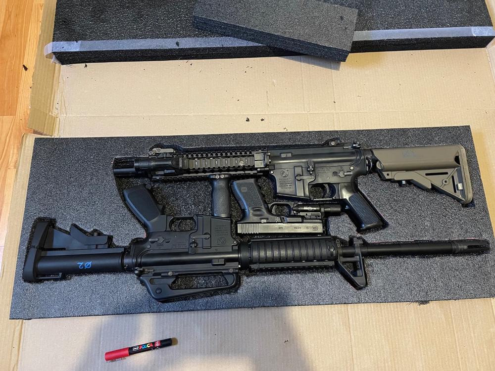

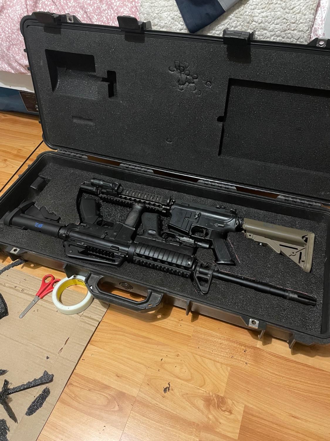

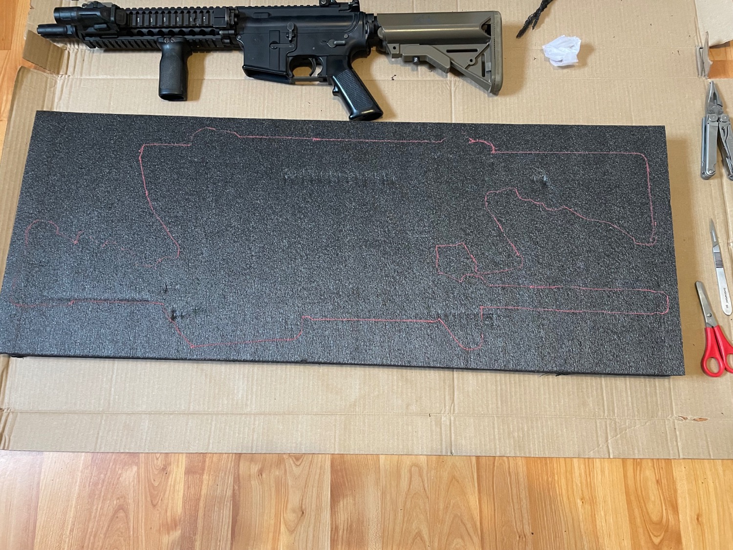

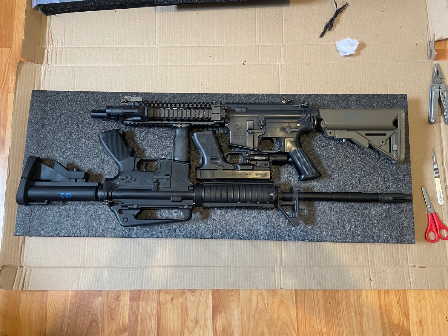

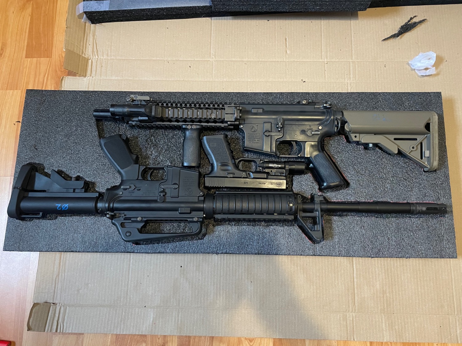

Jacob Wright Posted October 16, 2023 Posted October 16, 2023 Cracked on with the foam this afternoon .. didn’t consider that the bottom of the case isn’t flat sided so I’m having to chamfer the edges of it ? gavinkempsell, Shamal, Nick G and 1 other 4
Jacob Wright Posted October 18, 2023 Posted October 18, 2023 Think I did a pretty good job! Shamal, _K4MF_, BigStew and 1 other 4

BigStew Posted October 19, 2023 Posted October 19, 2023 16 hours ago, Jacob Wright said: Think I did a pretty good job! What case is that?
HuttArmouries Posted October 19, 2023 Posted October 19, 2023 26 minutes ago, Cocha said: I love it! Did you print the handguard? yep. first version used aluminium tubing but It was just easier to get all of the little vent holes and bits printed directly into it
Jacob Wright Posted October 19, 2023 Posted October 19, 2023 7 hours ago, BigStew said: What case is that? There’s a question ? a Peli 1700 I think?

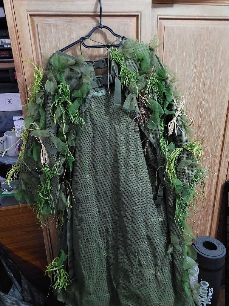

Impulse Posted October 21, 2023 Posted October 21, 2023 (edited) I do love my lightweight and affordable ghillie builds. This is a summer ghillie, just in time for winter to come around . It's super lightweight, super breathable, nothing on my front to snag on and drag half the forest floor with me while I'm low crawling along the ground. Also has elastic loops on the base, so I can stick a bunch of natural vegetation in it too. I have a 2nd webtex concealment vest and more than enough material to make a 2nd, so all in it'll be £120 for two ghillies, so £60 per ghillie and I'll have a summer one and a winter one. Used a lot of the green materials (not all), but still got the vast majority of the khaki and brown stuff, so a winter variant will be easy to do. Build is: Webtex concealment vest Novritsch raffia (in total about 1 bag used, but mostly greens from two bags) Novritsch camo material (less than half a bag used) Edited October 21, 2023 by Impulse DanBow 1

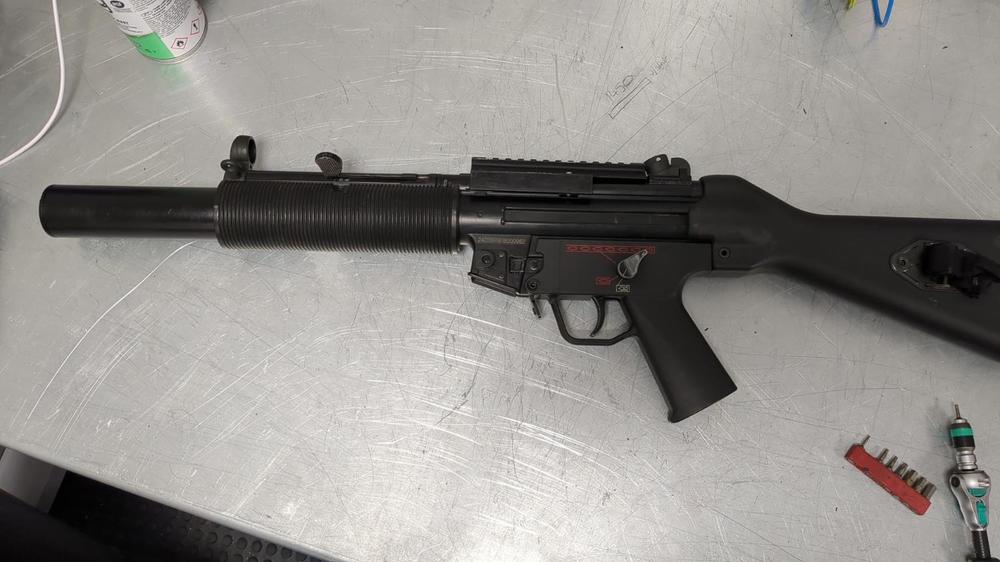

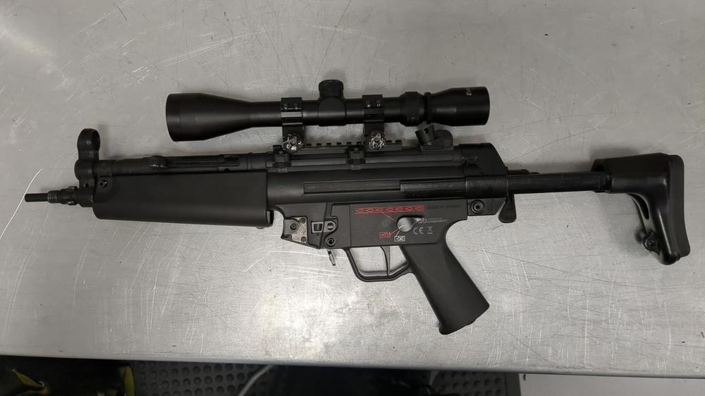

Egon_247 Posted October 30, 2023 Posted October 30, 2023 (edited) On 26/10/2023 at 09:01, mightyjebus said: I like it when a plan comes together...finished results Oddly, I've just gone the other way with my SD. Boy wanted a collapsible stock on his mp5, so we swapped. But if a faff getting the wires to the front but a couple of deans plugs and it's reversible. ? Ignore the scope, we were having a giggle about the range of it, so I stuck a scope on it ?? Edited October 30, 2023 by Egon_247 G'day Bruce....? RostokMcSpoons and Nick G 2

Egon_247 Posted October 30, 2023 Posted October 30, 2023 (edited) Sorry, the phone was doing odd things. I'll see if I can swap them over. ? Edit: that's better. ?? I have a G3 that I'm slowly turning into a beastie too. Still overspinnininning but hey, I'll get it sorted. Edited October 30, 2023 by Egon_247 RostokMcSpoons 1

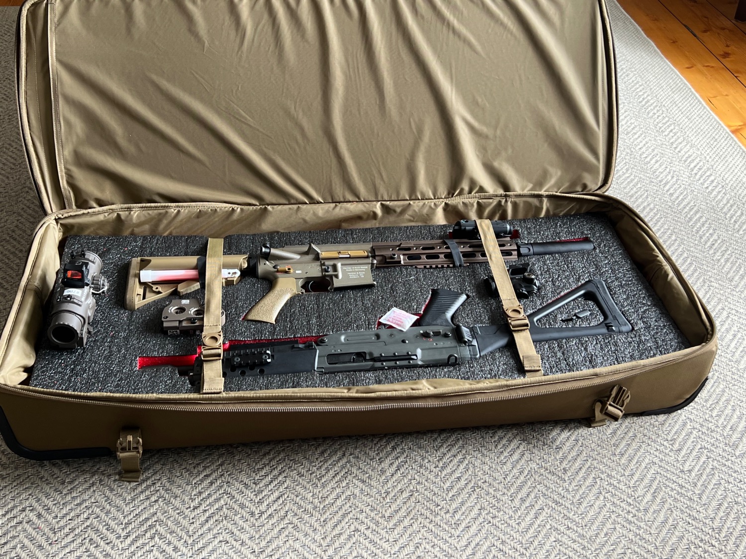

Enid_Puceflange Posted October 30, 2023 Posted October 30, 2023 ShadowFoam, finishes off the Cams quite nicely I think Well, gotta have somewhere snug for the Sig and the 416 backup to rest Jacob Wright, Egon_247, Chev Chelios and 1 other 2 2
