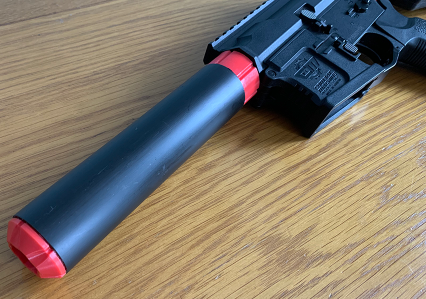

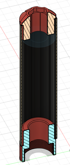

Speedbird_666 Posted August 12, 2021 Posted August 12, 2021 (edited) Ok, last of the Speedsoft content - moving on to other projects now. Made a hand guard using 40mm PVC pipe that acts as a sleeve over the stock outer barrel. Barrel nut epoxied to one end, and a cap that is a tight interference fit on the outer barrel epoxied to the other. Very solid given the soft plastic of the pipe, no flex or wobble. Perfectly usable I reckon, assuming you don't plan to use it as a club and wrap it around a tree. I call it - the fleshlight....? (Note - no guns were harmed in the making of this project, all bits will be reverted back to stock shortly.) Edited August 12, 2021 by Speedbird_666 Druid799 and PopRocket123 2
Supporters Druid799 Posted August 12, 2021 Supporters Posted August 12, 2021 9 hours ago, Speedbird_666 said: Ok, last of the Speedsoft content - moving on to other projects now. Made a hand guard using 40mm PVC pipe that acts as a sleeve over the stock outer barrel. Barrel nut epoxied to one end, and a cap that is a tight interference fit on the outer barrel epoxied to the other. Very solid given the soft plastic of the pipe, no flex or wobble. Perfectly usable I reckon, assuming you don't plan to use it as a club and wrap it around a tree. I call it - the fleshlight....? (Note - no guns were harmed in the making of this project, all bits will be reverted back to stock shortly.) Can certainly appreciate the technicality of the work that went in to the printed parts but f**k me sideways and call me Florence that has to be the most fugly gun it has EVER been my misfortune to see !? Think I need to go wash my eyes out with neat shampoo ! ? Speedbird_666 1

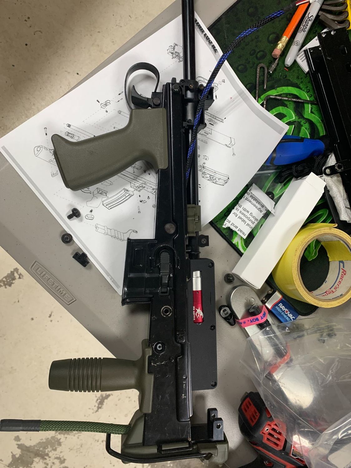

Supporters SeniorSpaz87 Posted August 13, 2021 Supporters Posted August 13, 2021 The STAR L86 revitalization project continues. Shell is printed, engine is acquired and installed, both microswitches have been installed, donor parts have been transferred, and all thats left is to wait for Polarstar to hurry up and send over the wiring and boards I need. PopRocket123, Druid799 and Speedbird_666 2 1

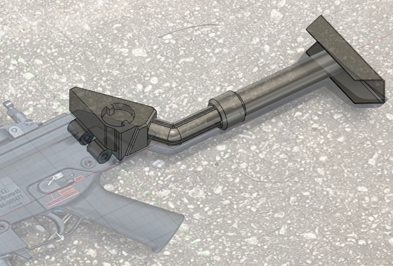

Popular Post Speedbird_666 Posted August 19, 2021 Popular Post Posted August 19, 2021 Not speedsoft....honestly! I've been modelling a real steel B&T Visor/Gas Mask Stock for a G36 using pictures as a reference. Not sure if I'll actually make this one (although it's dimensionally accurate to TM spec guns), but it's been fun to model nonetheless. RS references: PopRocket123, Jaylordofwaargh, Druid799 and 2 others 4 1

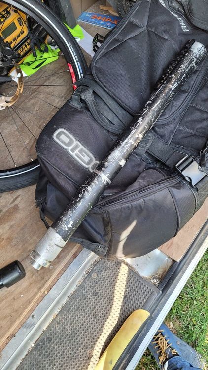

MagpieTactical Posted August 19, 2021 Posted August 19, 2021 Not made as such, but sprayed my old mtb Camelbak to use at airsoft rather then buying a new camo hydro pouch SilentSparky, Speedbird_666, Khyber and 1 other 4

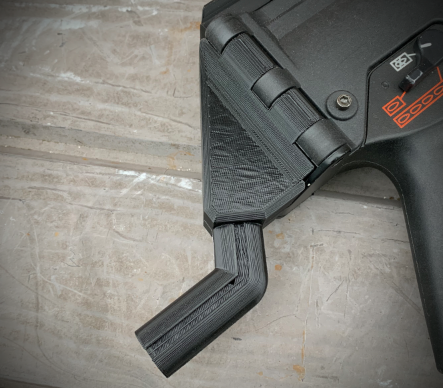

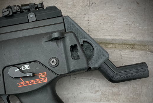

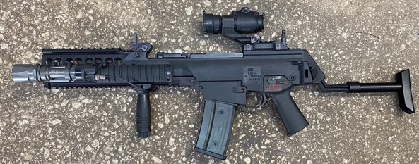

Speedbird_666 Posted August 19, 2021 Posted August 19, 2021 A quick and nasty print to test fitment - 0.30 layer height (accidentally left the upper and lower skin thickness at 0.12 which also doesn't help) and a very low infill leaving a rough finish. Fitment was damned near perfect - just needed the hinge holes opening up a little and a relief hole drilled for the gearbox screw that protrudes a little. Test print was done in two halves then glued - I'm considering creating a channel for a bent steel rod to be sandwiched between the halves for reinforcement before epoxying them together. The final print would be done at 100% infill with a much smaller layer height (around 0.12mm) to smooth things out. Haven't worked out the rear (sliding) bit yet - probably an aluminium tube and 3D printed bushing and stock pad. I'll probably not bother with a sprung button mechanism, rather glue the metal button in place and have it non-folding. Real Steel: Yes, it's ugly. But I like it. Very popular with French and German Police forces - they also use them on MP5s and I've never seen one on an Airsoft gun. Druid799, Tackle and Jaylordofwaargh 3
Shamal Posted August 19, 2021 Posted August 19, 2021 29 minutes ago, Speedbird_666 said: A quick and nasty print to test fitment - 0.30 layer height (accidentally left the upper and lower skin thickness at 0.12 which also doesn't help) and a very low infill leaving a rough finish. Fitment was damned near perfect - just needed the hinge holes opening up a little and a relief hole drilled for the gearbox screw that protrudes a little. Test print was done in two halves then glued - I'm considering creating a channel for a bent steel rod to be sandwiched between the halves for reinforcement before epoxying them together. The final print would be done at 100% infill with a much smaller layer height (around 0.12mm) to smooth things out. Haven't worked out the rear (sliding) bit yet - probably an aluminium tube and 3D printed bushing and stock pad. I'll probably not bother with a sprung button mechanism, rather glue the metal button in place and have it non-folding. Real Steel: Yes, it's ugly. But I like it. Very popular with French and German Police forces - they also use them on MP5s and I've never seen one on an Airsoft gun. I like it. ? It's better than the semi hard on stock lol ?

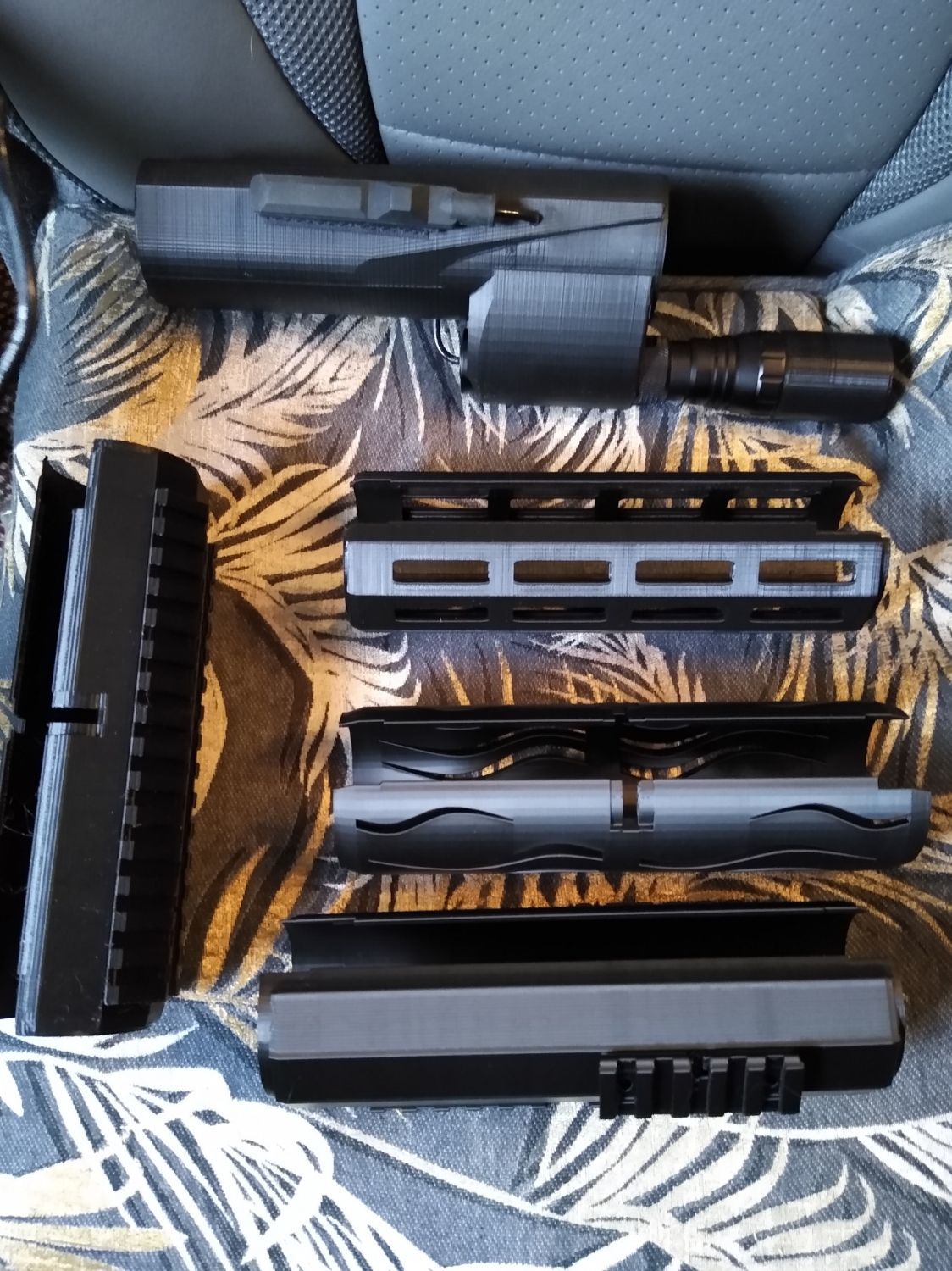

sjhirst Posted August 20, 2021 Posted August 20, 2021 My collection of handguards for the mp5. Once I'd done one, I just had to do more! Speedbird_666 and PopRocket123 1 1

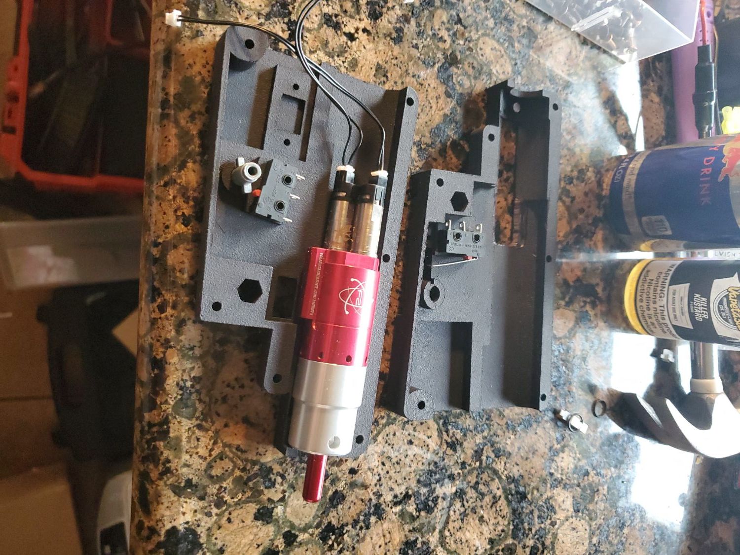

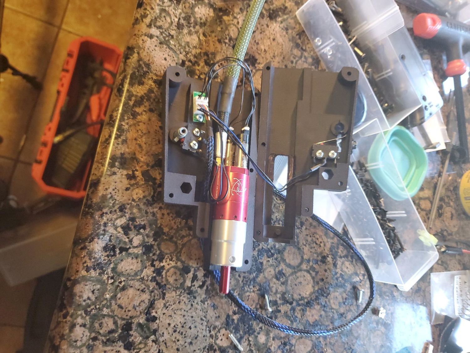

Supporters SeniorSpaz87 Posted August 21, 2021 Supporters Posted August 21, 2021 More pics of the custom 3D printed STAR HPA gearbox being assembled and installed. Damn these L86s have a bunch of parts... PopRocket123 and Speedbird_666 1 1

Tommikka Posted August 22, 2021 Posted August 22, 2021 On 19/08/2021 at 12:29, Speedbird_666 said: Not speedsoft....honestly! I've been modelling a real steel B&T Visor/Gas Mask Stock for a G36 using pictures as a reference. Not sure if I'll actually make this one (although it's dimensionally accurate to TM spec guns), but it's been fun to model nonetheless. RS references: There is a point often missed that real life weapon design is based on function. Stocks traditionally are as close as possible to being aligned with the barrel straight from front to back due to the physics of firearms and the force of recoil. They have the steadying function of a solid hold to assist in accuracy and in minimising lift and keeping the barrel on target. They also contribute to the ergonomics of the weapon. There is always a compromise between these and other functions. In gameplay as opposed to real firearms the physics differ, but part of the appeal is to look like real firearms so you get the variations between speedsoft ergonimics and skirmishing looks. In real firearms technology changes, with various calibers and propellant mixes plus other elements of the firearms design. Thus you get oddities like dropped stocks appearing in real firearms as the balance of physics and ergonomics changes
PopRocket123 Posted August 22, 2021 Posted August 22, 2021 6 minutes ago, Tommikka said: There is a point often missed that real life weapon design is based on function. Stocks traditionally are as close as possible to being aligned with the barrel straight from front to back due to the physics of firearms and the force of recoil. They have the steadying function of a solid hold to assist in accuracy and in minimising lift and keeping the barrel on target. They also contribute to the ergonomics of the weapon. There is always a compromise between these and other functions. In gameplay as opposed to real firearms the physics differ, but part of the appeal is to look like real firearms so you get the variations between speedsoft ergonimics and skirmishing looks. In real firearms technology changes, with various calibers and propellant mixes plus other elements of the firearms design. Thus you get oddities like dropped stocks appearing in real firearms as the balance of physics and ergonomics changes K
Supporters TheFull9 Posted August 22, 2021 Supporters Posted August 22, 2021 Stocks like that exist to get under big fat bullet resistant face shields/visors, nothing more needs saying really. French and German police specifically use such setups a fair bit. Speedbird_666 1
Speedbird_666 Posted August 23, 2021 Posted August 23, 2021 (edited) 11 hours ago, Tommikka said: There is a point often missed that real life weapon design is based on function. Stocks traditionally are as close as possible to being aligned with the barrel straight from front to back due to the physics of firearms and the force of re.... [Snip] Um..ok... Meanwhile - In other news: Now printing it 'properly' at 100% infill, with a channel for a 5mm steel rod to be glued within it. Each half will take 14 hours to print and the whole thing will be 3D printed (two sides and the butt pad as a separate print) with the stock 'fixed' in position. I'll be hitting it with filler primer and sanding it to smooth out the layer lines, then spray it with matte black paint. If anyone has any ideas on how to try replicate that 'moulded plastic roughness' surface finish that you get on polymer bodied guns, it would be much appreciated. 11 hours ago, HuttArmouries said: Had a friend print out the split slide model I modified. Going to be interesting to see how well it actually works. Got one made with the pic rail and one without just incase I feel like changing it over They look very cool. I'll be interested to hear how they perform. Edited August 23, 2021 by Speedbird_666 TheFull9 and HuttArmouries 2
