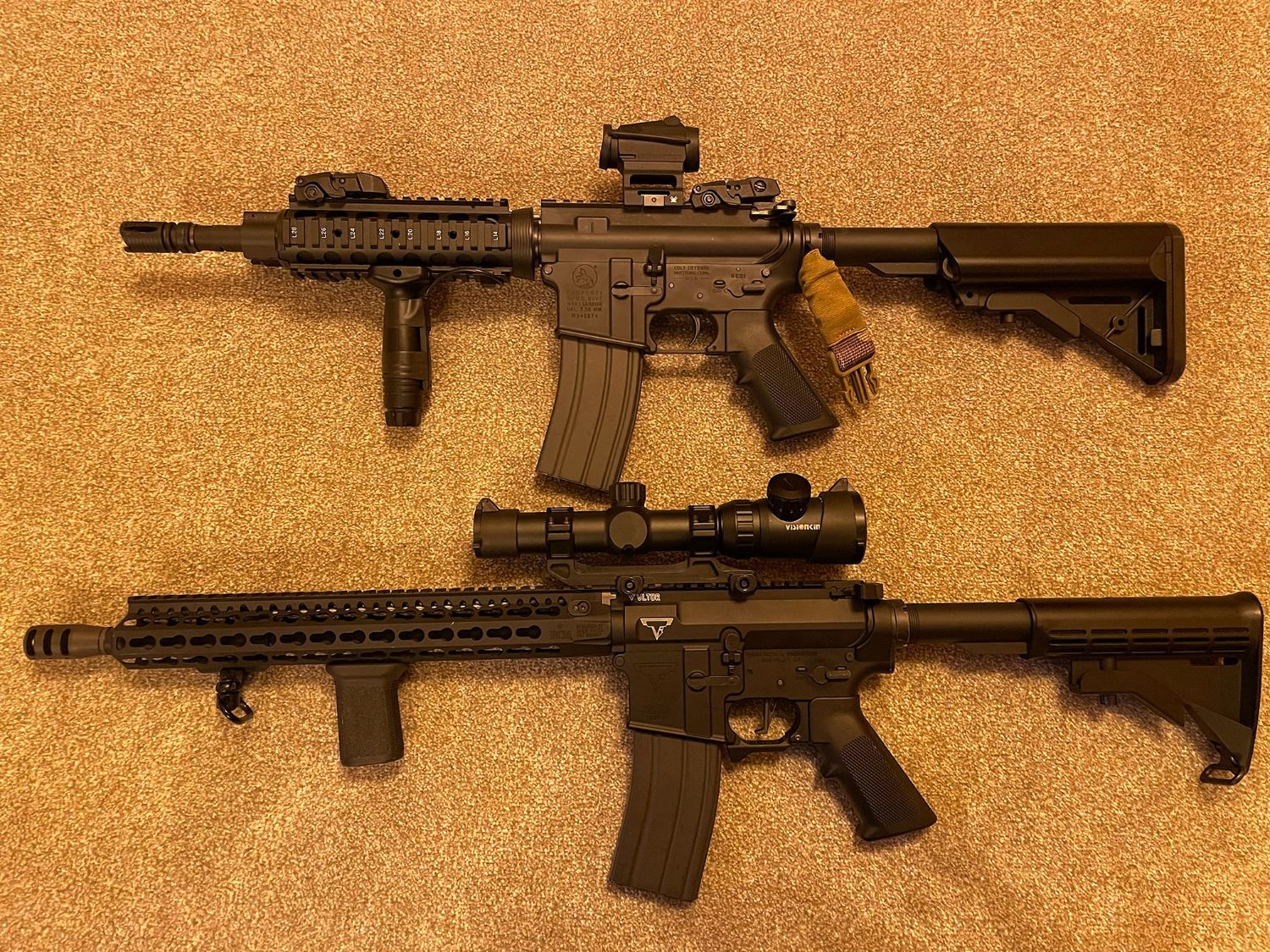

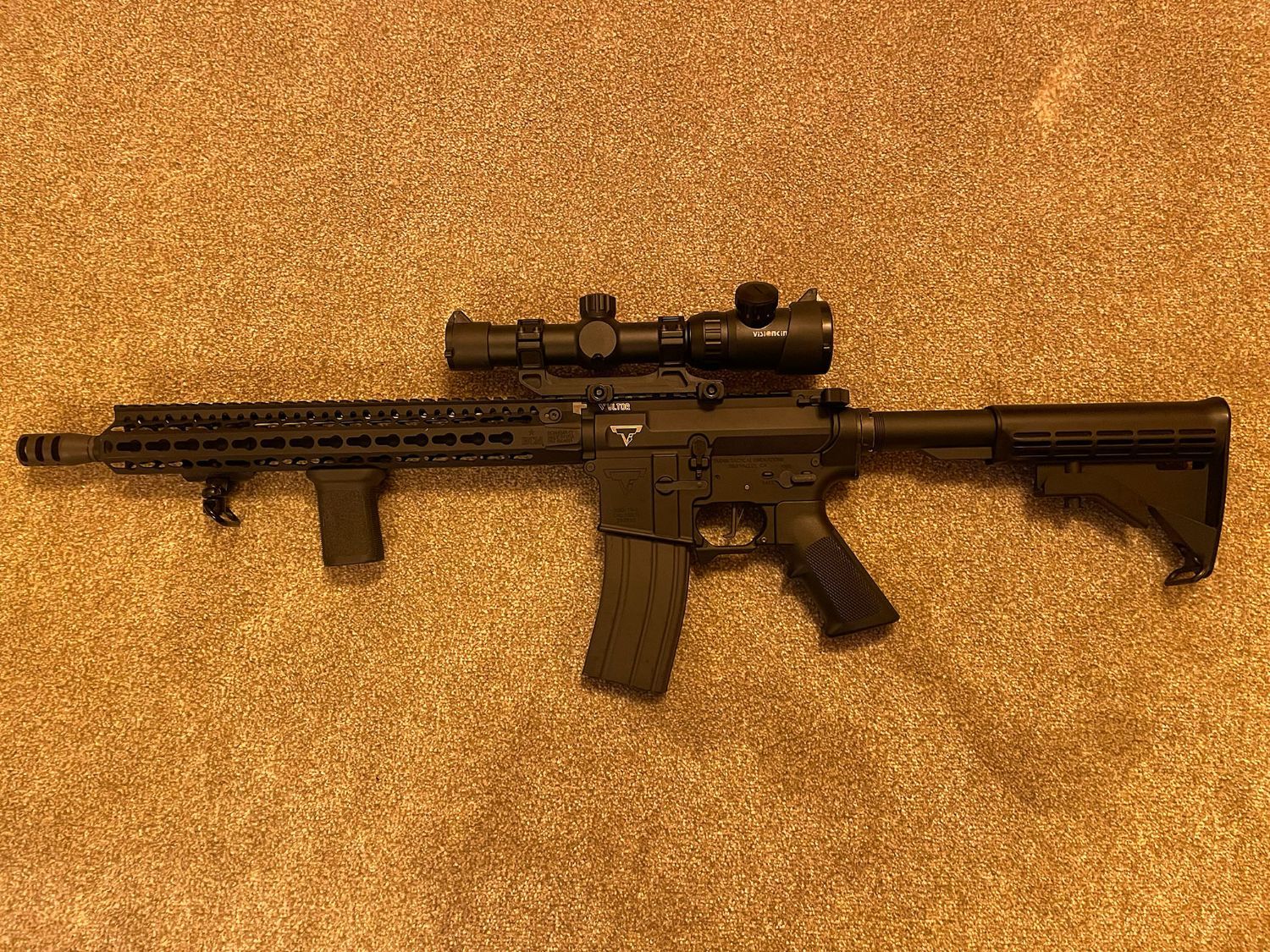

RobHedley Posted June 8, 2022 Posted June 8, 2022 (edited) Well after a long sabbatical from the sport I am now back and I finally got round to finishing of the Taran Tactical TR1 John Wick. It uses the Angry Gun TTI TR1 John Wick kit. Before a few of you tell me about the evil of Angry Gun parts, all the internals are all MWS apart from a tan bucking and a longer 6.05 inner barrel. Also I didn't pay the absurdly expensive price of £900 or whatever it was. I got it off a former member on here that bought it just to get an upper he had broken. I got eh whole thing including a near full MWS for a bargain price. Regarding the quality of the kit, I did have to do a little bit of light engineering to get the trigger mechanism to fit in the lower but everything else in the kit fitted quite nicely. I also fitted a new BCG with a built in NPAS ( I can't remember the name as I bought it over 2 years ago and never fitted it. I gave it a test fire and with the NPAS wound all the way in (max power) this thing is bloody powerful. I will run it through the Chrono tomorrow to see what it is coming out as then adjust accordingly. The second photo also shows my original Block 1 MWS for size comparison which is totally standard and totally bullet proof! Edited June 8, 2022 by RobHedley MILITATED and SSPKali 2
RobHedley Posted June 9, 2022 Posted June 9, 2022 (edited) Well the results are in. I have to say that it seems more powerful than the actual numbers. So the Block 1 which is standard is coming out at around the 260 fps using .32s and red gas The TR1 DMS is coming out between 370 - 350 fps using .32s and red gas I have a decent size garden so it was just short of 60m from firing point inside the outbuilding to the target. It is a little windy today but the DMR was firing straight with no hint of a drop off when it hit the target and it was still motoring when it got there. Pretty pleased with the results but we will see when I use it in anger in a game. Are those figures around the norm gents? Edited June 9, 2022 by RobHedley
