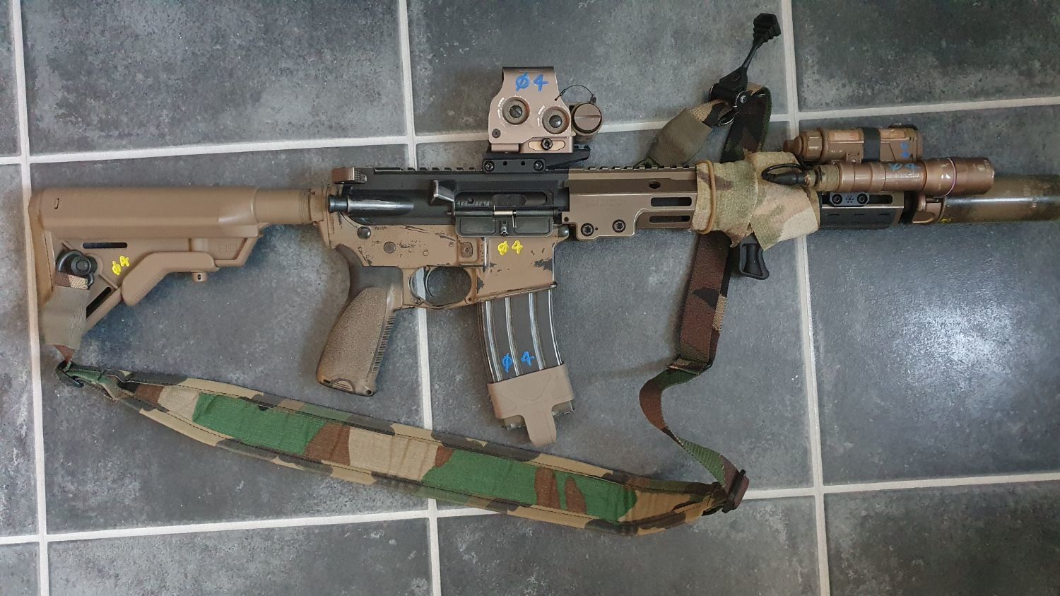

quango2k Posted March 26, 2022 Posted March 26, 2022 My mws in its current form. G&P npas Summer buffer spring Pts buffer G&P buffer tube Daves nub That's it for internals, I've tried so many others and it's all crap, just leave it as close to stock as possible. AG v2 11inch URGI rail. steel outer barrel, cant remember the make. geiselle gas block. b5 systems bravo stock. b5 systems grip( pictured with a bcm). g&p steel forward assist, mag release etc. AG b2 maritime bolt release AG mini socom and 4 prong flash. Bcm handstop. Surefire, ngal, unity mount and eotech to finish. Ferro concepts sling and swivels and probably other crap I've forgotten. Running on propane or mapp gas depending on temps. Tactical Pith Helmet, Tom_84, Wavey_Gravey and 1 other 4

AlphaBear Posted March 29, 2022 Posted March 29, 2022 On 26/03/2022 at 20:46, quango2k said: My mws in its current form. Running on propane or mapp gas depending on temps. That's one thing I haven't tried yet... I just seem to stick with Abbey at the moment. I assume propane during the colder months and Mapp for the other months? Also which propane adapter are you using and I assume you stick a wee bit of lube in with each fill?
quango2k Posted March 29, 2022 Posted March 29, 2022 9 hours ago, AlphaBear said: That's one thing I haven't tried yet... I just seem to stick with Abbey at the moment. I assume propane during the colder months and Mapp for the other months? Also which propane adapter are you using and I assume you stick a wee bit of lube in with each fill? Nope, propane for everything above 10 degrees, mapp below as it's better in the cold. I use the airsoft innovations one but they seem hard to get hold of right now. And a nope for putting lube in at all. I just run them empty at the end of the day, then put a square of Abbey Green/maintenance gas in for storage. Works just fine.
