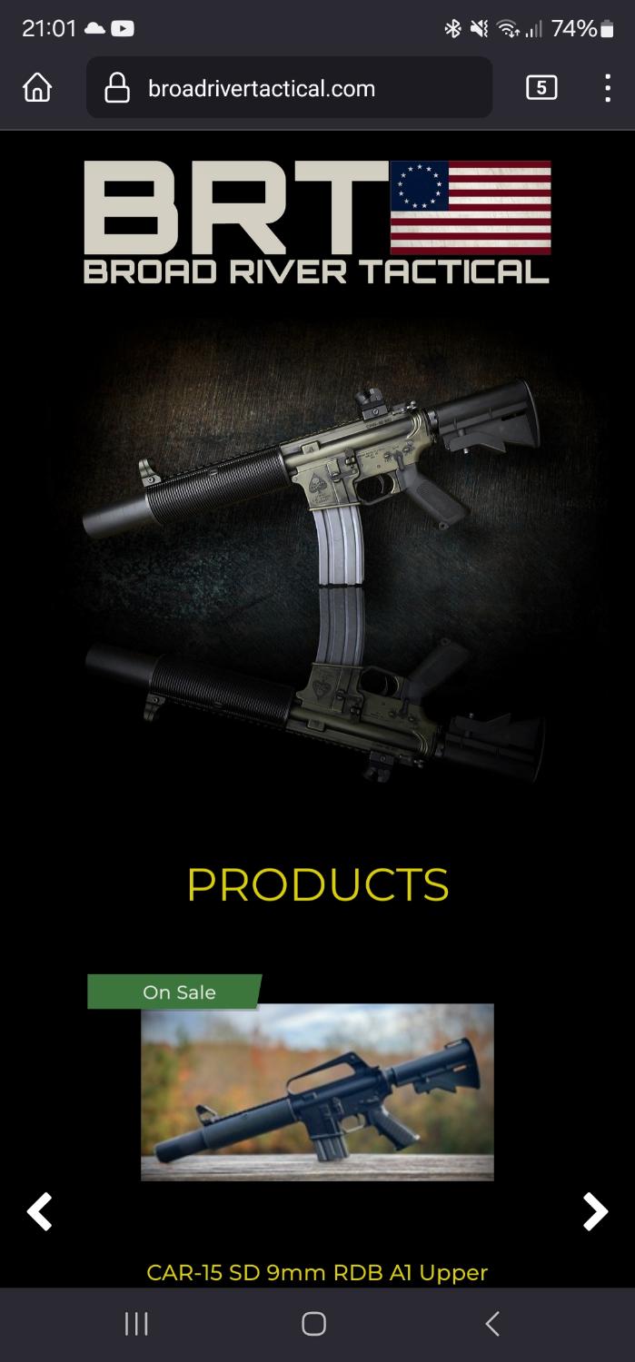

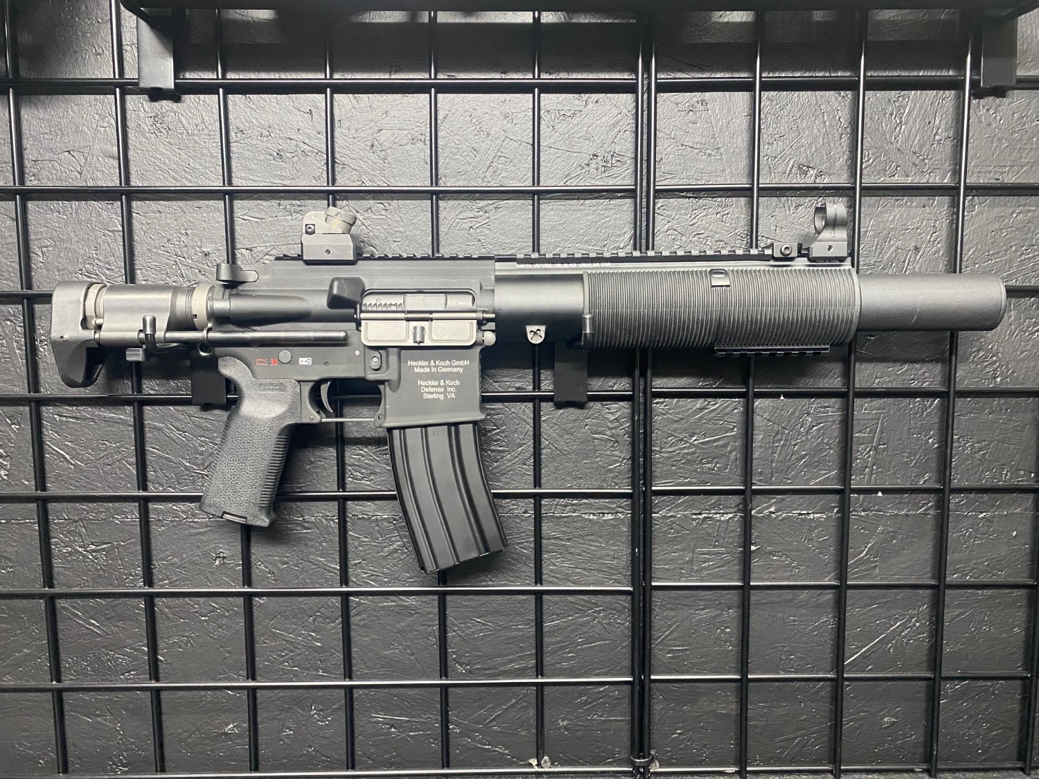

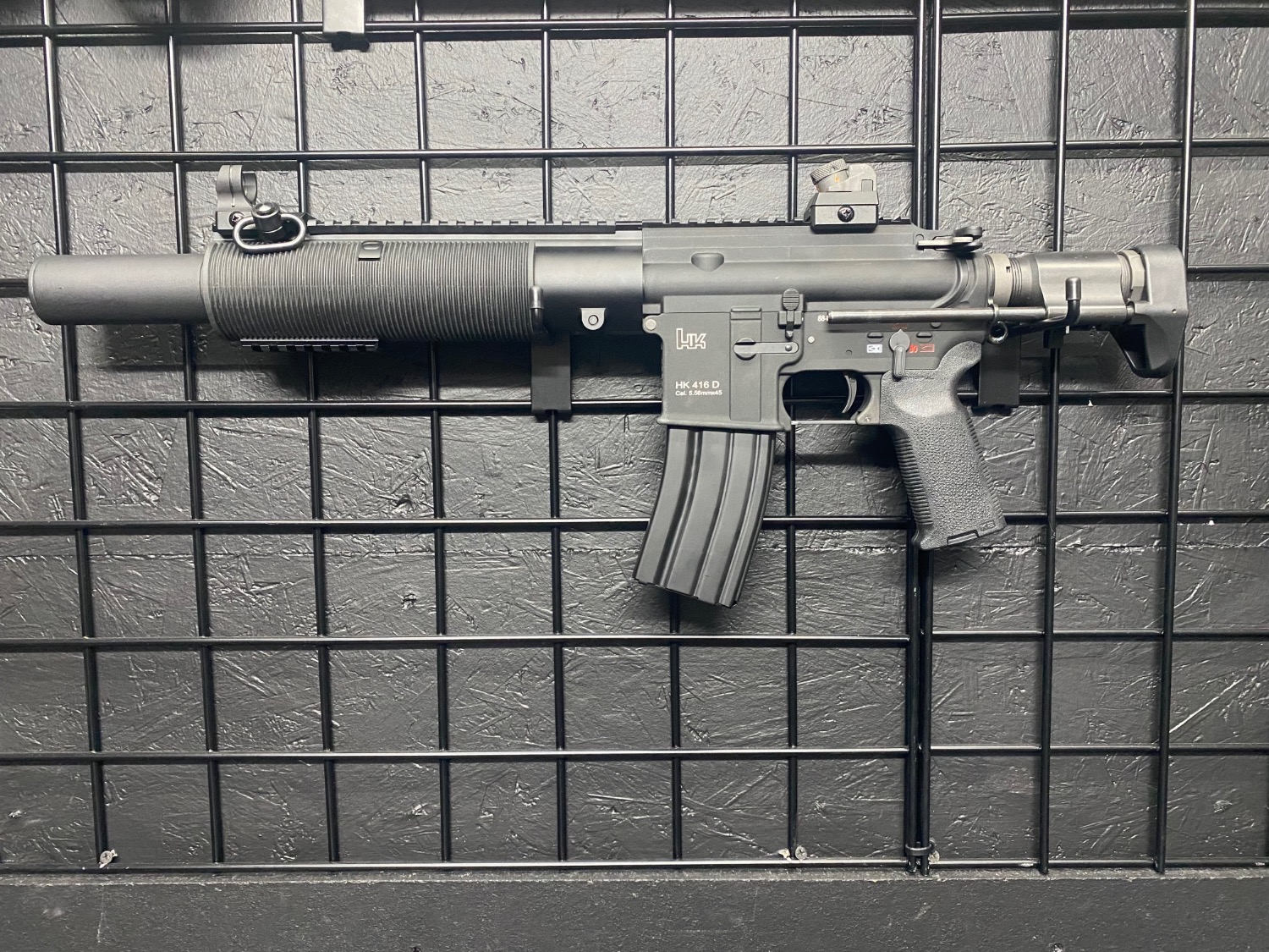

hunter511 Posted January 21, 2024 Posted January 21, 2024 (edited) Im officially intrigued. Anyone got any ideas for how to build one of these? Forgotten weapons strikes again. I can probs find the mp5 shroud and can I suspect its gonna be the front end underneath that'll be the issue. Edited January 21, 2024 by hunter511 _K4MF_ 1
JimFromHorsham Posted January 22, 2024 Posted January 22, 2024 9 hours ago, hunter511 said: Im officially intrigued. Anyone got any ideas for how to build one of these? Forgotten weapons strikes again. I can probs find the mp5 shroud and can I suspect its gonna be the front end underneath that'll be the issue. if I recall @Davegolfis building one , I went with a 416 SD6 ? Frank Castle, Mr Dellski and _K4MF_ 3

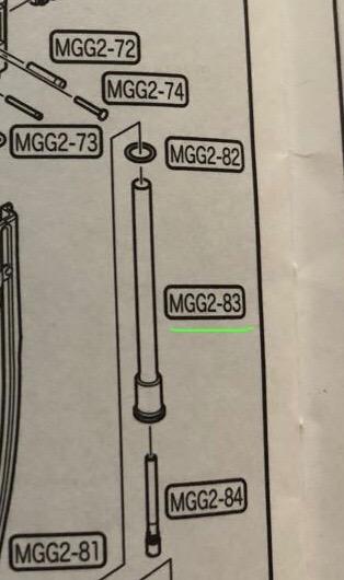

Ashbham Posted January 27, 2024 Posted January 27, 2024 Hi I have an MWS magazine and need to find the part MGG2-83 it is the part that screws into the bottom of the magazine and then the separate fill valve screws into this part, I’ve been trying to find a replacement part online but have had no luck Hopefully someone can help - I’m new to the MWS world kind regards Ash

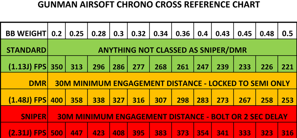

Frank Castle Posted February 21, 2024 Posted February 21, 2024 Hi all, great thread and it's convinced me to pick up a TM MWS GBBR. I was looking at a DMR build, site limits are 1.48 joules for a DMR at 400 fps on .2's. FPS chart below. I was wondering how far i could get bb's out to (Flat trajectory), on those fps limits - is 80 meters achievable? Would it be the following upgrades, Tightbore barrel - any suggestions on bore size and brand? - I could run a longer barrel into a suppressor if it helped achieve greater range. New nub - SiXG? New hop rubber - any suggestions NPAS - i think we have a few options now, is RA Tech the best one? What weight bb, i assume maybe .4's or as heavy as the hop can lift. Has anyone built a DMR, any suggestions? Looking at the m4 or the MK18 GBBR. Any help, info etc is much appreciated. Thanks, Mark
The_Lord_Poncho Posted February 21, 2024 Posted February 21, 2024 (edited) As an observation, that is quite a restrictive DMR rule at that particular site. Only 1.48j/400FPS AND a 30m MED is fairly punitive, and I'm not sure the extra few meters range that could be achieved with the additional circa .3J would in any way outweigh the disadvantage of a 30m MED. As a comparison, I'm used to playing at a site whose DMR rules are 1.88J (equivalent of 450fps on a 0.2g BB), and has a MED of 25m. The additional power allowable gives you a more meaningful edge over the typical AEG, and the slightly lower MED gives you less occasions when you need to switch to a sidearm, and more of a fighting chance to be within the useful range of your side arm when you do have to switch. Honestly, with the DMR rules at your site as they are, it would seem better to focus on squeezing all possible performance out of the gun whilst remaining below the standard 1.13J limit in my view. edit: to add, i would expect that the measures which you have listed would do a very good job of extracting maximum performance out of the rig, at whatever power level you decide upon, but i will defer to the opinions of others who have better knowledge of this particular platform. Edited February 21, 2024 by The_Lord_Poncho Impulse, Frank Castle and Nick G 3
Sewdhull Posted February 21, 2024 Posted February 21, 2024 (edited) In fairness few dmrs will meaningfully outrange a good aeg. But sniping is a laugh if the site suits it. As far as a dmr goes, good hop nozzle and barrel are really the things. Heavy BBS too and consistentcy OBS a little more joulage for another 10m of range. Tightbore Vs normal won't do much for anything really do long as the barrel is straight smooth and clean. Edited February 21, 2024 by Sewdhull Frank Castle 1
Frank Castle Posted February 22, 2024 Posted February 22, 2024 (edited) 16 hours ago, The_Lord_Poncho said: As an observation, that is quite a restrictive DMR rule at that particular site. Only 1.48j/400FPS AND a 30m MED is fairly punitive, and I'm not sure the extra few meters range that could be achieved with the additional circa .3J would in any way outweigh the disadvantage of a 30m MED. As a comparison, I'm used to playing at a site whose DMR rules are 1.88J (equivalent of 450fps on a 0.2g BB), and has a MED of 25m. The additional power allowable gives you a more meaningful edge over the typical AEG, and the slightly lower MED gives you less occasions when you need to switch to a sidearm, and more of a fighting chance to be within the useful range of your side arm when you do have to switch. Honestly, with the DMR rules at your site as they are, it would seem better to focus on squeezing all possible performance out of the gun whilst remaining below the standard 1.13J limit in my view. edit: to add, i would expect that the measures which you have listed would do a very good job of extracting maximum performance out of the rig, at whatever power level you decide upon, but i will defer to the opinions of others who have better knowledge of this particular platform. Yeah i did notice that after reading a few posts on here and thought that was a little low, you do make a good point and probably makes sense to build the best 1.13j gun i can within those FPS limits. I assume the most usable range then would be around 65 meters as that seems to be the magic number for most of the TM guns i see after a few upgrades. Is a bit of shame as i quite fancied a DMR but if its not going to out range a decent AEG by much then its not worth it. Edited February 22, 2024 by Frank Castle
