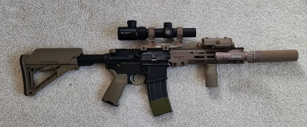

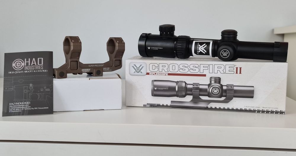

C-Diddy Posted March 22, 2022 Posted March 22, 2022 New scope and mount ready to go... ...and installed. Just waiting on a new Surefire M600 clone to replace the light, then I'll be done with this one. Then to tweak the MK18 build ?? lokkers, Wild Weasel, GothicGhost and 1 other 3 1
