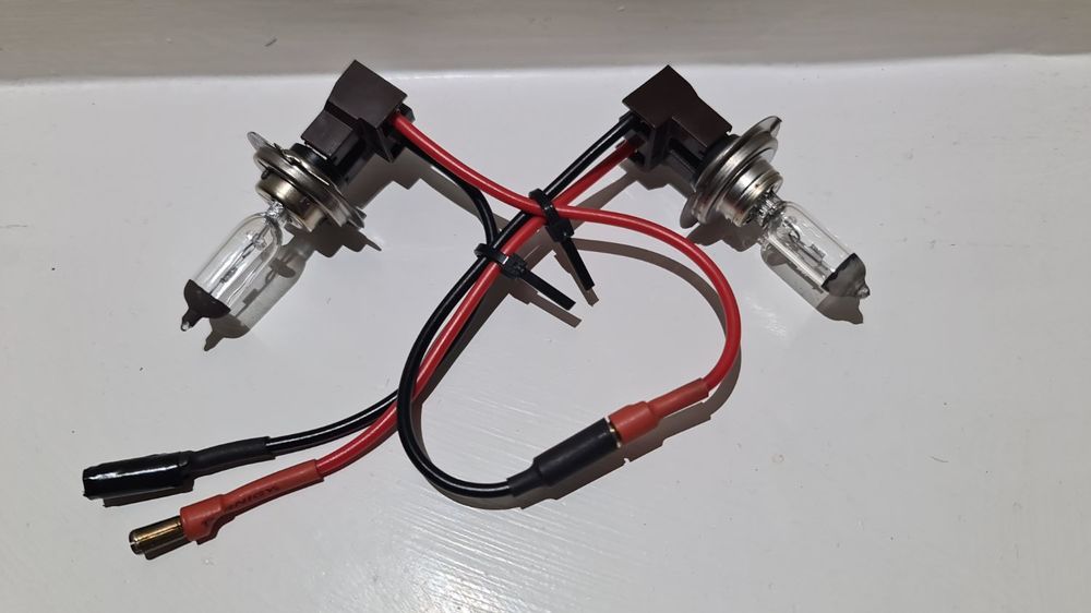

EDcase Posted October 7, 2021 Posted October 7, 2021 All good chargers require connecting the balance connector AND the main lead. I have an AEP LiPo for the MAC10 and I made an adaptor from the old charger base so I can connect it to the main leads on an IMAX B6. I think discharging to 'Store charge' is more of a concern for larger capacity packs, perhaps 11.1v and higher if unused for months at a time. I've never discharged a 7.4v battery and they are all good according to the meter.
