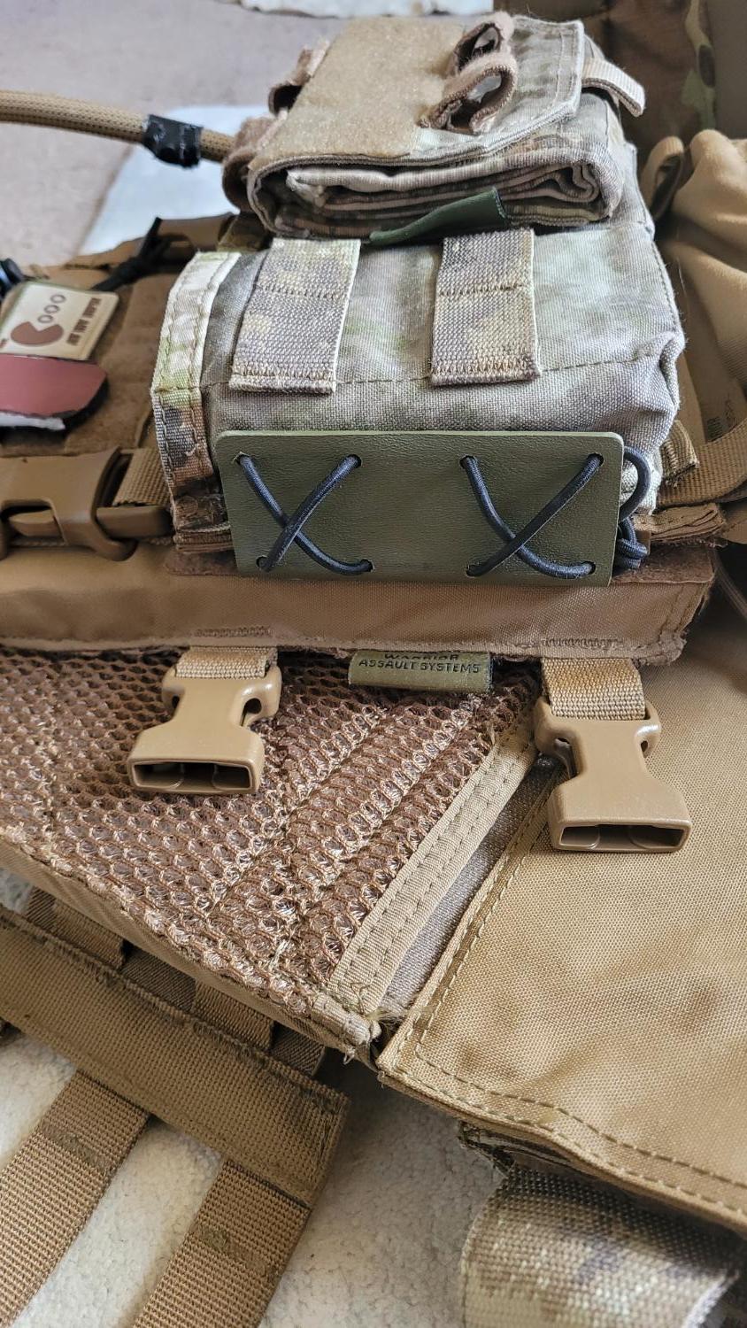

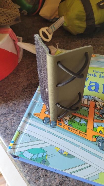

concretesnail Posted June 29, 2023 Posted June 29, 2023 Had some kydex leftover from a job so decided to use it up for a pyro/item holder. Lozart, OTH21 and SSPKali 3

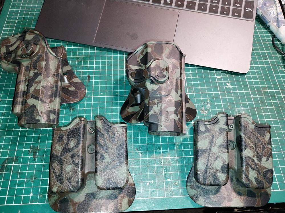

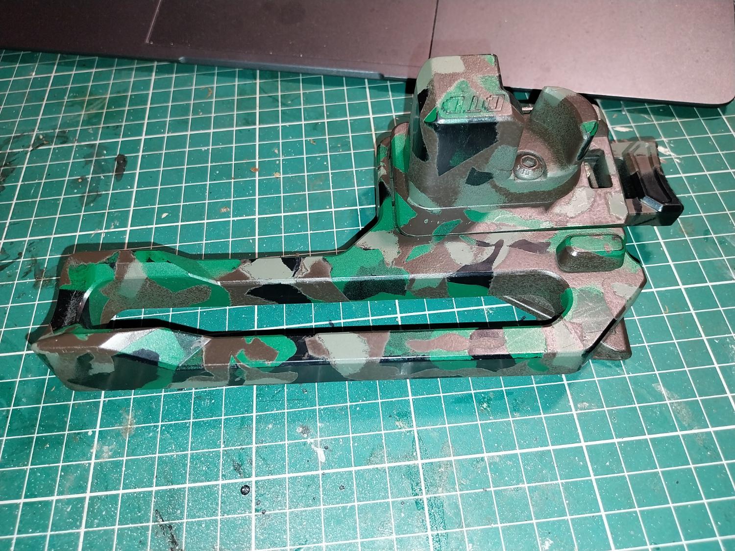

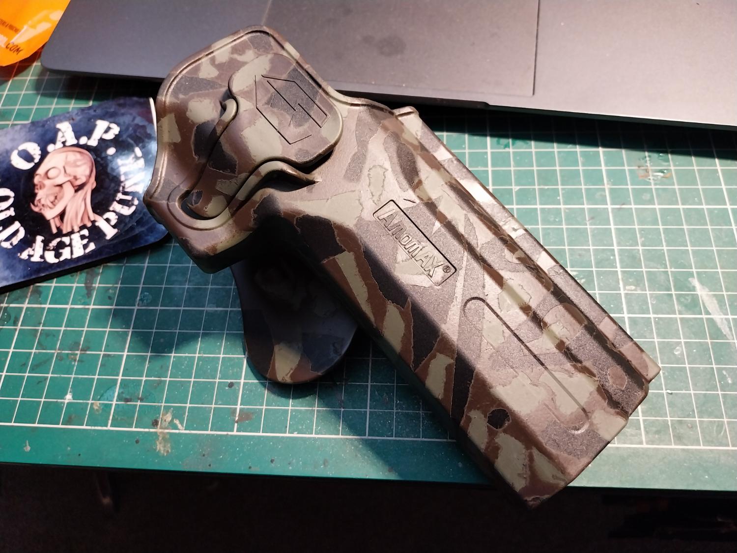

Skullchewer Posted July 20, 2023 Posted July 20, 2023 "Made" is a stretch, but I painted some holsters. TacticalWaifu and gavinkempsell 2
Skullchewer Posted July 20, 2023 Posted July 20, 2023 Also gave my mk23 holster a makeover. TacticalWaifu 1

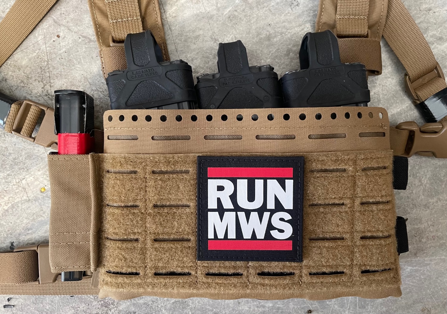

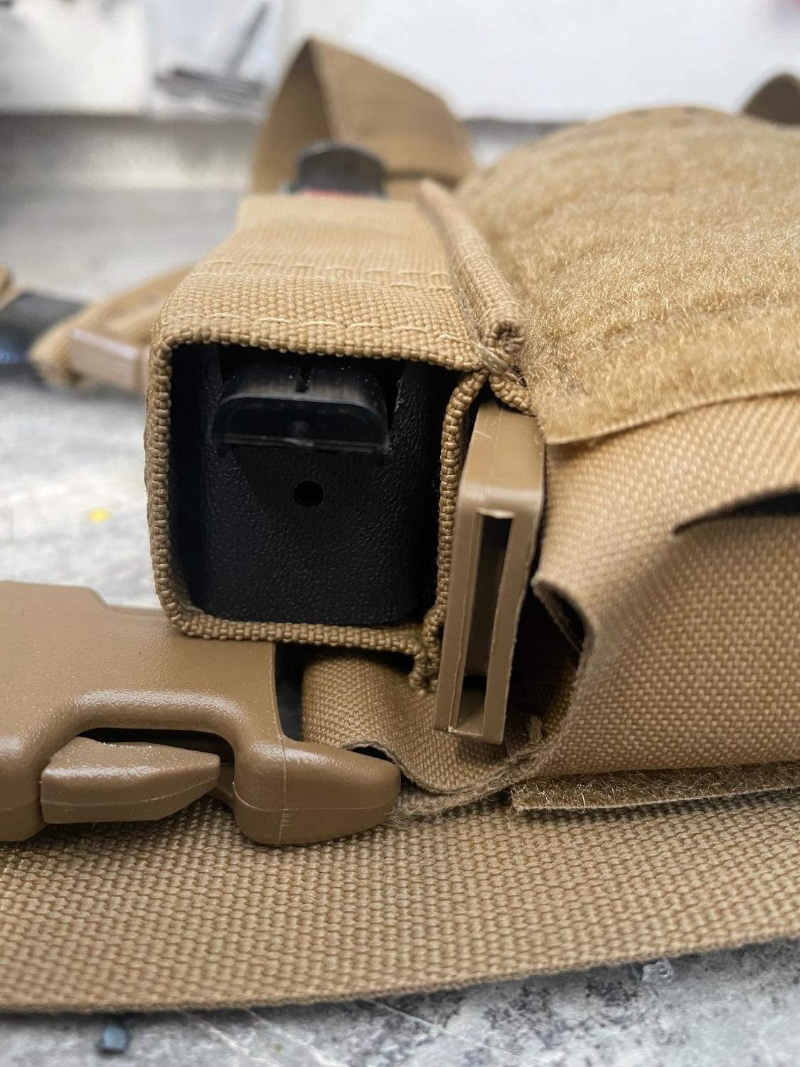

SSPKali Posted July 21, 2023 Posted July 21, 2023 Double gap pistol kywi became two pistol mag holders. One had the kydex insert trimmed to allow a speedloader to sit fully in the pouch. Added the modded one to the side of the Spiritus MkV to allow me to reload 3 MWS mags on the go. Saves lugging another 1.5kg of mags around ? Wavey_Gravey, Shamal and TheFull9 2 1

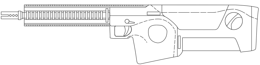

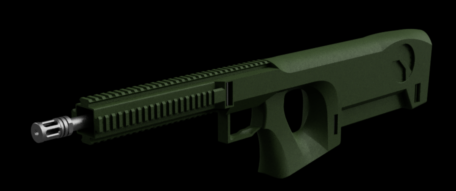

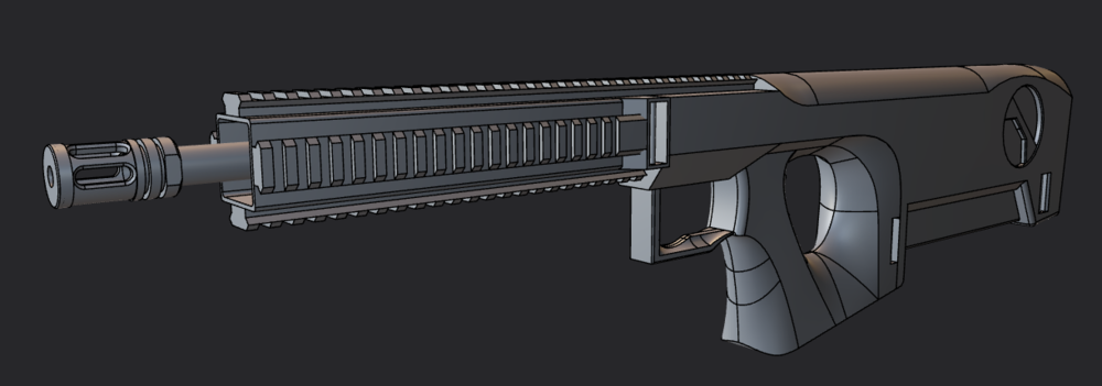

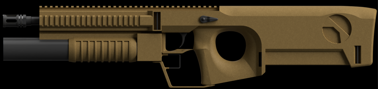

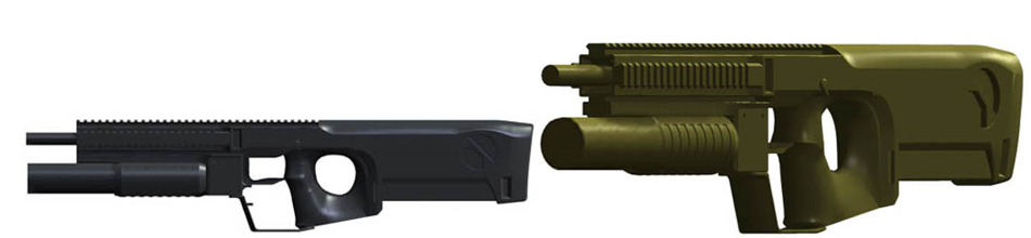

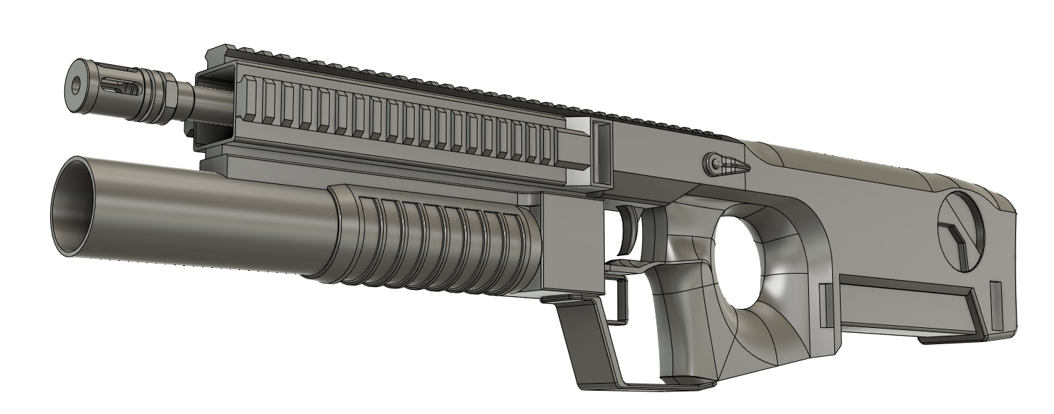

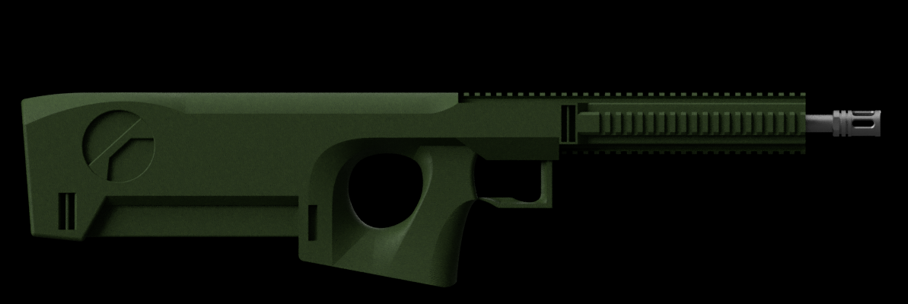

Speedbird_666 Posted August 12, 2023 Posted August 12, 2023 (edited) I have been slightly obsessed with the Crye MR-C after the Ghost Recon Advanced Warfighter game 'back in the day'. The gun itself was never more than a mockup - but I've always wanted to build one, even sketching out the idea in photoshop ~15 Years ago: I have been learning to use Plasticity 3D recently and I love it - so as a learning exercise I decided to try and build a 3D model of the MR-C based off the very few reference images of the real thing (there are loads of references of the in-game model but they are not particularly accurate) Mockup Pics: WIP Plasticity 3D: Quick and dirty Fusion360 Renders: Still got a fair bit to do - I'm not 100% happy with the grip shape and the mockups didn't have triggers, so I'll have to guess on that. I will also model the Grenade Launcher at some point too. Not sure if I can build it into any kind of functional airsoft gun - it would make a pretty cool wall-hanger. Edited August 12, 2023 by Speedbird_666 TheFull9 1
Speedbird_666 Posted August 15, 2023 Posted August 15, 2023 Pretty much finished the MR-C Model - I luckily came across a couple of official Crye renders of the gun (via the Internet Archive from Crye's own website ) which made me realise that the proportions were wrong. So I basically rebuilt the whole thing again, but I had a lot fun doing so. Seems like the real thing was a very small gun - just over 700mm, which is fixed-stock MP5 territory. @mightyjebus Don't suppose you have a V2 or V3 GB model that I can use to check if it's viable to build the gun? I did model one myself last year - but lost the file. TheFull9 and Tackle 1 1
mightyjebus Posted August 15, 2023 Posted August 15, 2023 This is the one I use: https://grabcad.com/library/airsoft-gearbox-v2-g-g-1#! looking at your model it looks like the V2 will be too tall so you have to get creative Speedbird_666 1
Speedbird_666 Posted August 15, 2023 Posted August 15, 2023 55 minutes ago, mightyjebus said: it looks like the V2 will be too tall so you have to get creative You are right. The GB will fit - but a motor will not. Oh well. If I had money I would consider an HPA-specific build negating the need for the GB shell/motor, but that's out of my price range. Finding a long enough length of Picatinny extrusion for the upper rail in the UK is a ballache as well (the front end would be a 38mm Aluminium box extrusion with metal rail segments bolted on) so I will shelve the idea. Had fun putting the model together though.
