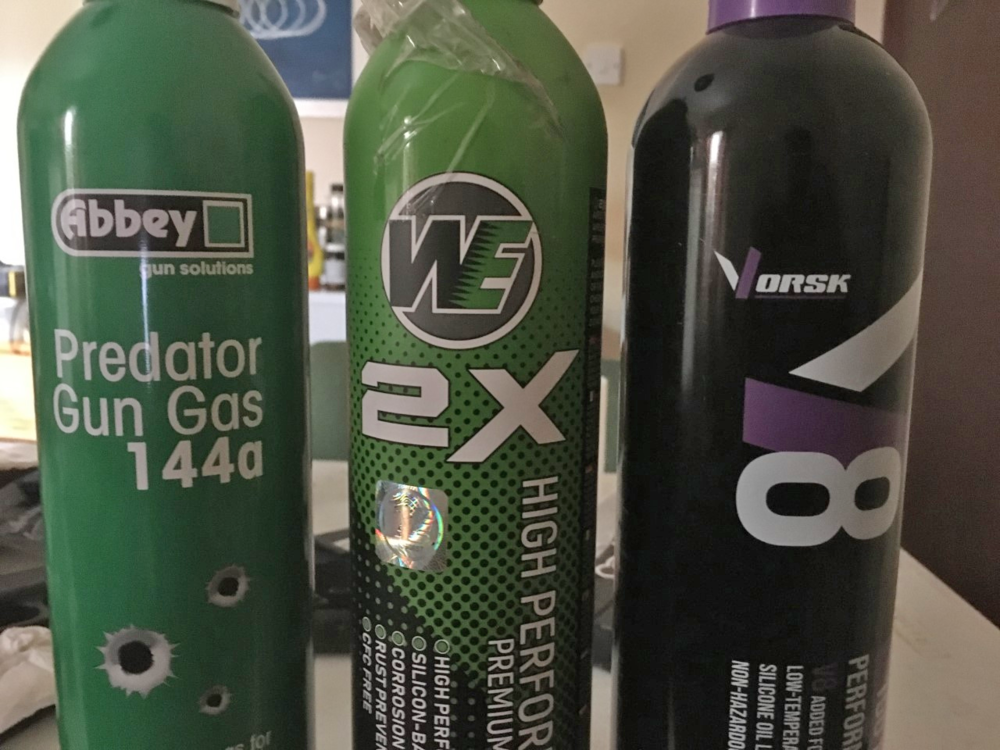

Guest Mr. No_Face Posted April 8, 2022 Posted April 8, 2022 (edited) 6 minutes ago, rocketdogbert said: each with a new nozzle? Or the same one? Both the TM and alleged "DP reinforced nozzle" which actually turned out to be the same piece of plastic trash - rebranded and sold for an extortionate price. Edited April 8, 2022 by Mr. No_Face

Guest Posted April 8, 2022 Posted April 8, 2022 Just now, Mr. No_Face said: Both the TM and alleged "DP reinforced nozzle" which actually turned out to be the same piece plastic trash - rebranded and sold for an extortionate price. Sorry, that’s not clear. Did you use the same components to test the lower pressure gas after the V8, or did you replace everything that broke? And have you inspected the whole gun for damage? I get that you’re p****d off, but up until now, the only issues anybody in this thread, or anywhere else that I have ever read about, or talked to, is the nozzle return spring breaking through fatigue. Hard as it is to stomach, it is VERY likely you’ve broken something or more than one something using the V8 gas. It could be something straightforward like the gas release valves in the mags now allowing far to much pressure into the gun, or something way more serious like scored internal components, or actually cracked components. All of that will put pressure on standard components and cause them to break again, and again, and again. Sorry dude, but it’s not the gun, it’s something you’ve done, and until you realise that and put it right, you’re not going to fix the problem 5 minutes ago, Wavey_Gravey said: Like the previous page, take that charging handle out and try it with the original. @Mr. No_Face You said it was umodified ??♂️
