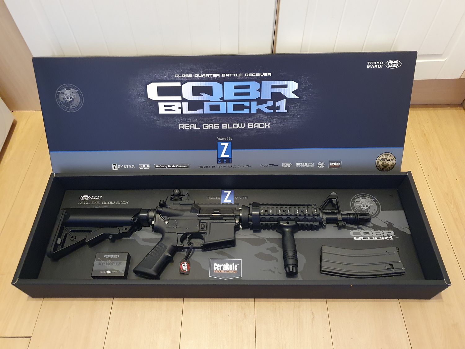

Popular Post RMDavis Posted June 29, 2020 Popular Post Posted June 29, 2020 Finally a paid up member of the fine MWS club! This beauty arrived today, and now the real fun begins, turning this CQBR into a URGI style 10.3" build! Wo1f, Crazy_Crystal, Wild Weasel and 6 others 5 4
AlphaBear Posted June 29, 2020 Posted June 29, 2020 4 minutes ago, RMDavis said: Finally a paid up member of the fine MWS club! This beauty arrived today, and now the real fun begins, turning this CQBR into a URGI style 10.3" build! Its all shiny and soooo new! Just like that new car smell On a serious note, should I take the plunge too? All I hear is MWS these days... it's like the recoils are dying off and everyone is moving over to this platform....well the serious players are at least... Food for thought
LVOA-D Posted June 29, 2020 Posted June 29, 2020 55 minutes ago, AlphaBear said: On a serious note, should I take the plunge too? Yes. AlphaBear and RMDavis 2
Wo1f Posted June 29, 2020 Author Posted June 29, 2020 1 hour ago, LVOA-D said: Yes. What he said AlphaBear and RMDavis 2
Crazy_Crystal Posted June 29, 2020 Posted June 29, 2020 you won't regret it... don't even have to change anything if you don't want too... RMDavis and AlphaBear 2
AlphaBear Posted June 29, 2020 Posted June 29, 2020 15 minutes ago, Wo1f said: Damn! That does look good! I'd better start reading up about the platform then......

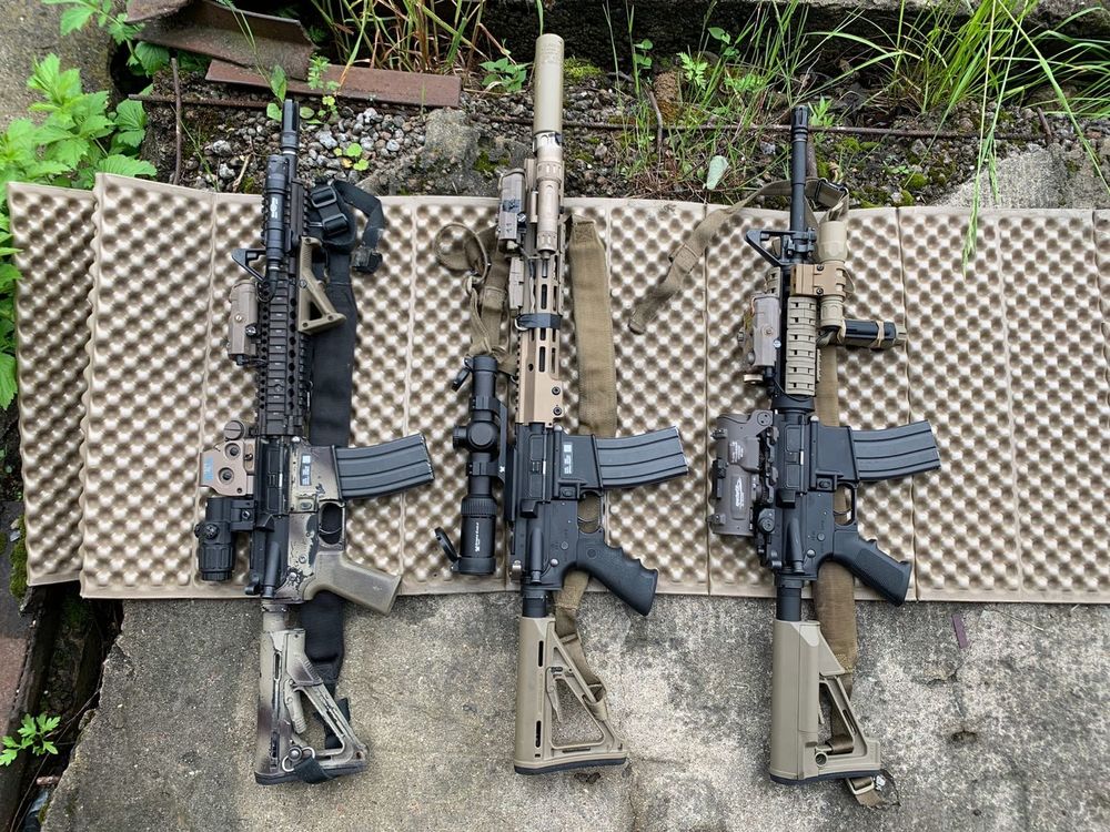

mr_anderson Posted July 1, 2020 Posted July 1, 2020 New to this forum, but not new with MWS. Here is what we have in our team (mine in the middle? quango2k, Tec-Spek, SSPKali and 1 other 3 1
