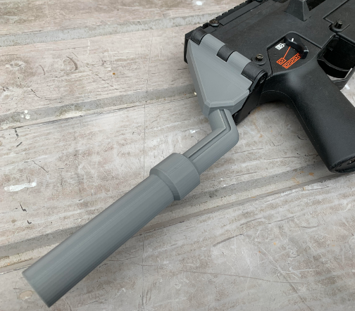

Shamal Posted August 23, 2021 Posted August 23, 2021 4 hours ago, Speedbird_666 said: 17 Hours later, I have half a stock: Print came out really nice though. Other half has just started I'm spending so much time printing stuff now (airsoft isn't my only hobby) that I'm seriously toying with the idea of buying (or even building) another printer. I'm really tempted to go down the Voron route for high-speed printing goodness. Hi? Would your machine be able to make the plastic component from a specna arms sae-05 charging handle? ? Regards

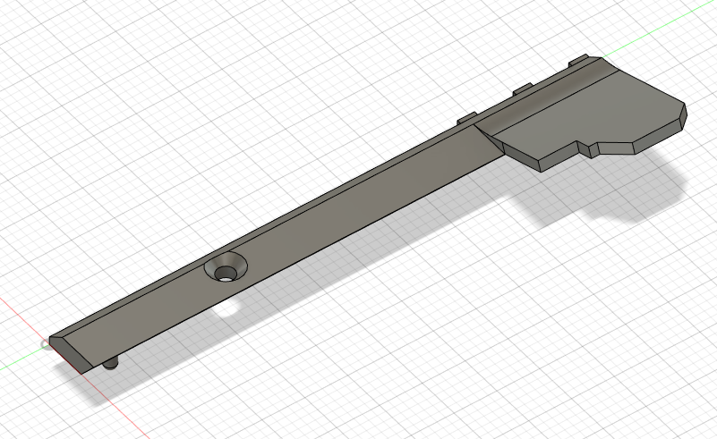

Speedbird_666 Posted August 24, 2021 Posted August 24, 2021 @Shamal I've knocked up the design in CAD. I'll print a test one this afternoon and see how it fits. If I can get the design to work properly in the gun I'll send you a couple for the price of postage?

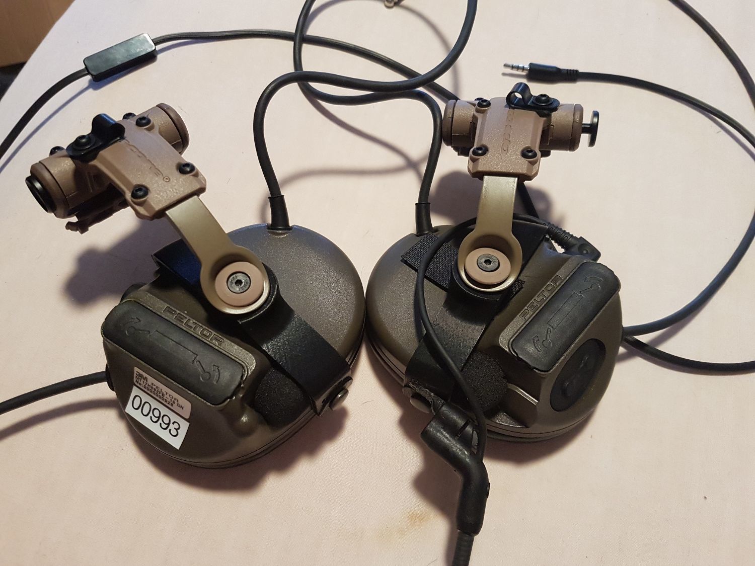

Popular Post Chev Chelios Posted August 24, 2021 Popular Post Posted August 24, 2021 In the middle of adding a load of blower fans to my helmet when I came across this little gem https://cults3d.com/en/3d-model/tool/amp-arc-rail-comtac-iii-adapter now us Peltor using hobbits can still have the sexy OPS core AMP mounts with out paying out £80 for the AXL adapters or £1500 for replacement AMPs although still jelly of the 3d amplified hearing on the AMPs its almost like video game hacks. Loving this thread BTW. Speedbird_666, Monkman, Panama and 2 others 4 1
Speedbird_666 Posted August 25, 2021 Posted August 25, 2021 @Shamal Took a while, but I think I've got it working good now (just tested it for 100+ cycles). Needed a few iterations and testing of the print orientation to maximise strength, the first prototype snapped instantly on a layer line with a vertical print, horizontal print was too flexible so ended up at 45deg. I beefed up the part thickness and added a strengthening rib running down the length it. I also had to extend the tab that hits the dust cover by 1MM for reliable opening. I'll print some more of the final design in the next few days so you'll have spares. Lozart 1
Shamal Posted August 25, 2021 Posted August 25, 2021 5 hours ago, Speedbird_666 said: @Shamal Took a while, but I think I've got it working good now (just tested it for 100+ cycles). Needed a few iterations and testing of the print orientation to maximise strength, the first prototype snapped instantly on a layer line with a vertical print, horizontal print was too flexible so ended up at 45deg. I beefed up the part thickness and added a strengthening rib running down the length it. I also had to extend the tab that hits the dust cover by 1MM for reliable opening. I'll print some more of the final design in the next few days so you'll have spares. Wow that's great! ? Yes that 1mm extra makes a difference with regards to reaching release mechanism. I'm sure it will be better than original? Thanks very much? Regards

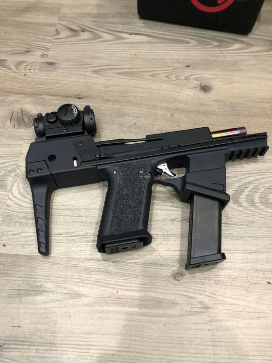

Popular Post jajaja Posted August 26, 2021 Popular Post Posted August 26, 2021 Spending a year on developing a glock pdw frame(spare mag font grip, 4 level retractable stock, build in magwell,raiser optics & flashlight mount,double side qd sling, silencer compatible) SilentSparky, sjhirst, Speedbird_666 and 5 others 5 3

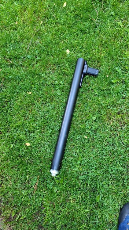

concretesnail Posted August 28, 2021 Posted August 28, 2021 Finished the mortar tube. PopRocket123, Speedbird_666 and Tackle 3

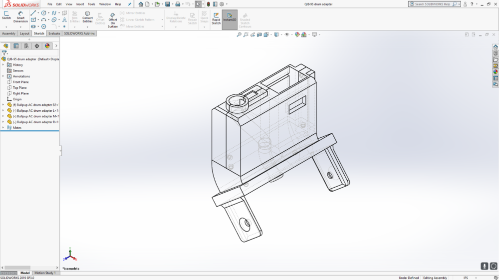

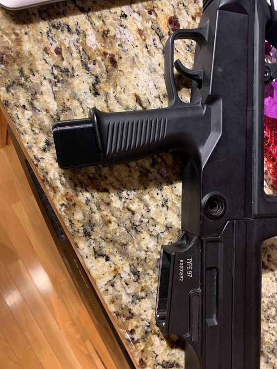

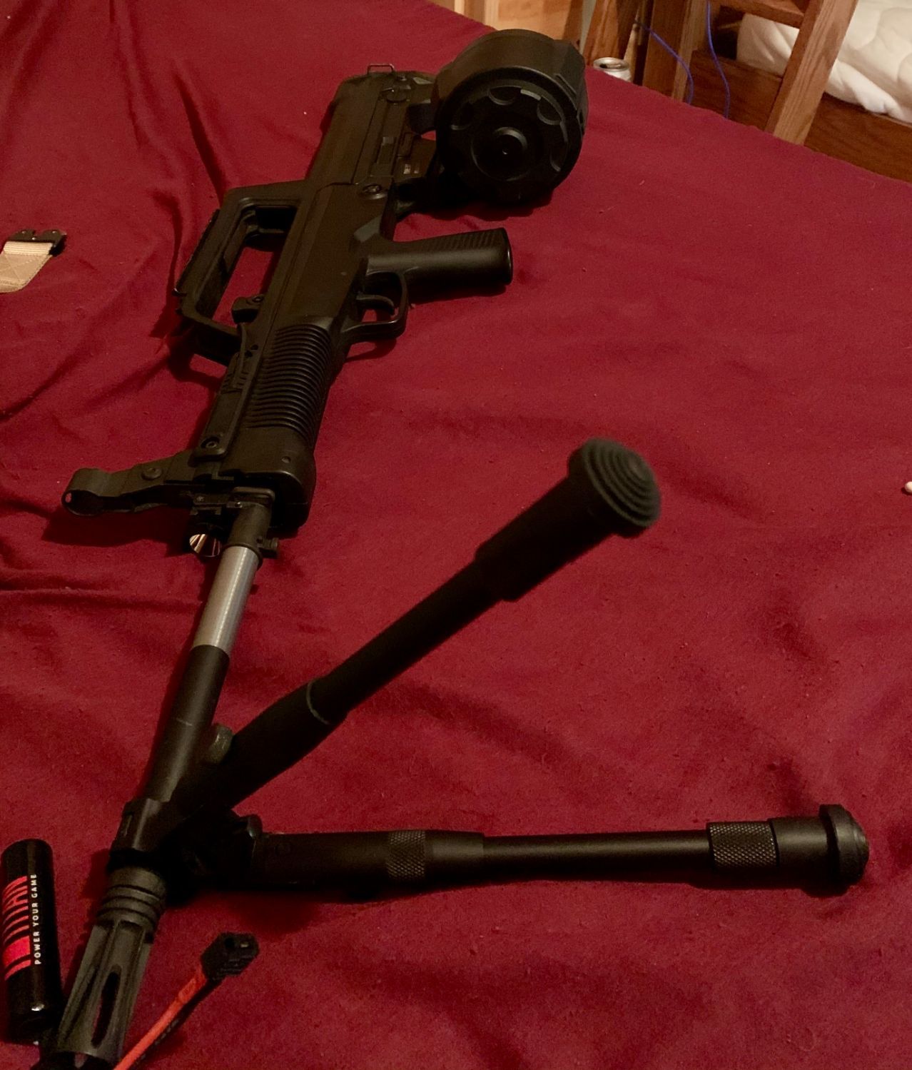

Supporters SeniorSpaz87 Posted August 30, 2021 Supporters Posted August 30, 2021 Looks like my custom parts for my QBJ-95 build are done. 4 part AC drum adapter, barrel cover, and battery extension all done. I am looking into getting a real RPK bipod to complete the look, and if that occurs I may redesign the cover, but for now its done. Assembly is tomorrow. Speedbird_666 1
Speedbird_666 Posted August 30, 2021 Posted August 30, 2021 5 hours ago, SeniorSpaz87 said: Looks like my custom parts for my QBJ-95 build are done. 4 part AC drum adapter, barrel cover, and battery extension all done. I am looking into getting a real RPK bipod to complete the look, and if that occurs I may redesign the cover, but for now its done. Assembly is tomorrow. Very nice mate. Will you be SLS printing the Mag adapter at some point?
Supporters SeniorSpaz87 Posted August 31, 2021 Supporters Posted August 31, 2021 15 hours ago, Speedbird_666 said: Very nice mate. Will you be SLS printing the Mag adapter at some point? Im... Unsure. I have several parts made in SLS so far, and its certainly the superior material, but it does get pricey. Once this hurricane moves on I will fill the drum with ammo and go stress test it. If the epoxy fails Ill need to redesign it to use bolts, and if the PETG fails then I will need to get it done in SLS. But for now itll stay as PETG.
