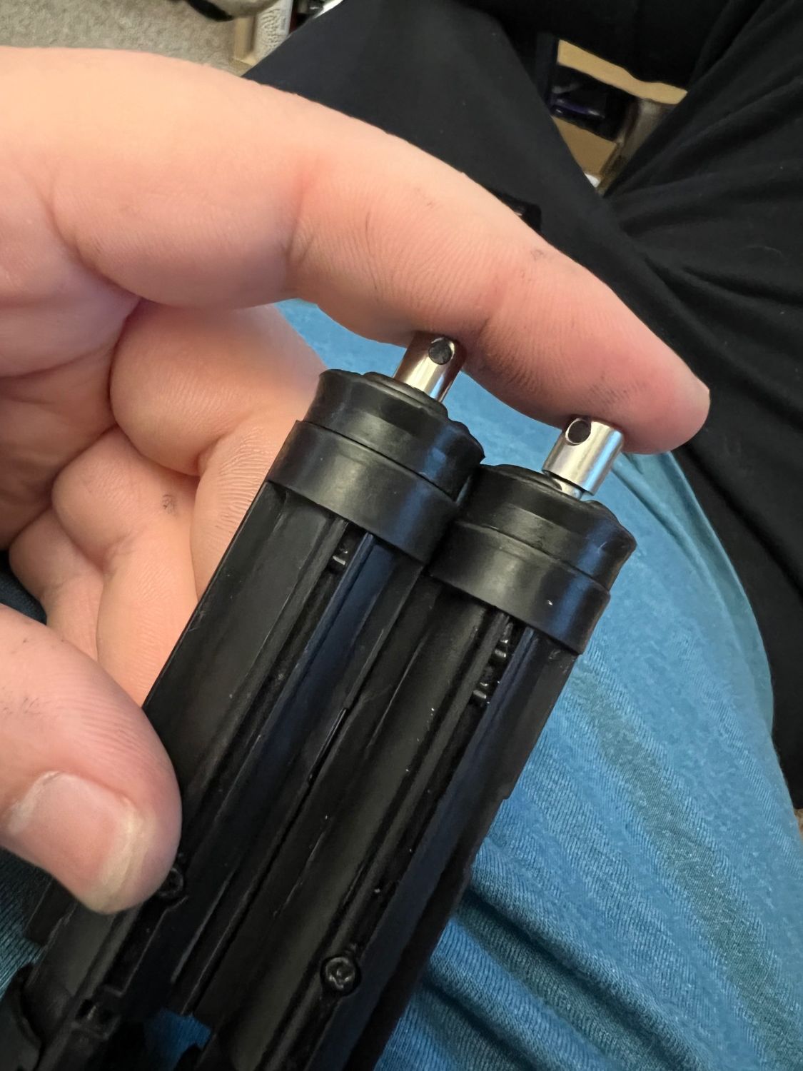

ArranTurner Posted May 7, 2022 Posted May 7, 2022 Anyone have any idea if there are multiple versions of the stock TM nozzle? notice one has 1 indent, and the other has 2 indents, the one with 2 indents is around 3mm shorter and has issue sealing with the bucking any ideas?
AlphaBear Posted May 8, 2022 Posted May 8, 2022 Well that's new.... well more so interesting to say the least. I'll have a look at my spare nozzles later and see if they have one or two indents.. I'm surprised there are 2 variations though.... Most unusual!
SSPKali Posted May 8, 2022 Posted May 8, 2022 The old one from my MWS has 2 ridges, probably 5years old. Will check the newer ones I can check later in the week.
ArranTurner Posted May 8, 2022 Posted May 8, 2022 Interested to here what everyone else are like, also the metal piece the nozzle return spring connects to (not really sure what it’s called!) is slightly different on both, one is chamfered and the other is radiused, I’ve not had either rifle from new so it is possible it’s not OEM, but I can’t find anything similar online!
Khyber Posted May 8, 2022 Posted May 8, 2022 (edited) 12 minutes ago, ArranTurner said: Interested to here what everyone else are like, also the metal piece the nozzle return spring connects to (not really sure what it’s called!) is slightly different on both, one is chamfered and the other is radiused, I’ve not had either rifle from new so it is possible it’s not OEM, but I can’t find anything similar online! On mine the cut is radiused. It was bought new this year if that helps... If your one that seals better is also radiused then that could show an improvement on newer revisions? Edited May 8, 2022 by Khyber
ArranTurner Posted May 8, 2022 Posted May 8, 2022 32 minutes ago, Khyber said: On mine the cut is radiused. It was bought new this year if that helps... If your one that seals better is also radiused then that could show an improvement on newer revisions? Cheers for that, really interesting, I’ll check later which is the better sealing one, but agreed, could definitely be an update, Marui seem to be really good at that Khyber 1

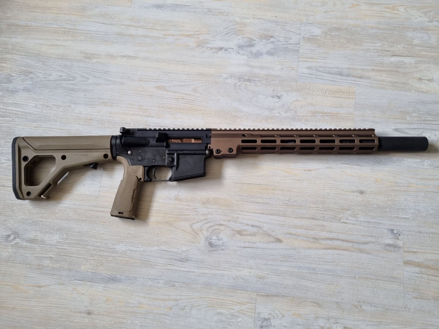

MAX DICKER Posted May 11, 2022 Posted May 11, 2022 On 10/05/2022 at 10:22, werkzeug said: I was looking at those handguards, it’s literally out of stock everywhere, or simply I’m not able to Google it somehow. 9.3” and FDE colour is what I need. About the barrel nut, do you use an adapter to fit the thing to the MWS or is it just machined right to fit to the MWS? Is there a common name for MWS barrel nut? https://www.fire-support.co.uk/product/angrygun-mk16-m-lok-rail-93-inch---gen-2-version-desert-dirt-color Angry Gun do one, I have the 13.5" version that's going on my upper build
