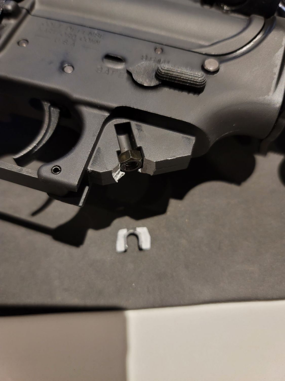

costpershot Posted April 7, 2022 Posted April 7, 2022 Hey guys. Received my TM MWS (mk18) yesterday and happy to be joining the MWS gang. I swapped out the stock grip today for a magpul K2 and noticed alot of wobble after some use. Attached is what I see after removing the grip. I'm super disappointed (mostly at myself, I assume I may have over-torqued the bolt?) but am I totally screwed here? Do I have any options other than replacing the entire lower frame? I also assume this is not something TM's warranty would cover since it happened during a modification. Any help/insight would be much appreciated. C-Diddy and AlphaBear 2
AlphaBear Posted April 7, 2022 Posted April 7, 2022 6 minutes ago, costpershot said: Hey guys. Received my TM MWS (mk18) yesterday and happy to be joining the MWS gang. I swapped out the stock grip today for a magpul K2 and noticed alot of wobble after some use. Attached is what I see after removing the grip. I'm super disappointed (mostly at myself, I assume I may have over-torqued the bolt?) but am I totally screwed here? Do I have any options other than replacing the entire lower frame? I also assume this is not something TM's warranty would cover since it happened during a modification. Any help/insight would be much appreciated. Crikey fella! Did you eat too much spinach or something? Sadly TM will not cover that. In fact you can seldom make a warranty claim as the RIF would only be covered by the retailer if it was indeed a manufacturing error. Luckily I believe someone is selling a lower receiver in the classifieds on here. I suggest grabbing it if it’s available. C-Diddy 1
C-Diddy Posted April 7, 2022 Posted April 7, 2022 13 minutes ago, costpershot said: Hey guys. Received my TM MWS (mk18) yesterday and happy to be joining the MWS gang. I swapped out the stock grip today for a magpul K2 and noticed alot of wobble after some use. Attached is what I see after removing the grip. I'm super disappointed (mostly at myself, I assume I may have over-torqued the bolt?) but am I totally screwed here? Do I have any options other than replacing the entire lower frame? I also assume this is not something TM's warranty would cover since it happened during a modification. Any help/insight would be much appreciated. Wow! I think you may have used just a smidge more torque than necessary. Out of interest, did you use the bolt that came with the grip or the original TM one? Everything I read said to use the OG bolt. That worked like a charm when I fitted my MOE+ grip, and I'm generally heavy-handed. As Alpha said, look for that lower in the classifieds and best of luck ? AlphaBear 1
alxndrhll Posted April 7, 2022 Posted April 7, 2022 15 minutes ago, costpershot said: Hey guys. Received my TM MWS (mk18) yesterday and happy to be joining the MWS gang. I swapped out the stock grip today for a magpul K2 and noticed alot of wobble after some use. Attached is what I see after removing the grip. I'm super disappointed (mostly at myself, I assume I may have over-torqued the bolt?) but am I totally screwed here? Do I have any options other than replacing the entire lower frame? I also assume this is not something TM's warranty would cover since it happened during a modification. Any help/insight would be much appreciated. I’d probably give gluing the nut in a place a shot before spending out for a new lower. Slap some JB Weld (or whatever your super strong choice of swaz may be) on the edges of the nut which contact the notch, then feed the grip on slightly and start threading the bolt on. This should ensure you’re lined up, once the adhesive has cured pop the grip all the way on and see how happy you are. Obviously you could just slap a heap of glue on the lot and slam the grip all the way on, but I suspect that grip is essentially a permanent addition at that point.
Jacket Posted April 7, 2022 Posted April 7, 2022 I just sold my lower with trigger mech, the buyer only wanted the trigger and body pins so may be willing to sell the lower @zehave
Davegolf Posted April 7, 2022 Posted April 7, 2022 (edited) @costpershot looks like your cost per shot is damn expensive ? Seriously if you send me the lower I can drill and tap a repair plate on to make the nut captive again. Ultimately though if you can get another lower cheap that is best. Was the grip a clone? They normal fit up pretty snug with zero movement - eg the bolt only literally holds it on, otherwise the large mating face takes all of the loading and stress. Edited April 7, 2022 by Davegolf
costpershot Posted April 7, 2022 Posted April 7, 2022 (edited) Man - you guys are the best. Thanks for all the responses. @Davegolf - Thanks so much. I will PM you for details. The grip is not a clone as far as I can tell - it did mate well to the receiver and only "wobbled" after this happened and the bolt came loose. And LOL yes this is what inspired my username. @Jacket - Thanks Jacket. Will PM you and see if we can work something out. @alxndrhll - Thanks for the suggestion - I was thinking along similar lines and am trying it as we speak (waiting for the glue to cure lol) @C-Diddy - I used the OG bolt - i used a socket rachet which may have been the wrong call in hindsight lol. @AlphaBear - thanks AlphaB. Figured it wouldn't be covered, but thought I'd ask. Appreciate you guys! Edited April 7, 2022 by costpershot AlphaBear and C-Diddy 2
