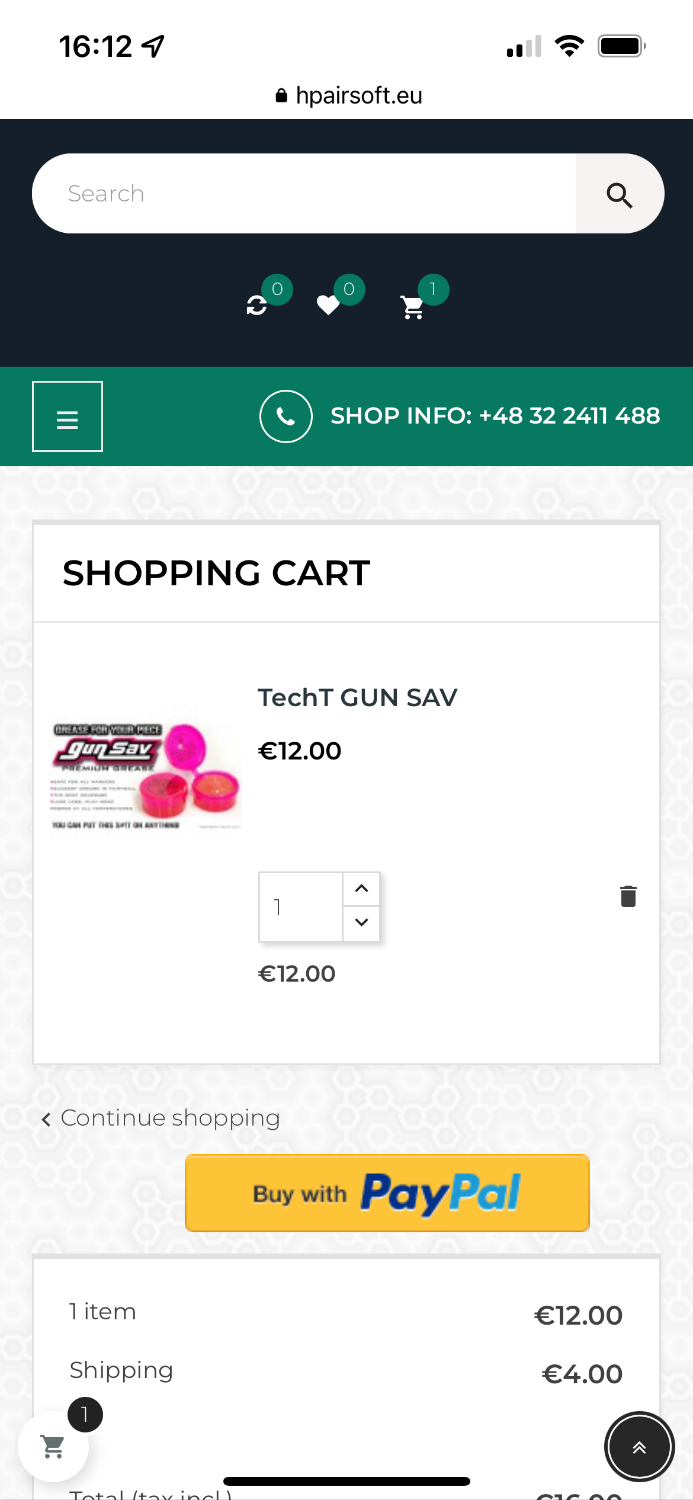

Noddy45 Posted January 22, 2022 Posted January 22, 2022 4 hours ago, Davegolf said: TechT gunsav for air seals - out of stock everywhere, let me know if you find some! And Parker Hale gun oil for metal on metal / trigger pack / charging handle / buffer spring. If you have HSB you’ll have Moly grease on your buffer spring. Is this it - In stock here but it’s a French site €9.00 so not sure it import charges Paul72 1
Davegolf Posted January 22, 2022 Posted January 22, 2022 That’s the stuff ? Do the deliver to the UK? Paul72 1
Noddy45 Posted January 22, 2022 Posted January 22, 2022 29 minutes ago, Davegolf said: That’s the stuff ? Do the deliver to the UK? Looks like they do but I didn’t realise at the time of posting they were taking the piss with shipping charge €22.00 i found it here also and they seem reasonable for shipping - they don’t say they do or don’t ship to UK - you would have to open an account to see I suppose Paul72 1
