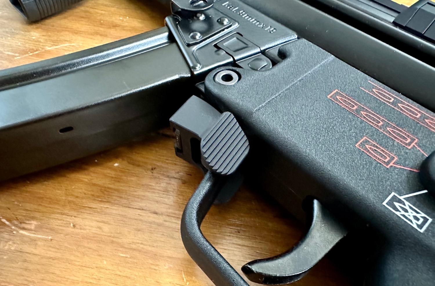

u6c2 Posted February 25, 2024 Posted February 25, 2024 Thanks all for the replies. Is anyone rocking the extended mag release for their MP5? I have read that the cyma one will fit, which would be ideal since its a lot cheaper and still made from metal. Or do I need to cough out for a specially made one?
Sewdhull Posted February 26, 2024 Posted February 26, 2024 I can measure my mag release (cyma mp5) if you want, you measure yours and compare? The TM one has two grub screws the others have one. The TM one is an anodized machined aluminium part ( maybe cast or from a lump) and the others, mim.
Mr Dellski Posted March 9, 2024 Posted March 9, 2024 On 25/02/2024 at 14:51, u6c2 said: Thanks all for the replies. Is anyone rocking the extended mag release for their MP5? I have read that the cyma one will fit, which would be ideal since its a lot cheaper and still made from metal. Or do I need to cough out for a specially made one? Do you mean this?… WiiTech CNC part, two little grub screws to secure it. Works really well for fast mag changes.. just push forward with trigger finger to release ??
u6c2 Posted April 14, 2024 Posted April 14, 2024 On 09/03/2024 at 12:49, Mr Dellski said: Do you mean this?… WiiTech CNC part, two little grub screws to secure it. Works really well for fast mag changes.. just push forward with trigger finger to release ?? Yeh, that's the one.. hoping to save a few quid if the cyma one fits. But may need to just bite the bullet Mr Dellski 1
