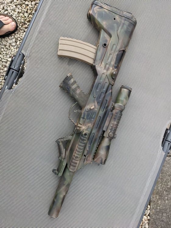

Bit it's up to u as its Airsoft . I built a aps bullpup gun into one and its pretty dam good . Quiet for AEG as have the extra sound deadening of the gearbox on ur shoulder . Takes a 509 tbb with ease and no longer than a stock mp5. Gearbox is at back with quick change spring so two minutes to change . Also on escrew to take out ? Will get pic up later
