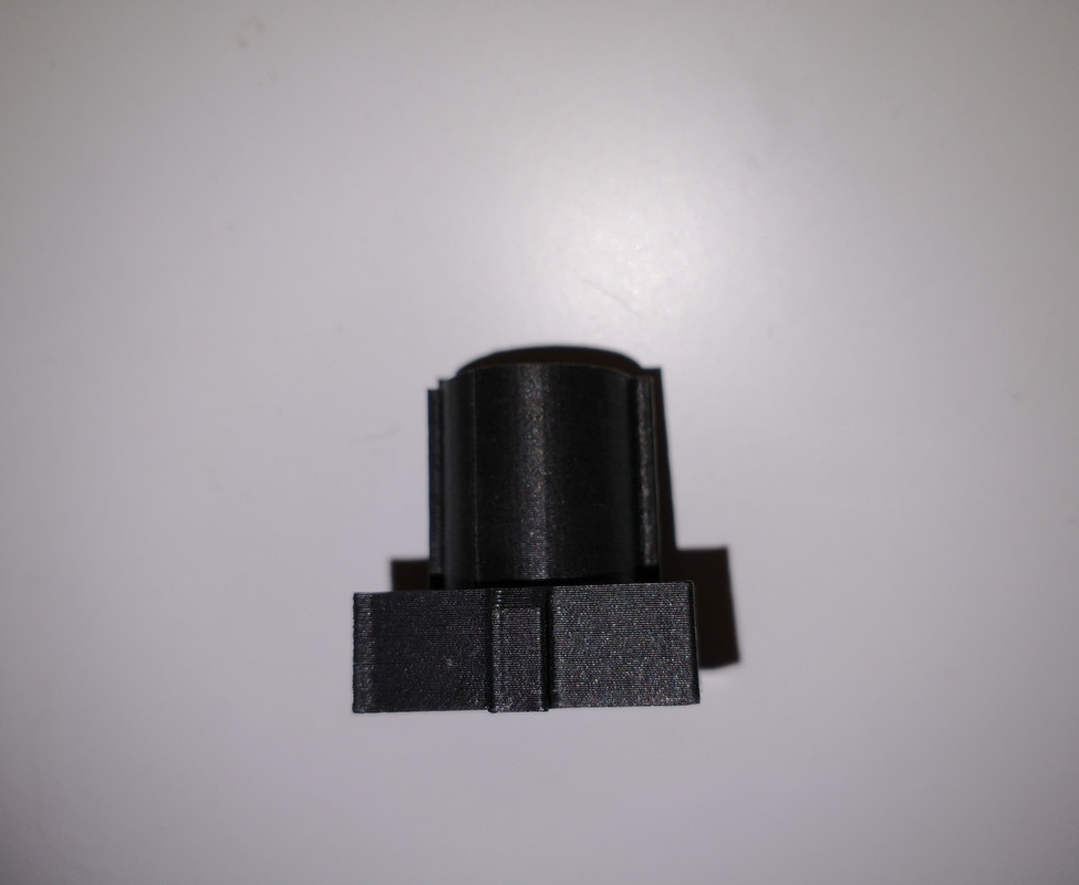

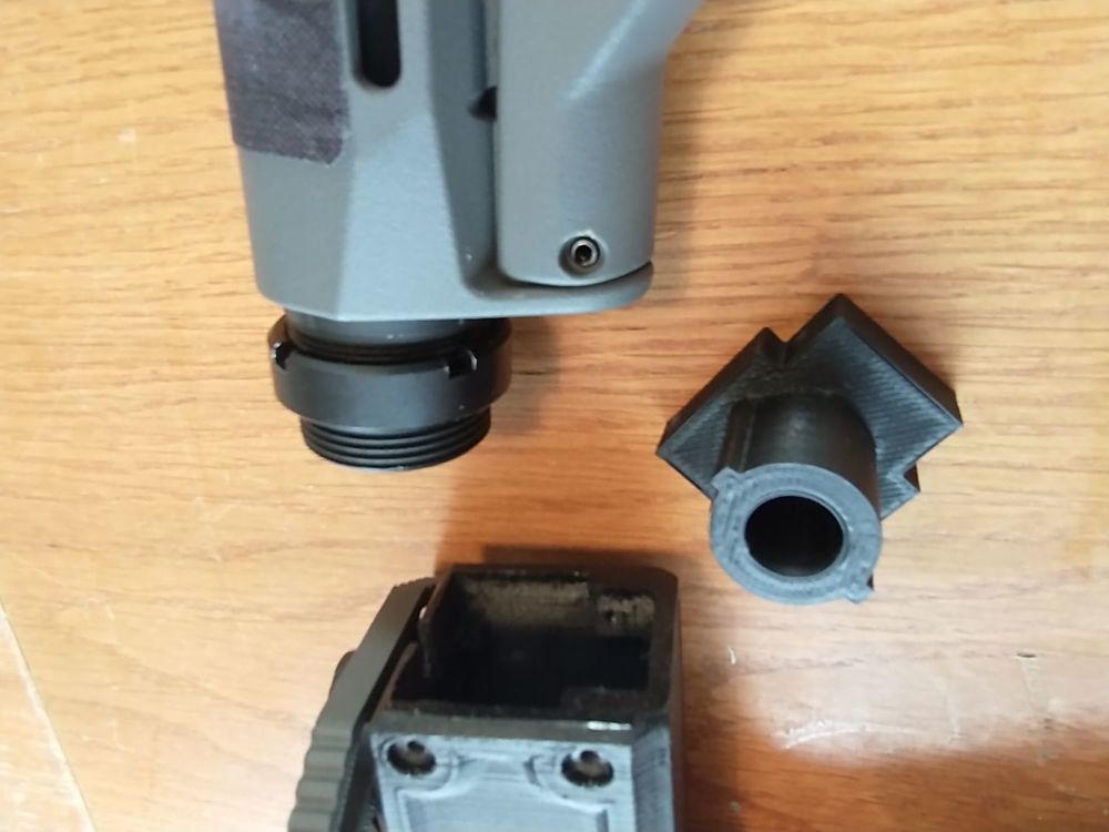

GothicGhost Posted March 22, 2021 Posted March 22, 2021 Quick question, how hard would it be to replicate this 3D printed m4 stock adapter? I would like to have another one at some point, thanks.
Piman Posted March 23, 2021 Posted March 23, 2021 10 hours ago, GothicGhost said: Quick question, how hard would it be to replicate this 3D printed m4 stock adapter? I would like to have another one at some point, thanks. That is not difficult but is not going to be very strong. Have you used it yet? The main load is in it's weakest axis (i.e. between the layers). Drop the gun on it's stock and I can see that snapping very easily. 3D printing is good for a lot of things but you need to choose carefully where you use it. Is there no commercial version you could buy? I would expect it to not be much mire than the cost of a 3D print.

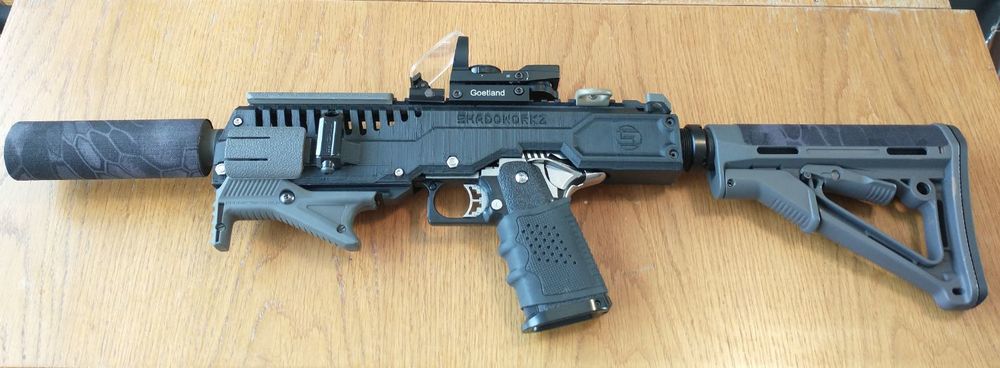

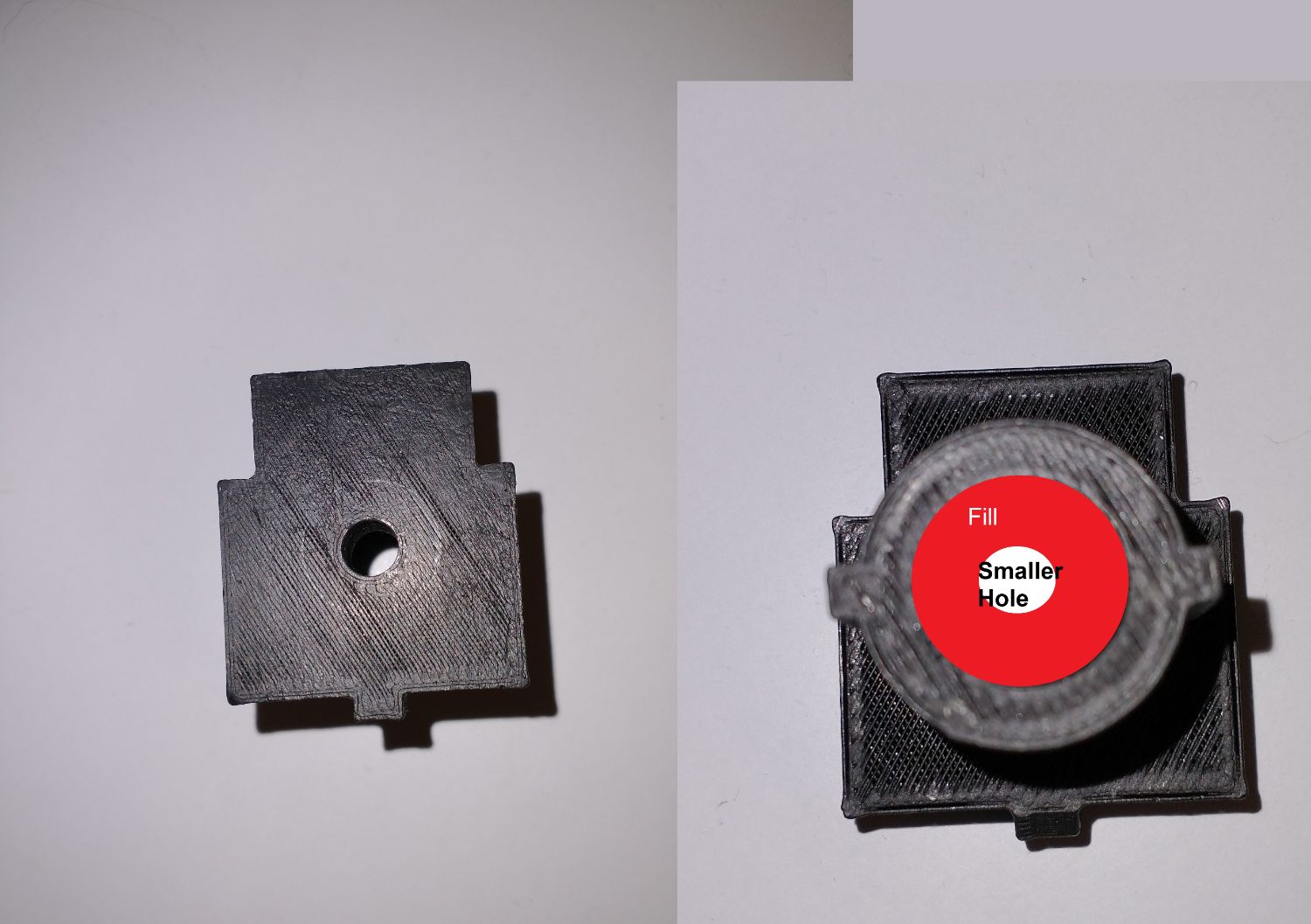

GothicGhost Posted March 23, 2021 Posted March 23, 2021 51 minutes ago, Piman said: That is not difficult but is not going to be very strong. Have you used it yet? The main load is in it's weakest axis (i.e. between the layers). Drop the gun on it's stock and I can see that snapping very easily. 3D printing is good for a lot of things but you need to choose carefully where you use it. Is there no commercial version you could buy? I would expect it to not be much mire than the cost of a 3D print. It's for a hi-capa 3D printed carbine and I understand the stock adapater the weakpoint of the kit if I drop or something so I wanted to have some few spare to just replace it if that ever happens What if the hole was more filled in to make it stronger and the bolt sits on the outside of the adapter. Thank you any advice. Khyber 1
Piman Posted March 23, 2021 Posted March 23, 2021 Yes, that and infill levels will all help. The design is simple so would be easy to replicate. Would just need to get a set of calipers on it.
Supporters Adolf Hamster Posted March 23, 2021 Supporters Posted March 23, 2021 looking at that, might be better to print it on it's side so the bolt holes are going through the layers too?

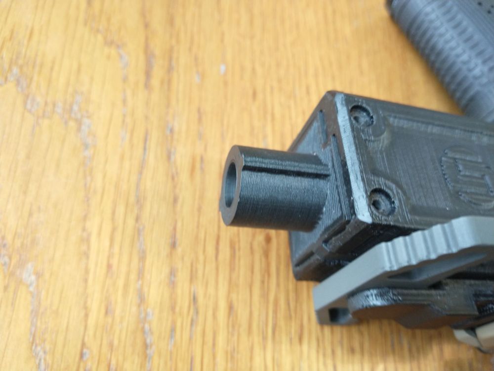

GothicGhost Posted March 23, 2021 Posted March 23, 2021 (edited) I have ordered some calipers lol How do you think something like this to print? Edited March 23, 2021 by GothicGhost
Piman Posted March 23, 2021 Posted March 23, 2021 1 hour ago, Adolf Hamster said: looking at that, might be better to print it on it's side so the bolt holes are going through the layers too? Agreed, that would make it stronger in the important directions but is a horrible print with supports. You can see it has been design to be printed the way it is. 14 minutes ago, GothicGhost said: How do you think something like this to print? I am not quite sure I understand the question but this is a simple 3D print in its current orientation.
