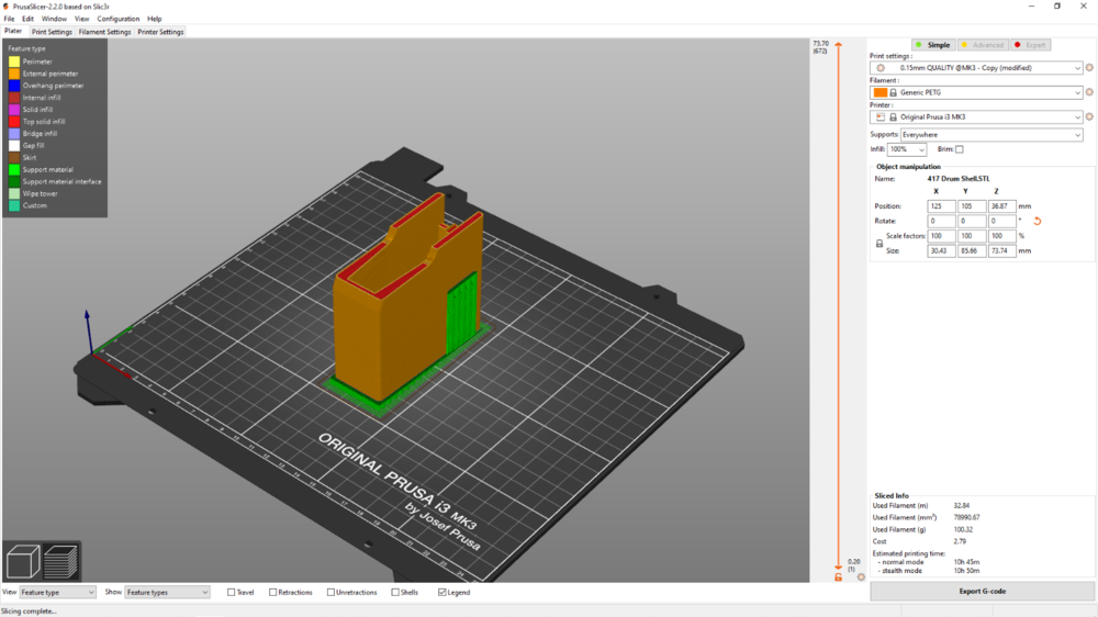

Speedbird_666 Posted August 31, 2021 Posted August 31, 2021 7 hours ago, SeniorSpaz87 said: Im... Unsure. I have several parts made in SLS so far, and its certainly the superior material, but it does get pricey. Once this hurricane moves on I will fill the drum with ammo and go stress test it. If the epoxy fails Ill need to redesign it to use bolts, and if the PETG fails then I will need to get it done in SLS. But for now itll stay as PETG. After having an epoxy joint fail on one my prints (admittedly it was cheap unbranded stuff), and some unreliable self-tapping holes, I've just ordered a bunch of M3 heat-set nuts to test out for future projects from Aliexpress. There's someone on eBay (UK) who happens to make a setting tool for these that fit my particular soldering Iron.
Supporters SeniorSpaz87 Posted August 31, 2021 Supporters Posted August 31, 2021 1 hour ago, Speedbird_666 said: After having an epoxy joint fail on one my prints (admittedly it was cheap unbranded stuff), and some unreliable self-tapping holes, I've just ordered a bunch of M3 heat-set nuts to test out for future projects from Aliexpress. There's someone on eBay (UK) who happens to make a setting tool for these that fit my particular soldering Iron. Yea Im hoping my high strength stuff and a rough surface will hold. Ill probably just use standard nuts as bolts as space is limited enough as-is. Trying to sink those in will be difficult. Speedbird_666 1

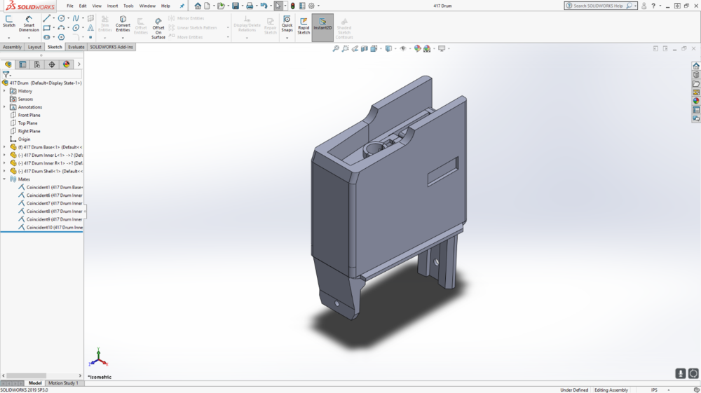

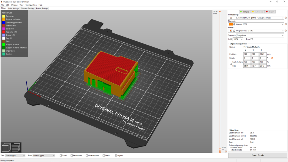

Supporters SeniorSpaz87 Posted September 8, 2021 Supporters Posted September 8, 2021 Oh what ever could I be working on now? In other news, my three latest projects - that being my AUG HBAR, L86, and QJB-95 are done. Look for them in the Gun Pictures Thread. PopRocket123 and Brophy 2
PopRocket123 Posted September 8, 2021 Posted September 8, 2021 9 hours ago, SeniorSpaz87 said: Oh what ever could I be working on now? In other news, my three latest projects - that being my AUG HBAR, L86, and QJB-95 are done. Look for them in the Gun Pictures Thread. Looks similar to a drum mag adapter I've seen a friend working on Am I right in thinking that looks like a hk417 mag? SeniorSpaz87 1
Supporters SeniorSpaz87 Posted September 8, 2021 Supporters Posted September 8, 2021 3 hours ago, PopRocket123 said: Looks similar to a drum mag adapter I've seen a friend working on Am I right in thinking that looks like a hk417 mag? It is indeed.

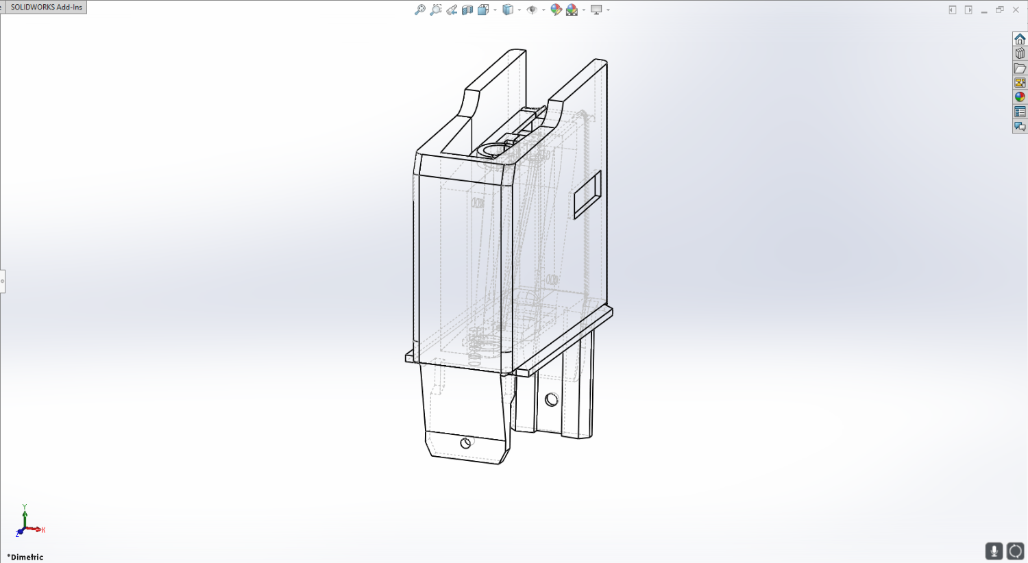

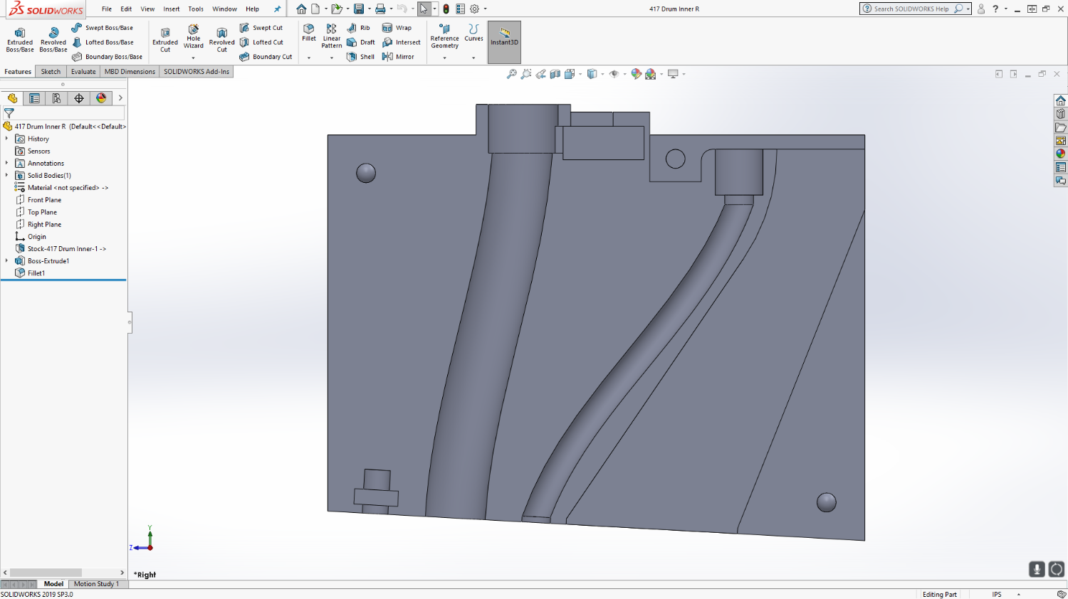

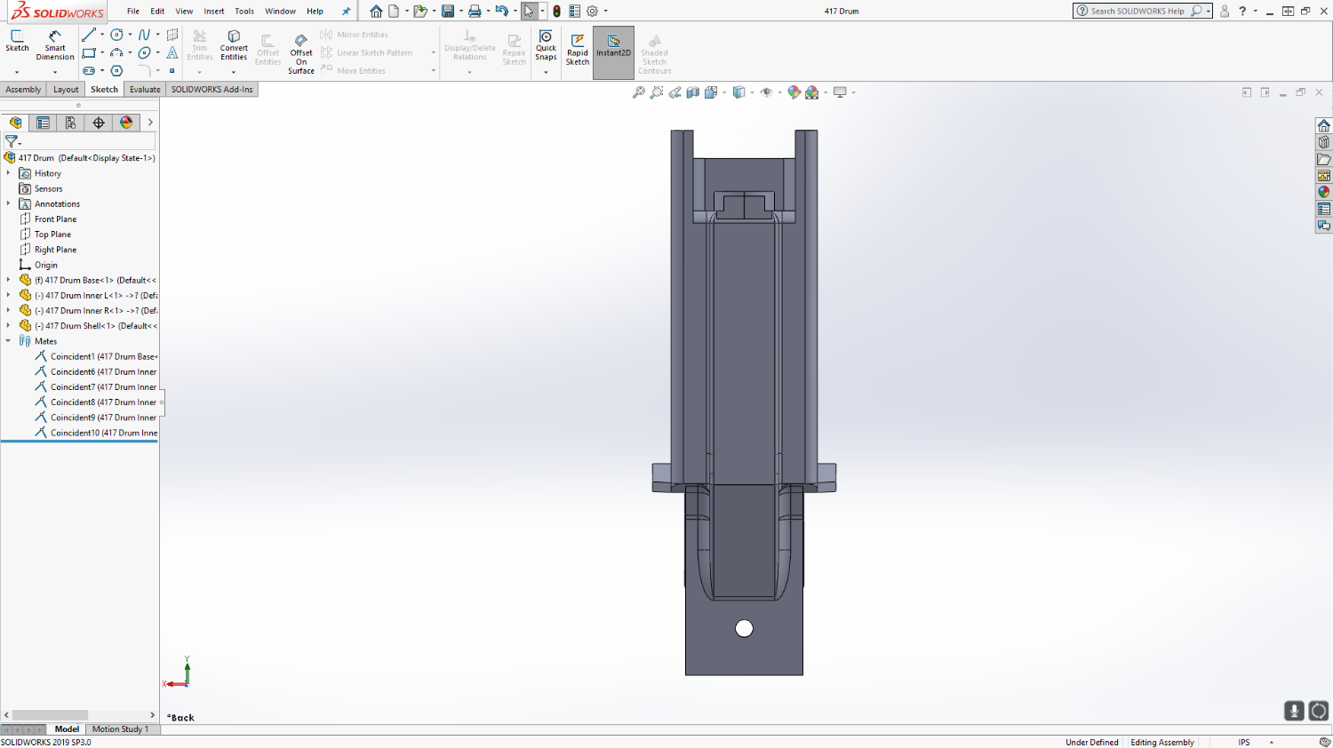

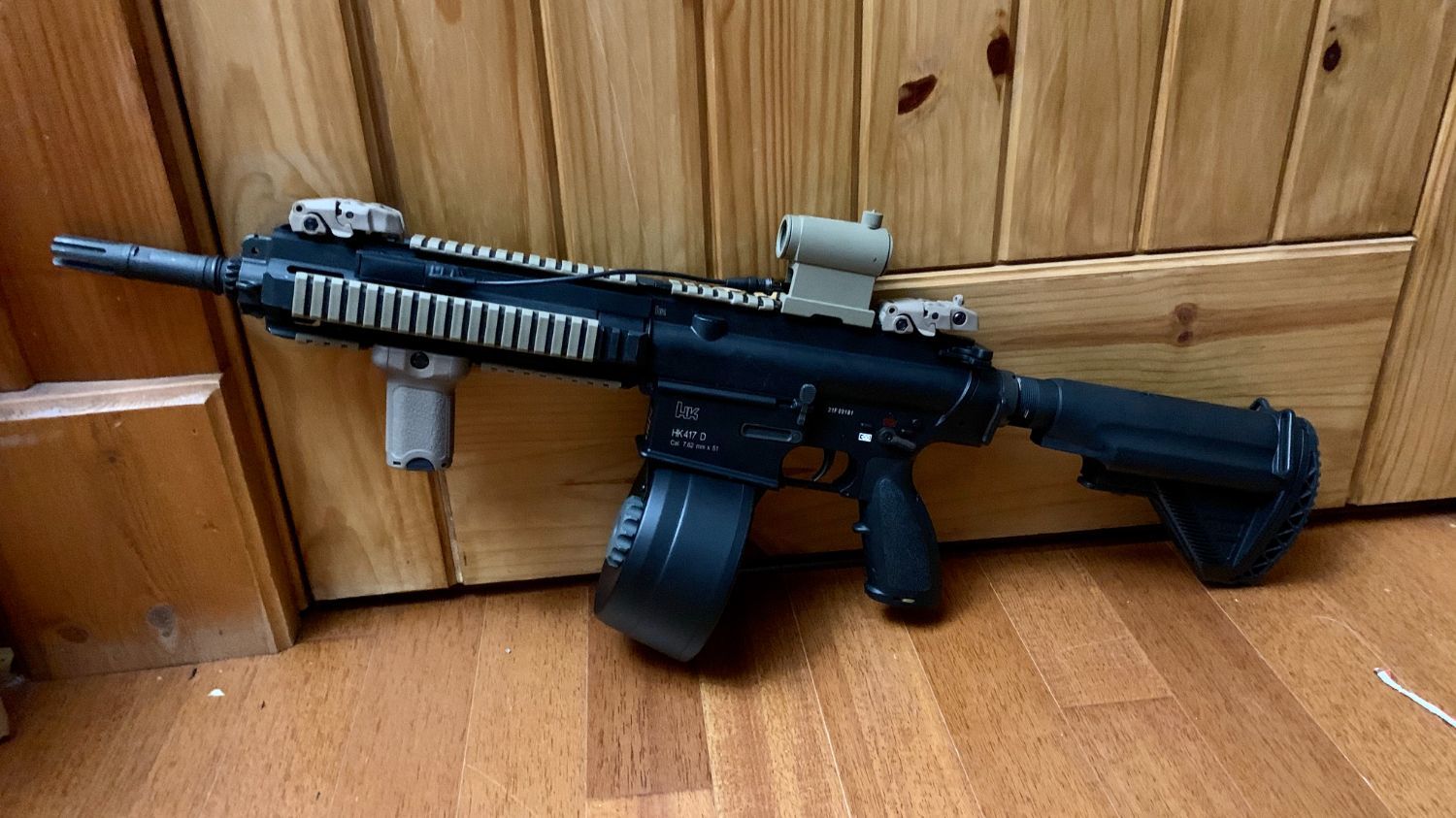

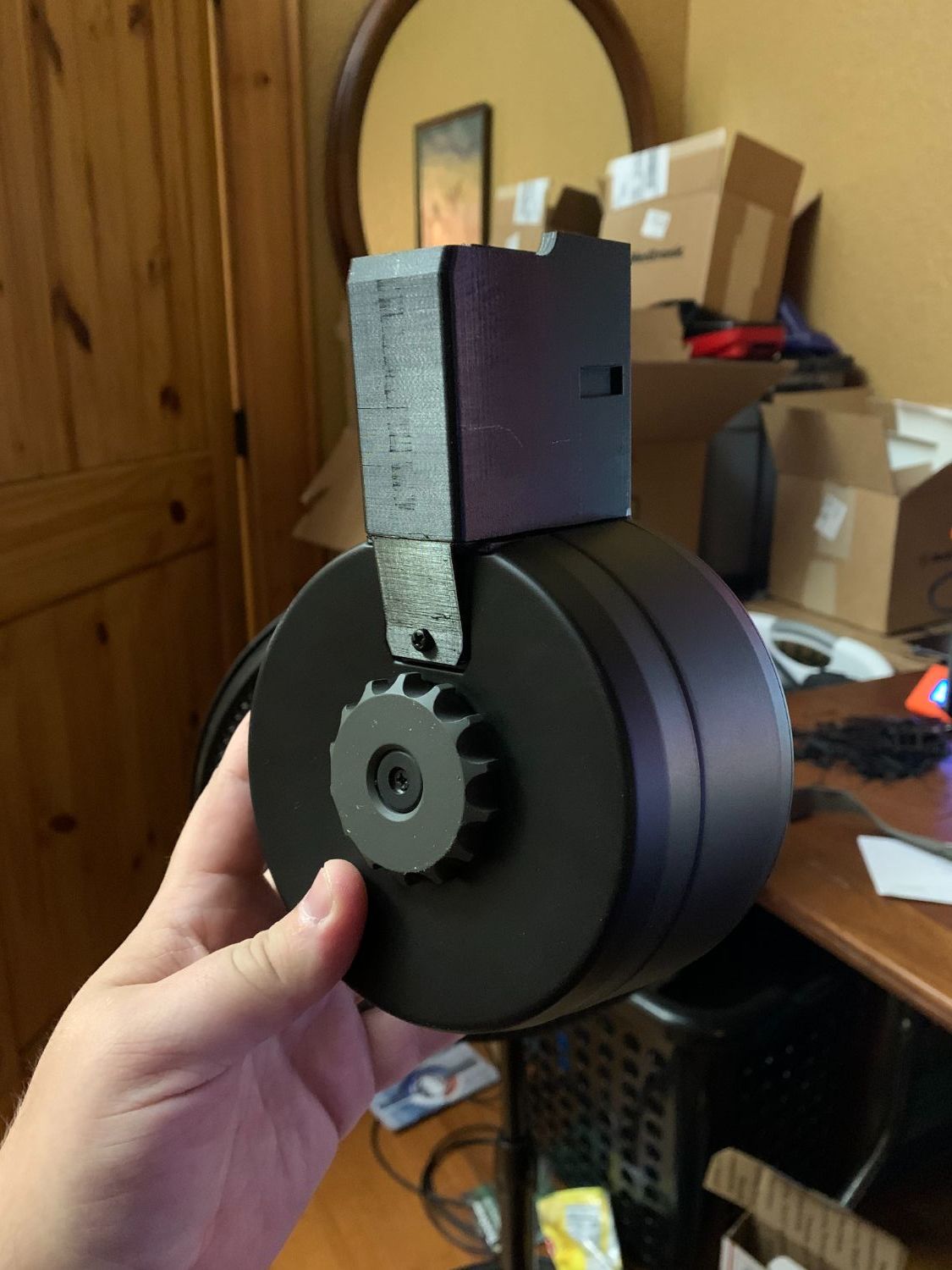

Supporters SeniorSpaz87 Posted September 8, 2021 Supporters Posted September 8, 2021 A few more pics of my 417 Drum adapter. It is designed for the A&K SR-25 drums as they are plentiful this side of the pond, dont break the bank, are sized for 308 (the main reason I chose a SR-25 drum over something smaller like the Angel Custom drums, which are sized for 5.56), and have some nice features including a sound-based auto-wind, button-wind, and switch-wind. As it seems all my drum adapter designs end up being, it is split into 4 parts for printing - left and right inner halves, an outer shell, and the base. Inner Right showing the internal passageways for loading BBs, the feed tube, and the sound sensor slot and wiring tube: Right and left inner halves put together: The outer shell: The base - printed inverse to this, of course: The four parts assembled (Isometric): The four parts assembled (top): The four parts assembled (back): The cut-away internal shot of all four parts assembled: strykerles and PopRocket123 2
Supporters SeniorSpaz87 Posted September 9, 2021 Supporters Posted September 9, 2021 Several test prints later, and a few changes were made. The screw hole has been enlarged for the bolt to pass clean through the base, and halfway into the shell. This makes it flush inside the assembly and actually serves as a pin between all 4 parts. I have also decreased the outer sides of the Inner parts by .02" all around (.5mm), as it would require a pneumatic press to actually get the two inner halves into the shell. Just the cm or so I shoved them together to test the fitment took a hammer to remove. So far I have 2 of the latest bases done, a possible "production" print of the shell done (I have three options to print it: First, I can do it with the top horizontal, and support material as a wedge. This is what I did for the shell I have printed. It worked, but did have some errors along the base and had to be sanded flat. Testing with the inner parts after theyre done will determine if this is a problem. Its also the longest print - at 80% speed it takes a whopping 14 hours: Second is to print it with no supports at the bottom, leaving the top as a slant. This has the plus of ensuring a flat base, but gives a layered top: Third is to print on its side. This is the fastest method at only 8 hours and change at 100% (approx 12 hours at 80%), but does use the most material and cost the most. To be fair its about 3 Euros per shell vs the 2.70 Euros or so if printed in either vertical orientation, so not exactly an important difference. Cleaning all that support material out is gonna be a PITA though, and itll leave the face-down side a different texture due to my textured print bed. ), and I am working on printing the two inner halves now. Heres what it looks like mostly assembled, still missing the two inner halves: PopRocket123, shadowfacex and Speedbird_666 1 2

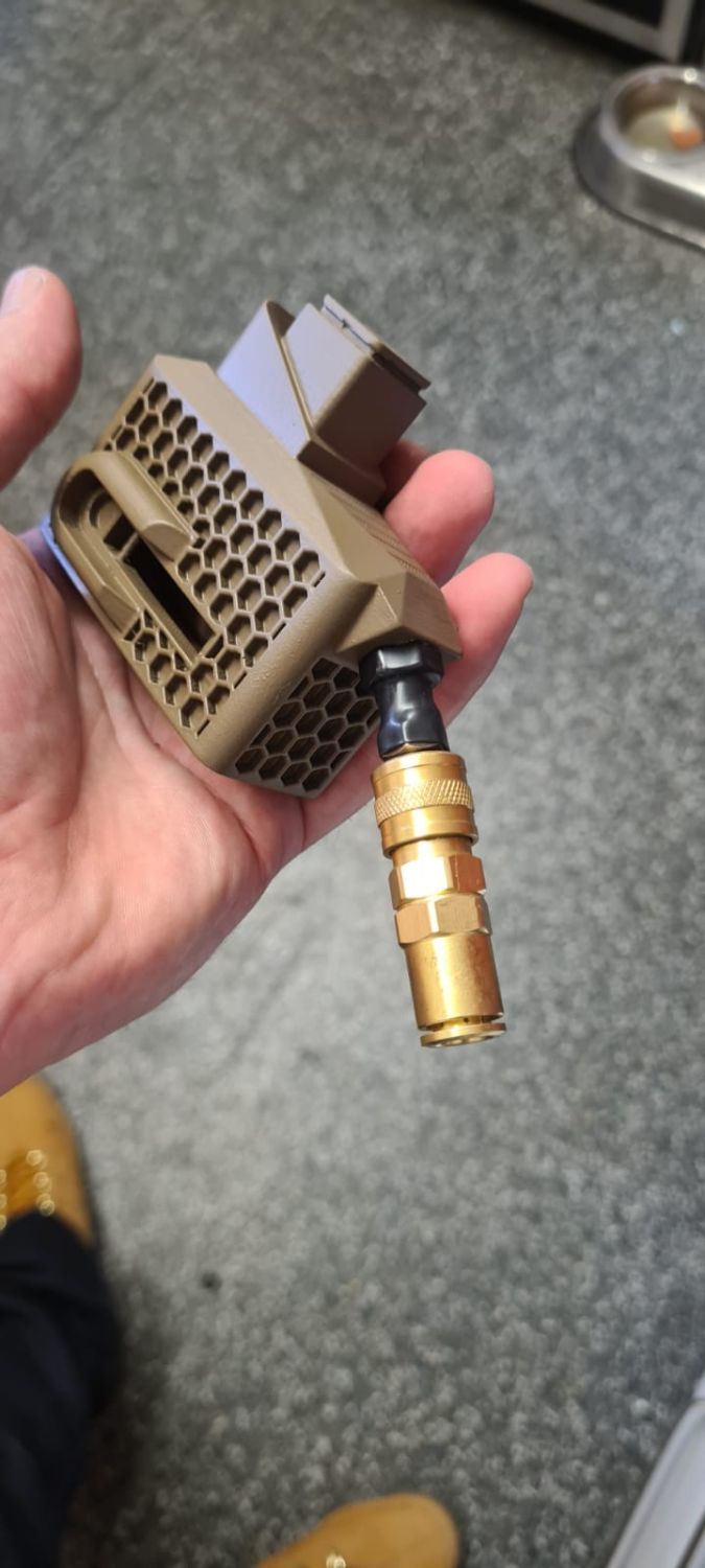

Cheeky vimto Posted September 10, 2021 Posted September 10, 2021 AAP01 hpa adapter. The plastic leaked like a shiv so it got a few coats of cerakote. Samurai and Speedbird_666 2
Supporters Samurai Posted September 10, 2021 Supporters Posted September 10, 2021 5 hours ago, Cheeky vimto said: AAP01 hpa adapter. The plastic leaked like a shiv so it got a few coats of cerakote. And it doesn't leak now?

Cheeky vimto Posted September 13, 2021 Posted September 13, 2021 On 10/09/2021 at 11:21, Samurai said: And it doesn't leak now? Zero leaks. Samurai 1

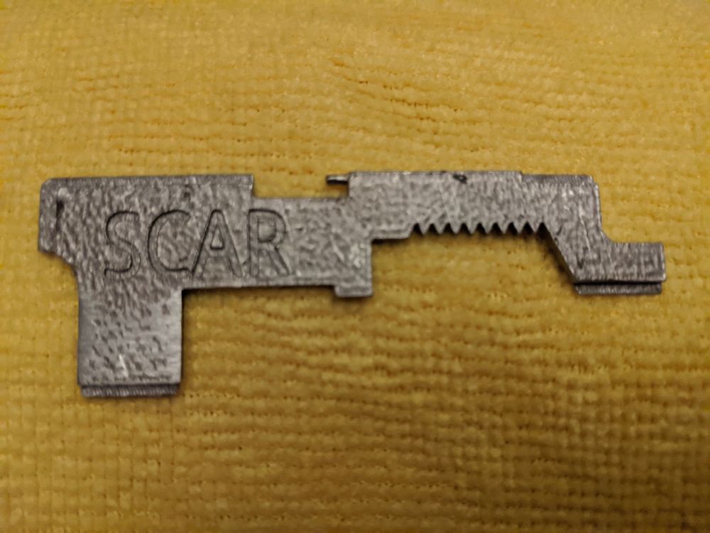

paradoxum Posted September 13, 2021 Posted September 13, 2021 (edited) The VFC SCAR-H selector plate is trash, as is any nylon or other platic ones you can buy, if you use the lever on the right (because you're left handed), the teeth on it get stripped crazy easily. So I found an .stl file of it on thingverse, got it printed in aluminium - it wasn't shaped properly - learned to mod the file myself enough, got it printed again in aluminium (shit is expensive, talking like, £35 for a selector plate). Anyway, here it is. I can post the modded file if anyone wants it. Edit: actually just uploaded it anyway incase anyone comes across this in the future; https://atomicrhino.net/upload/airsoft/scarh/VFC_selector_plate_mk_17.stl.zip Top plate is the stock one, bottom is a nylon printed one I bought from a shop. Teeth broke before the gun even left the house. Edited September 13, 2021 by paradoxum PopRocket123 and Samurai 2
PopRocket123 Posted September 13, 2021 Posted September 13, 2021 1 hour ago, paradoxum said: The VFC SCAR-H selector plate is trash, as is any nylon or other platic ones you can buy, if you use the lever on the right (because you're left handed), the teeth on it get stripped crazy easily. So I found an .stl file of it on thingverse, got it printed in aluminium - it wasn't shaped properly - learned to mod the file myself enough, got it printed again in aluminium (shit is expensive, talking like, £35 for a selector plate). Anyway, here it is. I can post the modded file if anyone wants it. Edit: actually just uploaded it anyway incase anyone comes across this in the future; https://atomicrhino.net/upload/airsoft/scarh/VFC_selector_plate_mk_17.stl.zip Top plate is the stock one, bottom is a nylon printed one I bought from a shop. Teeth broke before the gun even left the house. I'll grab that as I spotted the selector plate as a weak point on mine. Saves me modelling it up myself. I eliminated the ambi selector as it never worked anyway. paradoxum 1

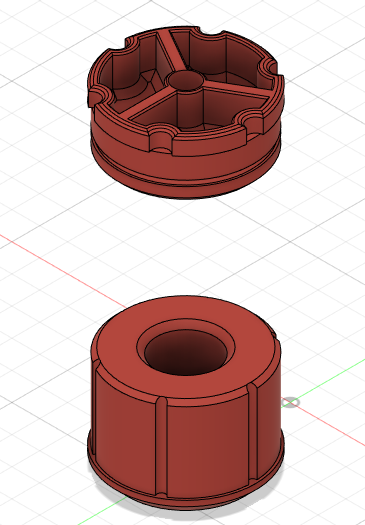

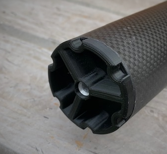

Speedbird_666 Posted September 17, 2021 Posted September 17, 2021 I dub thee: The WWSD - 'What Would Speedbird Do' Blaster. If you know, you know. The aim was a super light weight gun for all-round use. It's an unused ICS Sportline I have knocking about (hence shit camo job). It was a light weight plastic gun anyway, but had a wobbly/bendy front end that I was never happy with. So - 50mm Carbon tube hand guard. 3D printed barrel nut, hand guard end cap and barrel stub. ICS Stubby stock. No Outer barrel - the inner barrel is supported by the hand guard end cap. I replaced the RIS receiver rail with a 3D Printed blanking plate. I also added a flared magwell, 3D printed from a thingiverse file that I modded to better fit. No sights (never use 'em anyway - hi-cap 'spray and pray' for the win). It's my 40th Birthday in a couple weeks. Missus is buying me a nice Sparmax airbrush/compressor set, so the receiver will get some kind of 'interesting' paint job. I know, haters gonna hate. But I like it, and that's all that matters to me...? PopRocket123, Akuma121 and SSPKali 1 2
Supporters TheFull9 Posted September 17, 2021 Supporters Posted September 17, 2021 I may not like it but no arguing with the design or the practicality of the end outcome. Eliminating the outer barrel entirely was definitely a smart move in the context. Druid799 1
Chev Chelios Posted September 17, 2021 Posted September 17, 2021 On 13/09/2021 at 18:25, paradoxum said: So I found an .stl file of it on thingverse, got it printed in aluminium - it wasn't shaped properly - learned to mod the file myself enough, got it printed again in aluminium (shit is expensive, talking like, £35 for a selector plate). Forgive my ignorance but did they actually heat and extrude the ally or just said print instead of machine? Thanks.
