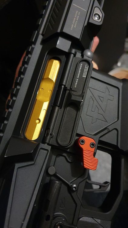

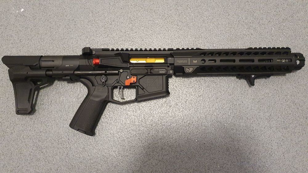

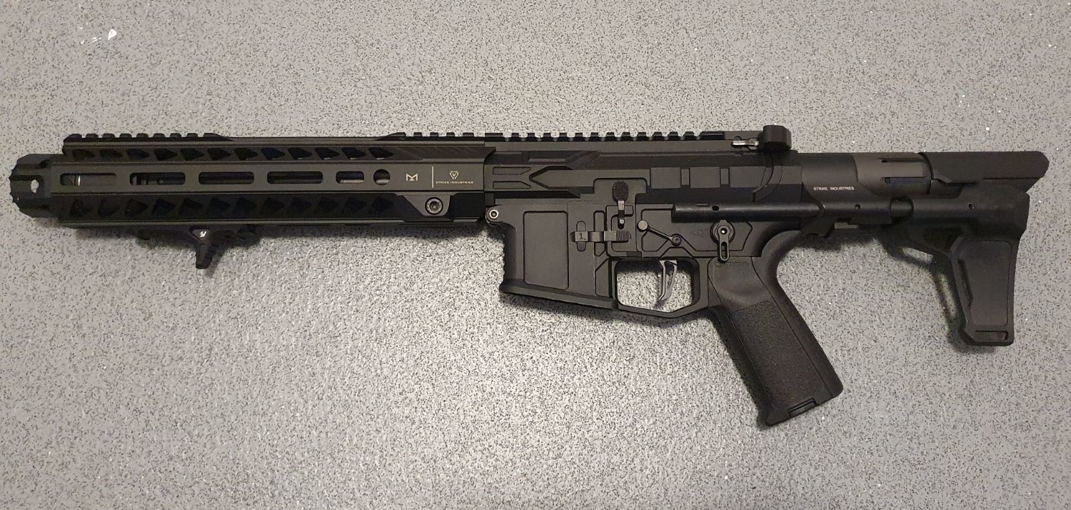

MILITATED Posted April 20, 2022 Posted April 20, 2022 (edited) Here is my almost complete build using the Dytac F4 receiver & going for a Strike Industries theme. I admit that it has been a pain in the ass, however. I need a different flat trigger, since this Vulcan one is genuinely too big for the trigger's hole in the lower to be pulled... Haven't tried it in a standard Marui lower - perhaps it will work with that. Maybe Dytac just made the hole smaller, or maybe Vulcan just don't test their products. The Salient bolt got a nice scratch on the only part where there is text since the fit was stupidly tight in the Dytac upper ?♂️ Brilliant start. God knows how it will cycle when fired. Not sure why my camera made the bolt look so dirty and dull in the closer picture ? Strike industries body pins don't fit the Dytac receiver since the body pin holes are slightly smaller than a regular MWS (what a weird design choice?), so they're sitting in a box. Strike industries dust cover doesn't close properly on the Dytac receiver, but still looks cool I suppose. Should have gotten the MWS specific one instead of a real one. The paint on the Dytac receiver is absolute wank, so cerakote is a must if you plan to get one and want it to look nice. Didn't mean to get a red forward assist and mag release, but will soon paint them black. On the plus side, Strike Industries stuff is of really nice build quality, definitely recommended, though Brownells UK is robbery ? Haven't even gotten to fire the bloody thing yet since I still have no mag, but it looks cool at least! If anyone has a flat trigger, preferably from a MTR, let me know ? Still not sold on having a gold bolt either, but I do like the angular shape of the Salient one. Also just realised the right side's anti rotation pin is out of place, oops. In conclusion, Dytac made a nice receiver but also made some questionable design choices in terms of compatibility. Some aspects are for real steel, others for Marui stuff & some just straight up oddly sized (body pin holes). Edited April 20, 2022 by MILITATED GStevo80 and Khyber 2

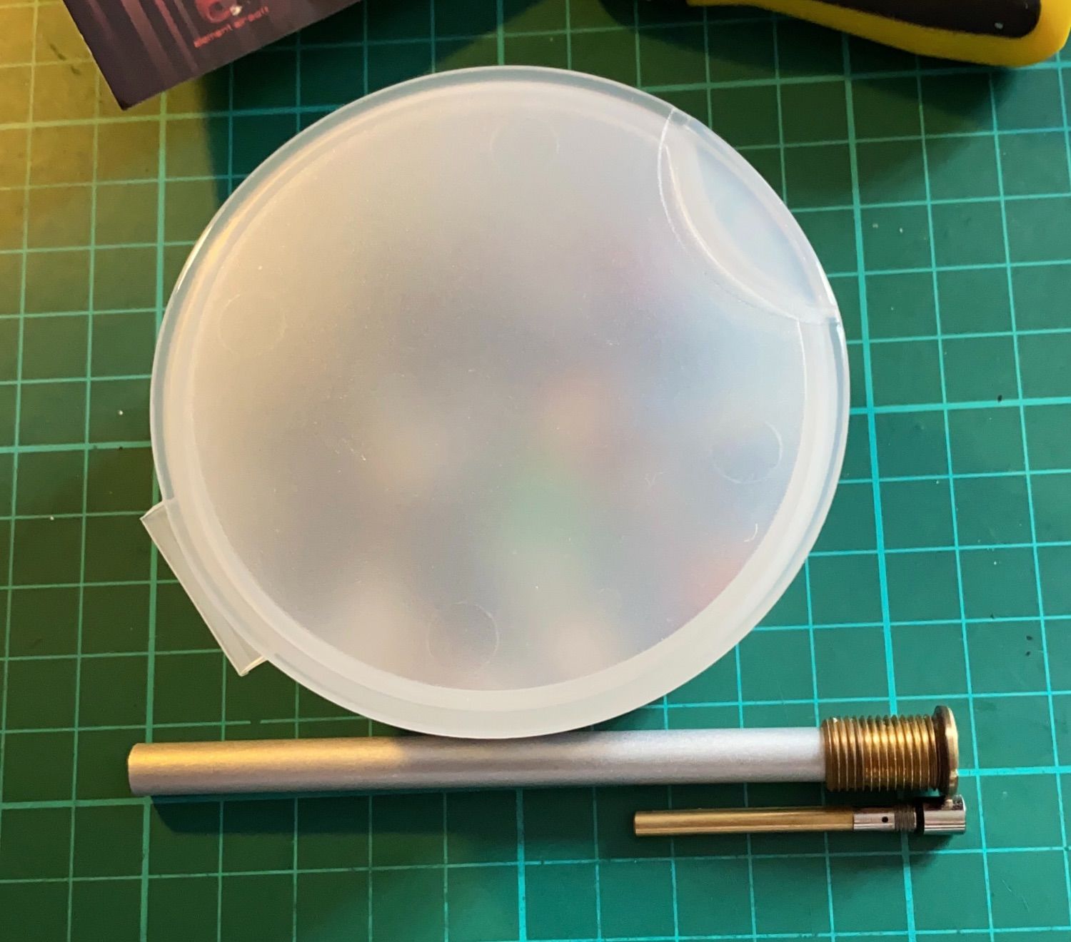

AlphaBear Posted April 22, 2022 Posted April 22, 2022 So I took the Valve out and figured I’d take 4cm off the bottom of the infill tube. That should leave a clear 2.5cm past the infill valve more than enough stop any liquid gas from accidentally flowing into the RIF itself. Argyld 1
AlphaBear Posted April 22, 2022 Posted April 22, 2022 I was gonna use my dremel and all the plethora of gubbins that come with it. Plus a black and decker workbench to hold the tube in place. I mean I have to justify all the power tools I have right? Lol Khyber 1
Argyld Posted April 22, 2022 Posted April 22, 2022 This might justify paying a mini plumber pipe cutter, you know ? Remember to thoroughly clean the tube afterwards, don't want any particles getting blown through your nozzle/barrel.

AlphaBear Posted April 23, 2022 Posted April 23, 2022 (edited) Drum Roll time…….. So I lobbed off 3.5cm off the bottom of the flow tube. That easily left 3cm of tubing past the bottom of the in-fill brass valve. I managed to get 23g of gas into the mag (more than double what I was previously getting)… now comes the number of shots I got off… wait for it….. 158 shots!!! Yep! You read that right… One hundred and fifty bloody Eight! And there was still gas left in the mag. Although the last 10 shots were kinda meh! So I’d say easily 4 full mags with good power and then the last mag with diminishing power. I’ll have to set my chrono up tomorrow if I have time and see what the FPS consistency is like. One more important point to note. I was testing with 0.2g ASG devils. I’ll try 0.28’s tomorrow as that will be more representative of the weight I play with. Happy days ya’ all Edited April 23, 2022 by AlphaBear

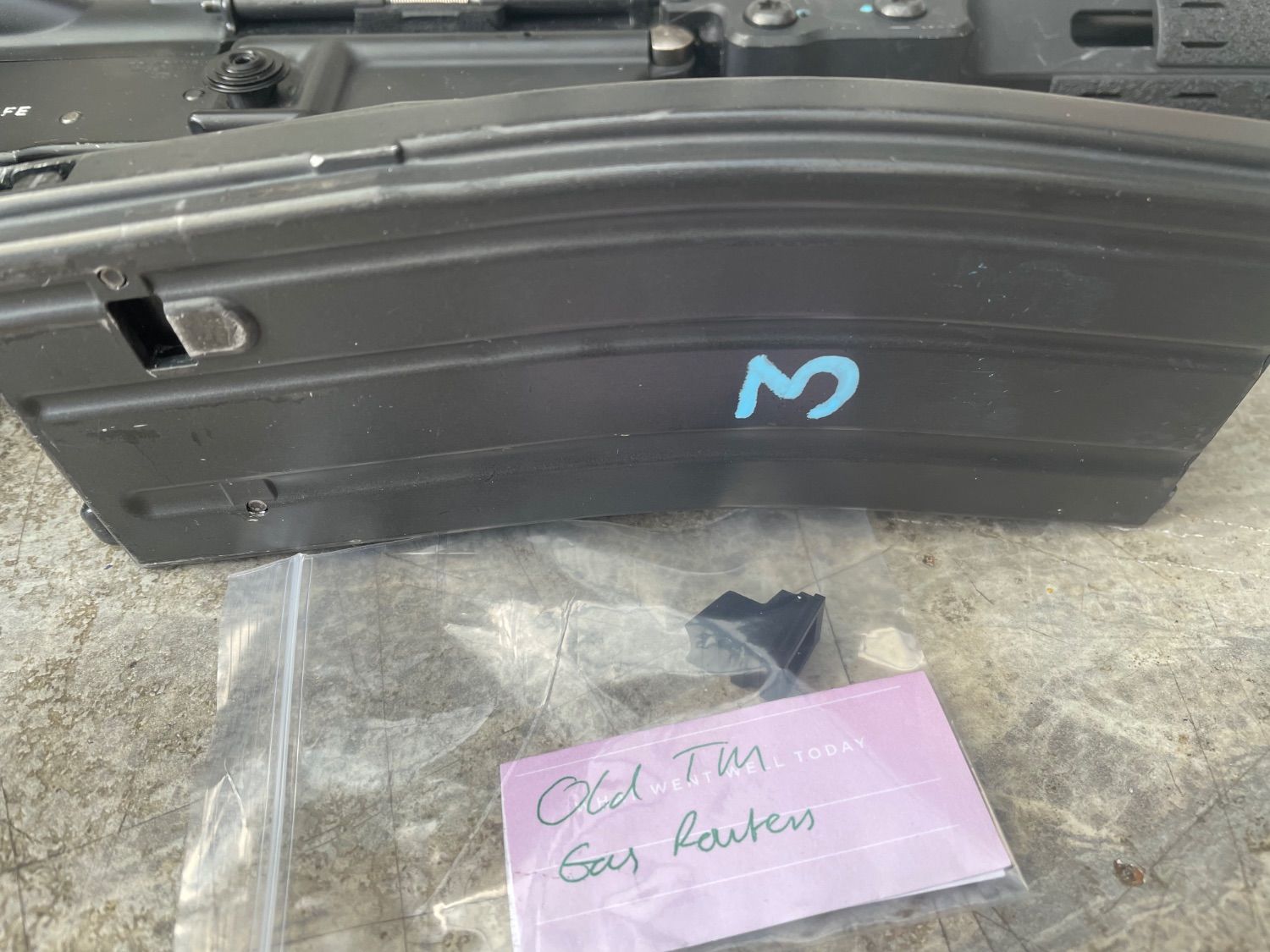

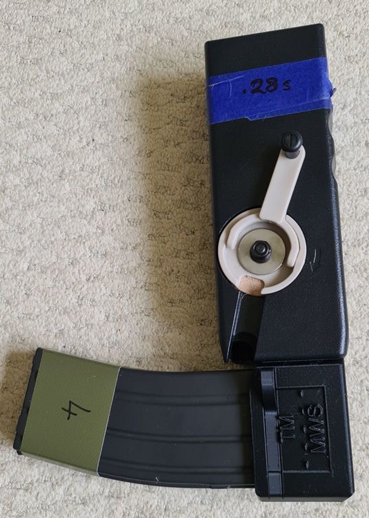

SSPKali Posted April 24, 2022 Posted April 24, 2022 Replaced the gas router on one of my mags, I bought them second hand 3 years ago and they had been well used so probably due replacement. I chronographed the gun before (263-267fps) on ASG Ultrair and 0.30g Once the gas router was replaced I tested it again…now 299-305fps! Turned down the NPAS and all is good again. It is definitely snappier and more recoil, I guess it is all going into moving the bolt and not leaking around the nozzle. The other 6 replacements from FireSupport will be here on Monday so I guess that is a couple of evenings next week sorted ? Mag now marked up so I keep track of which I have done!
AlphaBear Posted April 24, 2022 Posted April 24, 2022 9 hours ago, SSPKali said: Replaced the gas router on one of my mags, I bought them second hand 3 years ago and they had been well used so probably due replacement. I chronographed the gun before (263-267fps) on ASG Ultrair and 0.30g Once the gas router was replaced I tested it again…now 299-305fps! Turned down the NPAS and all is good again. It is definitely snappier and more recoil, I guess it is all going into moving the bolt and not leaking around the nozzle. The other 6 replacements from FireSupport will be here on Monday so I guess that is a couple of evenings next week sorted ? Mag now marked up so I keep track of which I have done! Just out of curiosity which brand of gas routers did you buy?
SSPKali Posted April 25, 2022 Posted April 25, 2022 1 hour ago, AlphaBear said: Just out of curiosity which brand of gas routers did you buy? Guarder
