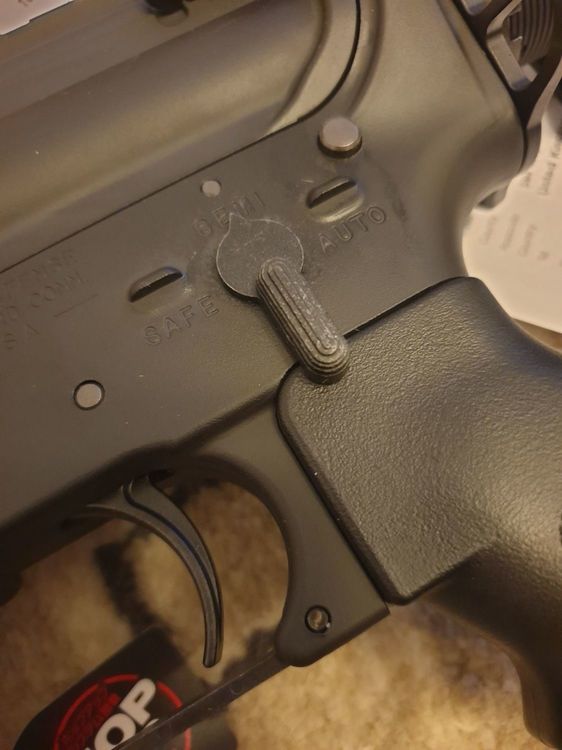

Whodat Posted October 19, 2021 Posted October 19, 2021 (edited) Right, she's arrived. Having a few issues off the bat! Firstly, the finish on some of the parts is really bad, should it be? E.g. fire selector, castle nut... Next up, the mag release is seemingly getting stuck on the mags and is a two finger job to actuate. Finally, has anyone managed to get the mags to load with a vanguard speedloader? Is there a technique I'm missing? Edited October 19, 2021 by Whodat
AlphaBear Posted October 19, 2021 Posted October 19, 2021 3 hours ago, Whodat said: Right, she's arrived. Having a few issues off the bat! Firstly, the finish on some of the parts is really bad, should it be? E.g. fire selector, castle nut... Next up, the mag release is seemingly getting stuck on the mags and is a two finger job to actuate. Finally, has anyone managed to get the mags to load with a vanguard speedloader? Is there a technique I'm missing? or switch Congrats on the purchase and welcome to the club..... The fire selector switch finish is pants on them all... Mine was kinda the same and I'm sure other peoples are too... The castle nut is hit and miss though.. I suspect your's just got tightened with a tad more vigour... believe you me if you need to tighten it with s Marui spanner it will mark anyway.... it's just the nature of the pot metal that Marui use,..
Davegolf Posted October 20, 2021 Posted October 20, 2021 I love a stock CQBR, yes the selector finish is the complete opposite to the receivers ? Sometimes the mag release is wound in a few to many times, if you ‘over’ push the release with a tool you can rotate the actual latch and undo it one or two turns to your desired amount.
Whodat Posted October 20, 2021 Posted October 20, 2021 (edited) 17 hours ago, Davegolf said: I love a stock CQBR, yes the selector finish is the complete opposite to the receivers ? Sometimes the mag release is wound in a few to many times, if you ‘over’ push the release with a tool you can rotate the actual latch and undo it one or two turns to your desired amount. Boom! One turn of the of the latch and it's much better - top tekkers my friend! Now it just leaves an adapter for the vanguard. I didn't pay all this money to lug around 5 kilos of real nato ammo tin and not get to use it! Edited October 21, 2021 by Whodat Spelling

Softcore Posted October 22, 2021 Posted October 22, 2021 On 19/10/2021 at 22:39, Whodat said: Firstly, the finish on some of the parts is really bad, should it be? E.g. fire selector, castle nut... Most of the zinc parts on the MWS have that finish, nothing you can really do about it except for buying replacements made out of aluminum or steel.

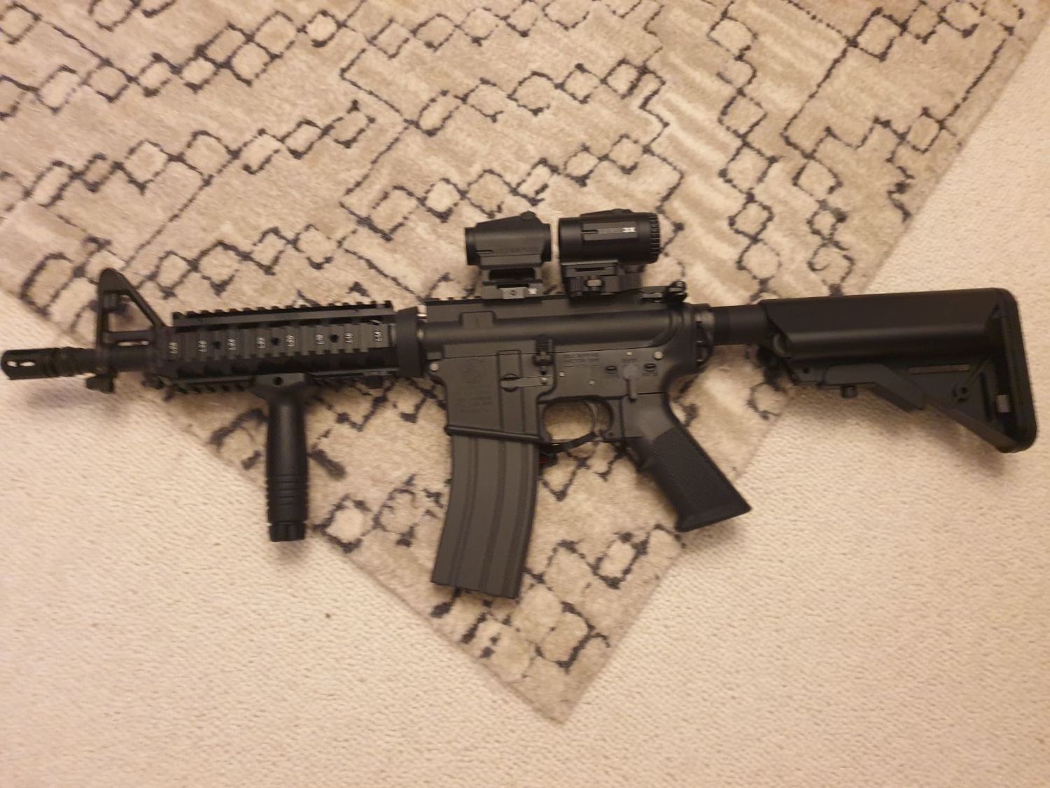

Captain Darling Posted October 26, 2021 Posted October 26, 2021 Yes, I own a modded MK18 and they are the same internally as far as I can see. It doesn’t look much like a MK18 now though GStevo80, Jacob Wright and Nick G 3
GStevo80 Posted October 27, 2021 Posted October 27, 2021 6 hours ago, Captain Darling said: Yes, I own a modded MK18 and they are the same internally as far as I can see. It doesn’t look much like a MK18 now though That’s a serious bit of kit there Sir. Looks the balls. So 90% of these 226 pages are people recommending and getting the Six Nub. They don’t have any and aren’t making them so I plan to do the “ram something solid into the TM nub” mod. All videos seem to be on CQBR and MWS barrel removal to access. Any tips? Clearly you’ve had yours off more than once lol Plastic mag? Is that the one with the extra 5 rounds? Are you a fan? Seems some complain about performance? even your grenades/smoke look cool. Bravo. 8 hours ago, Whodat said: Oi, that's my line! Ha ha Unbelievable Geoff! He who dares wins Rodney

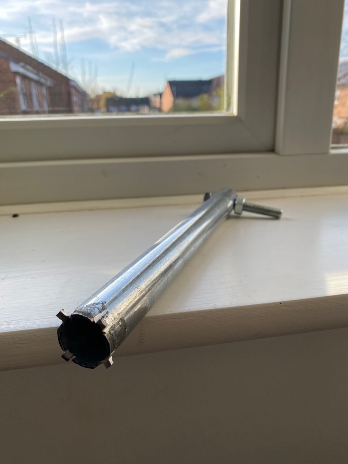

Captain Darling Posted October 29, 2021 Posted October 29, 2021 I made a tool to get my mk18 barrel nut off, used a vice and AR upper clamp. And a electric heat gun to melt the thread lock. It was an absolute arse, but do-able. With this in mind, you’re probably better off going for the CQBR as your base gun. You’ll need a low profile gas block/gas tube and flash hider. I sometimes run a 10.5” barrel in hotter months with a 250mm inner, but I’m trying the 370mm 6.03mn in winter to get better performance on black gas. The HAO rails seem much better than the alternative clones. The mags are SAA, they’ve run totally fine for me and weight 100g less per mag. Nick G 1

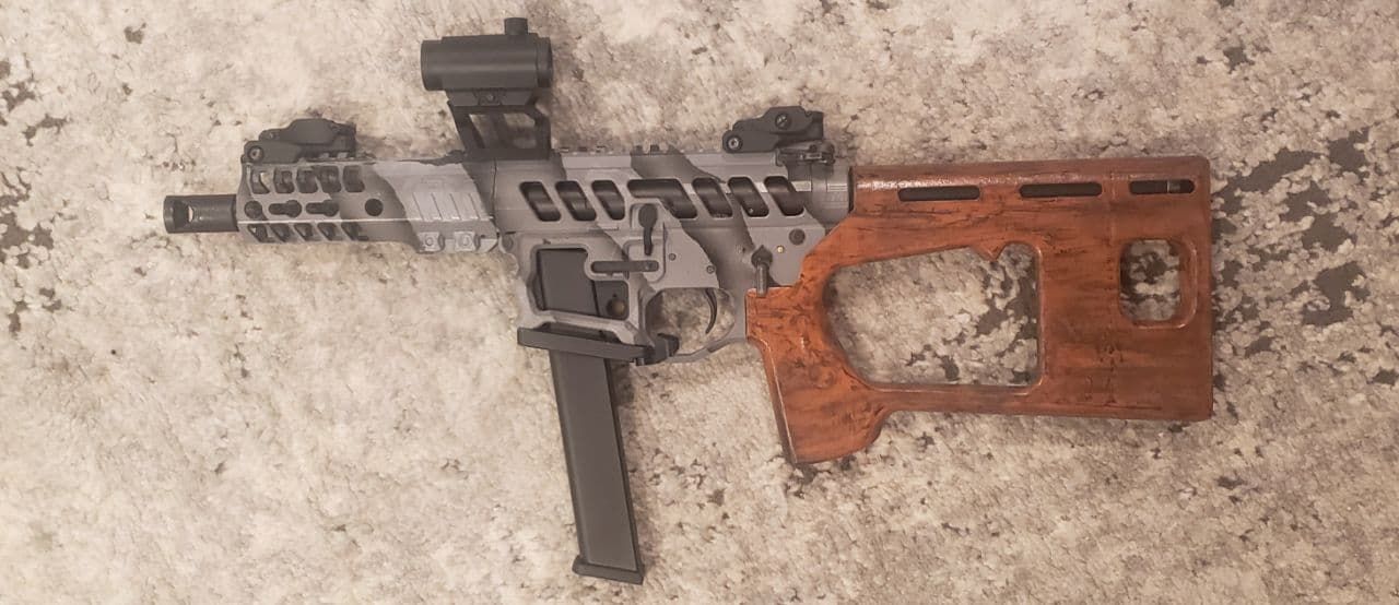

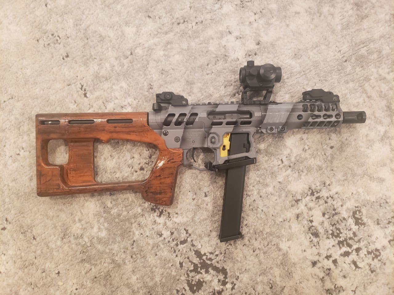

adas1223 Posted November 3, 2021 Posted November 3, 2021 My "parts bin" MWS monstrosity. the kick on this thing with duster gas is like shooting real steel. definitely harder than my 22lr! Stratton Oakmont, Crome and GothicGhost 2 1
AlphaBear Posted November 3, 2021 Posted November 3, 2021 On 16/10/2021 at 21:34, MalcyFett said: Took the MWS out today for it's first game since I've fitted the new Brass nub. I found I wasn't able to reach out as far as my MP7 GBBR. Tried .36 and .32. running predator ultra, at 250 fps with the .36 neither were working well with max hop on. Is there something I'm missing/not doing to achieve at least the range of my MP7? Everything is stock inside, except for said brass nub. I have a prommy barrel inside mine... a sixG brass nub and a HSB buffer.... I find the range pretty good (not as good as my upgraded KoA recoil though) of course it's dependent on temperature and the gas you're using. MalcyFett 1
AlphaBear Posted November 3, 2021 Posted November 3, 2021 17 hours ago, adas1223 said: My "parts bin" MWS monstrosity. the kick on this thing with duster gas is like shooting real steel. definitely harder than my 22lr! I am trying to find some words... but failing for some reason

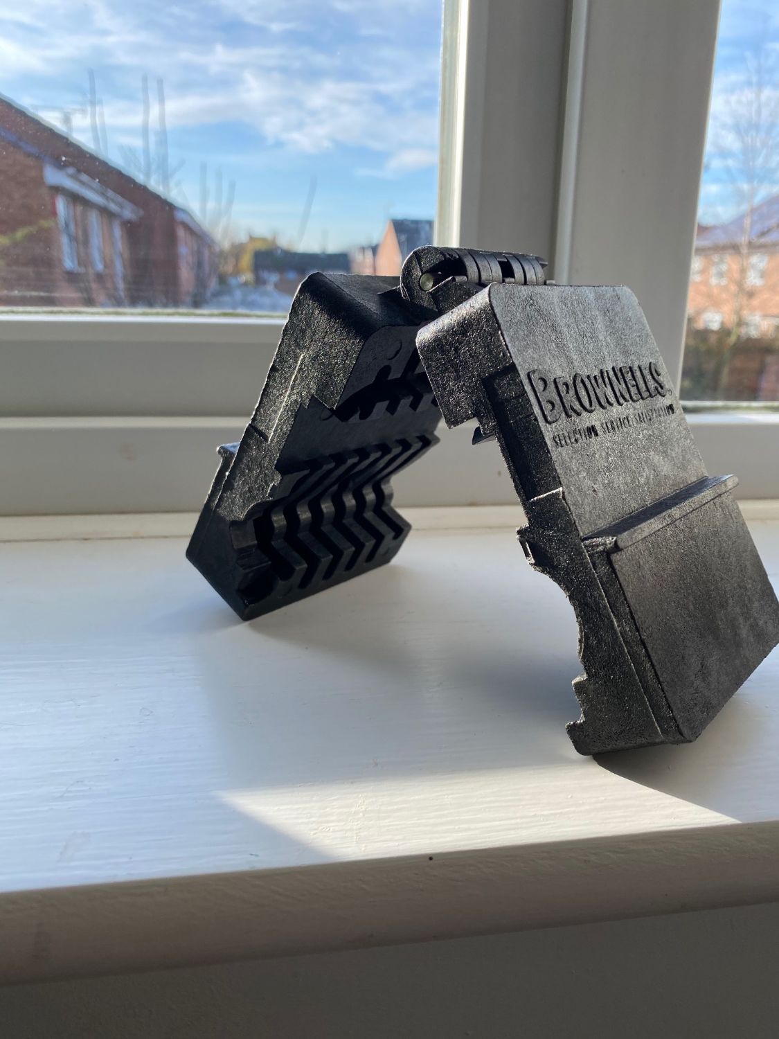

C-Diddy Posted November 7, 2021 Posted November 7, 2021 First proper skirmish with the MWS today and I was impressed and more than a little happy with every trigger pull. Today was unseasonably warm for Nov so green gas was working well and I even managed to score a few hits during the morning. Feeling I could tweak the hop a bit more, I went to the range over lunch, put a mag through her and was very happy. Slapped another mag in, squeezed off two shots then pffft. Bolt neither fully forward or back, lots of manipulating the forward assist to get it far enough forward to separate the receiver, and there it was - the spring in the extractor bent to buggery. At least I have a spare. Shamal and AlphaBear 2
AlphaBear Posted November 8, 2021 Posted November 8, 2021 19 hours ago, C-Diddy said: First proper skirmish with the MWS today and I was impressed and more than a little happy with every trigger pull. Today was unseasonably warm for Nov so green gas was working well and I even managed to score a few hits during the morning. Feeling I could tweak the hop a bit more, I went to the range over lunch, put a mag through her and was very happy. Slapped another mag in, squeezed off two shots then pffft. Bolt neither fully forward or back, lots of manipulating the forward assist to get it far enough forward to separate the receiver, and there it was - the spring in the extractor bent to buggery. At least I have a spare. Bloomin heck what the buggery happened there? Which spring are you talking about again? Is it the bolt spring or the smaller spring at the top of the bolt?
C-Diddy Posted November 8, 2021 Posted November 8, 2021 5 hours ago, AlphaBear said: Bloomin heck what the buggery happened there? Which spring are you talking about again? Is it the bolt spring or the smaller spring at the top of the bolt? Yep, the smaller spring, and having double-checked the spares box, none to be found. Nothing on Impulse101 either. Bugger.
