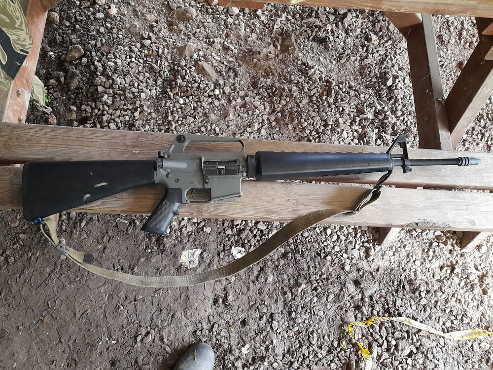

Popular Post Patrolpointman Posted May 26, 2021 Popular Post Posted May 26, 2021 (edited) Hi everyone, long time no post for me but thought I'd throw up my latest gat. I'm waiting on the real early D type stock and pistol grip to finish it off as a proper XM16E1. Base is the MWS M4A1 with a custom upper receiver done by LCS Engineering Outpost. Fencing was removed from the lower by me. Internals are stock with the exception of the rifle length buffer and tube. Edited May 26, 2021 by Patrolpointman Adding in description of work done. lokkers, SSPKali, Hypokondrikern and 3 others 5 1

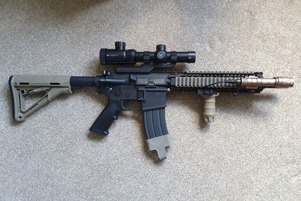

Recoil_ Posted May 26, 2021 Posted May 26, 2021 (edited) Well she's all done! Upgrades are: ML 60 Degree Autobot 2021 rubber and Laylax strike hop arm, Vortex Crossfire ii 1-4x, SixG HSB, Surefire repro, G&P QD stubby foregrip, Magpul FDE rail covers, Magpul magpulls and the Magpul CTR stock. That's it, I'm very pleased with how it turned out. Edited May 26, 2021 by Recoil_ GothicGhost 1

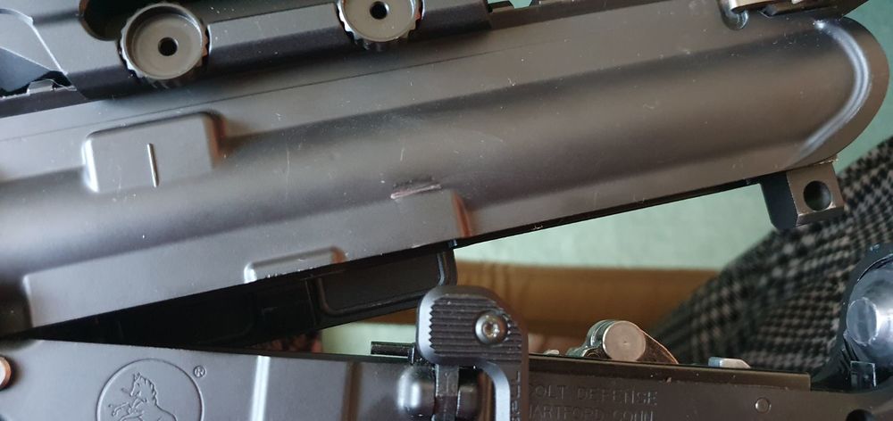

GothicGhost Posted May 26, 2021 Posted May 26, 2021 13 hours ago, quango2k said: Can only see it with the body open Yeah I know it get more scratches over time but I did not want to add more on my new £500 gun lol After a few months it be more warn in

gunbod007 Posted May 26, 2021 Posted May 26, 2021 14 minutes ago, GothicGhost said: Yeah I know it get more scratches over time but I did not want to add more on my new £500 gun lol After a few months it be more warn in I have played 3 games with mine and the left side is pretty scratched tbh from slinging it. Don't mind it but yeah keep an eye out it won't stay pretty long
AlphaBear Posted May 26, 2021 Posted May 26, 2021 1 hour ago, gunbod007 said: I have played 3 games with mine and the left side is pretty scratched tbh from slinging it. Don't mind it but yeah keep an eye out it won't stay pretty long The cerakote is supposed to be quite resilient to scratching... has it been rubbing up against metal (metal on metal) against the mags on your plate carrier for example? Magpul slings will not scratch it as the furniture on them is plastic bar the actual clips...

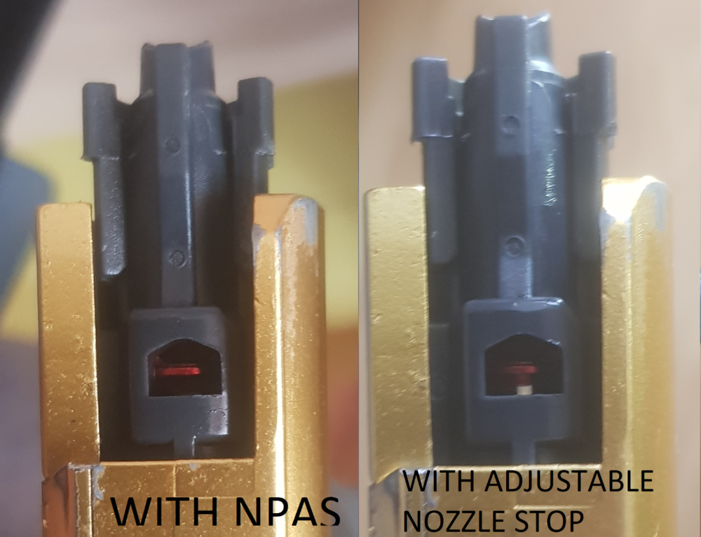

sabaka Posted May 27, 2021 Posted May 27, 2021 On 24/05/2021 at 12:36, TadsJ2 said: By buffer setup u mean: buffer tube? or buffer spring guide? So I did it today, i've come to conclusion - G&P Adjustable nozzle (NPAS) works with adjustable nozzle stop - nozzle stop holds G&P NPAS nozzle sturdier than TM OG one. BUT in my case its a no go, on a lowest setting it gives me 410FPS, highest - 460; so i've put the NPAS set back together and its ~393FPS - so its still working correctly after using it for ~ 20-30shots with adjustable nozzle stop. I wonder what could i do to loose 10FPS? In the photo on the right - lowest setting on adjustable nozzle stop. thanks for your nice feedback. i decided to try ag nozzle set gen.2 for now. heard about g&p adj.nozzle unconsistent fps. i will see ?.
TadsJ2 Posted May 27, 2021 Posted May 27, 2021 1 hour ago, sabaka said: thanks for your nice feedback. i decided to try ag nozzle set gen.2 for now. heard about g&p adj.nozzle unconsistent fps. i will see ?. I wouldnt say its inconsistent. U find a desirable FPS and loctite the NPAS screw, then its nice and sturdy and goes nowhere. AG V2 is a little more inconsistent than G&P NPAS, the best consistency i've seen is on G&P adjustable nozzle stop. SSPKali 1
gunbod007 Posted May 27, 2021 Posted May 27, 2021 19 hours ago, AlphaBear said: The cerakote is supposed to be quite resilient to scratching... has it been rubbing up against metal (metal on metal) against the mags on your plate carrier for example? Magpul slings will not scratch it as the furniture on them is plastic bar the actual clips... Not sure what it rubbed against, possibly mags although unlikely. I did run it slung on my back for a bit but yeah not sure. Nothing deep just a lighter colour on the Cerakote

Reap Posted May 29, 2021 Posted May 29, 2021 On 26/05/2021 at 23:34, AlphaBear said: The cerakote is supposed to be quite resilient to scratching... has it been rubbing up against metal (metal on metal) against the mags on your plate carrier for example? Magpul slings will not scratch it as the furniture on them is plastic bar the actual clips... exactly this! I have taken my MK18 to 1 game and the left side has very light scratches, almost superficial, some of them rubbed off and some remained but they are very faint. It’s from the gun resting and rubbing against my mags, metal on metal as alphabear says. The mags on the other hand have actually lost paint work, so they look worse than the rifle. I bought some Magpuls to prevent this. 3 genuine Magpul and 3 from Amazon almost identical price but the Magpul mag assist are a much tighter fit on the mags and this is what you want.
Kerberos Posted May 29, 2021 Posted May 29, 2021 My TM M45A1 mags gave a pretty deep scratch near my trigger guard when slung it to my side. They have metal bumpers on the bottom, unlike the TM MEU mags which have plastic bumpers. Put some black paint in the scratch to kinda blend it back in. My old WE M4 and WE M14EBR are beat and scratched to hell, but for some reason I get bothered when my MWS gets a scratch
