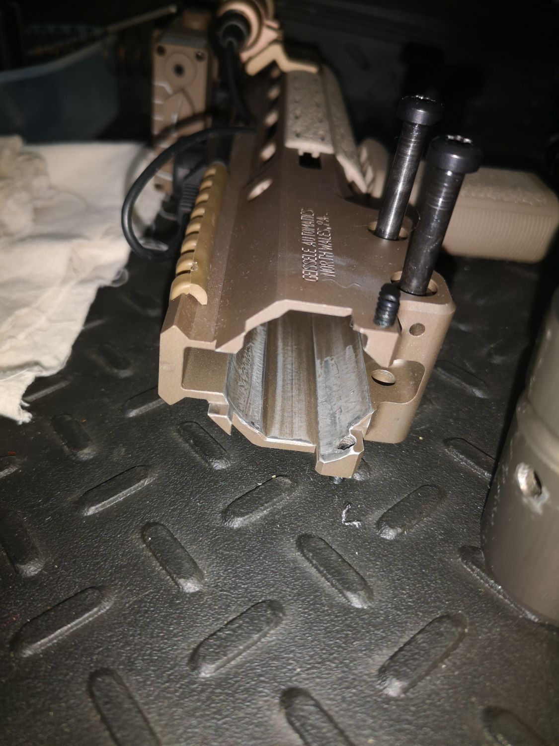

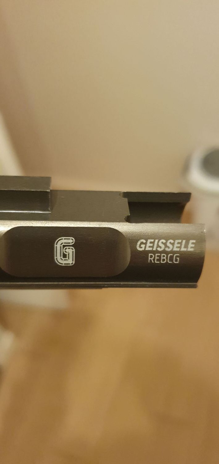

Wild Weasel Posted November 13, 2020 Posted November 13, 2020 Happy days, Hao Econoline Geissele REBCG (Reliability-Enhanced-Bolt-Carrier-Group) in DDE colour and replacement barrel nut is out for delivery today, so I'm all set in 'shop mode for upgrade time. Hao 9.3" Civilian URGI handguard has had a light sanding down of the four bearing surfaces to ease the handguard on an off without so much effort as it is immensely tight and requires hammering with a rubber mallet to remove, the barrel nut has been replaced also as it has light scoring that could potentially make it tighter to remove. Upgrades already done are modify tan hop rubber (first time I've tried this so should be interesting coupled with the essential mws upgrade Super Six G nub.) Dp enhanced piston seal, mags are green gas modified ready. Angry gun nozzle fitted with R A Tech black Npas. My goals for this upgrade are better consistency and improved accuracy. As as man of science (choke, LOL) I'll be trying to prove my findings on the rif ballistic performance spreadsheet I/we have created so if anyone knows of a way of creating a printable target to obtain a standardized accuracy test and sharing over Google sheets that would be great so we can prove out these mods and sort of justify the fortune we've spent over lockdown and not waste money on kit that does not work/incompatible with other mods. I believe there's another file on this forum somewhere that has a list of what works and what doesn't. Admins is there any possibility of combining these two files please? Any constructive comments/ suggestions greatly appreciated. Link below to spreadsheet. https://docs.google.com/spreadsheets/d/1lfmKJtQm-qGtE-EJLlXXixfkon5uT6nDdt7BJOOOb1o/edit?usp=drivesdk RMDavis 1

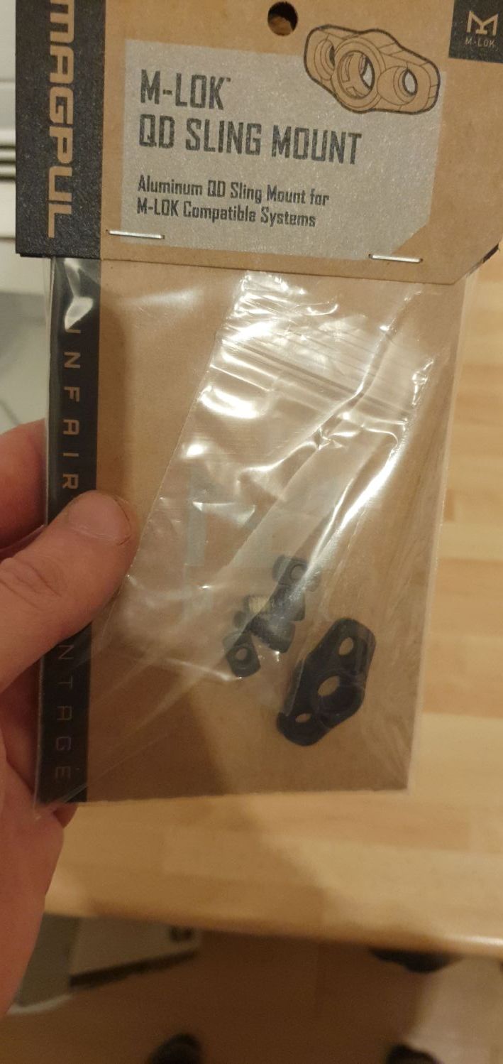

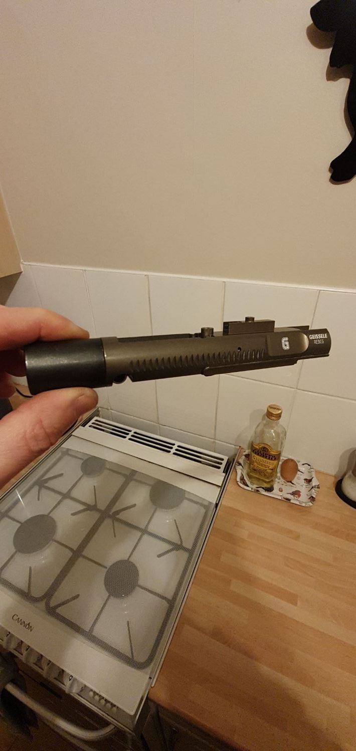

RMDavis Posted November 13, 2020 Posted November 13, 2020 Delivery today for me also @Wild Weasel Firstly a HAO Geissele BCG which is a very well machined piece of aluminium. The colour is lighter than the tan HAO use for their rails but it's close match to the shade used for the real Geissele BCG. Hoping to get it fitted on Monday and will report back. Secondly my Magpul M-Lok QD mount arrived for my SL-K stock, not very exciting but it's pretty much the final piece for my 9.3" URGI build! Next year I'm definitely picking up a second MWS with the plan to build a 14.5" rifle as I've really enjoyed working on this one! AlphaBear and Wild Weasel 1 1

Wild Weasel Posted November 13, 2020 Posted November 13, 2020 3 hours ago, RMDavis said: Delivery today for me also @Wild Weasel Firstly a HAO Geissele BCG which is a very well machined piece of aluminium. The colour is lighter than the tan HAO use for their rails but it's close match to the shade used for the real Geissele BCG. Hoping to get it fitted on Monday and will report back. Secondly my Magpul M-Lok QD mount arrived for my SL-K stock, not very exciting but it's pretty much the final piece for my 9.3" URGI build! Next year I'm definitely picking up a second MWS with the plan to build a 14.5" rifle as I've really enjoyed working on this one! Do us a solid, whip out your buffer and see if the hao BCG has grooved the inside of your buffer tube where the roller has been please? Just trying to figure out off this is legacy wear or if it's today's testing results which are on the spreadsheet if interested. RMDavis 1

RMDavis Posted November 13, 2020 Posted November 13, 2020 1 hour ago, Wild Weasel said: Do us a solid, whip out your buffer and see if the hao BCG has grooved the inside of your buffer tube where the roller has been please? Just trying to figure out off this is legacy wear or if it's today's testing results which are on the spreadsheet if interested. Yeah man I can check on Monday when I get chance to fit the HAO BCG. I will check before and after fitment. ? Wild Weasel 1

RMDavis Posted November 17, 2020 Posted November 17, 2020 On 13/11/2020 at 21:34, Wild Weasel said: Do us a solid, whip out your buffer and see if the hao BCG has grooved the inside of your buffer tube where the roller has been please? Just trying to figure out off this is legacy wear or if it's today's testing results which are on the spreadsheet if interested. Fitted the HAO bcg yesterday, and had a good look at the inside of my buffer tube. Prior to fitment there was no witness marks on the inside of the tube that I could see and again after fitment and a couple of mags put through it for testing I couldn't see any obvious wear. Admittedly I was short on time as thus was carried out on my lunch break at work (boss is a fellow airsofter and I work in a workshop on a farm so all good!) So i haven't been able to test it thoroughly. On the face of it though all seems okay, although trying to get the upper plastic section that holds the nozzle with that spring was bloody tricky! ? Wild Weasel 1

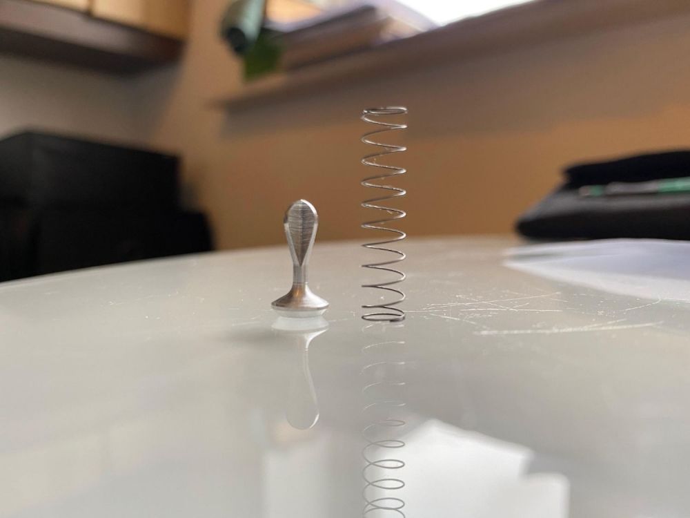

ajumma Posted November 17, 2020 Posted November 17, 2020 2 hours ago, RMDavis said: On the face of it though all seems okay, although trying to get the upper plastic section that holds the nozzle with that spring was bloody tricky! ? Yup, that spring sucks. I've gotten quite good at it though by following how Badabing does it. Put the nozzle guide in (the plastic section) and pull it towards the back of the bolt, so its sat like it would sit if the spring were inside. Then push the spring into the hole where it's supposed to sit and use the flathead to compress it into the little chamber where it sits, and when you pull the flathead out, it will engage with the post where it should sit. RMDavis and jsmithski 2
jsmithski Posted November 17, 2020 Posted November 17, 2020 27 minutes ago, ajumma said: Yup, that spring sucks. I've gotten quite good at it though by following how Badabing does it. Put the nozzle guide in (the plastic section) and pull it towards the back of the bolt, so its sat like it would sit if the spring were inside. Then push the spring into the hole where it's supposed to sit and use the flathead to compress it into the little chamber where it sits, and when you pull the flathead out, it will engage with the post where it should sit. Yeah, best wat to put it in, I also use another screwdriver to keep the spring in while I’m pulling out the first one so it does not jump out. RMDavis 1
