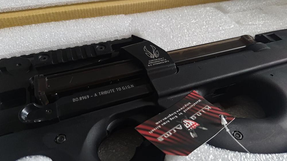

Does anyone have experience with, or know anything about, the BO Dynamics P90? It's King Arms OEM and they upgraded it with a MOSFET but IDK what they used exactly.
Can't seem to find much of anything on the internet about this and their own website doesn't have it listed, I assume it's because they're that old. I can only assume it's a simple MOSFET to protect the trigger contacts and let you use 11.1v safely rather than having any special functionality. All i've found about the King Arms P90s is that they're probably the best of the P90s before you get to Krytac and G&G.
