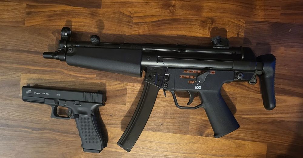

Mels Posted August 10, 2022 Posted August 10, 2022 (edited) Finally in the club ? In regards to the tight magazines, I've noticed the one it came with seems to need a bit more encouragement to fit but the others are fine. Edited August 10, 2022 by Mels JimFromHorsham 1
