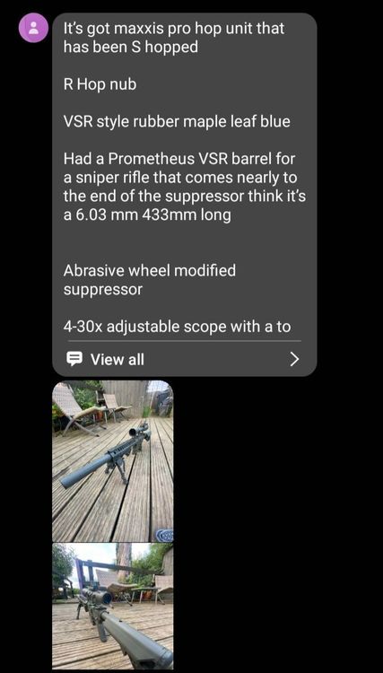

hi guys, I have a guy asking if I'd swap my gun for his after ige listed it, turns ut to be a DMR and I've wanted one a while, claims to be hitting 70-80m accurately with it but I'm unsure as from what I know it takes quite a built up bolt action for that, keeping in mind it's an AEG,   Its a £250 specna arms base gun with the upgrades listed in images

With an AEG I'd be thinking about asking, as your image doesn't show it, if they also possibly changed the cylinder / improved the volume of air to support that very long inner barrel.

All other considerations aside, I'm a bit dubious about his claims that it has a Maxx hop unit but a VSR barrel and rubber. Pretty certain that the Maxx unit will only work with AEG rubbers.
it could be a ml hot-shot bucking? although he also claims it's s-hopped which is a totally different setup.
i'd be asking what ammo he's using for that range, followed by the cylinder setup.
630 is a lot of barrel for a standard m4 cylinder (i'm assuming m4 but pictures could be sr i can't really tell)
^edit, scratch that, i'm evidently at the hallucinations phase of insanity, 430mm is fine for barrel length.
That might be a viable combination, you could s-hop a VSR barrel easily enough then slip any smoothed off bucking over it.  At UK energy levels it doesn't really seem worth it over just using an AEG barrel and Maple Leaf rubber, but if it works, it works.
70m sure, 80 is rare. He's saying 70-80, which means max 70.
VSR rubber won't fit an AEG. I guess he means the maple leaf AEG rubbers, which are the same colours and names as the vsr rubbers. But if it's s-hopped then it doesn't matter.
Oh, I hadn't spotted that he's claiming it has a VSR rubber as well. No, that's jive, man.  If he's making that up, what else is he stretching the truth on, I'd wonder.
he said vsr style maple leaf, which is what had me thinking hot-shot.
i'm still wondering why the hell you'd s-hop a ml bucking and use a vsr barrel over just using an aeg barrel with a standard maple leaf bucking.
unless he already had the barrel lying around and decided to install that instead of buying a dedicated one for the build?

Huge barrel for a V2 so hopefully a full cylinder in there.
