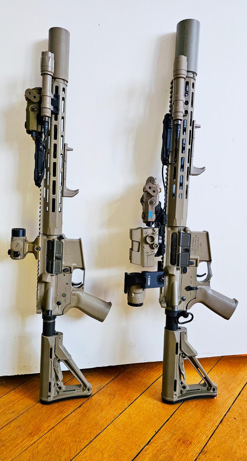

Supporters Popular Post TheFull9 Posted March 1 Supporters Popular Post Posted March 1 I dunno... bit of a vanilla, run-of-the-mill, pedestrian looking setup there tbh, you'll find most other people at your next game running the exact same kinda gun I'm afraid. Enid_Puceflange, BRThoughts, Colin Allen and 2 others 5
Moderators Tackle Posted March 1 Moderators Posted March 1 26 minutes ago, TheFull9 said: I dunno... bit of a vanilla, run-of-the-mill, pedestrian looking setup there tbh, you'll find most other people at your next game running the exact same kinda gun I'm afraid. TheFull9 and Rogerborg 1 1
Anonymoose Posted March 1 Posted March 1 1 hour ago, TheFull9 said: I dunno... bit of a vanilla, run-of-the-mill, pedestrian looking setup there tbh, you'll find most other people at your next game running the exact same kinda gun I'm afraid. Well i think most of us have at least two of them to loan out. Tackle and TheFull9 1 1

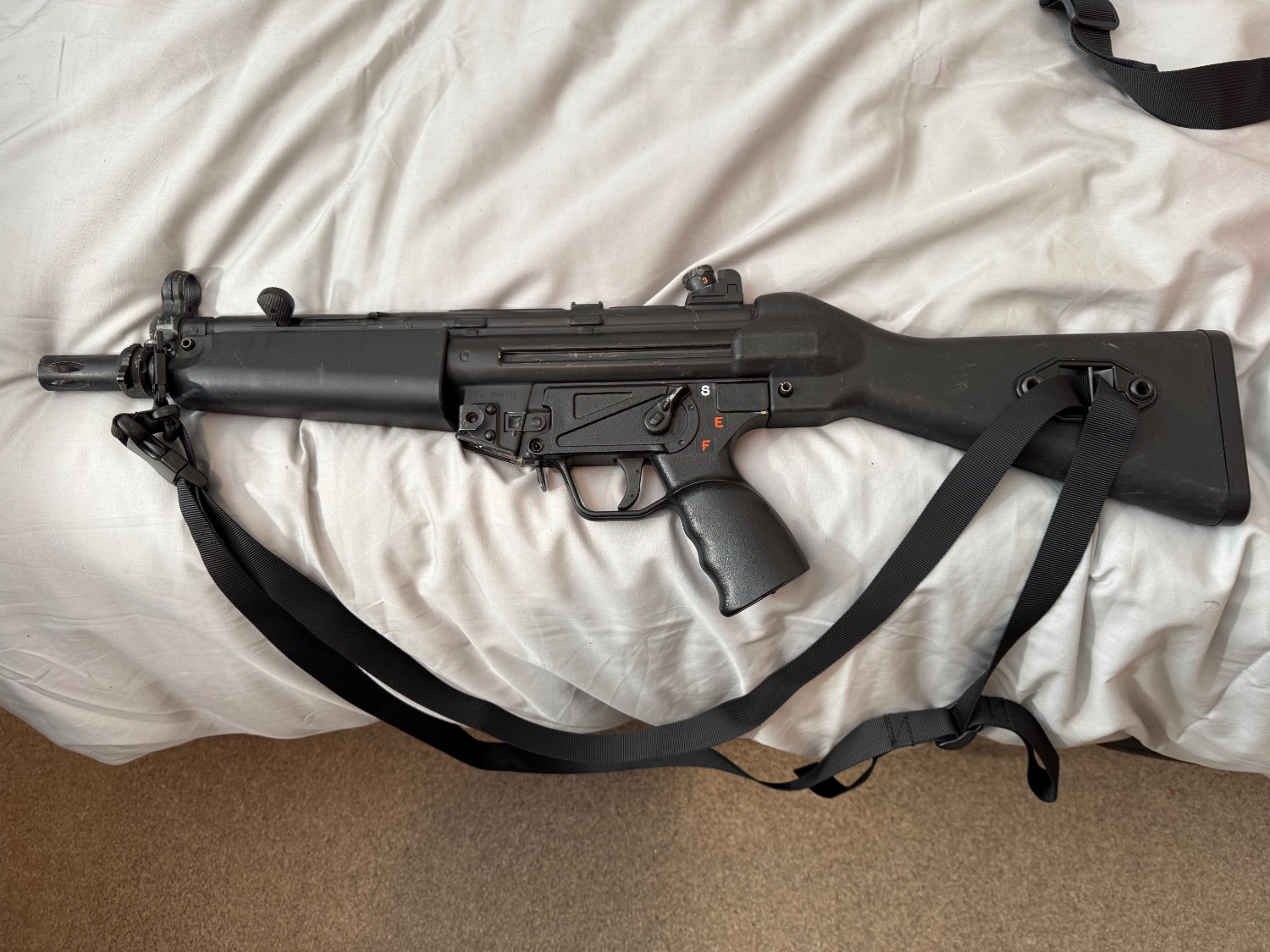

Colin Allen Posted March 1 Posted March 1 Nothing special, but this is my eldest son's old SRC MP5 that he gave me when he gave up airsoft several years ago. It had a "Navy" style lower and selector, which I really disliked. This morning, I decided to install a Perun Hybrid; having done that, I started wondering if I could fettle one of my spare Classic Army lowers to fit. I could; after some minor surgery, everything aligns well and it functions perfectly. A well spent morning. Rogerborg, Tackle, ButcherBill and 1 other 4

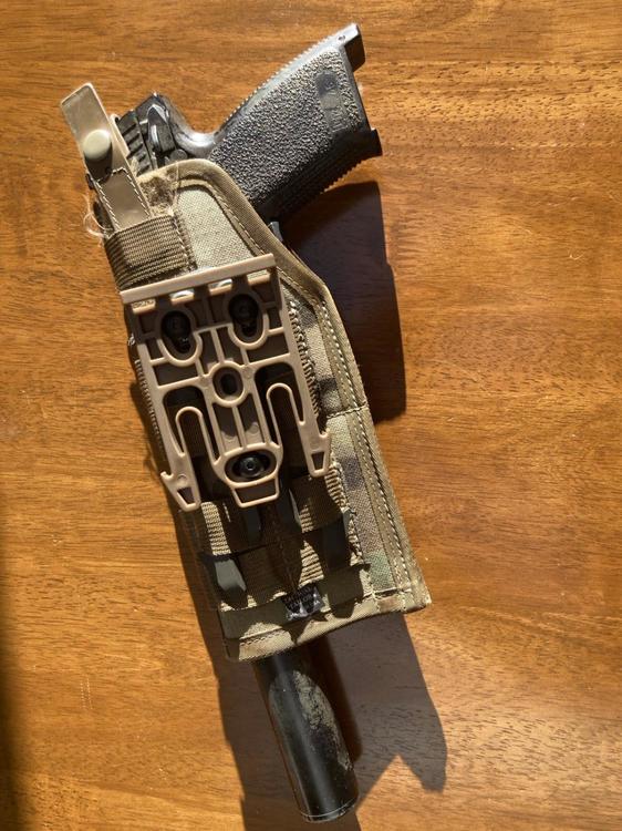

Hatchet Posted March 2 Posted March 2 Not exactly *made* as such, but succeeded in Safarilanding my MK23 holster so I can swap between loadouts with the same belt rig a bit easier. This was more difficult than it should be due to lacking the right screws and retaining nuts, so I had to improvise with some 8/32 UNC t-nuts and clip the prongs off them. It's a replica mount, but it fits into the real Safariland well enough.

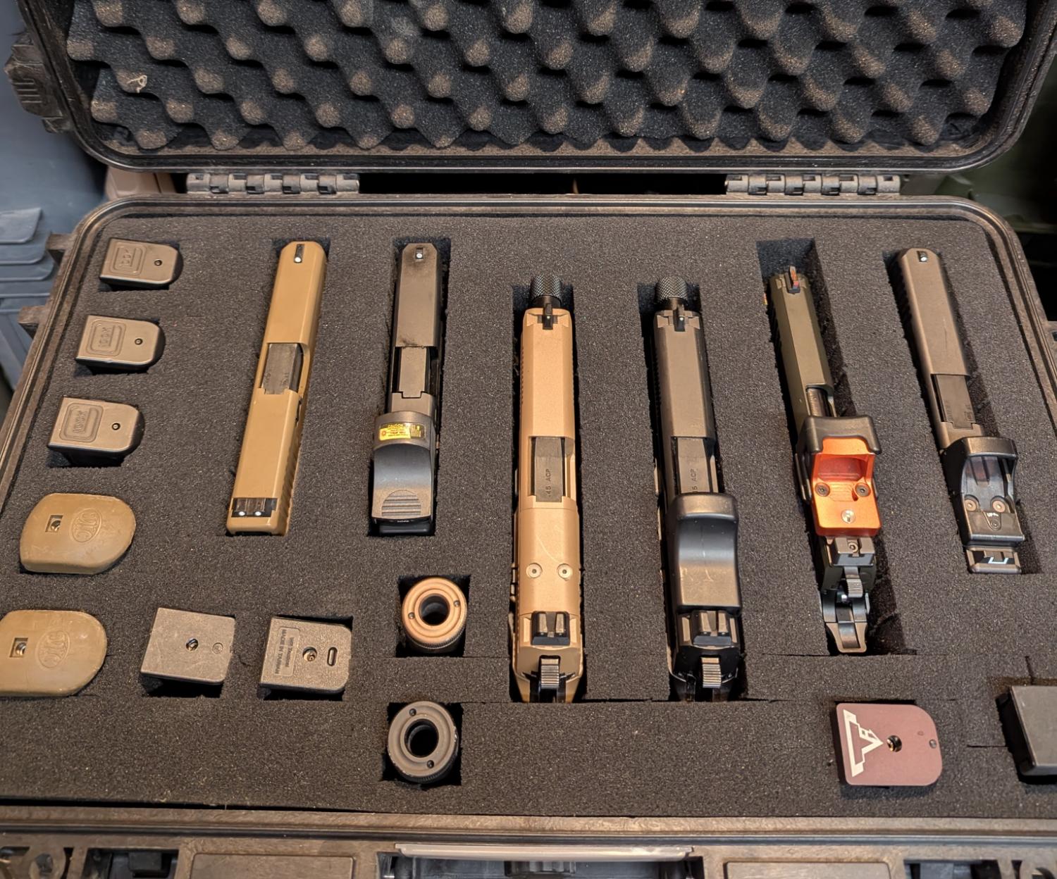

Popular Post mightyjebus Posted March 3 Popular Post Posted March 3 since I was doing stuff, thought I best get around to sorting out a pistol case. Galvatron, Tackle, BigStew and 4 others 5 2
Tommikka Posted March 4 Posted March 4 14 hours ago, mightyjebus said: since I was doing stuff, thought I best get around to sorting out a pistol case. I like the way that you think, using the depth rather than laying things flat with miles of foam deep below mightyjebus 1

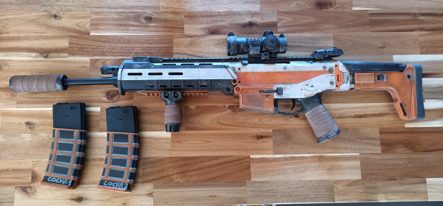

Cocha Posted March 7 Posted March 7 Since I bought a PTS Masada I had the A&K laying around... Was thinking about selling it but I think I'm better off this way Lonex flash magazines painted accordingly, cheap Amazon red dot to be used on this one and on the M14. Painted using Fosco spray paints, Warhammer transferables for markings, serial number, etc., miniature pigments for weathering. Silencer and grips wrapped in my girlfriend's AliExpress boob tape ? PopRocket123 1
strykerles Posted March 7 Posted March 7 51 minutes ago, Cocha said: Since I bought a PTS Masada I had the A&K laying around... Was thinking about selling it but I think I'm better off this way Lonex flash magazines painted accordingly, cheap Amazon red dot to be used on this one and on the M14. Painted using Fosco spray paints, Warhammer transferables for markings, serial number, etc., miniature pigments for weathering. Silencer and grips wrapped in my girlfriend's AliExpress boob tape ? That looks...............................the tits.................. Rogerborg and Tackle 2

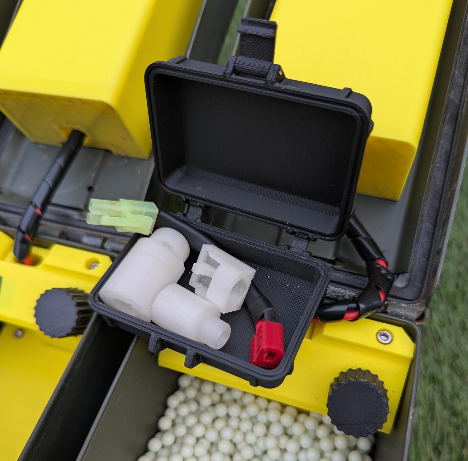

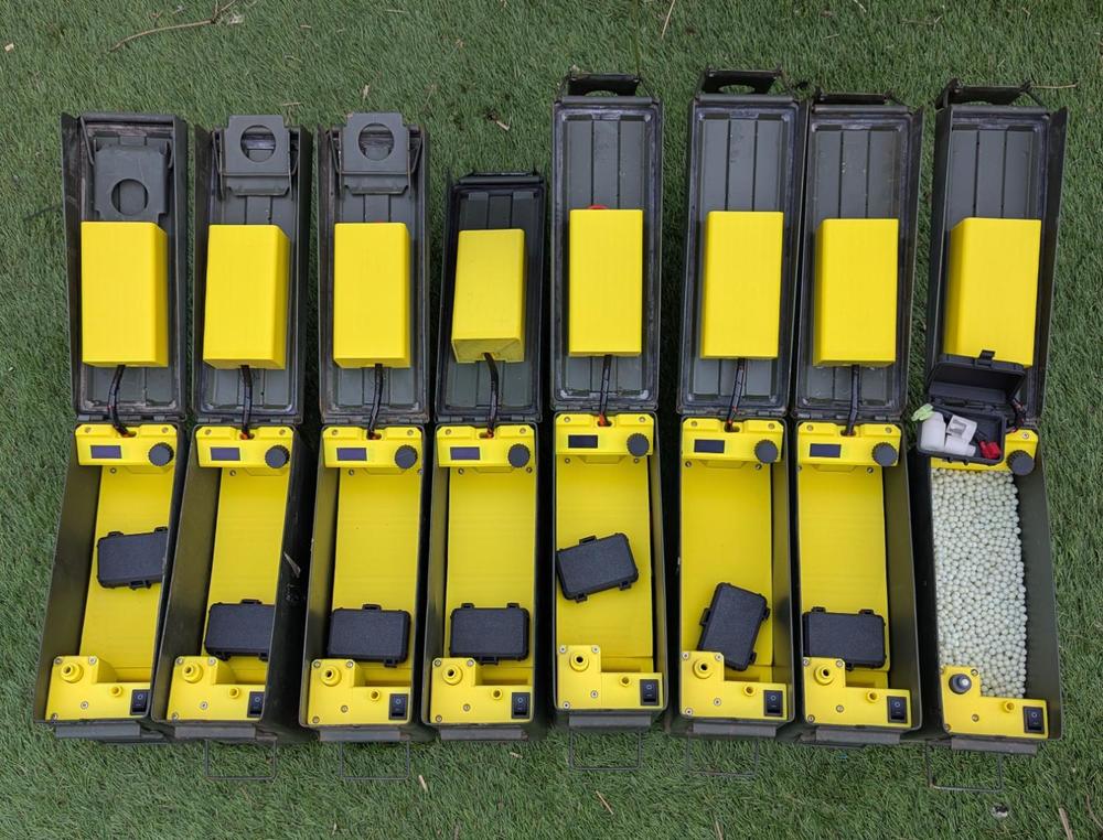

mightyjebus Posted March 22 Posted March 22 you have a speed loader for your magazines, I have a speed loader for each magazine. We are not the same. Little box holds adapters for MWS, PTW, P90 and a cable to go from deans to Tamiya depending on which battery you have. Rogerborg, Enid_Puceflange and ButcherBill 1 2

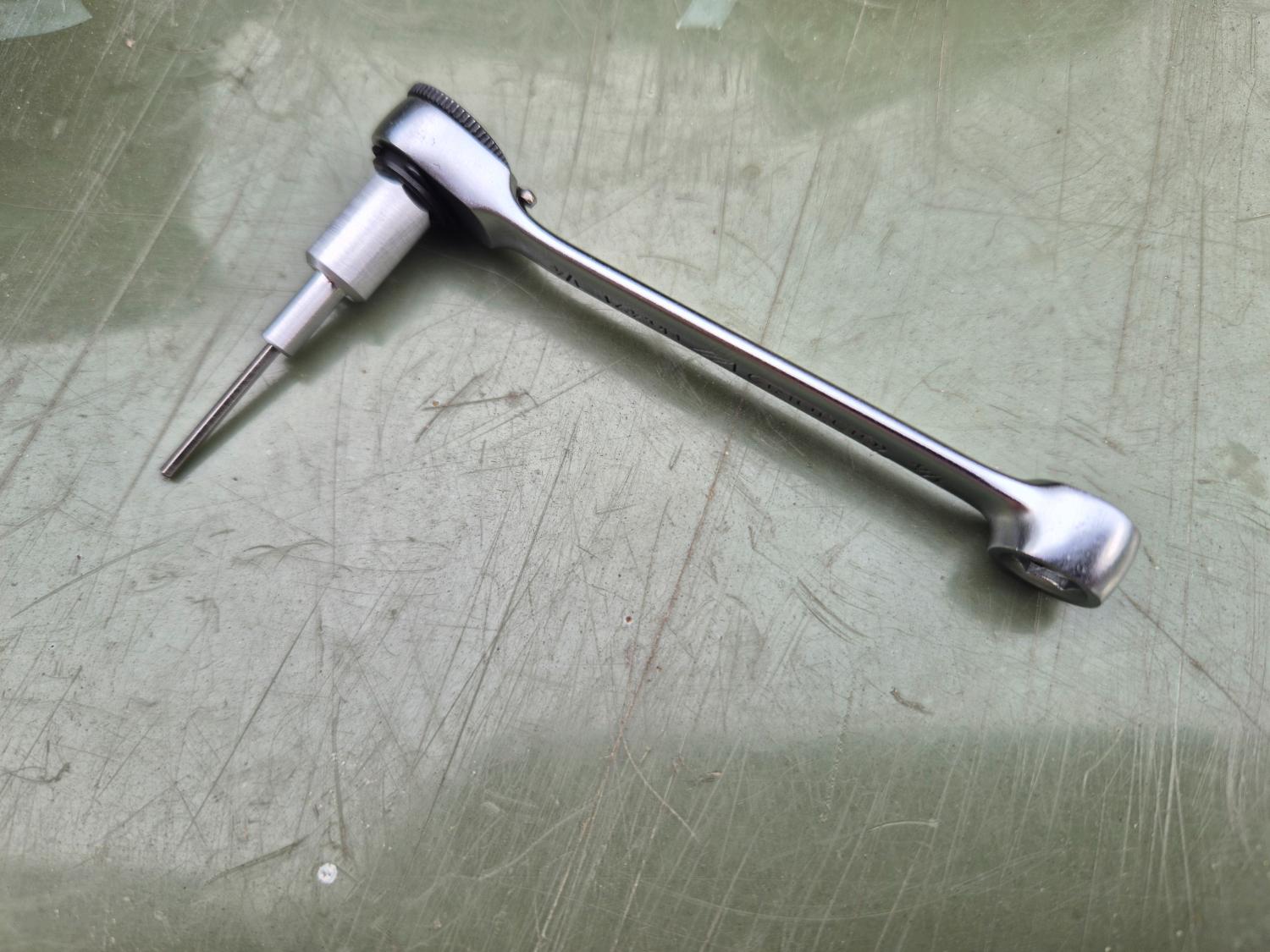

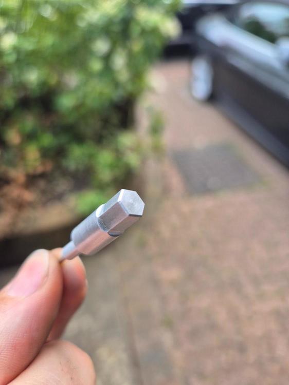

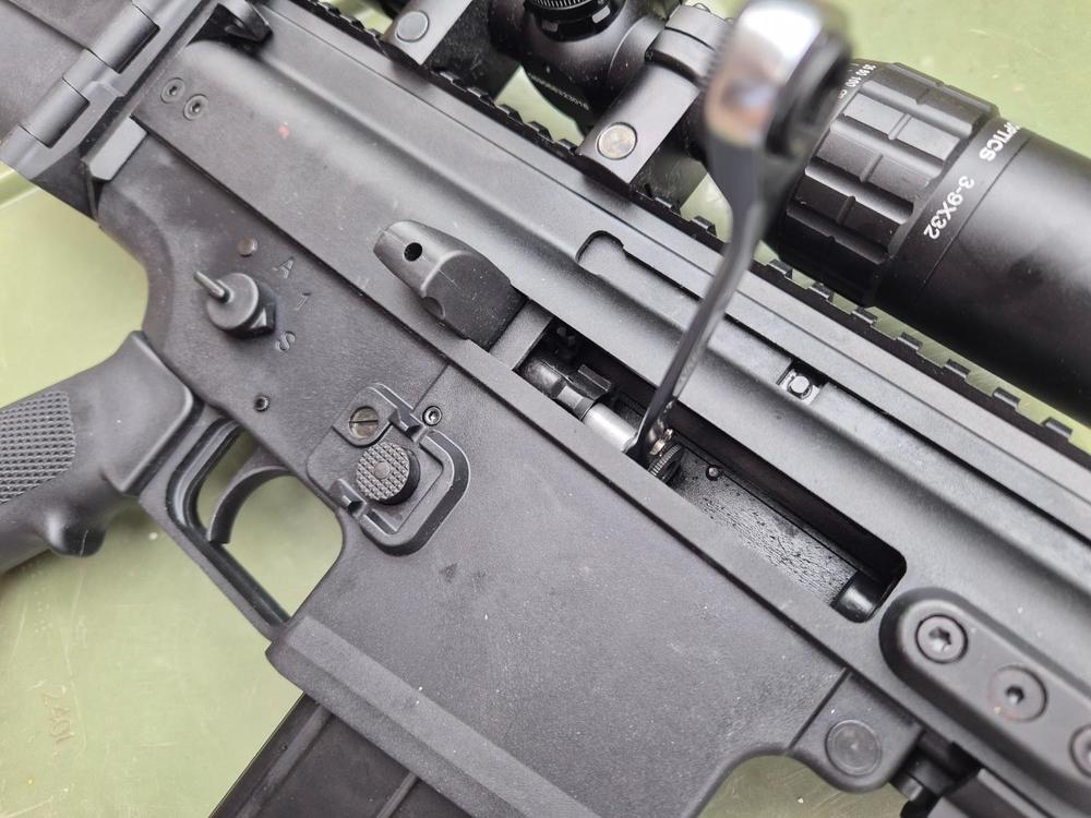

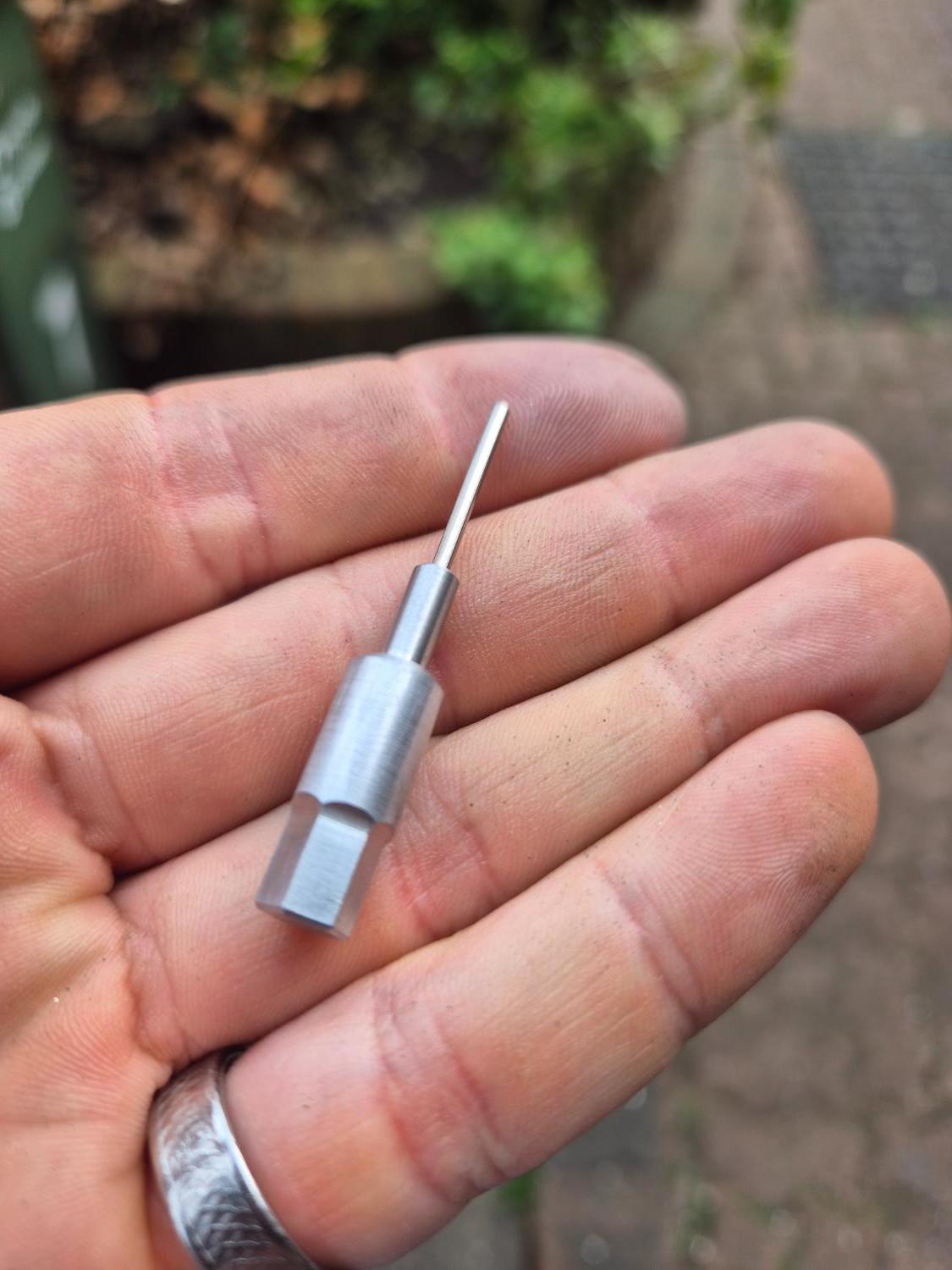

Popular Post Anonymoose Posted April 12 Popular Post Posted April 12 After discovering my VFC SCAR-Hs have an NPAS from the factory (?) i made an adjuster tool to make it easier to tweak through the ejection port rather than stripping it down every time. enzo47, DanBow, PopRocket123 and 3 others 3 3

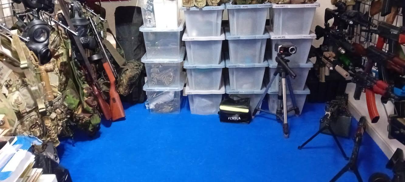

Popular Post ButcherBill Posted April 12 Popular Post Posted April 12 Doubt this will count but I made a tidier mancave... Tackle, DJsnipe, PopRocket123 and 2 others 5
Barny Posted April 13 Posted April 13 On 12/04/2025 at 21:03, Anonymoose said: After discovering my VFC SCAR-Hs have an NPAS from the factory (?) i made an adjuster tool to make it easier to tweak through the ejection port rather than stripping it down every time. If you fancy making some more i'd buy one from you
Anonymoose Posted April 13 Posted April 13 1 minute ago, Barny said: If you fancy making some more i'd buy one from you For the VFC SCAR-H as well?
Barny Posted April 13 Posted April 13 1 minute ago, Anonymoose said: For the VFC SCAR-H as well? Ahh, have i jumped the proverbial gun here and assumed it'll fit any VFC...?
Anonymoose Posted April 13 Posted April 13 1 minute ago, Barny said: Ahh, have i jumped the proverbial gun here and assumed it'll fit any VFC...? I don't know to be honest. I know the VFC SCAR-Hs have an NPAS from the factory, while my two VFC MP5s don't. Not sure which others have them. Making another tool to fit other brands/models is no issue, but they do use different size hex keys and different nozzle internal diameters. (This is made to be a close fit into the nozzle for alignment of the hex key and to prevent damage.)

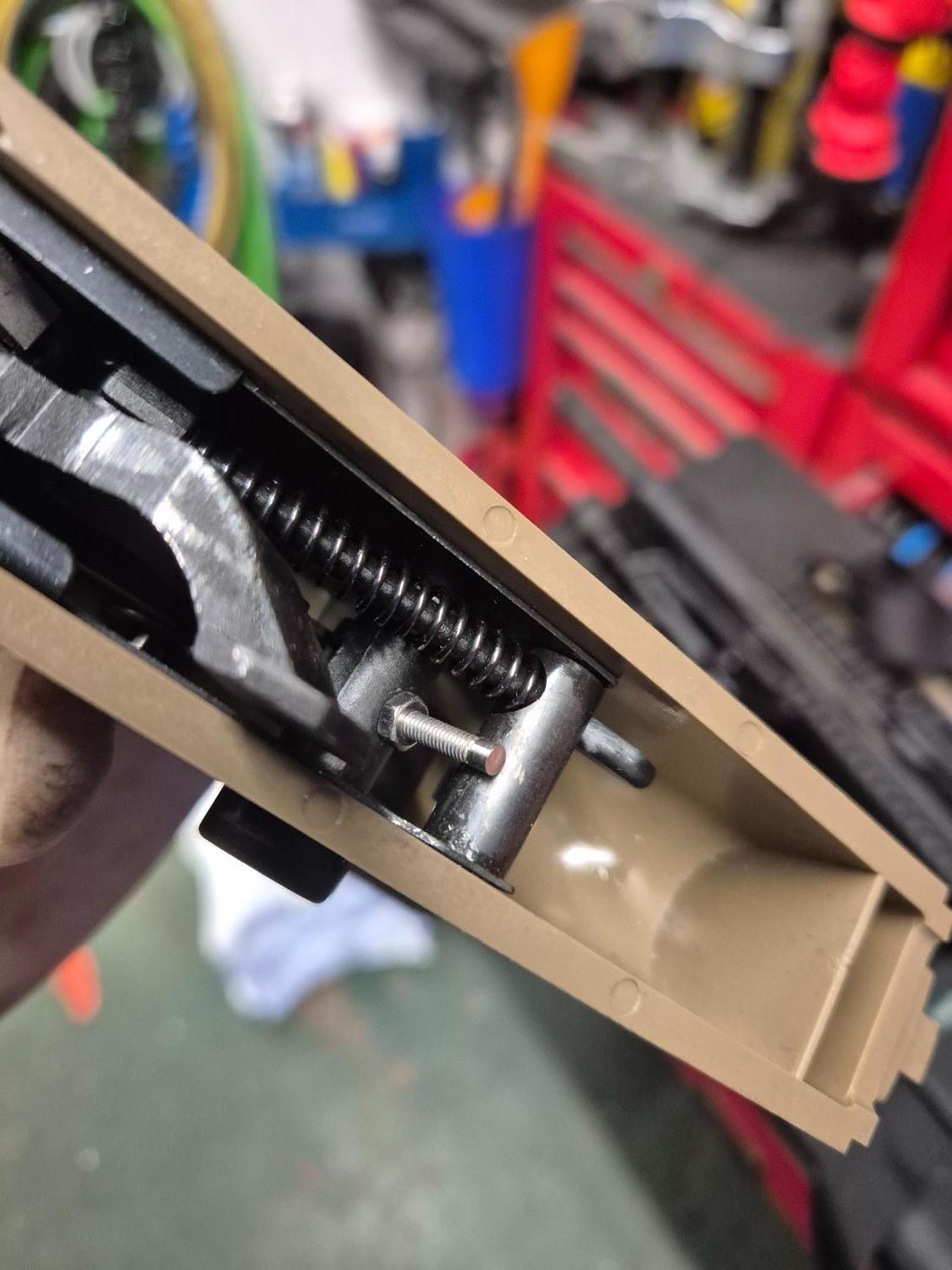

Anonymoose Posted April 19 Posted April 19 "Made" a locking pin to lock my SCAR-H MK20 to semi-only for DMR use. Very basic; drilled and tapped the selector cam and used a machined bolt to hit that rear pin in semi so the selector can't turn any further. Gonna take it to RIFT tomorrow and hopefully get some kills in with it. Rogerborg, TheFull9, Enid_Puceflange and 1 other 3 1
