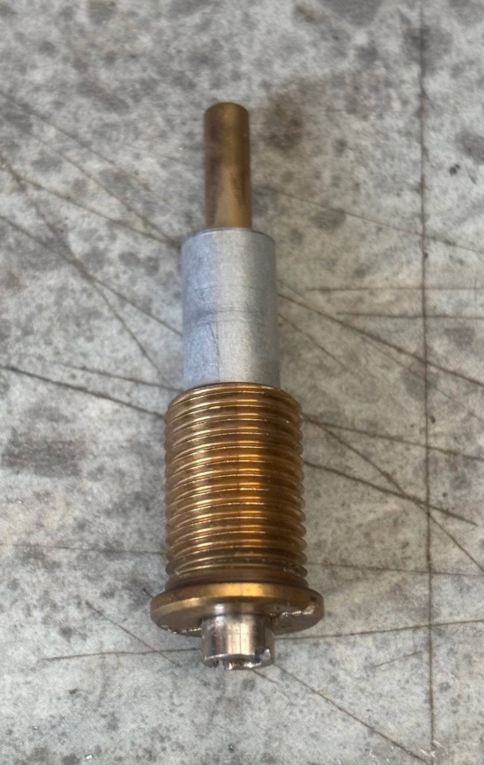

SSPKali Posted October 15, 2023 Posted October 15, 2023 (edited) Silent fill valve o-rings removed and fill tubes replaced with 7mm ID stainless steel tube, 50mm length from the brass threads. This is a bit less than stock but still gives a good space for the gas to fill above the liquid. The stainless tube is a snug push fit over the alu tube so with some grease and percussive maintenance it goes on and stays on ? I filled the mag with ASG beige gas until it spluttered, then tilted and got another 1s worth of fill. Bearing in mind it is quite cool today I was able to fire 140 shots and still have it lock back, the mag was pretty cold by then so I popped it in my pocket for 30sec while I got some BBs and turned on the chrono. It was putting out 230fps on 0.32g and locked back after the 14 shots I fired. Pretty damn amazing! Right, beer o’clock ? “Tell me you know nothing about GBBRs, without telling me you know nothing about GBBRs” ? Edited October 15, 2023 by SSPKali Nick G and C-Diddy 2
