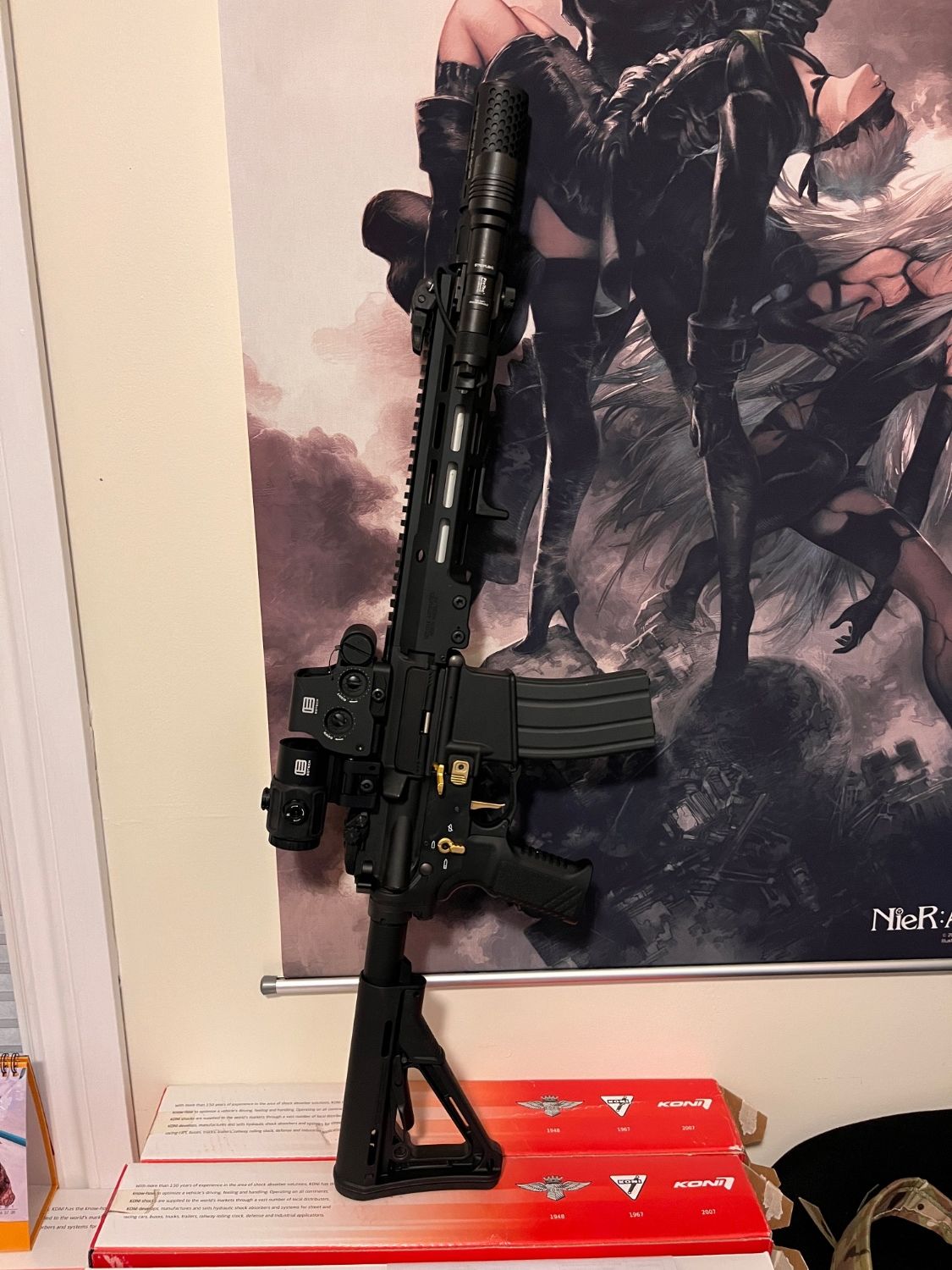

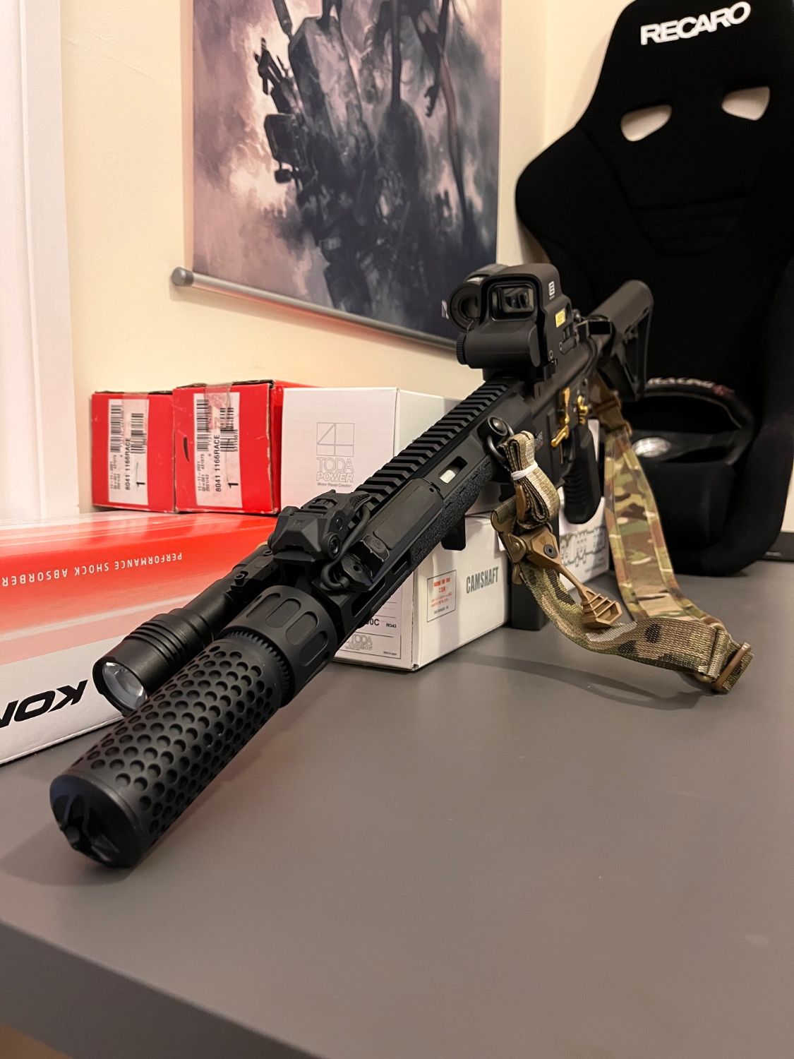

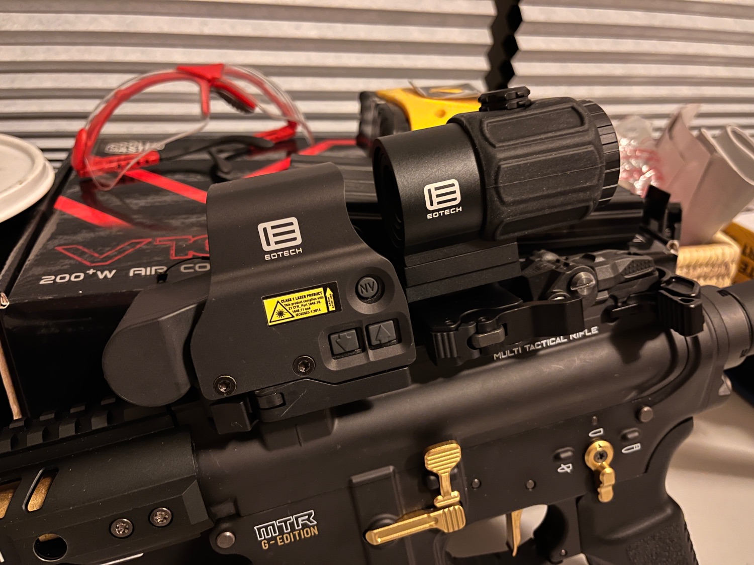

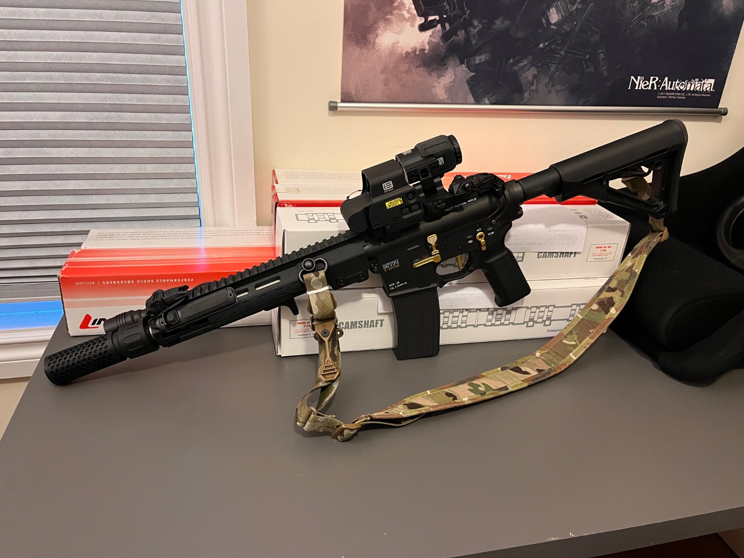

sloppyclock Posted February 22, 2023 Posted February 22, 2023 (edited) Finally got my parts in for my MTR16 the other day and had a chance to install them. HAO Industries 10.5" MK16 Hand Guard Revanchist 11.5" Outer Barrel Magpul CTR Stock G&P EMG SI Charging Handle Ferro Concepts Slingster w/ PTS QD Sling Attachments Real Steel EOTech EXPS3-2 w/ G43 magnifier The Hao Industries MK16 hand guard is a super nice unit. Fit and finish is top notch, no shims are needed and it isn't that expensive either compared to other companies. It also comes with a barrel nut so you don't need to worry about getting one. One thing that bugged me with the Revanchist outer barrel is that they include a .5" extension with it but it's not in any packaging or anything so it rattle and rubs against the barrel during shipping and leaves a lot of scratch marks on it. Edited February 22, 2023 by sloppyclock
