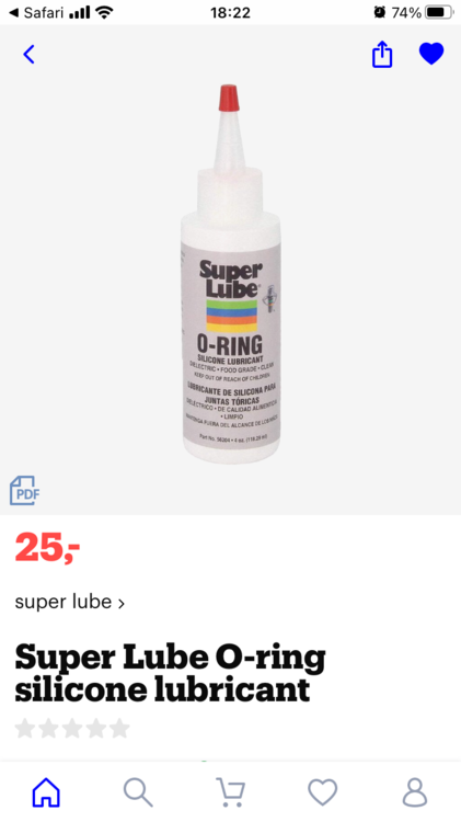

Tom_84 Posted February 4, 2022 Posted February 4, 2022 Anyone got experience with this brand or good tips. tnx
