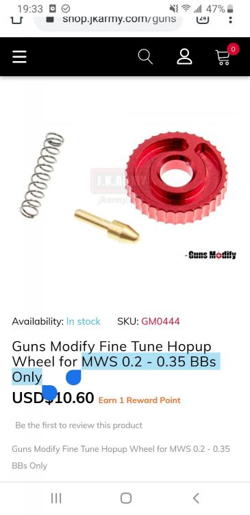

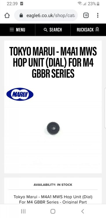

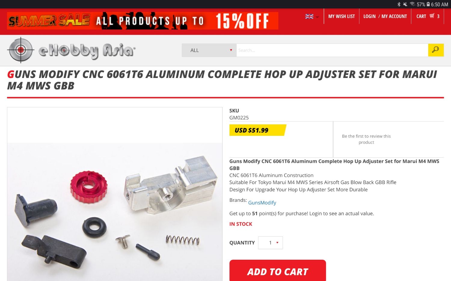

P4radox Posted September 30, 2020 Posted September 30, 2020 6 hours ago, Davegolf said: @P4radox stock tm hop unit, bucking and Super Nub will lift 0.36 Yes ,just spoke about the Gunsmodify "Fine tune" wheel
GregArm Posted September 30, 2020 Posted September 30, 2020 I think Davegolf meant this wheel. This wheel will press the Super Nub better and the heavier balls will spin and lift.
PopRocket123 Posted September 30, 2020 Posted September 30, 2020 I bet I could print one of those from polycarbonate it'd be almost as strong as the aluminium one
Davegolf Posted September 30, 2020 Posted September 30, 2020 @P4radox as a fix you can cut a small square of plastic sheet, the sort that the clear packaging display boxes are made of - that the guns modify hop unit probably can in lol - and superglue it onto one of the hop arm paddles. Basically increasing the relayed pressure applied from the first (hop wheel driven) lever to the second lever (pushing the nub) GregArm, SSPKali and mr^Mobs 1 2

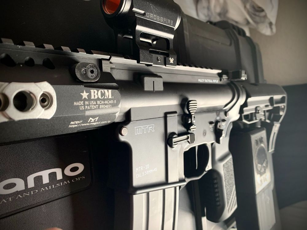

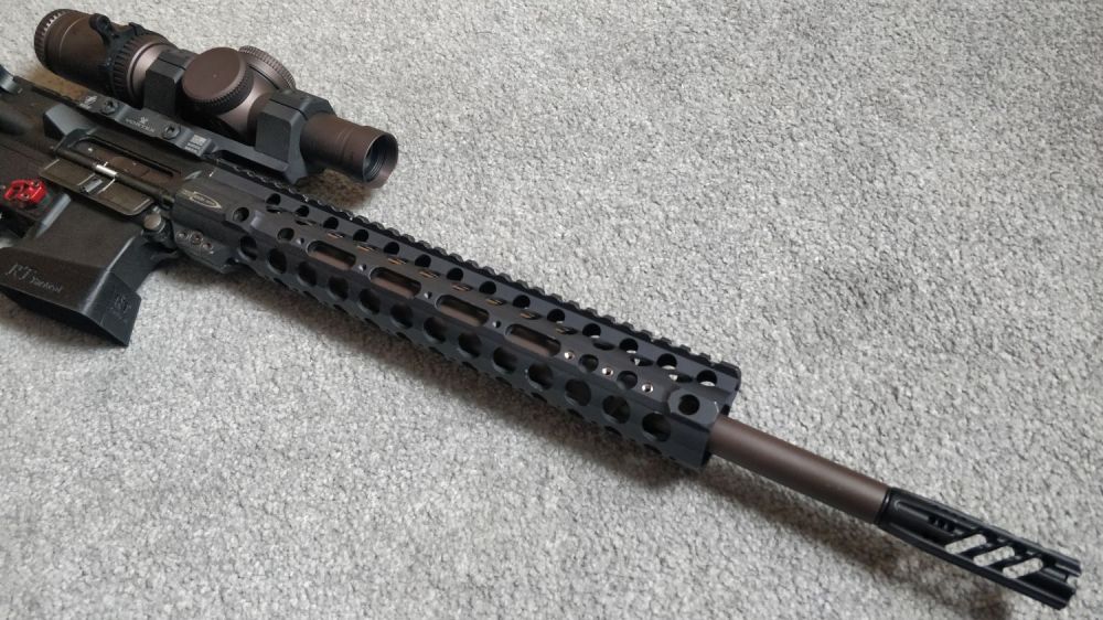

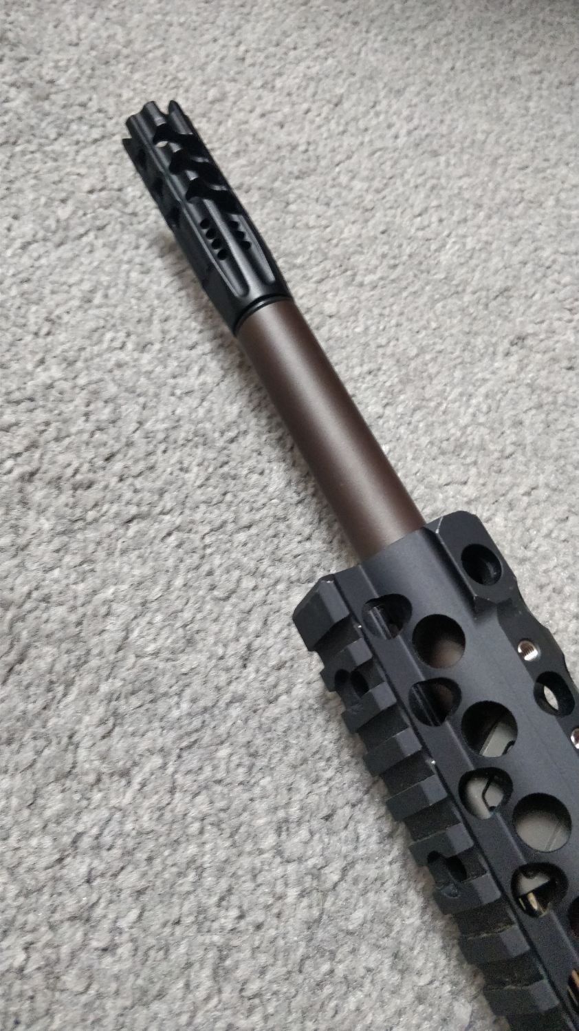

Popular Post mr^Mobs Posted October 1, 2020 Popular Post Posted October 1, 2020 Just reassembled my mws after getting the barrel cerakoted in vortex bronze to match my scope. Would highly recommend MPH Cerakoting if anyone fancies a splash of colour on the baby. https://www.facebook.com/mphcerakoting/ I've attached some pictures, because I'm a proud father Hypnosis, Crazy_Crystal, SSPKali and 5 others 2 6

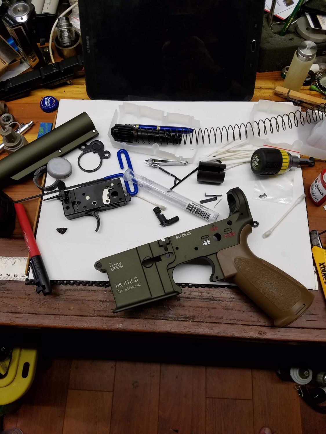

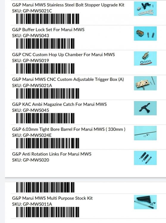

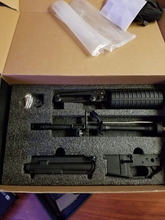

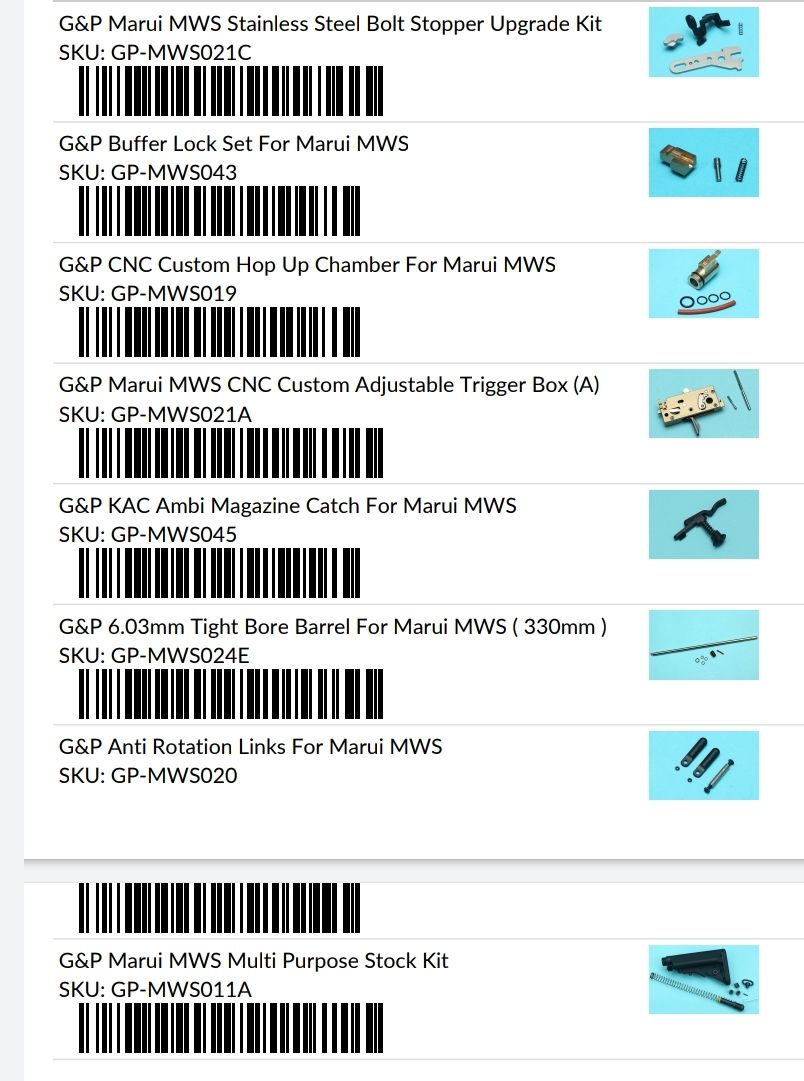

Marroksteel Posted October 2, 2020 Posted October 2, 2020 So... yeah mws carbine came in yesterday morning and literally spent the day taking it apart and figured out how it works then refitting it to the Hao and got to the point where I thought(evil things) should I just buy G&P's complete trigger, bolt catch upgrade, hop unit, and other bits and have 2 mws's lol I'm going Tokyo marui crazy....
AlphaBear Posted October 2, 2020 Posted October 2, 2020 52 minutes ago, Marroksteel said: So... yeah mws carbine came in yesterday morning and literally spent the day taking it apart and figured out how it works then refitting it to the Hao and got to the point where I thought(evil things) should I just buy G&P's complete trigger, bolt catch upgrade, hop unit, and other bits and have 2 mws's lol I'm going Tokyo marui crazy.... Here’s a thought. Take it all apart again and video it Marroksteel 1
Marroksteel Posted October 2, 2020 Posted October 2, 2020 23 minutes ago, AlphaBear said: Here’s a thought. Take it all apart again and video it Not on your life lol AlphaBear 1
Marroksteel Posted October 2, 2020 Posted October 2, 2020 I basically bought another MWS is parts lol but it'll be better than using stock part's and having a dust collector plus i can paint the colt because it's engraved not lasered. But swapping the stock/barrel for a new one as the stock was uncomfortable and a 330mm barrel with tan bucking and super6nub will do fine as a hardcore gbbr backup.
Marroksteel Posted October 2, 2020 Posted October 2, 2020 So..... yeah I forgot that hopup wheel combo...oh and forward assist lol So these look literally the same

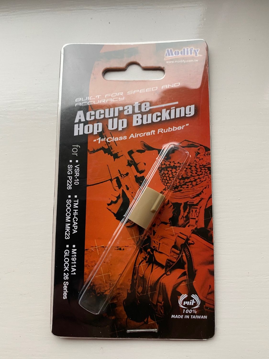

AlphaBear Posted October 2, 2020 Posted October 2, 2020 Is this the famous bucking everyone is larking on about. The package doesn’t say MWS so wanted to be sure. Part number is GB-05-62
JSwan Posted October 2, 2020 Posted October 2, 2020 2 hours ago, AlphaBear said: Is this the famous bucking everyone is larking on about. The package doesn’t say MWS so wanted to be sure. Part number is GB-05-62 Yes that’s the one modify tan coloured bucking. That’s the one I’ve got having been recommended it on this thread ?? AlphaBear 1

Marroksteel Posted October 3, 2020 Posted October 3, 2020 Yeah after reading 130 pages of this forum i didn't want the AG bolt set so i ordered a HAO econo(tan)bolt and G&P complete nozzle set/ adjustable valve I figured company's that spend time getting things right over getting it out the door is the cheaper option "buy once cry once".

P4radox Posted October 3, 2020 Posted October 3, 2020 On 30/09/2020 at 22:24, Davegolf said: @P4radox as a fix you can cut a small square of plastic sheet, the sort that the clear packaging display boxes are made of - that the guns modify hop unit probably can in lol - and superglue it onto one of the hop arm paddles. Basically increasing the relayed pressure applied from the first (hop wheel driven) lever to the second lever (pushing the nub) Yes ,thats true but one way or the other mocking always sucks , especially in sensible parts like hopup ... In this case I reckon easier to restore the original wheel which is handles properly fine bbs from 0.36g. GregArm 1
