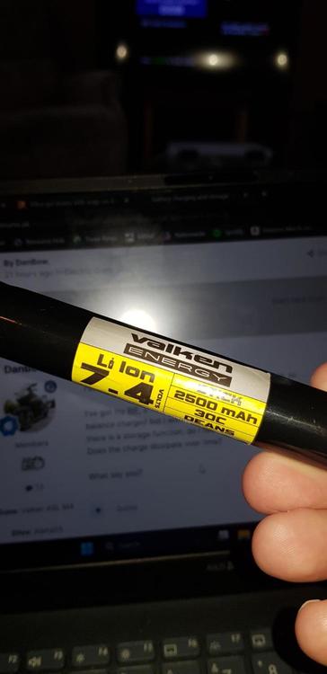

DanBow Posted September 11, 2023 Posted September 11, 2023 I've done a quick search of the forum but found nothing, so . . . . I've got my RIF, 2 x 7.4v Li-Ion batteries and a SkyRC S65 balance charger. Both batteries have been balance charged but I wont be playing for a few weeks as I work shifts. I see on the charger that there is a storage function, do I need to keep them plugged in if I'm not going to use them for a while? Does the charge dissipate over time? What say you?

RostokMcSpoons Posted September 11, 2023 Posted September 11, 2023 If you're running Li-Ion batteries (Titan?) them you don't need to worry, it's Li-po that need storage charges, but as the guys say - it's not a big deal, unless you want to squeeze every last percent of life out of them. DanBow 1

RostokMcSpoons Posted September 12, 2023 Posted September 12, 2023 Note that this storage charge stuff only applies to Li-Po batteries - if you really are using Li-Ion then one of the great benefits (as stated by Titan) is that they can be left in any state (except completely empty) indefinitely without affecting it adversely. DanBow and Rogerborg 1 1
DanBow Posted September 12, 2023 Author Posted September 12, 2023 29 minutes ago, RostokMcSpoons said: Note that this storage charge stuff only applies to Li-Po batteries - if you really are using Li-Ion then one of the great benefits (as stated by Titan) is that they can be left in any state (except completely empty) indefinitely without affecting it adversely. Ah, I'd missed that. Yes, definitely Li-Ion. Do I still need to balance charge them then?
Supporters Lozart Posted September 12, 2023 Supporters Posted September 12, 2023 Just now, DanBow said: Ah, I'd missed that. Yes, definitely Li-Ion. Do I still need to balance charge them then? Yes. DanBow 1
