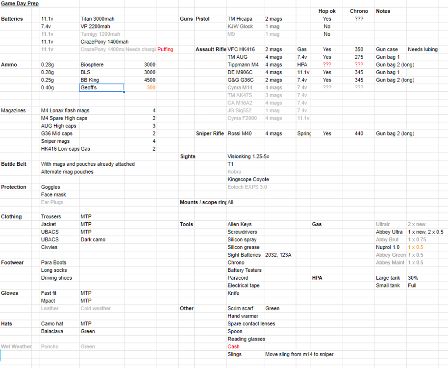

45 minutes ago, RostokMcSpoons said:
So I put all my kit into a spreadsheet
@RostokMcSpoonsyou're not alone in doing that 😂 So used to having a kit list, I've carried it across to airsoft.

I'm playing my first game in a loooooong time, and went a bit bananas today trying to work out what I needed.
So I put all my kit into a spreadsheet (and greyed-out the stuff I'm not taking / don't need)
It's a bat-shit crazy amount of kit
I know it's quite an OCD thing to have done... I wish I could attend to important things with as much diligence ;)
The TL;DR version is
  • Comfy clothes (plenty of cheap army surplus available)
  • Decent boots with some ankle support (the first time you trip over a tree root or stick your foot in a hole, you'll thank yourself for buying them)
    They're a very personal thing, but I took a punt on Swiss Paratroopers' boots which are heavy, but good.
  • Eye protection: Bolle Tracker 2's a cheap and good starting point, or British Army ESS goggles perhaps.
  • Half or full face mask (cheaper than a visit to the dentist)   Perhaps a Dye full-face mask if you're thinking of CQB.
  • Baseball cap or bush hat (scalp shots hurt, protect yourself at least a bit)
  • Gloves (knuckle shots hurt too) - Mechanix are great value.
  • Battle belt or chest rig + mag pouches.  You can just stuff things into pockets, but it's just not tacti-cool ;)
