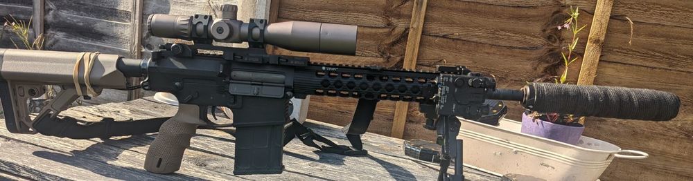

I can hardly talk, my MK12 was built from scratch so not exactly the cheapest way to go! I'm fortunate in that I can handle the engineering involved in putting airsoft bits together well enough.
