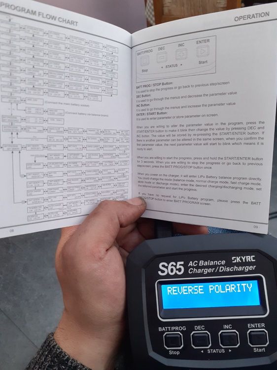

I am in way over my head ?
Looks like the tamiya to xt60 adaptor I bought has its wires crossed?
Either way it looks like I'll be using the NiMHs this weekend after all, there's no way I'm going to figure this out or sort the wiring issue before Sunday..20220516_201622.thumb.jpg.25ec649ac43d883f678369d77ffdbc71.jpg

Maybe swap wires round ?
Airsoft and RC disagree on Tamiya connector polarity, and as XT60 is mostly an RC thing I'd expect any converter to be RC wired.
Yup.  Oh, we covered that here, all you need to swap Tamiya terminals is a very small flat-blade screwdriver or some other way to squish the connector tabs in.
Oh it's not soldered? In that case I'll switch the wires around at work tomorrow. I have some heatshrink tube to tidy it up after.
Edit: found some heatshrink in my toolbox and just did it on my lap while watching TV. Super easy, I used a lock pick to bend the tabs down.
