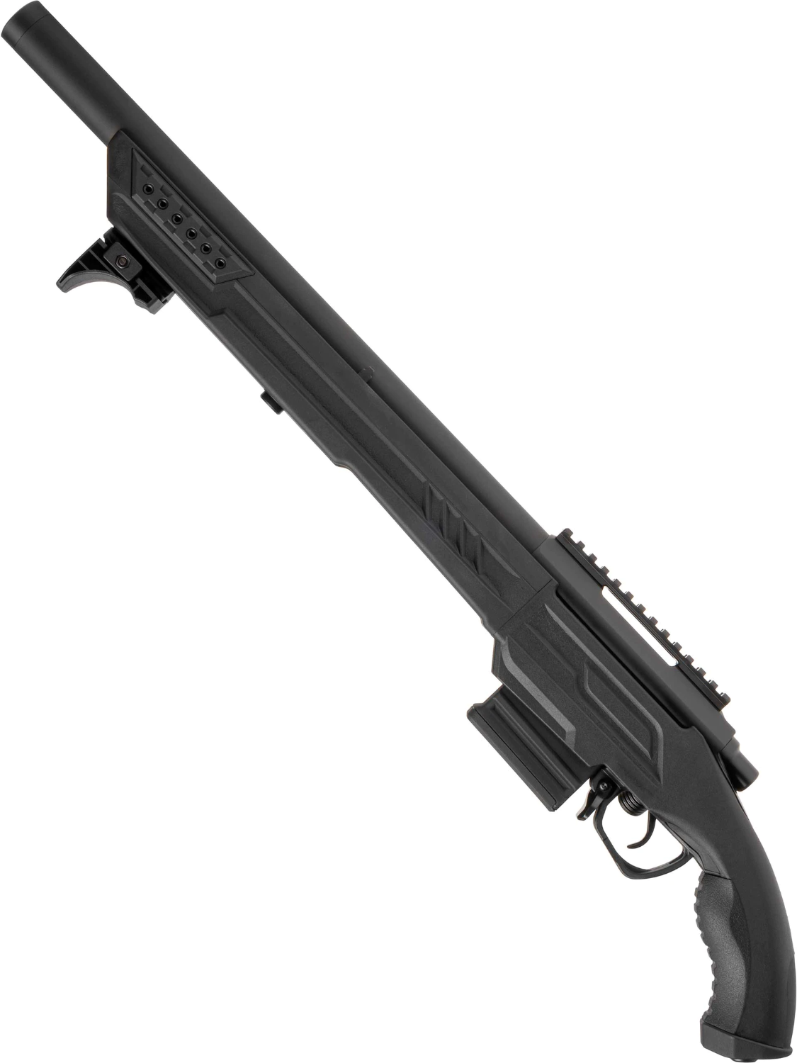

So sniper, I have a well mb-01 that’s been fully upgraded using Airsoft pro parts. Nothing inside is stock. What sort of range should I be expecting? I’m using 0.4 bb’s and a m170 spring. FPS is 200fps at best and about 0.8j’s. The range I feel I can hit well is about 40 meters. This seems incorrect to me but if someone can shine some light that’ll be great.
Mr dad.
That FPS is far too low, especially considered the barrel length and the whacking great spring you have in there. Do you have an air leak? Cock the bolt , stick your thumb over the end of the inner barrel and fire, does the air stay in the cylinder or does it leak out?
You should be hitting out 100 metres with that setup. (Though that's with an M170 which if working properly will be too hot for any UK field)
You should be getting about 80 metres with an M145/M150 which would be UK legal.
That’s what I was thinking.
So 80 meters is what I should be getting?
Thank you for the reply. Best go and double check it all. If I’m still having issues I’ll be back.

ok so took it all apart and checked it all and good air seal all the way to the nozzle. So the only thing it could be is the bucking. I have a maple leaf light green ( can’t for the life of me remember the degrees of it ) so I’ll get a new bucking and try it again in a few days.
Expand
Oh!  That's a 50 degree, it would be fine for a GBB pistol, but I'd suggest a 70 or 75 for a sniper rifle.
Hi all.
Thank you for all your help. So here’s what happened, the nozzle was damaged, don’t know how so it wasn’t sitting on the bucking right. So new nozzle, new harder bucking and a re-fit and double check and now I’m getting my 270fps and and 1.2j (ish) also changed to a m140 spring so it’s a lot easier to pull.
Thanks for the update.  Was the nozzle brass?  The mind boggles.
That's still low though, you should be seeing more like 1.9J out of that spring.
I'd have another look at the air seal.

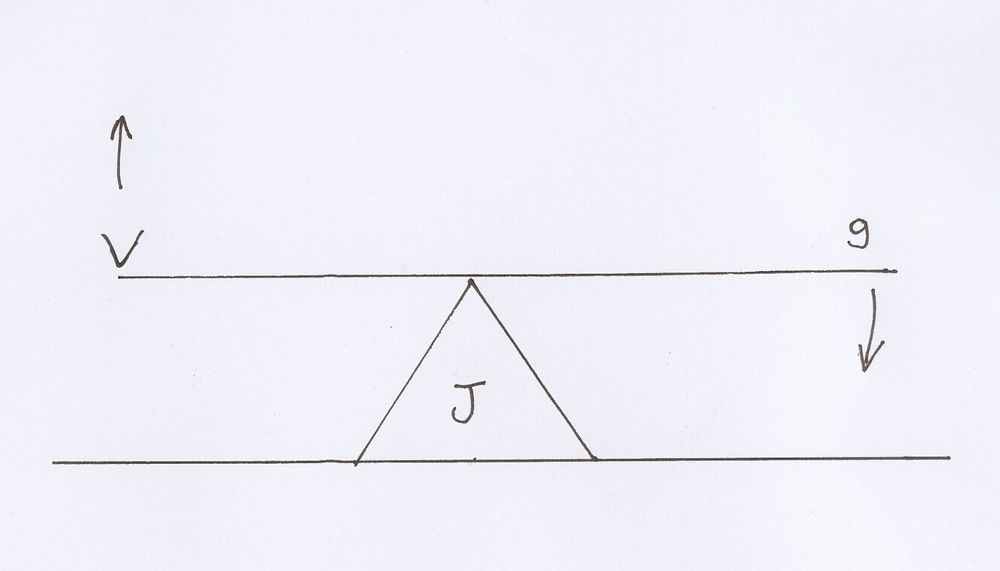

Here is what I am trying to make clear, the relationship of Joules to Velocity from BB weight.
You want more velocity then you have no option but to lower your BB weight.
If you swap out a spring, then your taking the RIF above its rated Joules output for no good reason other than to break it. Things are made to a stress point, even in airguns, like my sons HW57 that had a failure in the piston because of dieseling detonation on firing took the spring past its tolerance for compression and no longer produces the 11.9 ftlbs but only 8ft lbs.
Same rules apply in airguns, you want a slower speed and more joule delivery, go for heavier grain weights.
This posted image is the simplest way I could demonstrate what I am trying to put in to words.
It will also help those I hear uttering that "I don't know owt about this joules business..." and why it is important.
