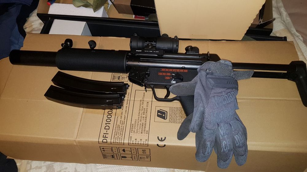

I actually took these a few weeks ago for another member on here who asked the same question :)
Whilst it doesn’t 100% line up with the cocking handle slot it does still function perfectly fine :)7F49550C-708C-4ACC-BBEF-2C0B2656B7D1.jpeg.bb2dfe2bf701a305af2e0287b93be39a.jpeg5341CEFD-0464-42BE-975D-576B54A8E7F4.jpeg.ca4519a966e79a17ddc03e0837a91f2f.jpeg78FB2C78-F041-431A-965D-50CDD26EACC4.jpeg.02781db239882af3b34c19550228016f.jpeg17AFE4A6-AC22-4444-8DF1-FE1161B2D80D.jpeg.389ee97c4c26107ea7c67cd4db952506.jpegA32B6AB7-436B-43C2-90D4-0AF7B6997AC6.jpeg.a5509b4014e44c5d267f14baa120dc65.jpeg

Funnily enough I asked Jim the same thing before I brought mine!
It fits, cocking handle locks back fine but it just falls short of seating properly.

Much appreciated, truth be told it doesn't look as shit as I was expecting it to either. Certainly food for thought, alongside figuring out what would go if I make the leap. Can't be breaking my self imposed 'no more than 4 RIFs (excluding the single pistol I own which is entirely there to justify a fancy holster... which is only there to justify a fancy belt etc etc). The MWS would be the one on the chopping block (again... which I knew full well would happen). A head scratcher indeed.
