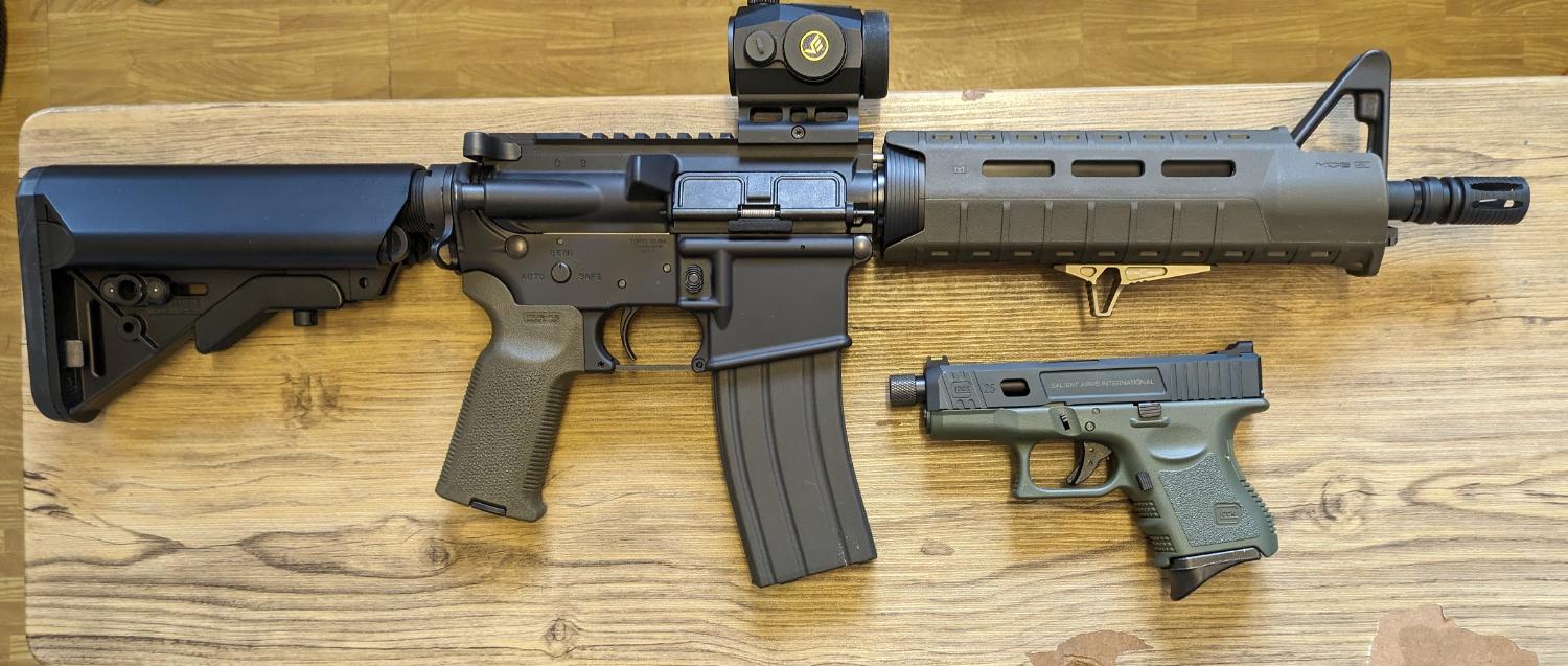

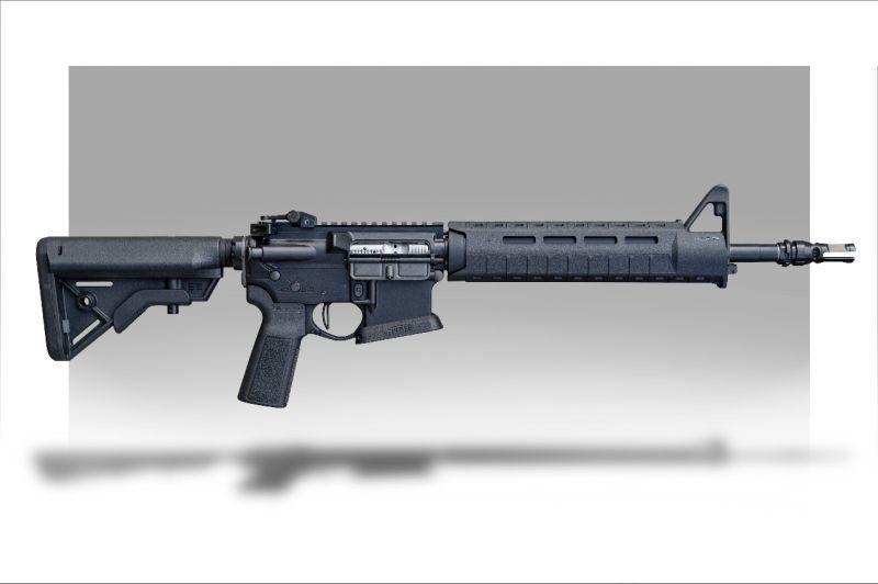

Popular Post GothicGhost Posted May 18, 2024 Popular Post Posted May 18, 2024 Magpul bits arrived, I just need to buy the OD stock and trigger guard next ? Jacob Wright, gavinkempsell, SSPKali and 3 others 6
Davegolf Posted May 20, 2024 Posted May 20, 2024 I did that build many moons ago, its so simple and light, classic front sight post, nice! GothicGhost 1
Wavey_Gravey Posted May 20, 2024 Posted May 20, 2024 Reminds me of this…which I really like: O3Tactical and GothicGhost 1 1

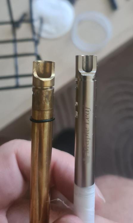

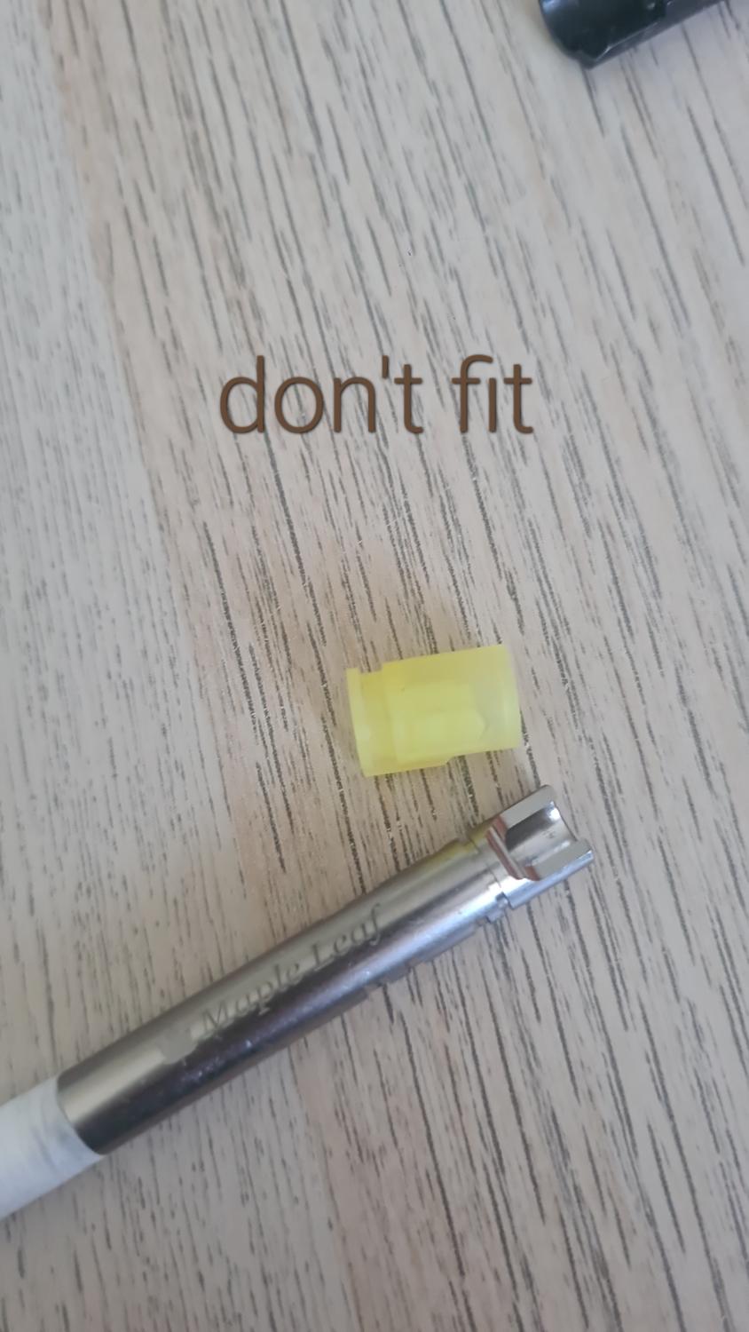

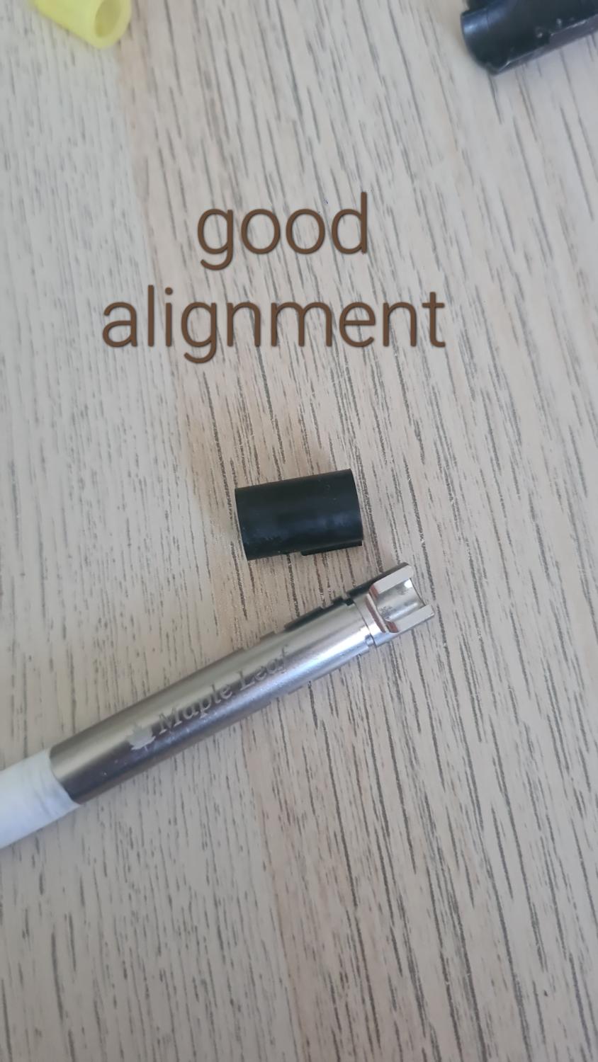

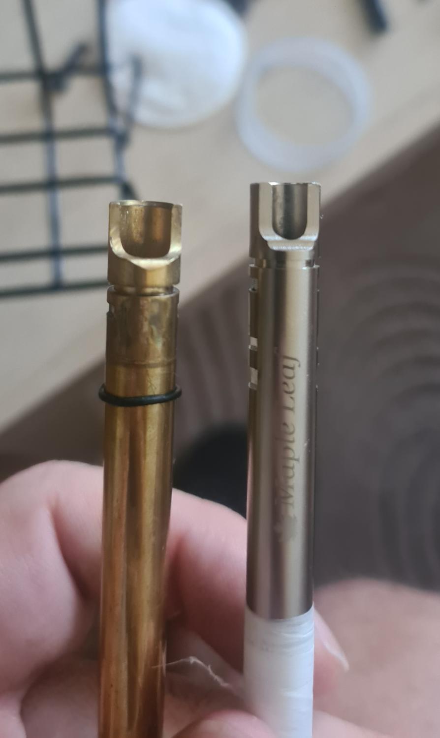

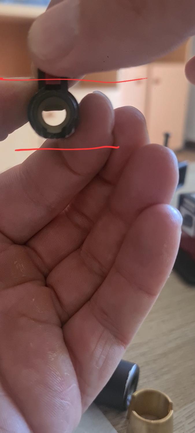

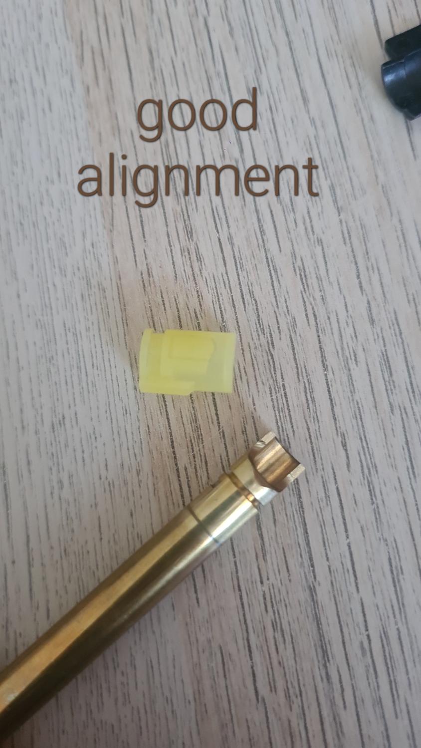

Jigorugu Posted July 2, 2024 Posted July 2, 2024 Hello people , I have a issue with my mws . So I am using this combo : maple leaf crazy jet inner barell, stock hopup chamber, laylax hop arm , maple leaf mr.hop . So clearly is not about unproper instalation cause I did it for several times , so what cause this misalignment ? 20240702_161512.mp4 20240702_161512.mp4 20240702_161512.mp4
Davegolf Posted July 3, 2024 Posted July 3, 2024 It can only be a duff bucking or the hop arm is duff/skewing under pressure.
zizivert Posted July 3, 2024 Posted July 3, 2024 Did you try to turn lightly the inner barrel clockwise? There is a little play wich can create this trouble.
Jigorugu Posted July 3, 2024 Posted July 3, 2024 I think I found out that this barrel crazy jet maple leaf is not good with maple leaf 60° mr.hop , just because the window cut is smaller that the rubber's nub , so that's is causing that misalignment. So I was bad advised about that 2 parts togheter GothicGhost 1
zizivert Posted July 4, 2024 Posted July 4, 2024 Using the good tools and with patience you can open the window of the crazy jet inner barrel.
GothicGhost Posted July 6, 2024 Posted July 6, 2024 On 03/07/2024 at 18:59, Jigorugu said: I think I found out that this barrel crazy jet maple leaf is not good with maple leaf 60° mr.hop , just because the window cut is smaller that the rubber's nub , so that's is causing that misalignment. So I was bad advised about that 2 parts togheter oh no, I was looking to buy a PDI barrel and use MR bucking, I assume it be the same issue looking at the PDI cut?
