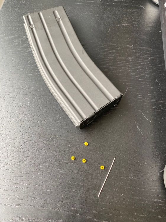

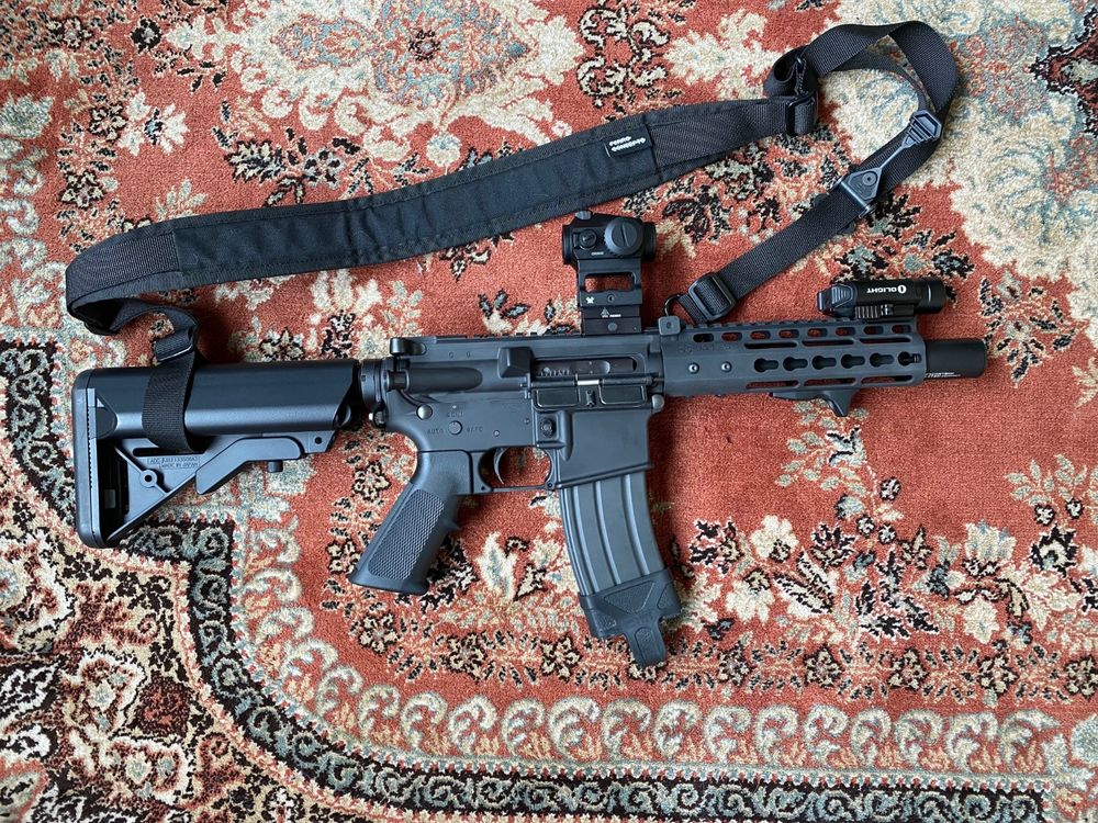

itsme Posted April 23, 2023 Posted April 23, 2023 Removed my silent fill o-rings from my greengas modded mags after having some trouble filling them up enough to shoot a whole magazine. problems are fixed and I can get about 2,5 mags worth of bb’s through a gas fill. Bonus picture of my CQB MWS build. looking to get a new buttstock. I want an SB tactical SBA3 but can’t seem to find a European resaler. If anyone knows one or a similar buttstock please let me know. SSPKali 1
SSPKali Posted April 23, 2023 Posted April 23, 2023 5 hours ago, itsme said: Really cool build - not sure about the riser on a riser? Are you a giraffe?!
itsme Posted April 23, 2023 Posted April 23, 2023 3 minutes ago, SSPKali said: Really cool build - not sure about the riser on a riser? Are you a giraffe?! I play with a dye paintball mask and makes it a lot easier to shoulder the weapon for me. I don’t like the looks of it either but it does the job really well. I would like the UNITY Fast Miceo which is kind of the same height as this one but it’s super expensive over here. So for now it will do. SSPKali 1
