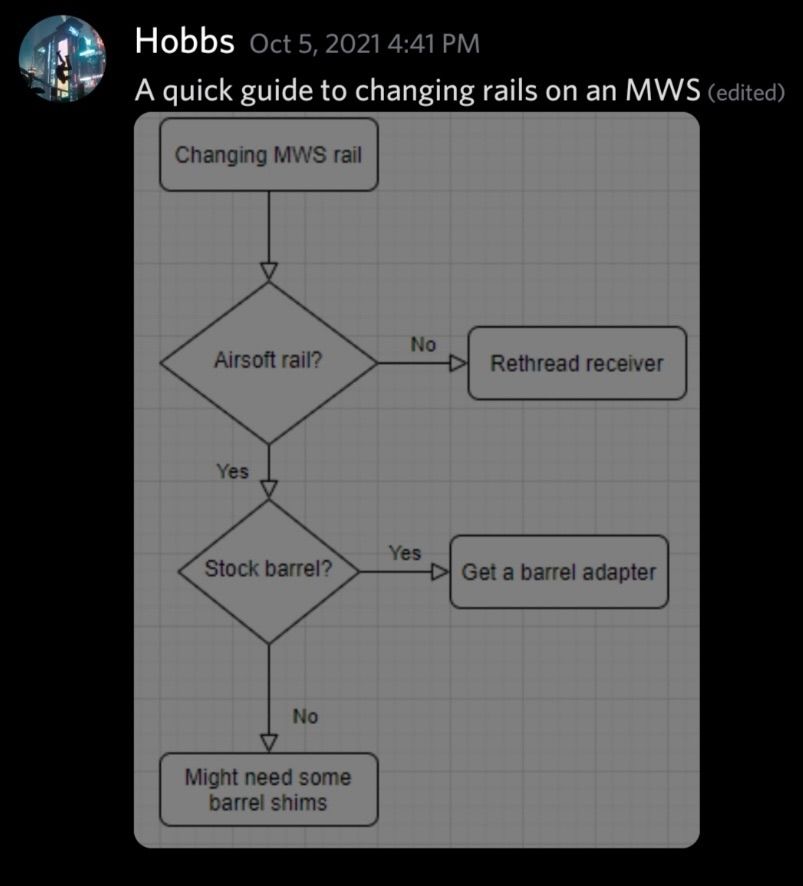

DrFumbles Posted August 2, 2022 Share Posted August 2, 2022 I've been looking into getting another rail for my MWS. I've found a Madbull Viking Tactical Extreme handguard which I quite like but before I drop the money on it does anyone know if it will actually fit? I've seen the PTS Barrel Adapter I could get but does this only work for PTS rails? If so is there another adapter I could buy? Could I also have people's opinions on Angry Gun outer barrels? Link to comment Share on other sites More sharing options...
SSPKali Posted August 2, 2022 Share Posted August 2, 2022 (edited) 35 minutes ago, DrFumbles said: I've been looking into getting another rail for my MWS. I've found a Madbull Viking Tactical Extreme handguard which I quite like but before I drop the money on it does anyone know if it will actually fit? I've seen the PTS Barrel Adapter I could get but does this only work for PTS rails? If so is there another adapter I could buy? Could I also have people's opinions on Angry Gun outer barrels? If the rail is an airsoft std one the mounting nut should screw straight on. Milspec one will need the receiver rethreading! If you change the barrel nut you will need a shim to make sure the barrel nut holds the outer barrel that is different diameter to AEG ones. Not tried it but apparently the PTS adapter shim only works with PTS barrels. There are a few others, I think WiiTech, Hao and others. Have a look on FireSupport (search ‘MWS’and then select “view all”) Edited August 2, 2022 by SSPKali Edited for barrel nut info Link to comment Share on other sites More sharing options...

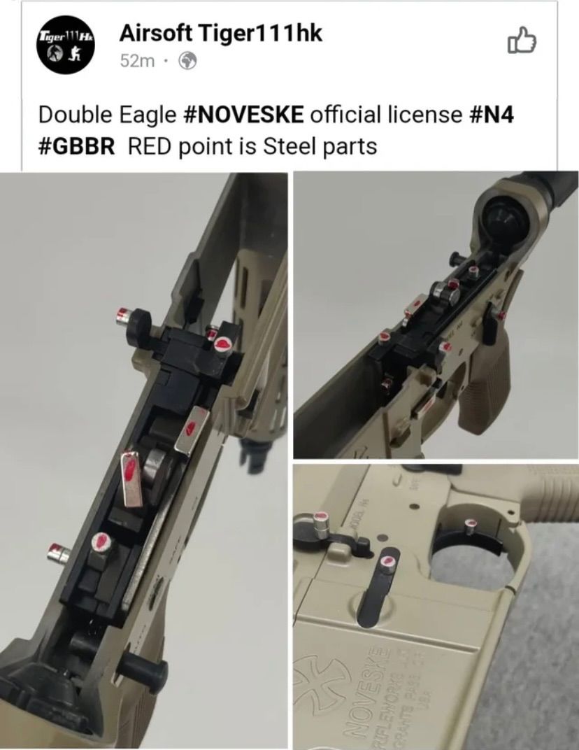

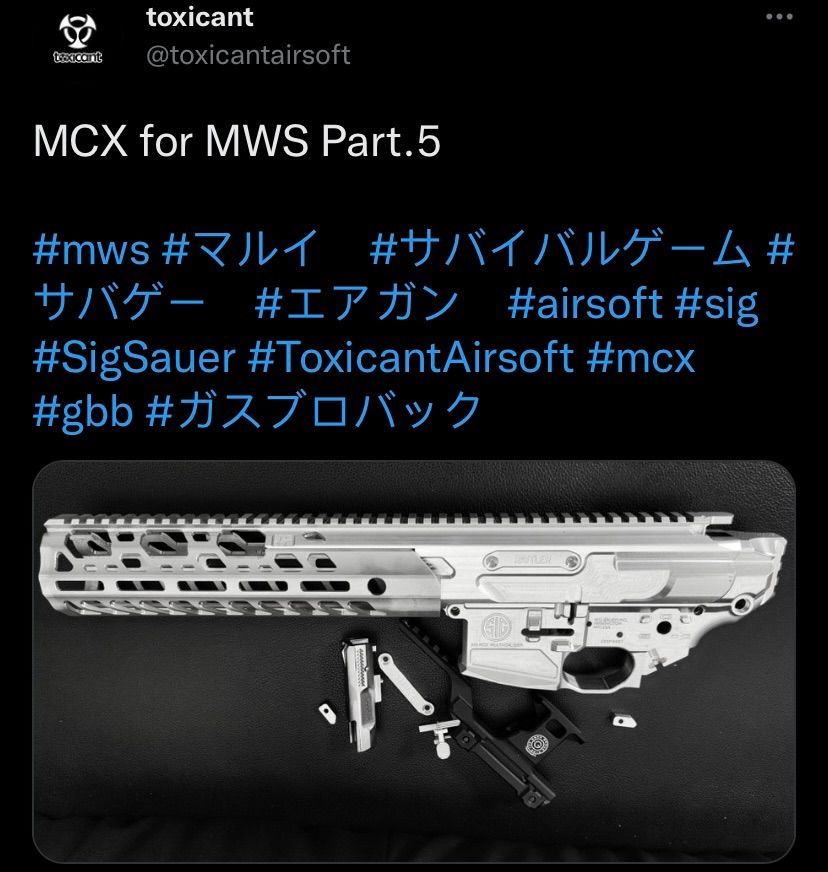

Wavey_Gravey Posted August 2, 2022 Share Posted August 2, 2022 So along with Airsoft artisan making a rattler kit, a company called Toxicant are also making an MXC kit: Aaaaaand I’ll just leave this here 👀 Sylithics 1 Link to comment Share on other sites More sharing options...
Speedbird_666 Posted August 2, 2022 Share Posted August 2, 2022 1 hour ago, Wavey_Gravey said: Aaaaaand I’ll just leave this here 👀 Is that a DEVGRU Noveske kit? Is it any different to the Dytac MWS offering? Link to comment Share on other sites More sharing options...
Wavey_Gravey Posted August 2, 2022 Share Posted August 2, 2022 Full rifle apparently, complete clone of the MWS zet system internally. Could be big win or massive flop but that’s Airsoft, right? Speedbird_666 1 Link to comment Share on other sites More sharing options...
Jacket Posted August 2, 2022 Share Posted August 2, 2022 10 hours ago, DrFumbles said: I've been looking into getting another rail for my MWS. I've found a Madbull Viking Tactical Extreme handguard which I quite like but before I drop the money on it does anyone know if it will actually fit? I've seen the PTS Barrel Adapter I could get but does this only work for PTS rails? If so is there another adapter I could buy? Could I also have people's opinions on Angry Gun outer barrels? I’ve had 4 madbull troy and vtac rails, only one of them fitted - the threads in the barrel nut just wouldn’t engage with the receiver threads past about 2 rotations. Link to comment Share on other sites More sharing options...
SSPKali Posted August 2, 2022 Share Posted August 2, 2022 12 minutes ago, Jacket said: I’ve had 4 madbull troy and vtac rails, only one of them fitted - the threads in the barrel nut just wouldn’t engage with the receiver threads past about 2 rotations. Sounds like that was a milspec threading which is close but not close enough. Link to comment Share on other sites More sharing options...
Jacket Posted August 2, 2022 Share Posted August 2, 2022 The Troy 7” one worked, the Troy 9” 13” and VTac 9” all wouldn’t screw on. All same design barrel nut obviously different batches. None had different descriptions of the thread in the adverts, but good on Firesupport and Landwarrior both refunded when I returned them. Link to comment Share on other sites More sharing options...
