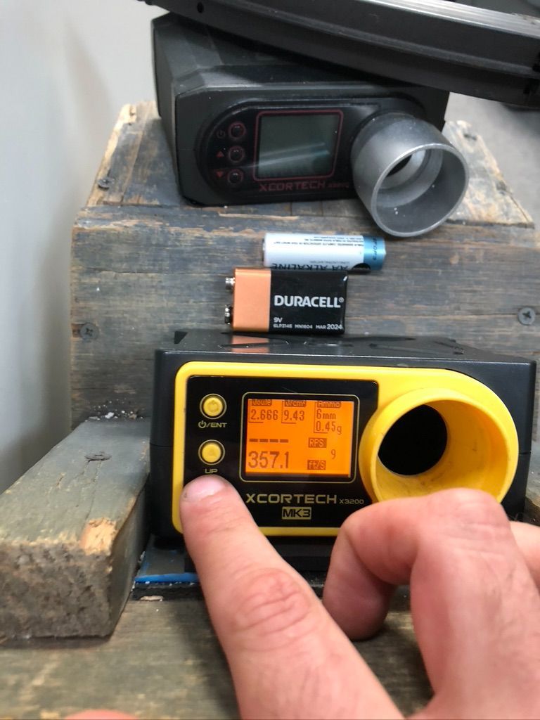

scar527 Posted October 16, 2021 Posted October 16, 2021 (edited) TM MWS, Stock bucking, SixG nub and buffer spacer, 410mm Barrel + Revanchist High Flow Nozzle. Otherwise stock. Tested with .45's: 357.8 (fps) 354.5 355.1 354.3 355.3 355.7 354.9 357.1 1-2 seconds between shots. Average of 2.65-2.66J Got an average of 350 with .48's, similar consistency with one deviation of +10 FPS Non UK user so higher FPS is legal where I'm at, that being said I have the stock nozzle and a Dynamic precision nozzle on hand to help tame that down a bit for DMR uses. Why am I sharing this? Because I am SUPER impressed with the consistency. Its on par with my SRS using the same ammo. Edited October 16, 2021 by scar527 Avg Joule Nick G and Wild Weasel 2

scar527 Posted October 16, 2021 Posted October 16, 2021 6 hours ago, AlphaBear said: Crikey! Those FPS figures with 0.48’s are scary high. I would not like to be on the end of one of those that’s for sure lol. By the way, what gas are you using and at what temperature was your test done at? Propane, 70-80F. Again this was to see what the setup is capable of, in game MED's apply and power of the rounds drops a lot after it leaves the gun.
