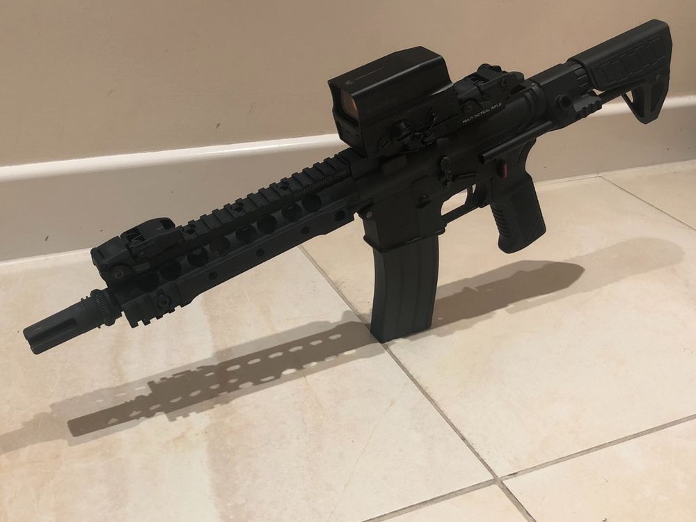

Cyberlawyer Posted April 24, 2021 Posted April 24, 2021 So here is the latest addition to my MWS collection. 8” PDW build. As some of you will remember from the above I picked up an MTR to use the ambi lower in my competition gun. This is what I did with the bits I had left. Its the MTR upper receiver (I wanted the forward assist on my competition gun) with a regular MWS lower a guarder front end kit and a G&P PDW stock. Still a few bits to sort. NPAS is on order and I managed to bugger up the bolt catch due to my own clumsiness so trigger box will have to come out once the new one arrives, but other than that I’m quite pleased with it. GothicGhost, Wo1f, SSPKali and 1 other 4
