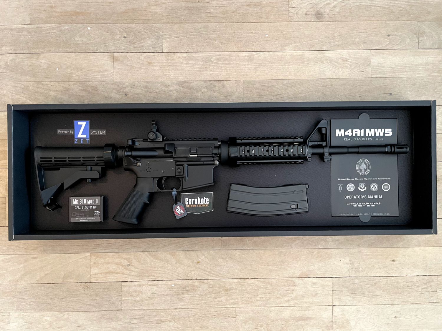

demandt Posted April 12, 2021 Posted April 12, 2021 (edited) Second MWS has arrived! Man... I never get tired of unboxing these things. And the brilliant finish they come with from the factory. I rattle canned my first MWS, so think this one will stay pristine. I have a civilian style build in mind for this one with a 13.5 M-LOK rail. Edited April 12, 2021 by demandt GothicGhost and RMDavis 1 1

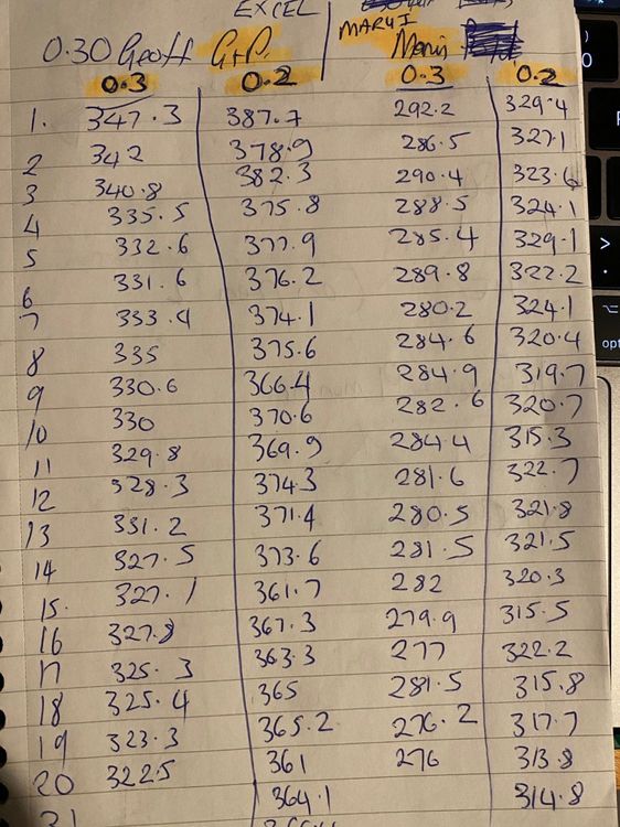

AlphaBear Posted April 12, 2021 Posted April 12, 2021 (edited) Guys, I did some FPS testing way back in January using a G&P BCG and a Marui BCG. For those who want to know what power you get from using Abbey Ultra Predator gas (the one that comes in a red can) see the attached pic. I did some testing using 0.3 Geoffs and 0.2 Excels at a temperature of 20c (I do believe). The left side shows a G&P bolt carrier group. On the right is the standard Marui bolt. The max figure for the G&P bolt was 387fps!! With the Marui bolt it was 329fps on 0.2s. Interesting results eh? The mag was filled up each time fresh of course which explains the initial high power. The main reason for the G&P bolt having a higher output is the floating valve in the nozzle. Obviously it's set to allow more gas to get pumped into the valve. Yes I can remedy this with a G&P NPAS which I do have but just haven't got round to installing it.... I will do at some point and then report back... (but don't hold me to that lol) Edited April 12, 2021 by AlphaBear
SSPKali Posted April 12, 2021 Posted April 12, 2021 (edited) 6 hours ago, AlphaBear said: Guys, I did some FPS testing way back in January using a G&P BCG and a Marui BCG. For those who want to know what power you get from using Abbey Ultra Predator gas (the one that comes in a red can) see the attached pic. I did some testing using 0.3 Geoffs and 0.2 Excels at a temperature of 20c (I do believe). The left side shows a G&P bolt carrier group. On the right is the standard Marui bolt. The max figure for the G&P bolt was 387fps!! With the Marui bolt it was 329fps on 0.2s. Interesting results eh? The mag was filled up each time fresh of course which explains the initial high power. The main reason for the G&P bolt having a higher output is the floating valve in the nozzle. Obviously it's set to allow more gas to get pumped into the valve. Yes I can remedy this with a G&P NPAS which I do have but just haven't got round to installing it.... I will do at some point and then report back... (but don't hold me to that lol) Solid work ?? I notice that there isn't a linear relationship between the 0.30g and 0.20g results - Take for example the TM bolt set up with an average of 285fps on a 0.30g, the same energy 0.20g BB should be going about 350fps....but the result is only about 320fps. I guess this is to do with the acceleration of heavier BBs, time to clear the barrel and effect on how fast the rocket valve closes. In all AEGs I have tested shooting at 285fps with 0.30g will always fire a 0.20g at 350fps just by changing the ammo weight. So well below the limit if tested at a site on 0.20g BB, but as soon as you put in 0.30gs to play and it might be (slightly) over the limit ? UPDATE: I have just tested my stock bolt/nozzle MWS with both 0.20g and 0.30g BBs (same brand, ASG gas, 11degC in the shed) and found that over 10 shots: 0.20g BB = 312 fps / 0.9 Joules 0.30g BB = 270 fps / 1.02 Joules 0.36g BB = 244 fps / 1.0 Joules ***UPDATED*** Looks like the short barrel and valve design keeps the power within Japanese limits even with very heavy ammo (IIRC TMs' are designed around 0.25g) ***UPDATED*** If I "adjust" the 0.30g BBs to equate them to 0.20g giving the same power predicted average is 331 fps, about 20fps difference I have a Dynamic Precision valve coming with my FireSupport order so will give that a try with the exact same set up and see what difference the alloy (heavier) valve will make. I am guessing a boost to the power / fps. Edited April 12, 2021 by SSPKali added info for 0.36g BBs as it was niggling that I didn't test them too!

AlphaBear Posted April 12, 2021 Posted April 12, 2021 1 hour ago, SSPKali said: Solid work ?? I notice that there isn't a linear relationship between the 0.30g and 0.20g results - Take for example the TM bolt set up with an average of 285fps on a 0.30g, the same energy 0.20g BB should be going about 350fps....but the result is only about 320fps. I guess this is to do with the acceleration of heavier BBs, time to clear the barrel and effect on how fast the rocket valve closes. In all AEGs I have tested shooting at 285fps with 0.30g will always fire a 0.20g at 350fps just by changing the ammo weight. So well below the limit if tested at a site on 0.20g BB, but as soon as you put in 0.30gs to play and it might be (slightly) over the limit ? Exactly. You’d think a 285 FPS 0.3 bb would them churn out the equivalent 0.20 bb at 350fps but my tests clearly showed that was not happening. With an AEG definitely the relationship would be almost linear as you said in your post. GBBRs are not an exact science. They are just fun to use. Here is a thought. It could well be the quality of the 0.2bbs they were Excels and pretty old too. Dare I say it about 6-7 yrs old maybe more. I do have some newer 0.2s so I’ll give them a go at the weekend and see what transpires. SSPKali 1
