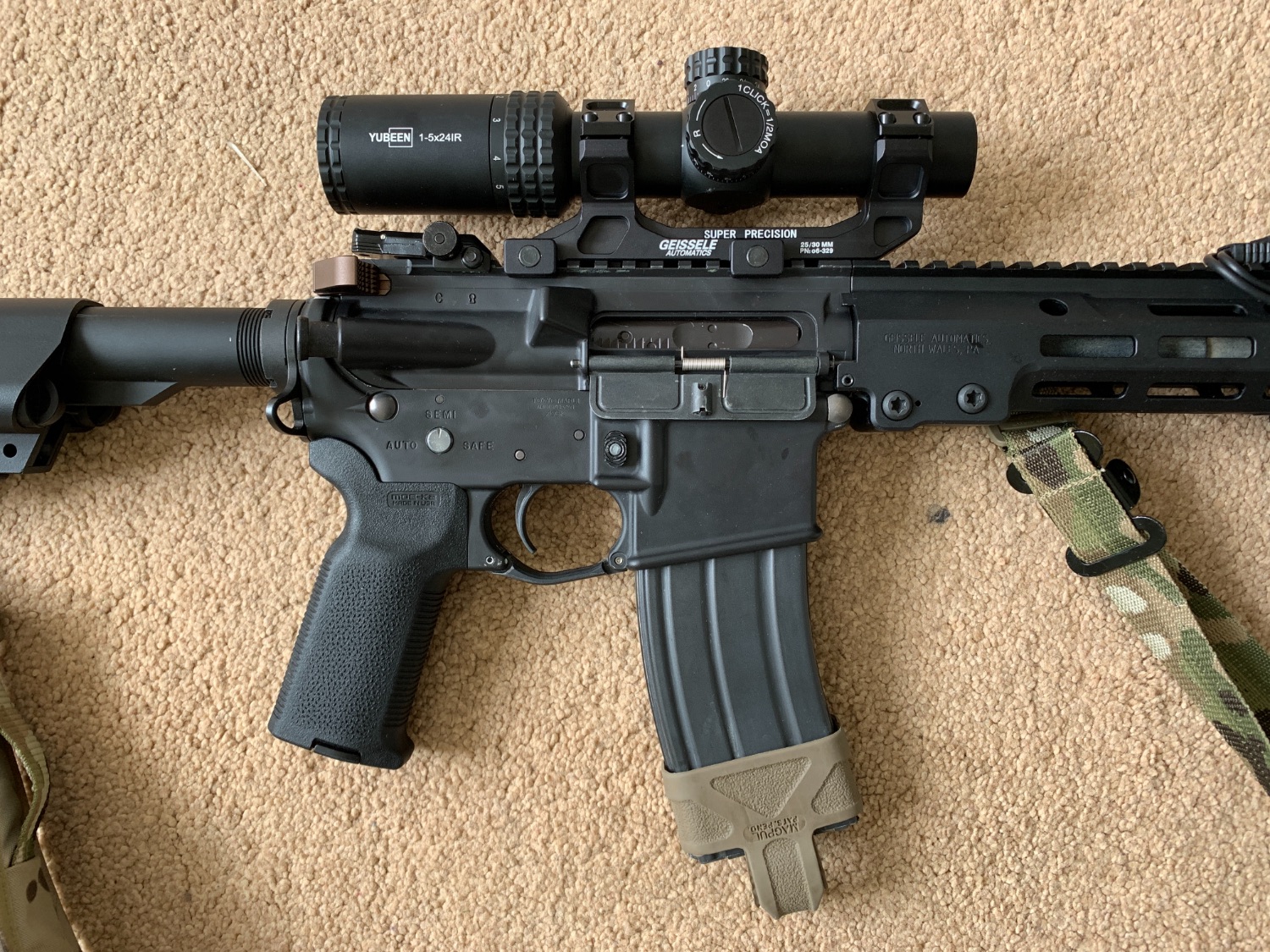

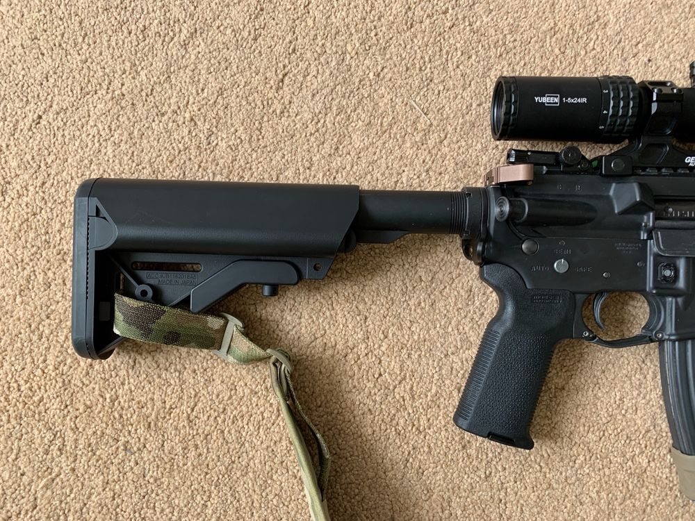

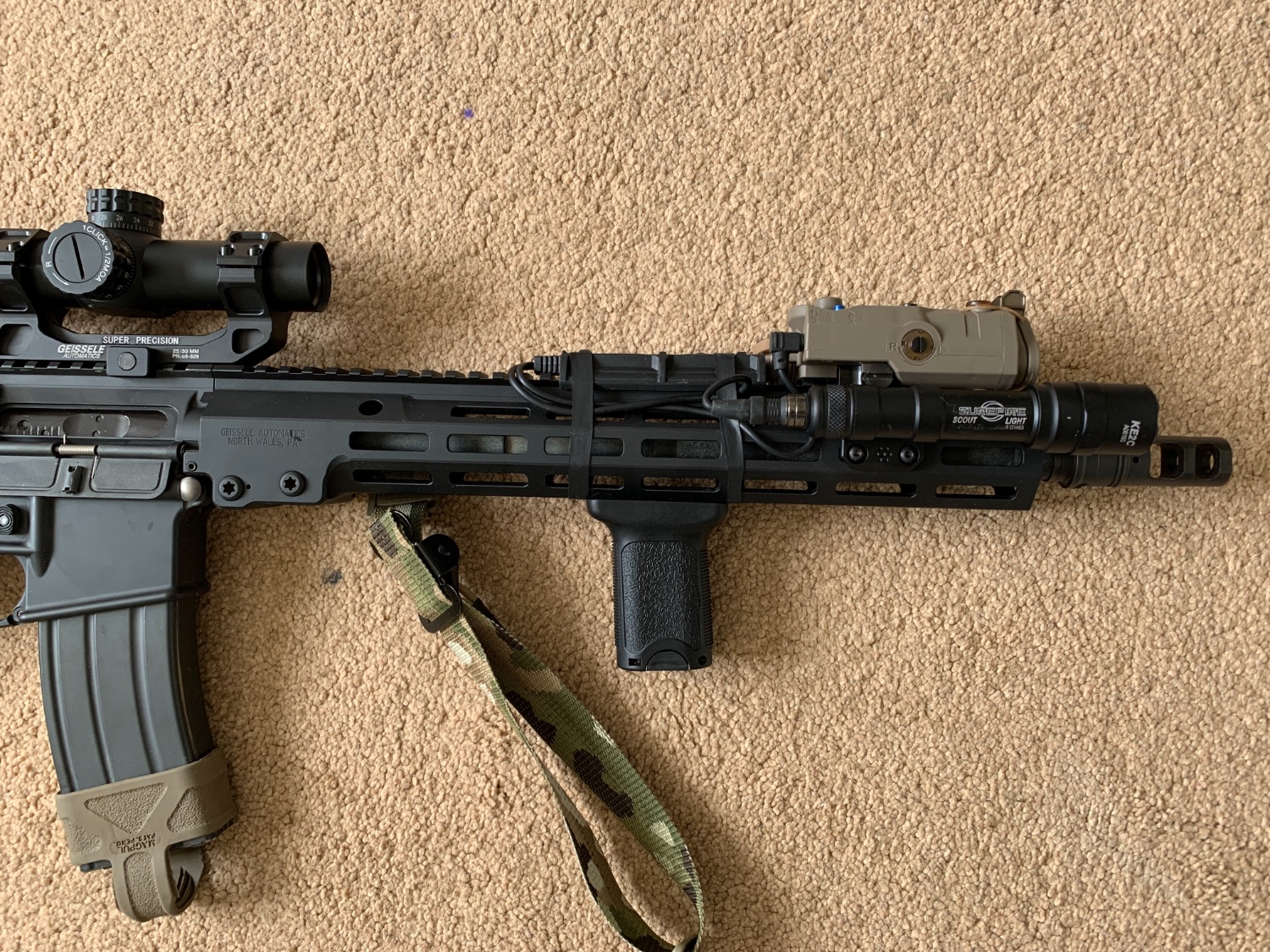

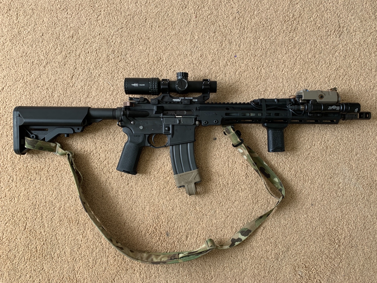

Groot Posted April 7, 2021 Posted April 7, 2021 Black Urgi build complete bar the magpul stock which may arrive from China in my lifetime quango2k, AlphaBear, Wild Weasel and 1 other 4
